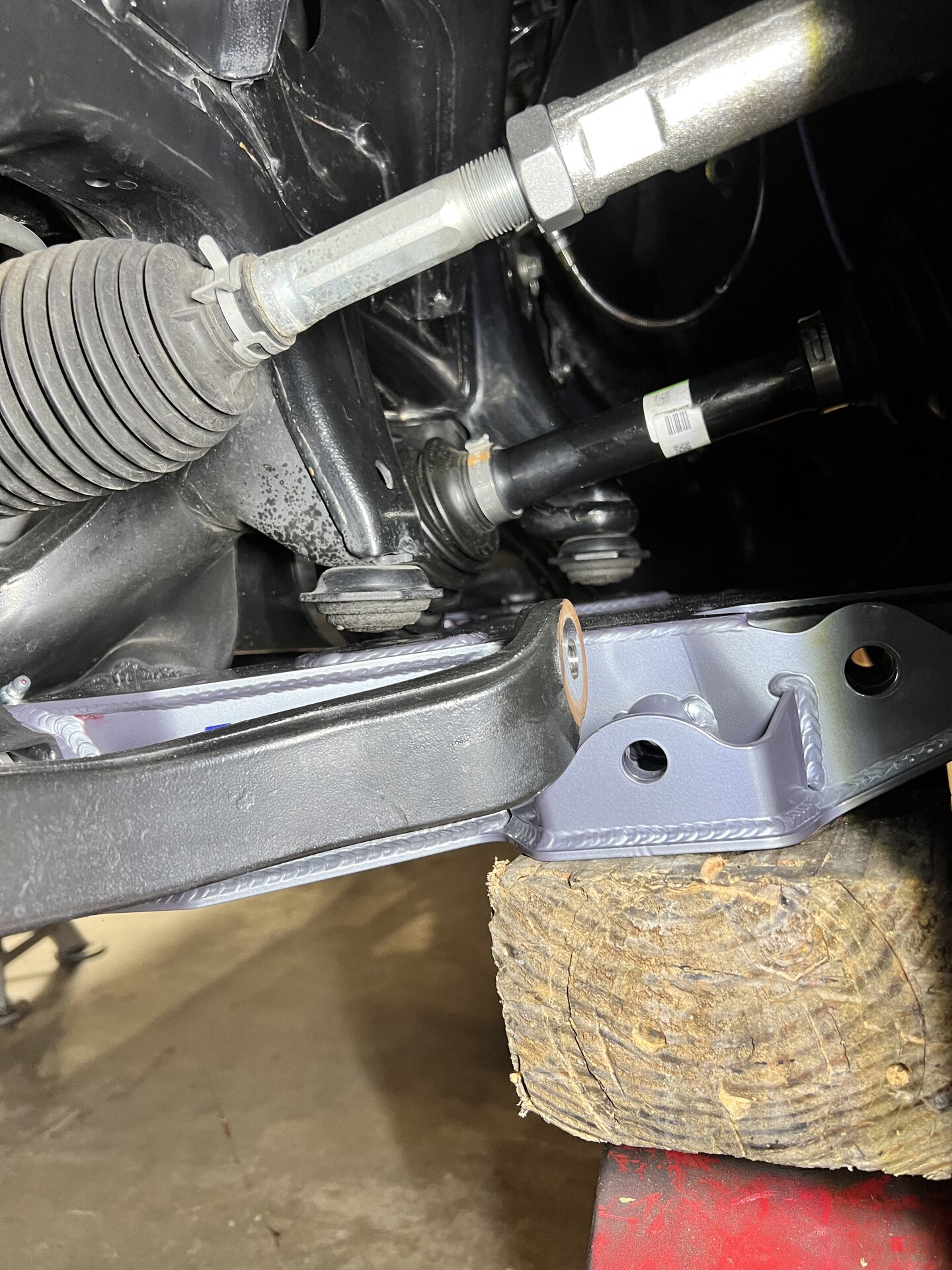

And last pic you can see the cv boots is about to touch the arm
Ouch, so TC Tundra lower arms won't allow full travel. Looks like an inch or two of lost compression travel. So the upper uniball bolt contact with inner fender won't matter.

that’s crazy to bind with that much travel remaining - gonna cut and box the arm? I’d imagine a 2” .120 tube section could give you a cup for the CV.

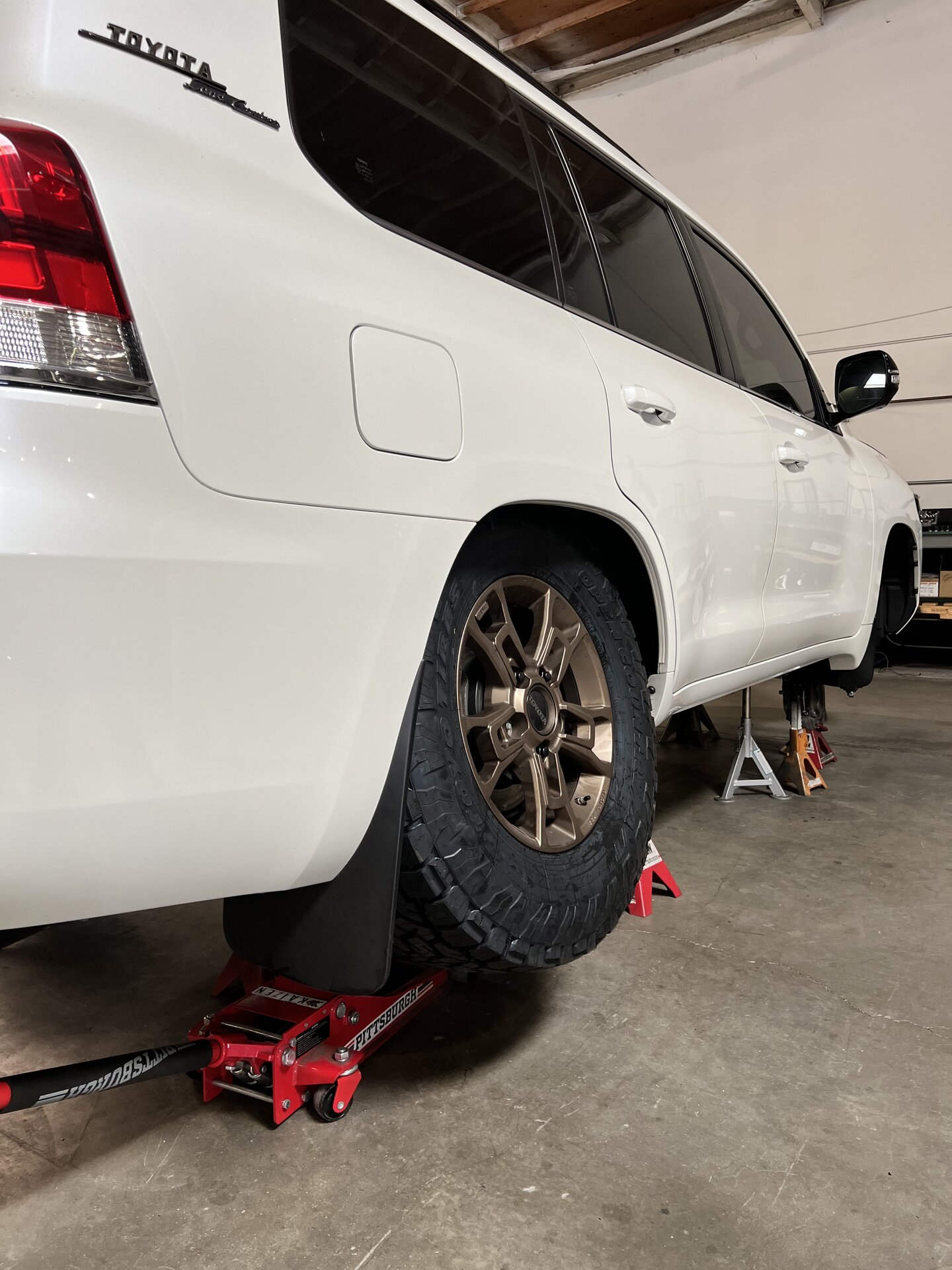

Stuffed the fronts pretty good. Using AHC low to make the suspension as slinky as possible. Fingers gap clearances, but stuffing 35s she does.
Was on the stops but not hard so and there's a bit more travel.

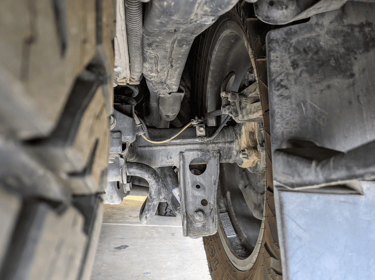

Rear, wasn't able to fully peg it out with my floor jack.View attachment 2489905
Looks like another 1"++ travel here to the bump stop that I couldn't tap out

But it’s not even just the arm. The 3.0 king is the same king shock that camburg would use. Nothing different. At full bump or with 1/8 of shaft showing that how much space there is to the oem bumps.
But there’s no more travel in the 3.0 king shock. It’s the same shock that camburg uses too. I just hav the shock out in the picture as we were getting ready to tac up some end links.

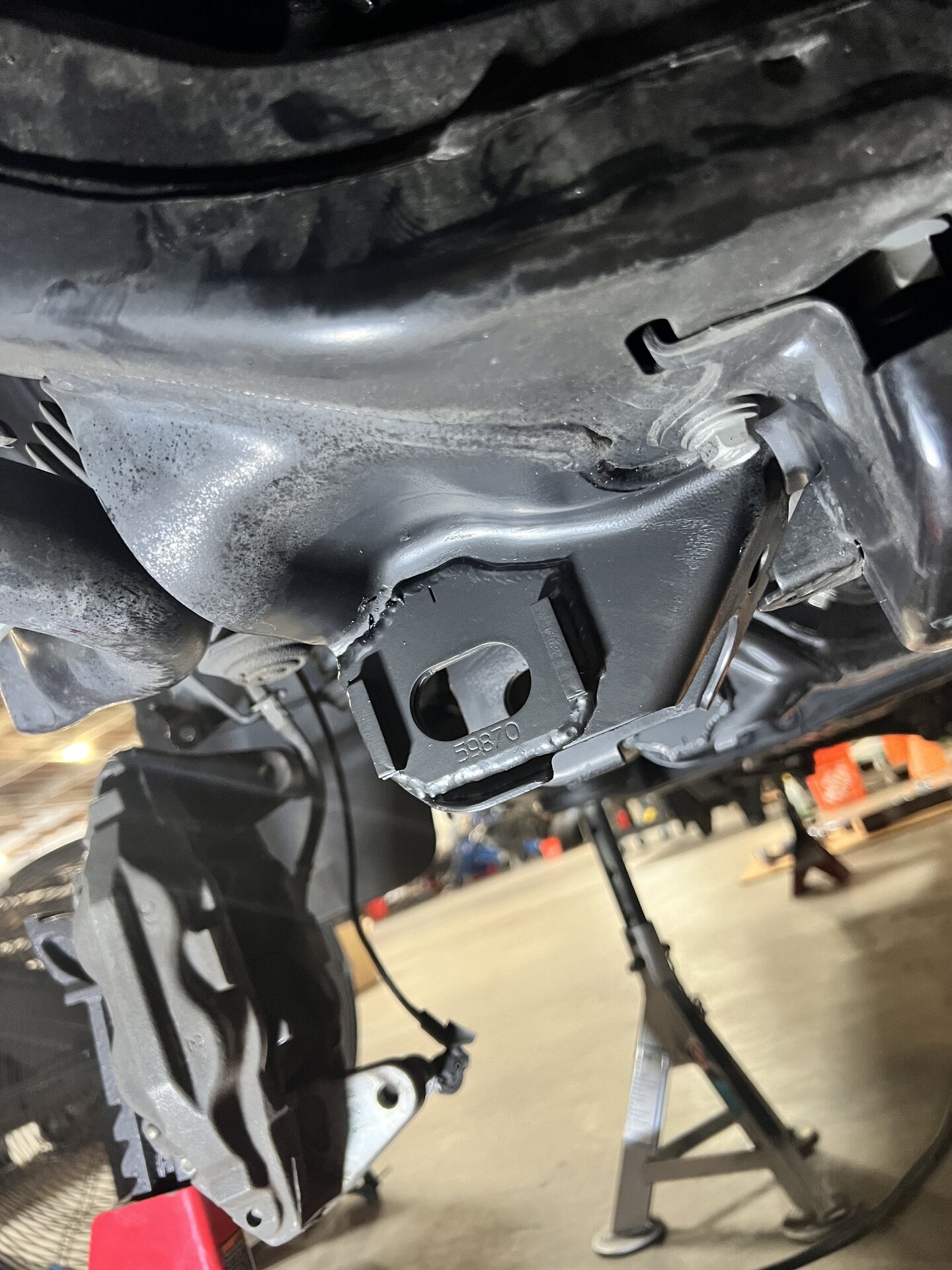

I believe on the Lexus axles, the rear stabilizer bar mounts with threaded holes underneath the panhard mounting bracket. Has that been factored into the BOTCK design, or will this be a Toyota only (KDSS equipped) design?
i will need to look at that. Do you have a picture? I can see thread holes for sure on the bottom of oem mount.
I bet you we can still bolt it similar to that off of the bracket I’m making. And then I’m just guessing that we can space out on the left side.

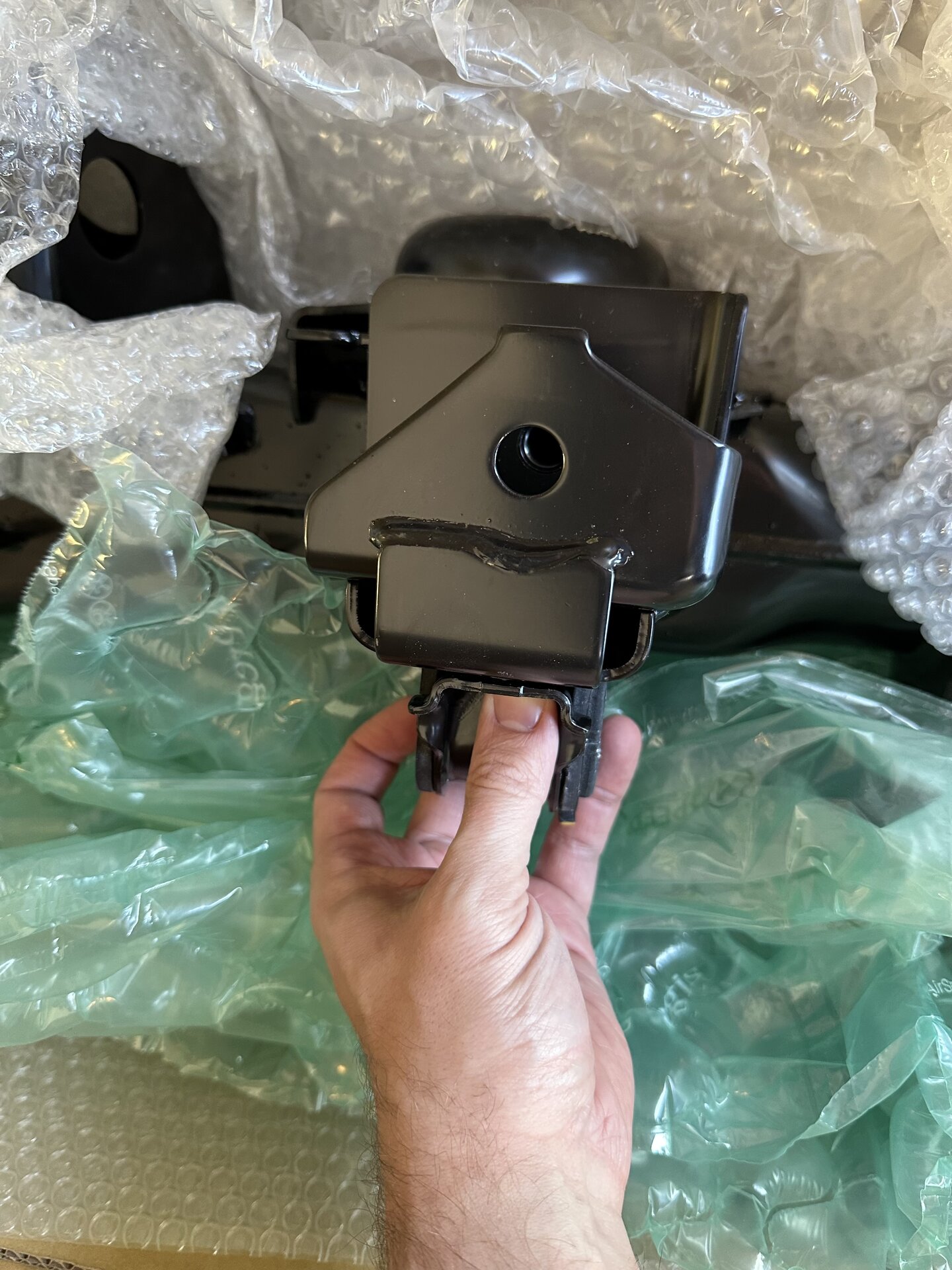

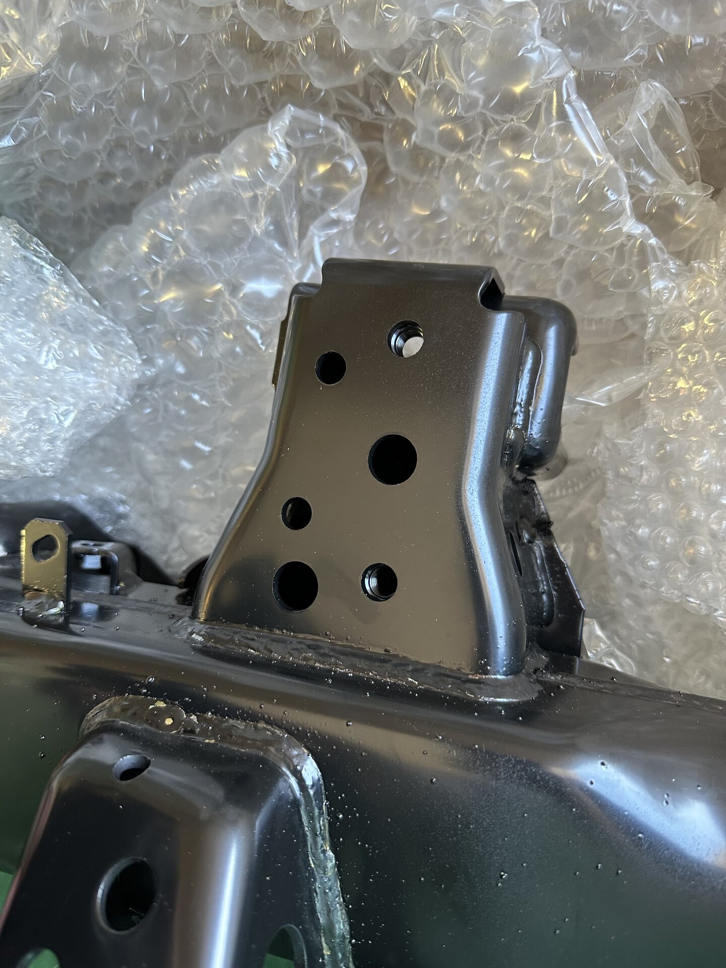

Here’s what I have. One of the Lexus guys may be able to do a bit better.
Now I’m interested why you have a shiny new axle housing lying around…
