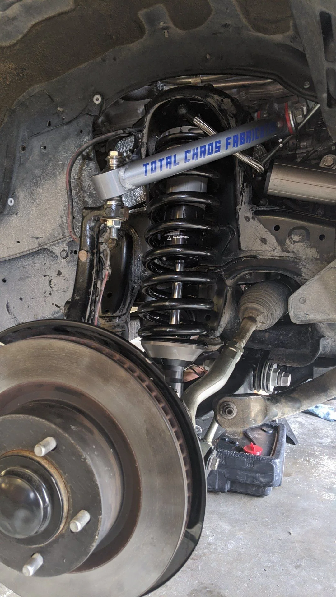

Because we spend so much time driving dirt, and because I want the 200 to be as comfortable and confidence-inspiring as possible, I figured the Tundra-swap front end was a good idea, and even convinced Toyota of that. They provided the OE parts to make it possible. I also wanted the install to be done right, by an actual expert, so brought Robbie Gordon's suspension guy up from south Texas to do it for us. Hudson Hall is probably one of the best suspension tech's in the country and will travel to do suspension installs. I don't think I could have figured all this out without him.

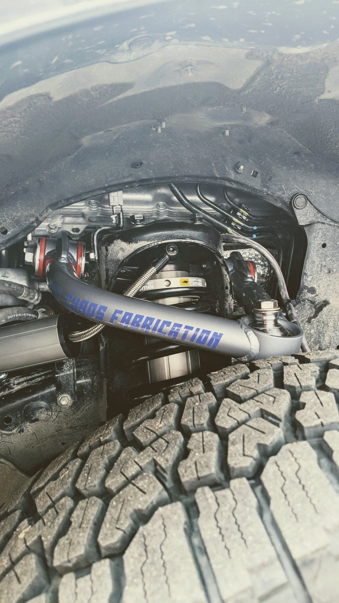

In addition to the Tundra lower control arms, tie rod ends, CVs, and other extraneous parts, Hudson and I opted for Tundra-spec Total Chaos upper control arms as the strongest possible option (the nature of this project is very much best-possible parts and decisions, no compromises), and Tundra-spec BP-51 coilovers for their ride quality, weather resistance, and long service intervals.
This being 2020, ARB is sold out of 200-spec BP-51 rears, so we're running the stock shocks and 440 LB OME springs (to support the rear bumper and 12.5ga LRA that're about to go on) until a new shipment comes in from Australia.

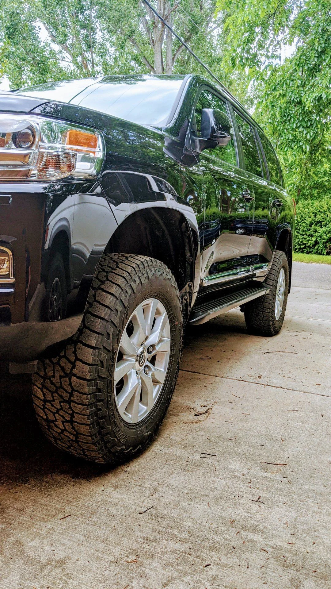

Other problems we ran into were trying to get zero offset wheels with 285/75r17 tires to tuck. There's just no way this front end works without the +56 offset of the stock wheels, and I just hate the look of the Rock Warriors. MLO is sold out of 17-inch Evo Corse's likely for the rest of the summer. BUT, I actually really like the look of the stock wheels, once they've been pushed out flush with the body. Running 1.25" Spidertrax spacers on the rear.
The end result of all that is +1.5 inches of width on each side up front, without a compromised scrub radius. Wheel travel has increased two inches. The outer sidewall of the tires is now perfectly flush with the truck's body. I don't understand why they don't just sell them like this stock. By the time we'd wrapped the install, my favorite tire shop was closed for the day, and today's Sunday, so I've only driven this thing about 25 miles so far. Given that limited mileage, ride quality and handling on the road feel 100% as good as stock, you just sit much higher. Very happy with that result.
I had 265/70-18 Falken AT3Ws (p-metric) on there already. We need to figure out a taller tire, but don't have much room for a wider one. Thinking 285/70-18s, unless anyone has a better suggestion?

Thanks for the suggestions. The least offset I see at Alpha Equipt is +35. Factory is +56, which is already flush with the body on this suspension. G0003s are probably a little aggressive for a vehicle I want to remain highway friendly. But yeah 285/70-18 or 275-70-18 are going to be the name of the game.
What did you do for sway bar end links? I seem to remember some people doing tundra arms saying the stock cruiser parts bind up.. could be wrong though.

Hope you give us better pictures once the armor is on! You made the right choice with ARB. Substantially beefier and more protection than competitors. You also made the right choice with TC arms. Best out there IMO. Suggest heavily greasing the bushings before installing them with synthetic grease.

Rock warriors are a lower offset and stuff fine with the Tundra front end. Lots of guys rocking this setup. I have Tundra front end, +60 OEM wheels (2013), wheels are flush with the body, and no rub anywhere at full stuff.

Haha I'm not suggesting you get them, I'm just saying you can go +35 easily and still be "flush". The RWs are used mostly because they are forged, and some of the lightest wheels out there. The AEs are something ridiculous like 20lbs. But yeah if its just about the looks, maybe some methods? And it's becoming slightly easier to find a tall/skinnier tire, most say 34" is perfect for these vehicles without introducing other issues and/or need to regear. That said... The Tundra arms def help with clearing the sway bar, and you could go closer to 35 if you stay narrow. Good luck, I'm sure whatever you go with "she" will love it.

Honestly, +35 would poke, and likely struggle to tuck a tall tire in the front fenders.

You might be right, I misspoke above I'm not running spacers in the front only rear. RWs are +50, I think I've seen some +45/Tundra setups. Lots of info on this board and Tundra swap comes up a frequently, there's a bunch of combos out there that work.
There is exactly one tire in 275/80r18. It's an AT by Kenda, I have a set and they are fine. Interco makes some narrow 33s if you want to go down the aggressive path.
I should add in my earlier post I was referring to 17 inch tire sizes .........also a body lift might may help to help get the needed clearance to stuff the tire
