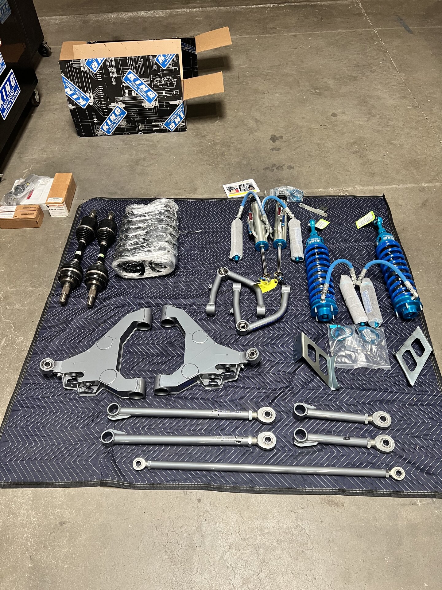

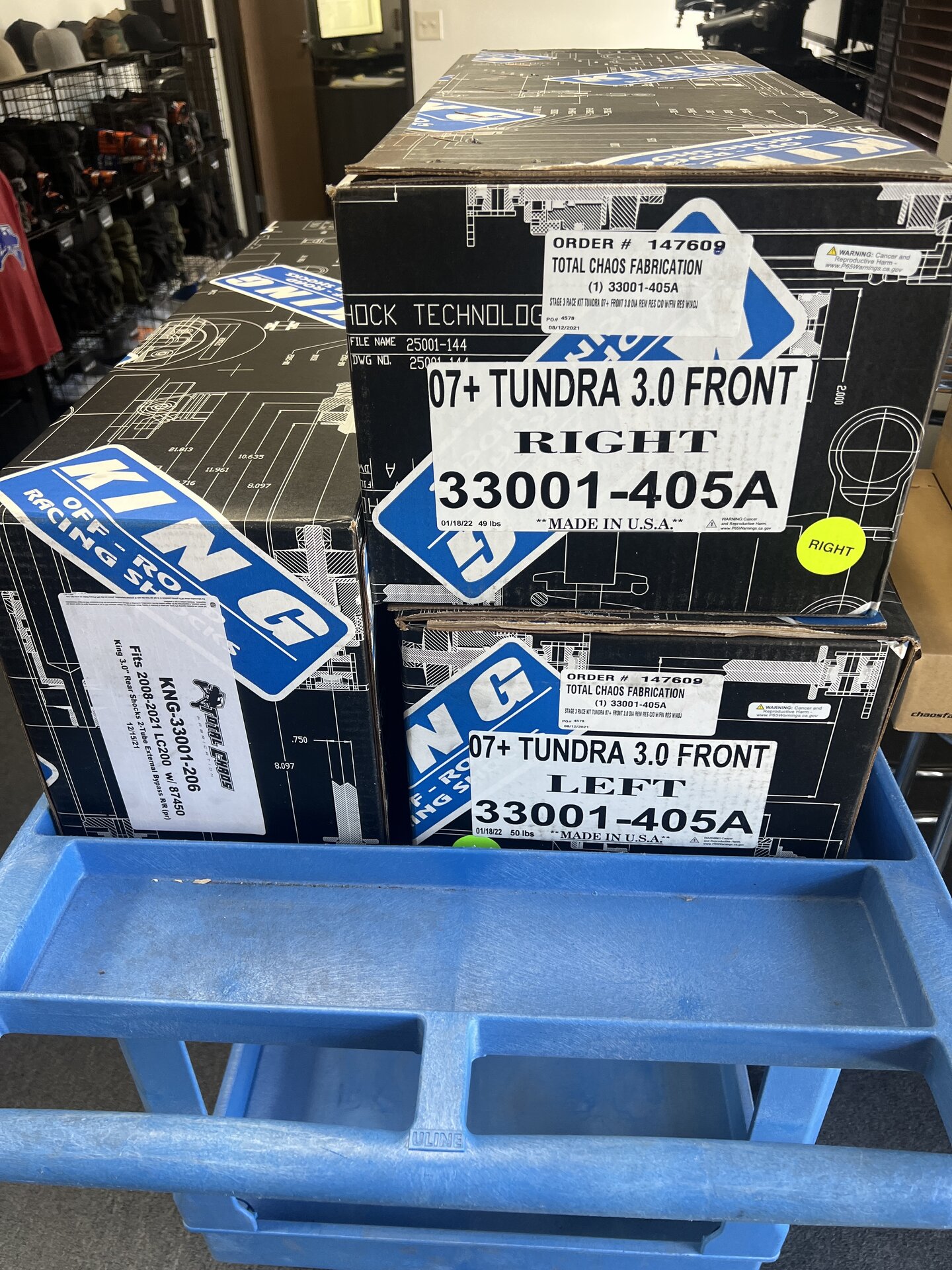

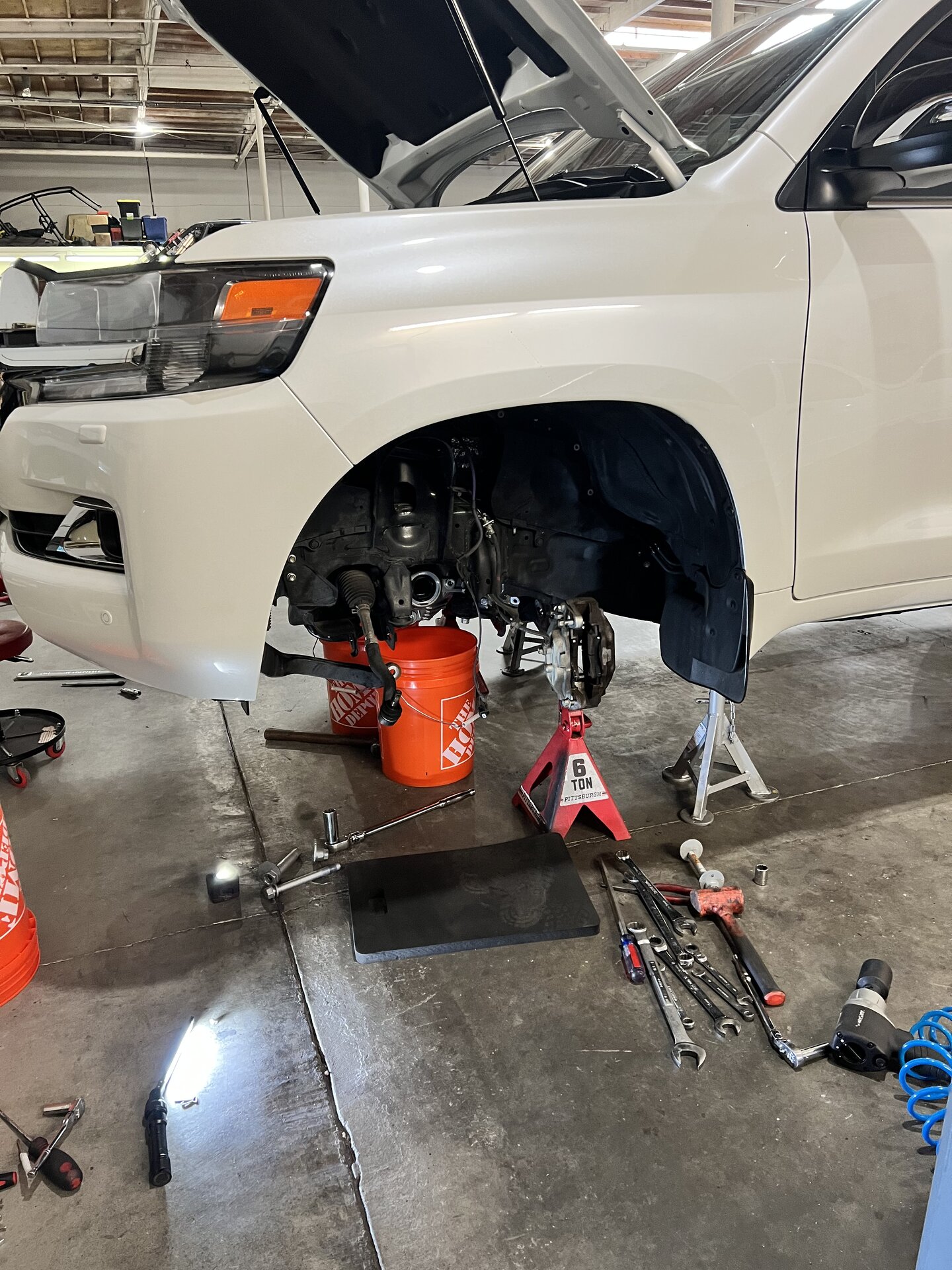

3.0 king shocks for gen2 Tundra for the front along with the TC tundra upper and lower arms. Oem tundra outer tie rods and oem Tundra cv axles. I will be designing an endlink that will allow this to bolt up to the kdss front sway bar with no bind in the suspension cycle. This link will allow one to use it on oem tundra lowers for those that use oem tundra arms. I’ll definitely make a bracket that will allow it to be double shear for the oem lower arm.
Cam tab gussets and spindle gussets because I don’t tread lightly ! Some ppl are going to be so butt hurt when you see how hard I’m going to go with this… “ for testing purposes “.

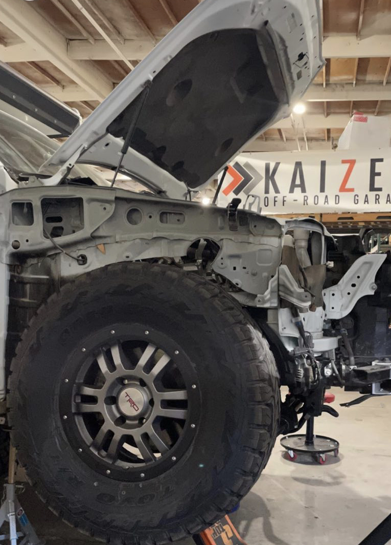

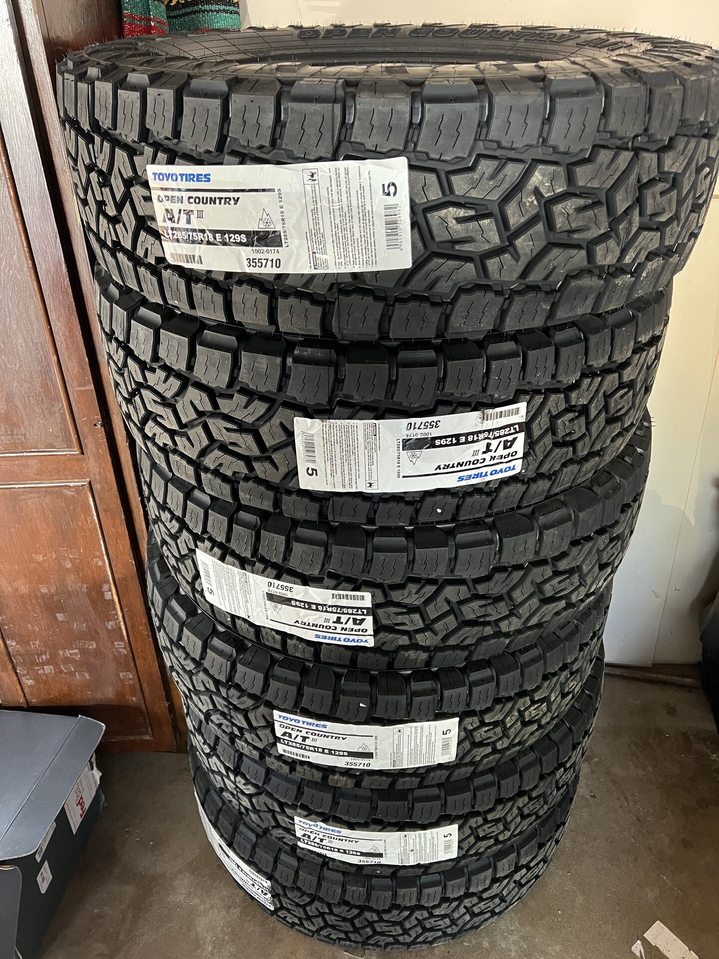

I’m sticking with the 18” bbs forged wheels for now 🤭. Also for now I’ll be using some toyo at3 in a 285/75/17. I will most likely get the fenders custom rolled to allow some tucking of the tires. But I will set the bump stops before the tires can hit the inner fenders.
On my 4r I have it completely tub’d and it will fully bump 35s

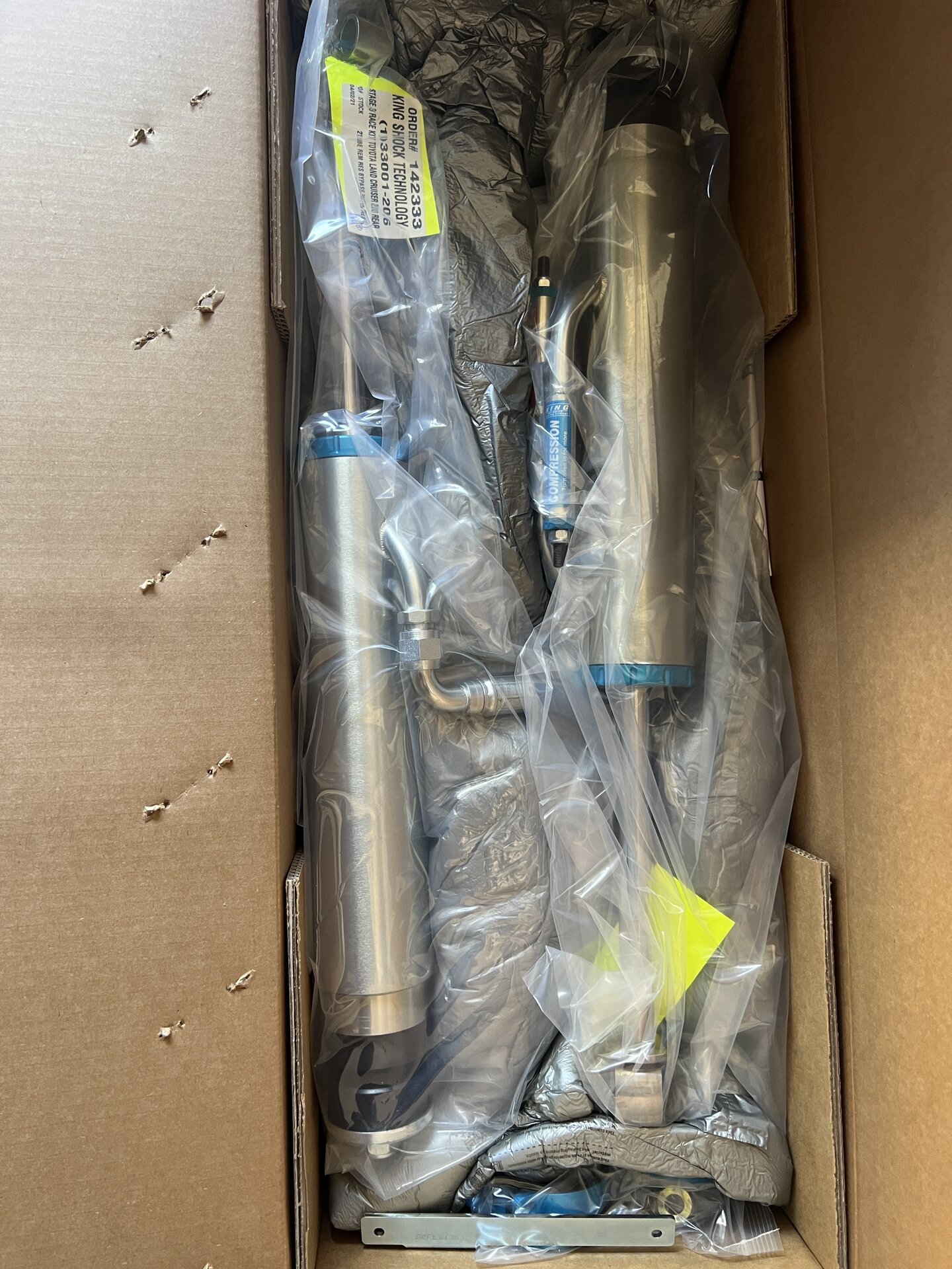

3.0 double bypass for the rear
3.0 Tundra king shock coilovers but these will be for sale once King finishes my 3.0 tundra IBP coilover 😆🤦🏻‍♂️.
TC had these waiting on the shelf for me.

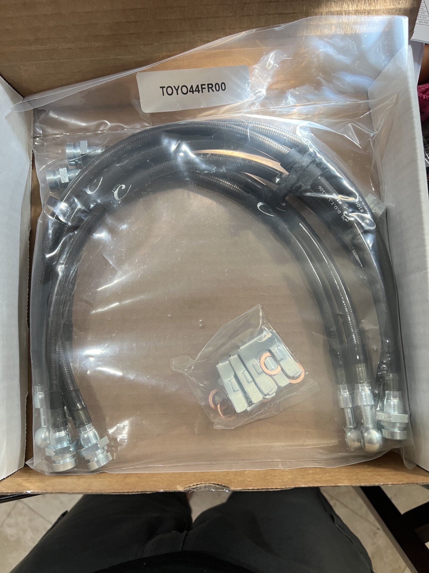

Brake lines from Crown Performance. +3 for the front and +2 for the rear center. The rest are standard length just in smoked steel braid.
Part numbers for reference. I saw a member ( BRYSON) had posted this info. But when I ordered based off his invoice. They didn’t recognize it or couldn’t find it. But we ended up figuring it out and I guess this is a new part number now based off my build. I hope it helps.

Those brake lines are exactly what im looking for.

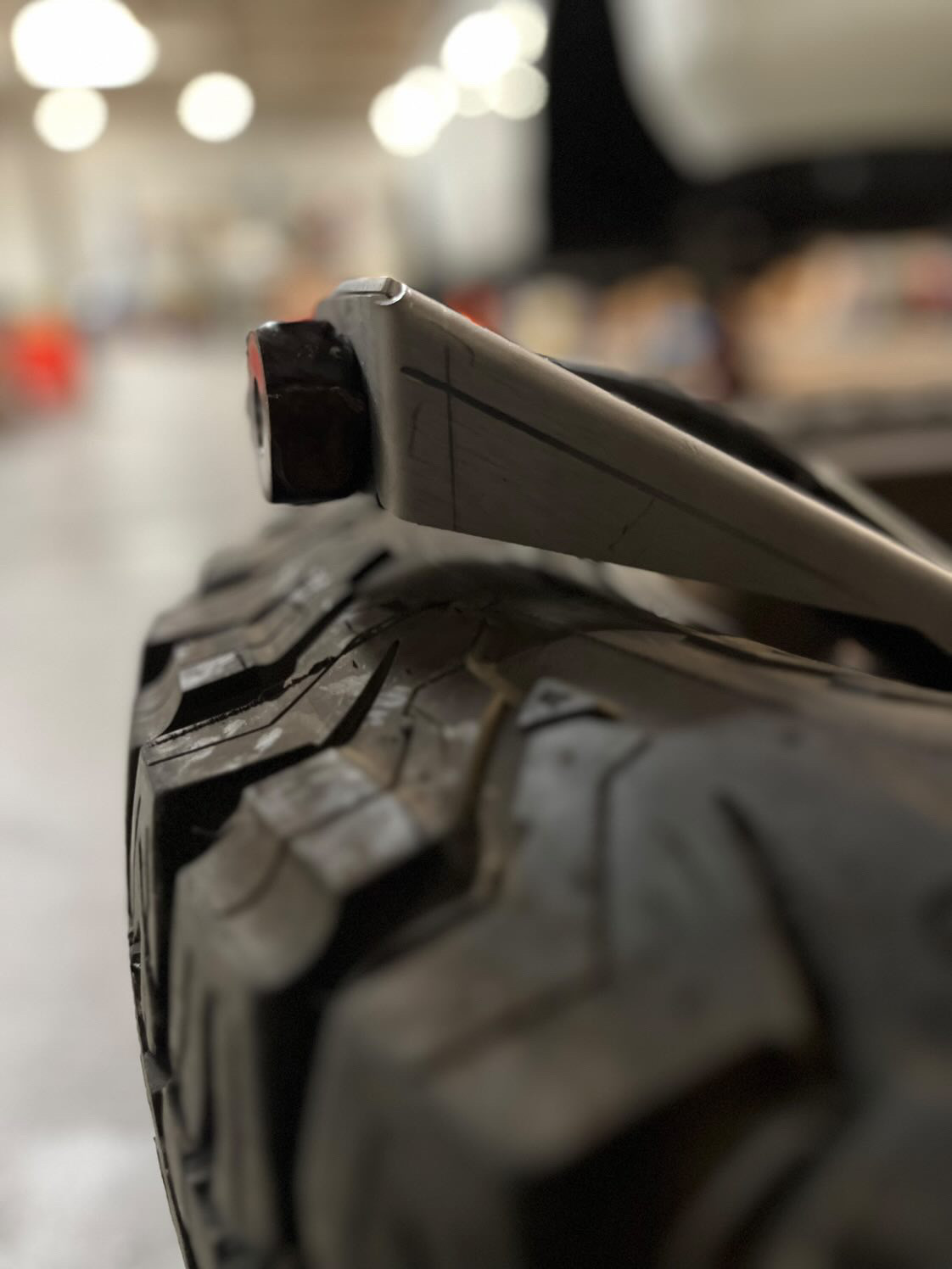

On full bottom out with Camburg Tundra arms, my upper arms just kiss the fenders. The TC arms have a misalignment spacer and the bolt head sticking out of the uniball. I would cycle the suspension and verify the bolt head doesn't contact the upper fender before bottom out.

1000% I always cycle my builds. No matter what. What size tires did you run on the setup you are talking about ? I’m setting my bumps so I don’t contact the tires on the inner fender. My 4runner is full tub’d so I get max up travel on 35s. Notching the coil buckets seems pretty easy!!

On the 4r I literally have 1/8” of shaft showing at full bump and absolutely no tire contact even full lock full bump. It’s amazing how fast this 4r can move and I don’t even have my 3link rear yet which I’m going to introduce a new style 3link soon and yes I still have kdss.
