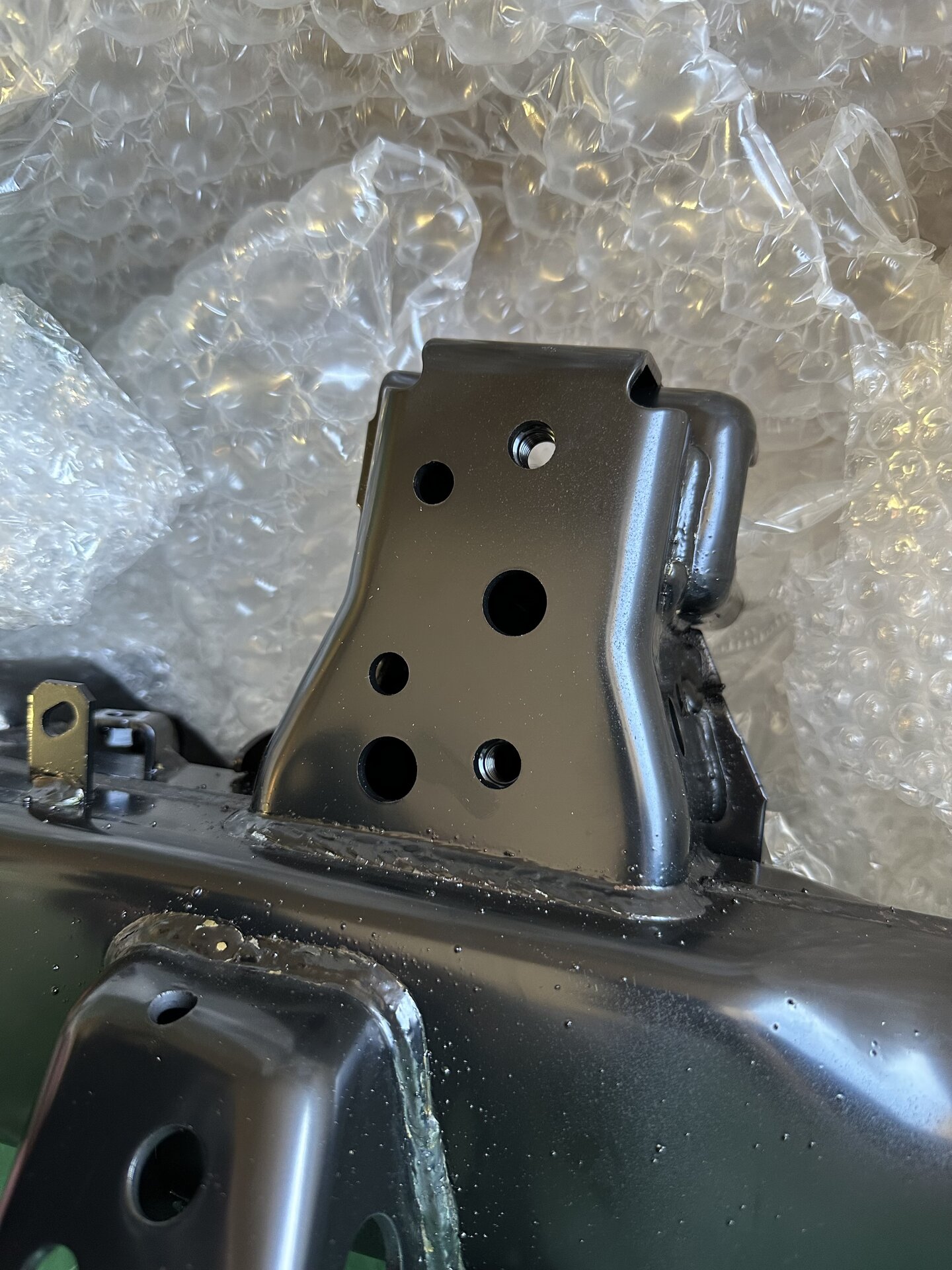

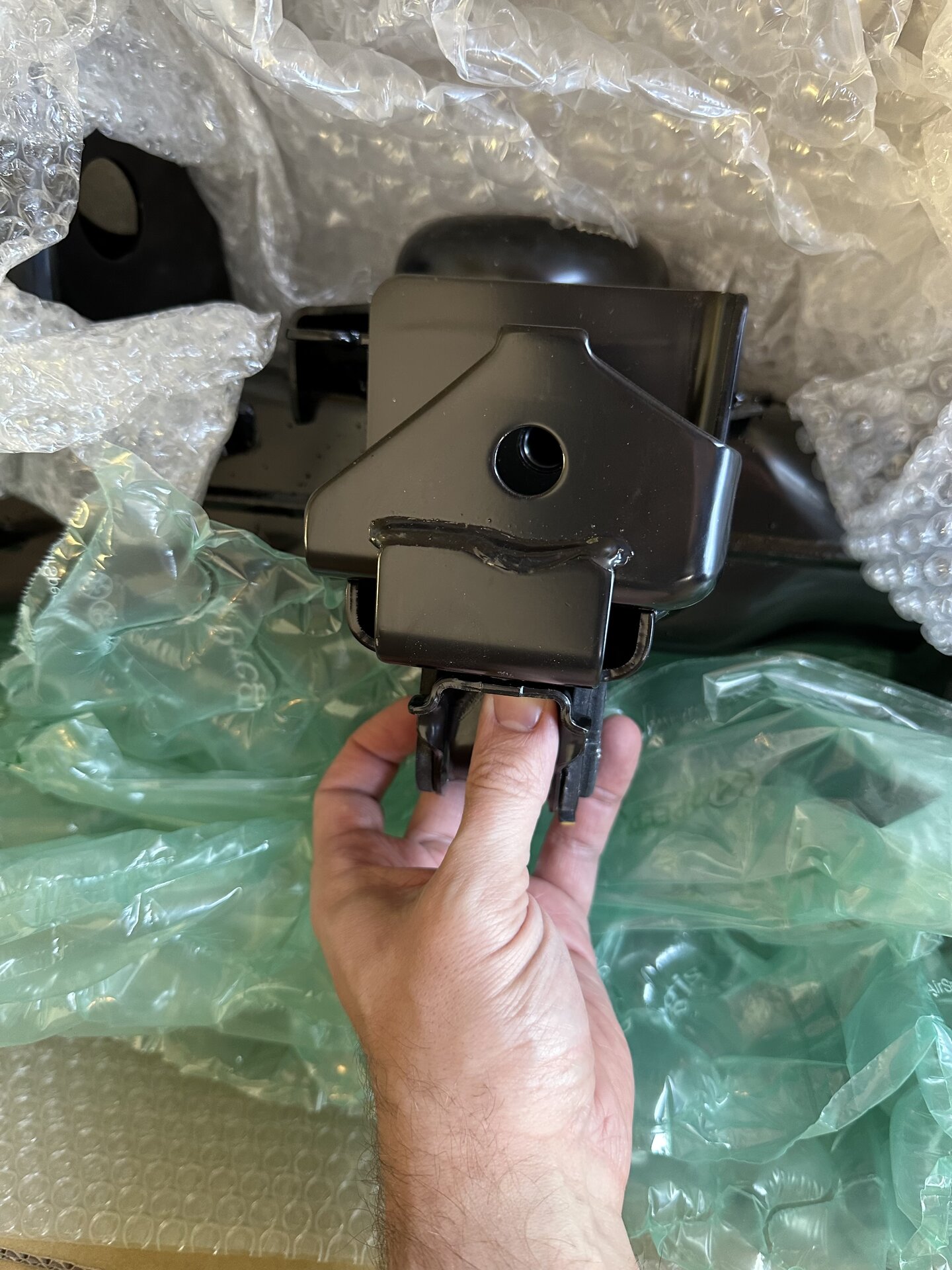

Oh yeah now I get it. It’s funny because I’m going to use those threaded holes to utilize the way the bolt on trac bar bracket bolts to the bottom of the oem mount. I don’t see it being an issue ( right now in my head 🤣).
We’ve made some brackets for some lower links on another platform that utilized an area where the sway bar bolted to it. And spacing it down 3/16-1/4” absolutely didn’t do anything to the sway bar and it worked out perfect. I’m trying to find a picture of it… to be continued !

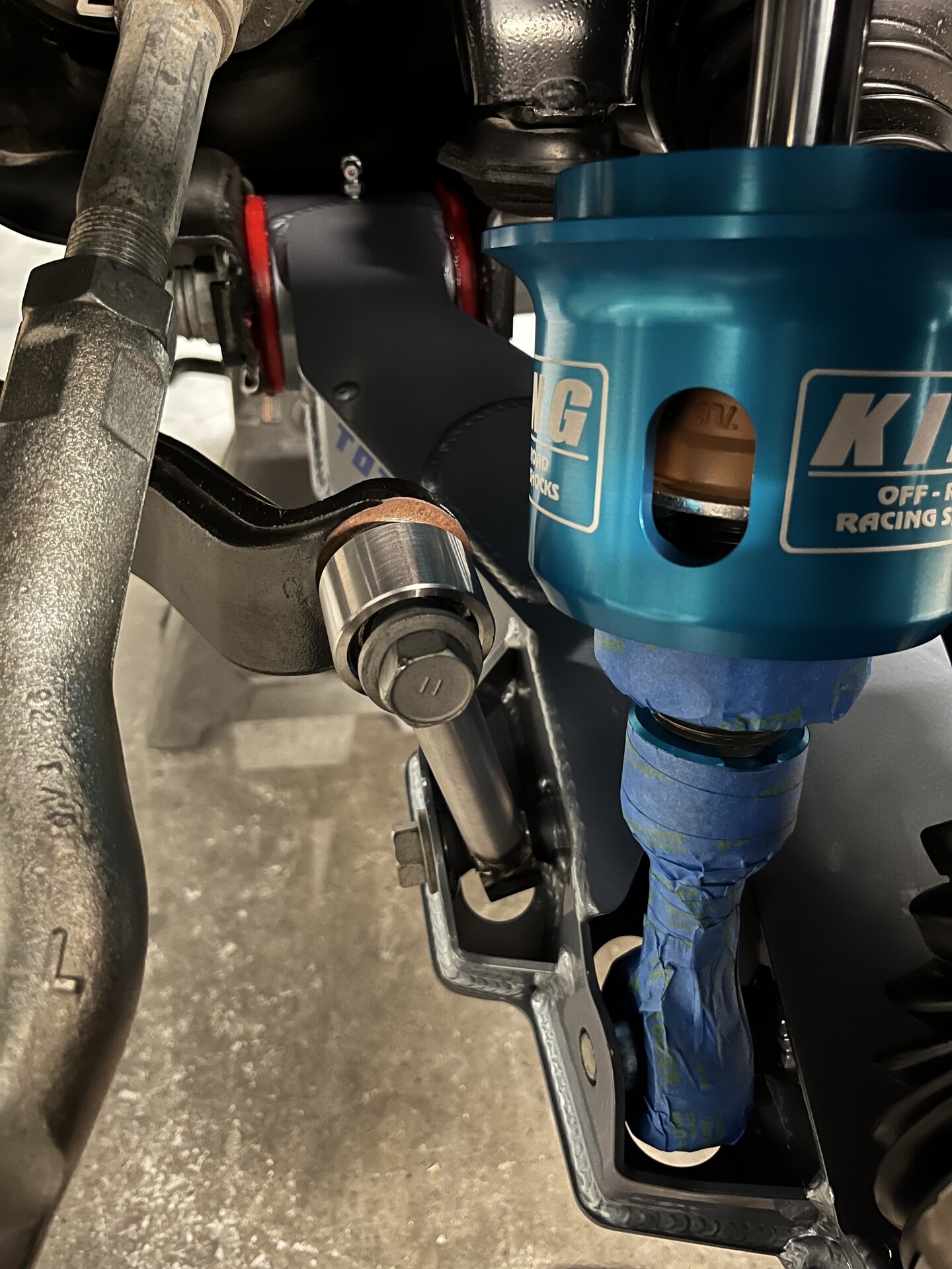

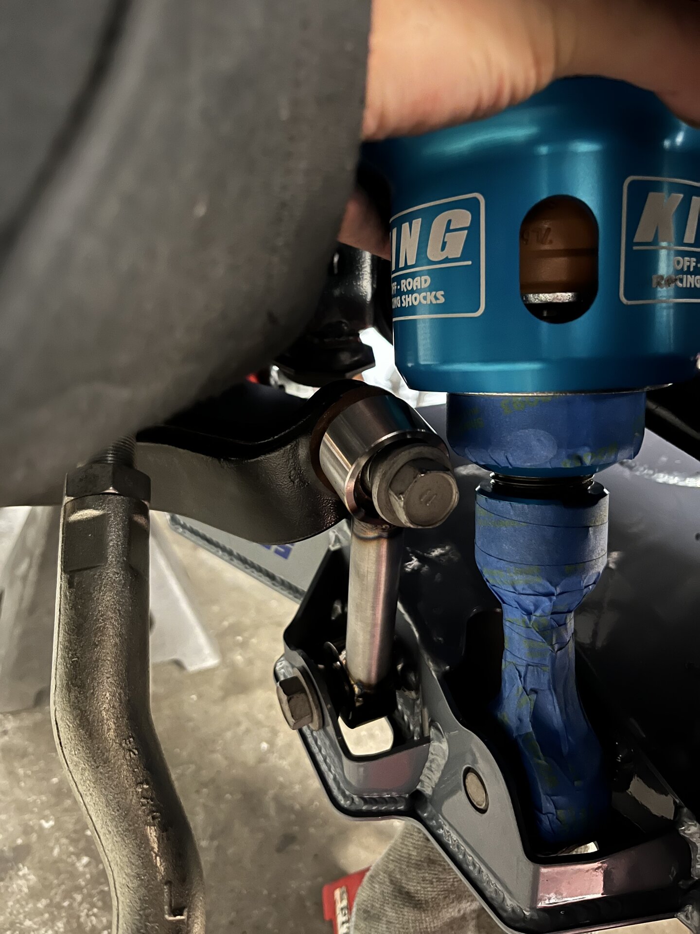

Tig welded up some chromoly end links. First run to get in rolling. Everything clears. But I think I’m going to explore some brackets to offset the endlinks. With how the kdss sway bar being so different on passenger side vs driver side. I have to run one end link on the inside ( passenger side ) and one on the outside ( driver side ). I know it will function the same but I hate how it’s not uniformed.
I know Walt at TAV as some offset bracket to allow the endlinks to sit on inside of the sway bar. I need to call him to see if it they are available! I wanted to make endlinks so it can work with guys not running the TC arms and be used on oem tundra arms.

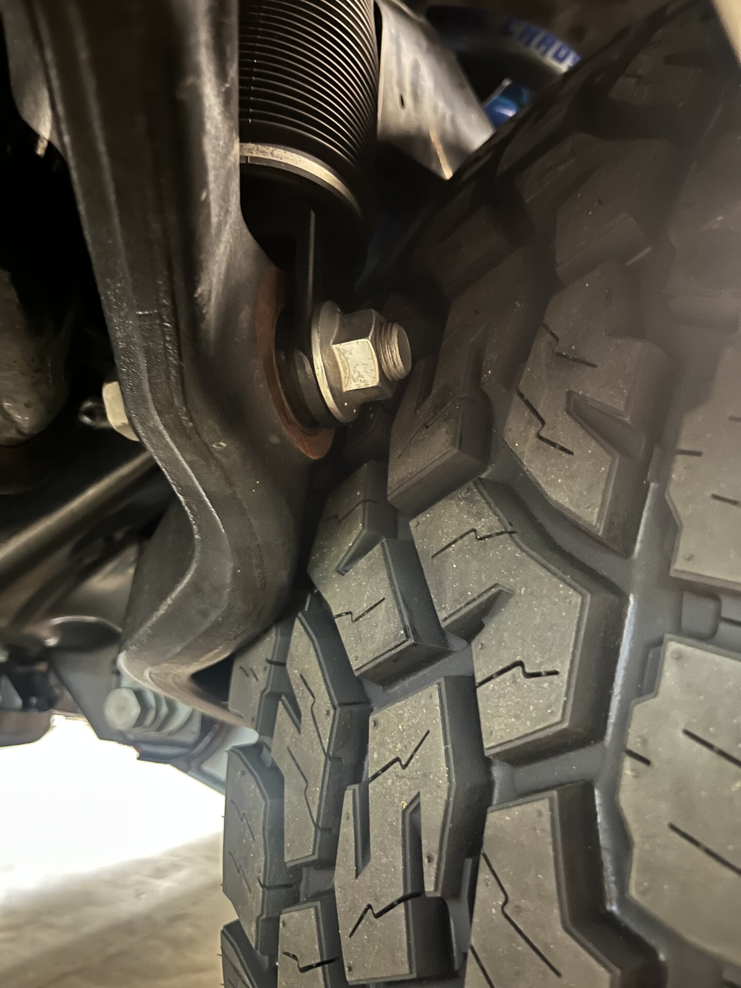

Yea it clears. It gets close at ride height but fully clears.

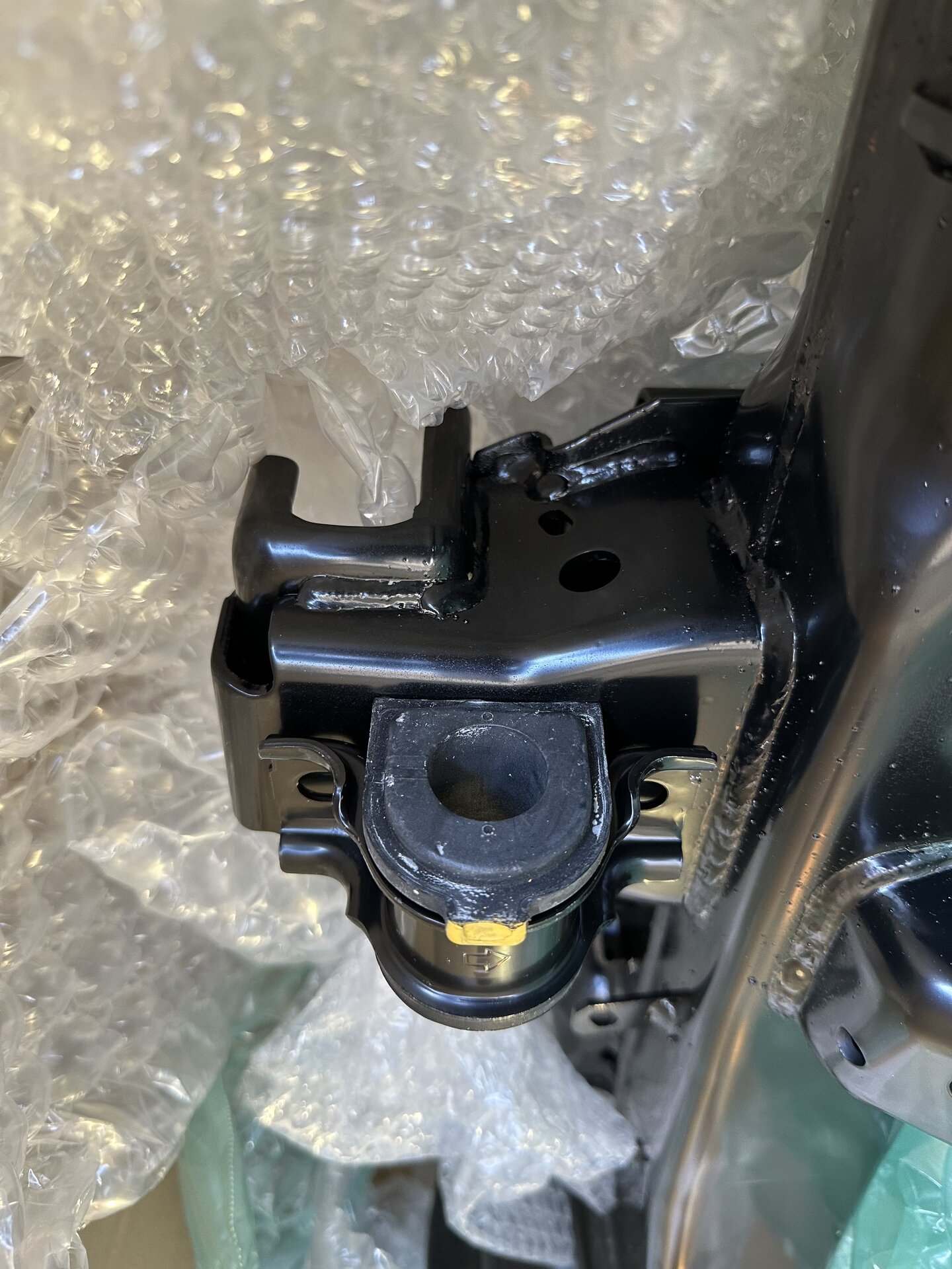

Ok for the front sway bar. Did I see or read about some one makes a higher clearance sway bar arm for this side ?
Been off fourm for a while. The camburg arms sits under the spindle cradle vs oem is on top of the cradle.. thus the lower shock mount is lower than oem wich allows full compression of shock while still needing to extend bump stops.( this does sacrifice ground clearance which is kind of important for a crawler)The arms are +4 per side and I'm running +0 offset. 12in of travel at last che k but I have since cut the front wheel arch to accept full compression lock to lock with zero rubbing. I'm assuming I'm at about 13in of travel now
Ok so I did read through that and even left a comment. I can’t seem to find this higher clearance kdss sway bar arm. Ppl talking about an oem modified one ! Or I’m definitely blind 😆🤦🏻‍♂️
I don’t think anyone is manufacturing them. VooDoo2 sounded like he’s fabbing to suit. It’s a bummer it hasn’t caught on yet.
Well s***. I guess I’ll do it then.

I get my lc200 back today. I also picked up a brand new rear axle housing to make easier for me to develop the BOTCK ( bolt on trac bar correction kit).

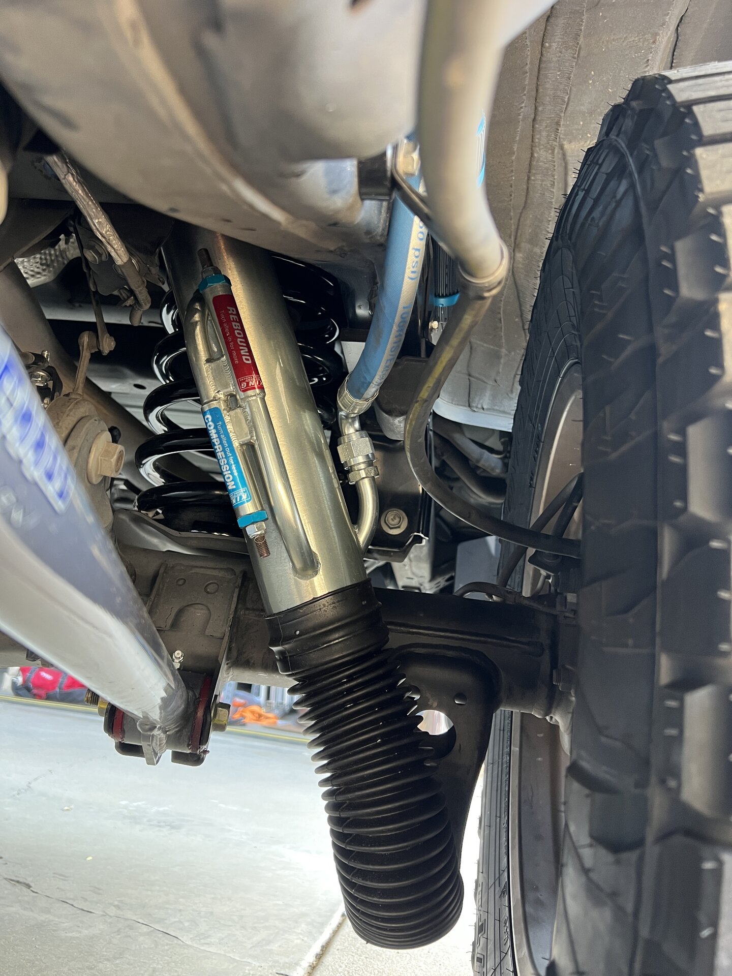

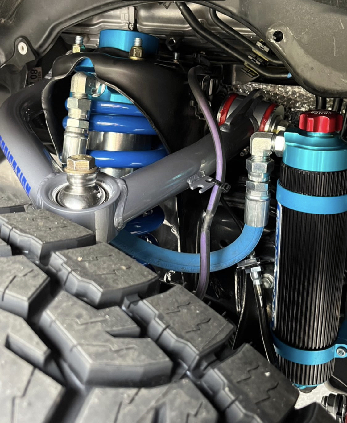

Rear shocks. I didn’t want to mount it under the door ( where king designed it )
Looking very mad scientist in there. I cant imagine how you torqued down that UCA through bolt. Did you do it loaded wheels down or have you got some trick im not aware of? Maybe you pieced it together like a puzzle with the resi last?
Yes resi was put on after torquing down the inner pivots.
