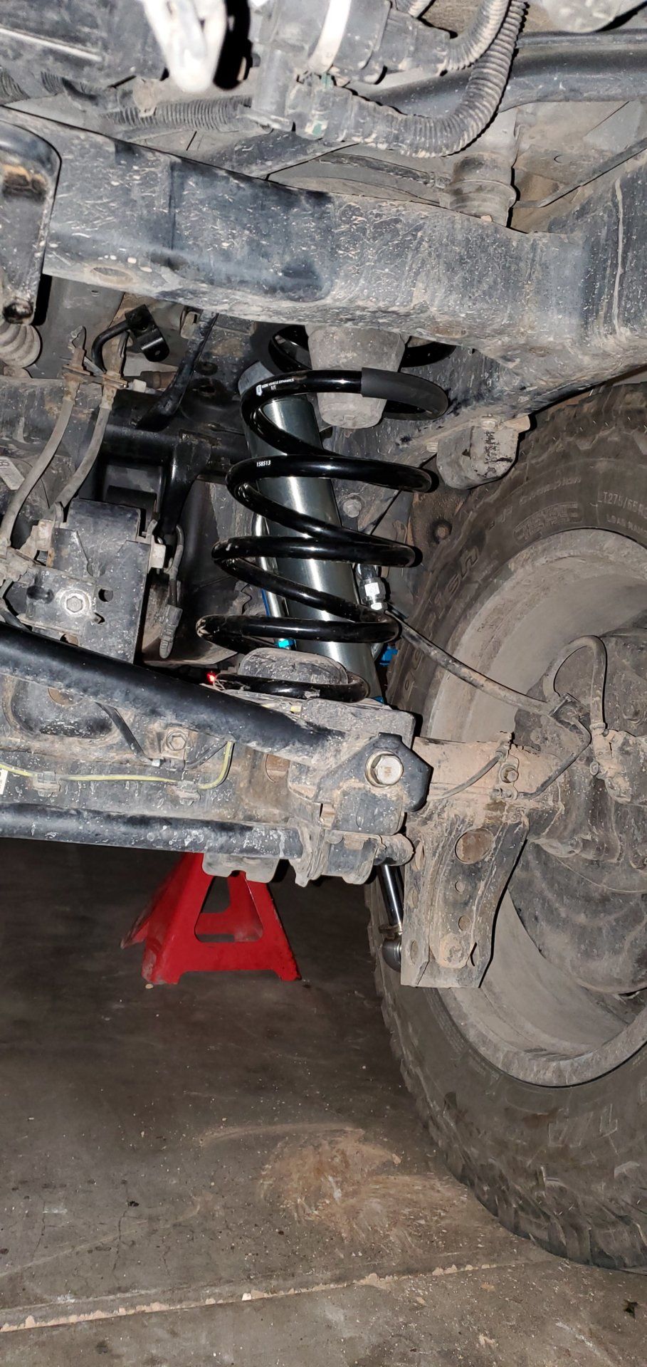

Disabling the AHC and AVS systems, no warning lights.
Stock travel is about 9-10" with the kings 11-12"

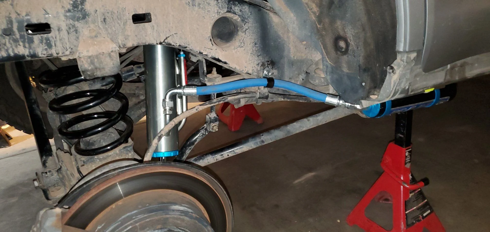

Man, the rear shocks suck to remove. To make it easier, drop the spare tire and remove the exhaust pipe from the muffler back.
I needed a 28" breaker bar to get the top nut off of the driver side rear shock.
I just need to install one rear shock, chop off the running boards and get an alignment and this should be road worthy.
I have some 2" longer brake lines and a dobinsons diff drop on order.
This is all very, very exciting.

You really just need springs and shocks.

Tundra parts are not necessary, LC parts will be direct replacement.
I'm using front components from a Tundra because they are wider than LC/LX parts.
The LX suspension system is really good, I would not recommend replacing it with a cheap lift system.
I wouldn't do less than TC UCA's and King's, I like the AHC system but when you do the fixed AHC High mod you lose travel and I'd like the option of deleting it to run something adjustable. I had planned to unload the LX in favor of a LC in a few years for this very reason.
Took it for a test drive tonight! I need to cut out the remaining hardlines and other components as they are rattling.
No warning lights😊
