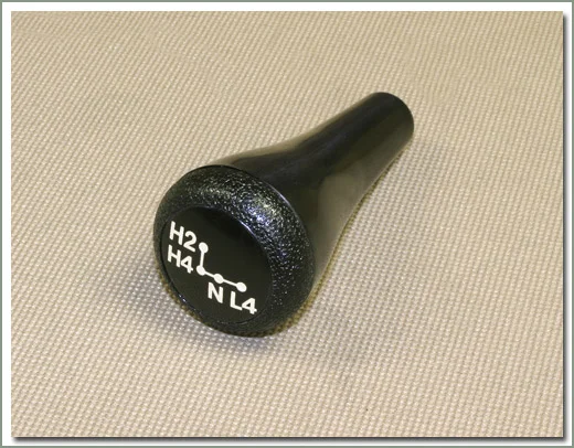

Tim, it's also possible that you have some slop in the shifter. It's quite common. Typically, a US version transfer case shift pattern would look like this if it's on the floor. Can you upload some photos?

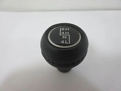

Definitely not a US version stock 1971 FJ-40. (very nice looking though). It appears from the dash photo that the transfer case shift pattern is the same as the knob photo I uploaded. With the transmission in neutral, the transfer case would shift from 2Hi to 4Hi moving the lever front to back. Pushing the lever from 4Hi to N - 4Lo is a push to the right. The knob photo doesn't look right for the year, but not knowing the vehicles history, it may just be a knob added by the PO.
When I get home I will try the pattern on the glove box and see if that works. If so, I will be ordering a new knob...

When I got home I tried the pattern on the glove box and all went well. I had to fish around a little left and right on the stick to find neutral, but I did. Thanks for all if the help. I'm new to FJs and feeling my way around.
