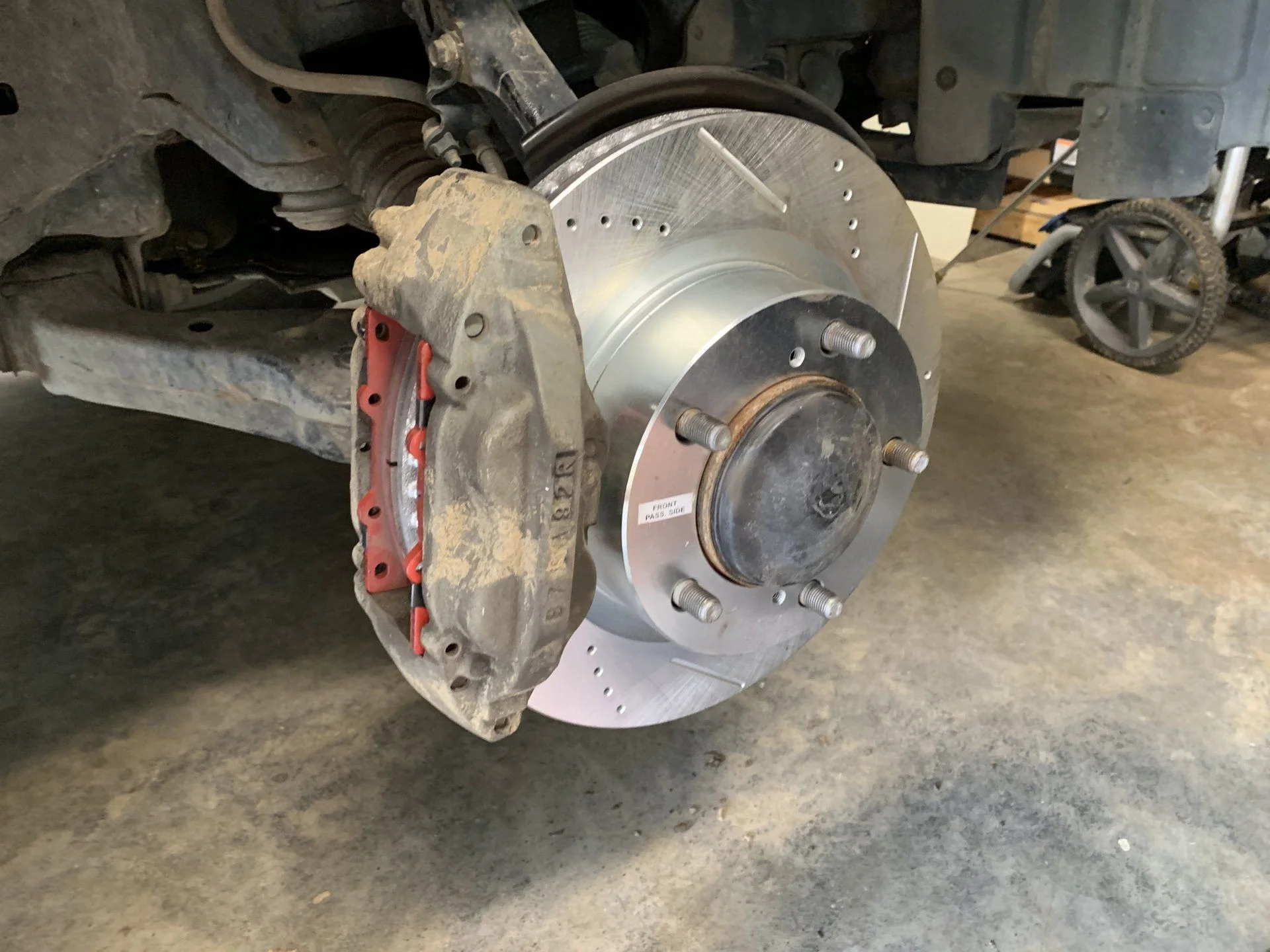

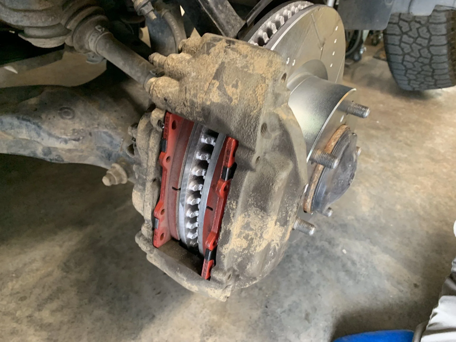

I replaced (actually my buddy did while I watched and drank beer) my pads and rotors last night. I replaced them with TRD pads, that I picked up on the one day TRD 40th anniversary sale a couple weeks ago. I only mention that because I know some people will want to know why I went the TRD pads. While we are on the subject of "why", the reason I went with the rotors is because of reputation and "bang for buck" that Stoptech usually offers.
TRD Rear Pads Part Number = PTR090C110 and I paid $90, Amazon has them for $100 shipped
TRD Front Pads Part Number = PTR090C111 and I paid $90, Amazon has them for $103 shipped
StopTech Rear Rotors Part Number = JBR1355XPR, $141 shipped at Amazon
StopTech Front Rotors Part Number = JBR1312XPR, $151 shipped at Amazon
So for right around $500 shipped, I feel like this is a great deal! I couldn't find anything here or on Google with anyone using this combo. I have about 13k miles on the dealership flushed fluid, so I decided to NOT do a flush. Stock brake lines, actually completely stock brake system. I went from...
OEM Rear rotors shot, 3/4mm left but OEM pads were at about 75%
OEM Front rotors had been turned once about 40k miles ago, but still looked like they had decent life left, but OEM pads were at about 10% and squealing.
The difference in braking is by far the largest difference in braking I've ever felt on any vehicle I've ever owned (Acuras, Audis, VW, Subaru, and Chevys) going from OEM components to Performance aftermarket (yes I'm aware TRD is OEM but you know what I mean) brake pads/rotors. The pedal feel is perfect now, the initial bite comes on almost instantly instead of almost half way depressed like it was. The amount of effort I have to place on the pedal has gone from a decent amount (my wife said it would make her legs sore!), to almost nothing, and the stopping power now is just ridiculously good. In fact I'm shocked a vehicle this large can stop this well now.

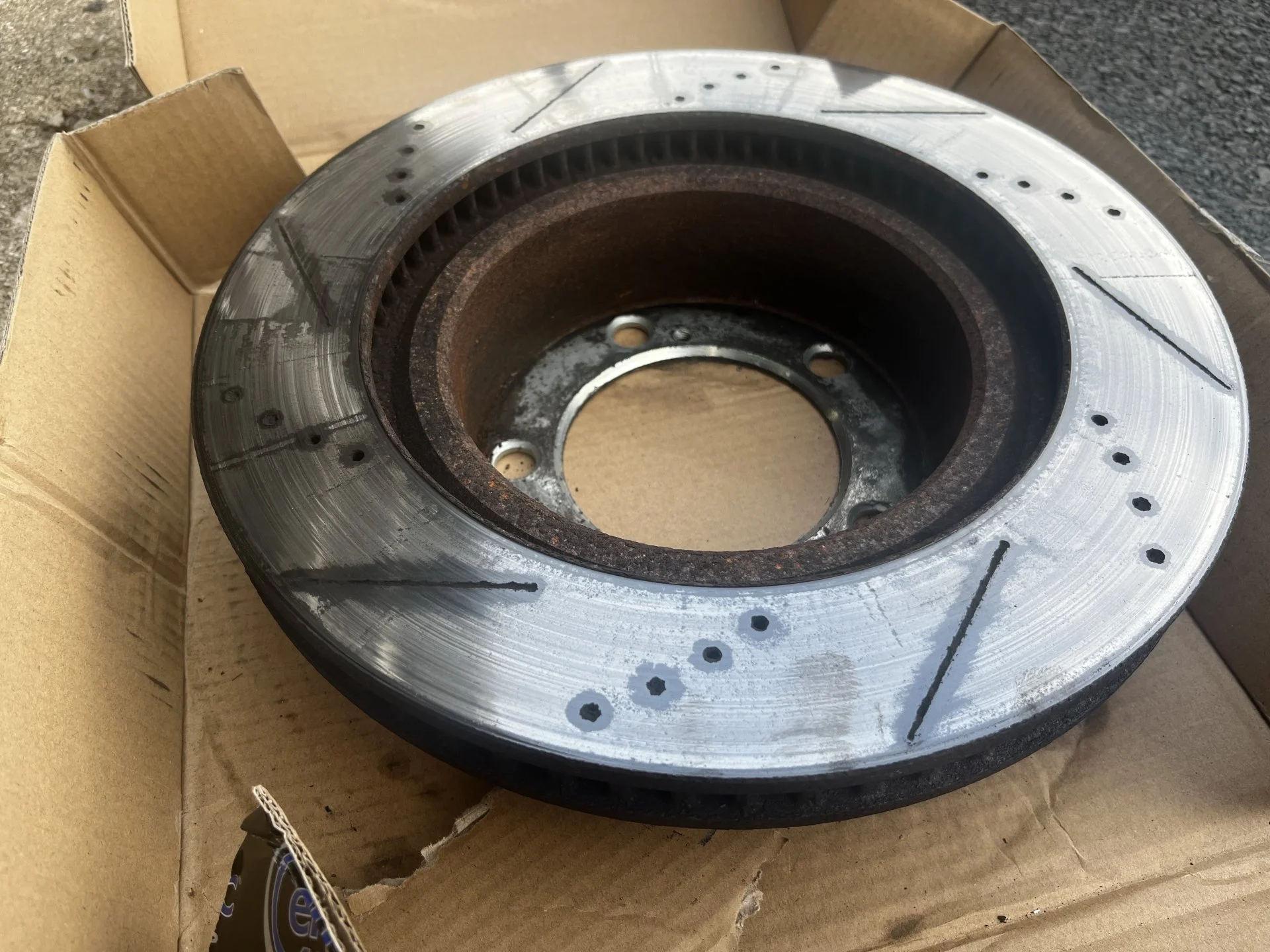

Fantastic post, I did this exact thing and the braking feel is WAY better. The ONLY feedback I'd add is that in the salt belt the salt got a hold of the drill holes in the drilled rotors this winter. Somehow that was a foothold for corrosion and you can still see it, even after a summer of braking, around those holes. Also vibrations through the brake pedal now as well. So, absolutely glorious modification but in the rust belt maybe use regular rotors.
So some long term follow up on here- these slotted and drilled rotors do not work in the rust belt. Just swapped these out for solid rotors and standard pads and it's like a dream in comparison to the grabby pulsating combo of salted drilled/slotted rotors and the TRD pads, good riddance. See the photo below. You can see how the corrosion spreads out causing really lumpy pad deposits, so annoying.
Appreciate the feedback. Too many new to this are attracted by the race inspired features. And at least on most non-race pedigreed brands, is just cosmetic features that create opportunities issues.
