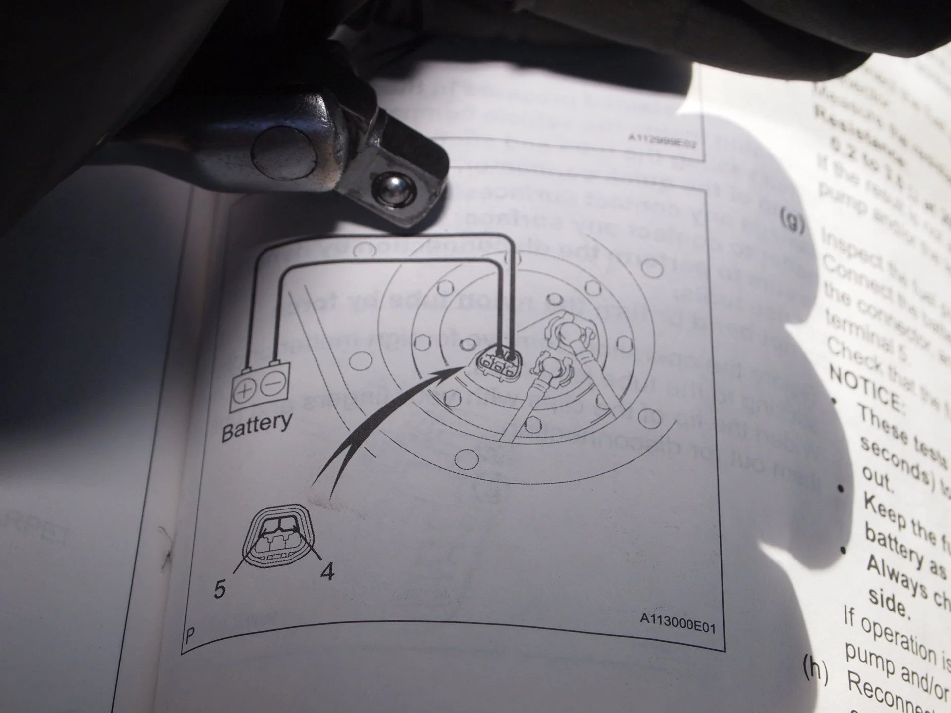

I think toyota uses that FSM procedure for a function test. Because obviously polarity is reversed in there. I don't know why toyota would think that's a good thing. Maybe for fumes like you said? That would be the reason the give you the ten second rule.
BUT, they are not telling you how to drain the tank, only to test the pump. To use the pump to drain the tank, do not reverse polarity. Maybe this is obvious and doesn't need to be said. But I think people might come away with the idea that the black wire is ground and go about their business without the books. If I'm wrong please say so, but there are no black grounds on a 100 in the wiring book. If in doubt check continuity to ground with each wire. There's your answer.

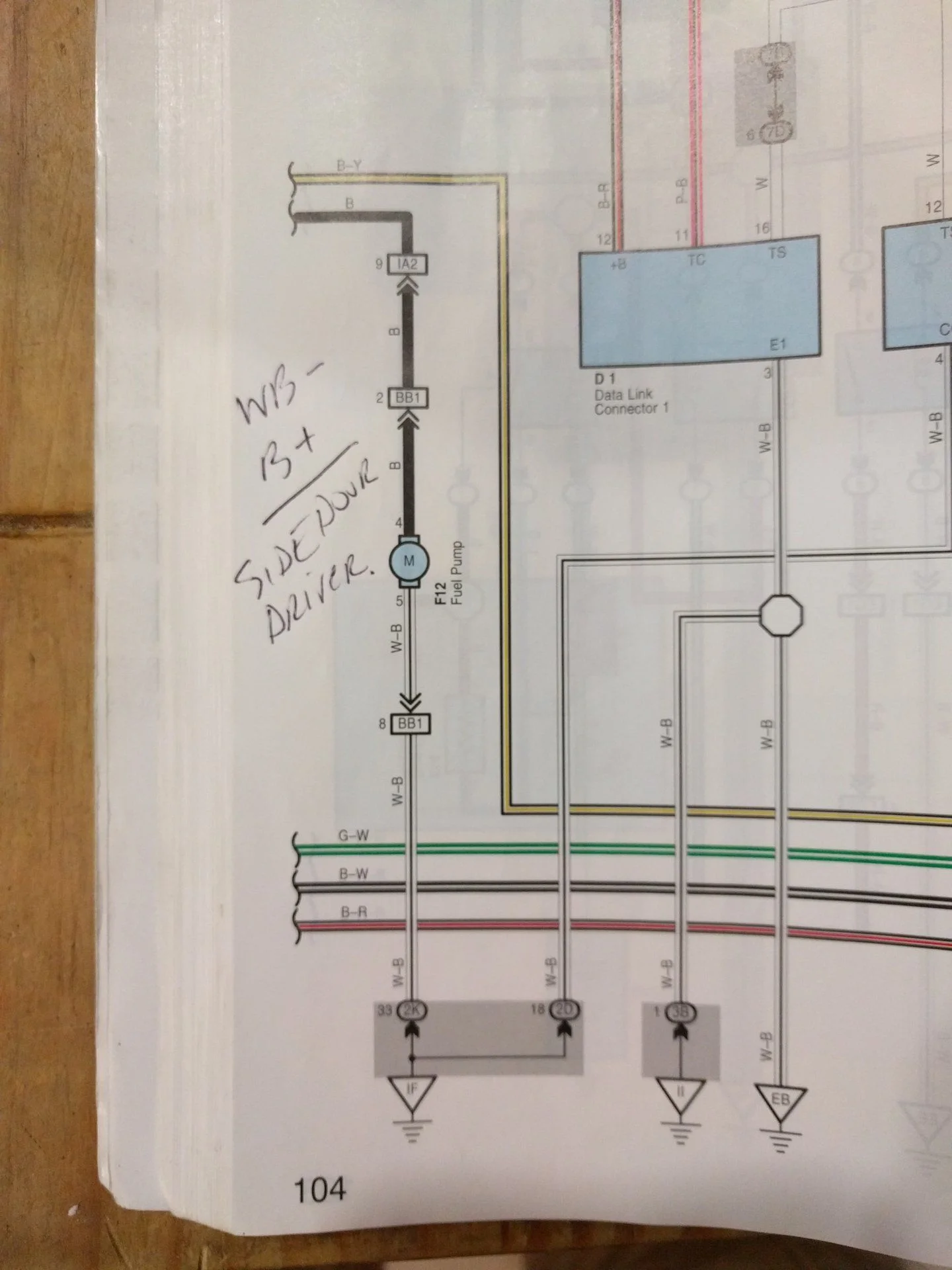

Jerry good point it is a test, FSM doesn't have procedure for draining tank that I could find. I've gone back and edited, also added a wiring diagram from a 2000 FSM, to help clear this up...I HOPE
The only wiring diagram I had is from a 2000, but pump test is same in all years.
So Jerry do you think connecting + to #5 and - to #4 on pump which is reverse of this test. That we can then run pump without fear of damage to it?
@Julian Stead I could use your input here as well.
2000 diagrams
yes I do.
At the same time I also think it's possible to run it reverse, as long as there's no check valve and the fpr lets some by. But most likely will burn out in short order, immersed in fuel or not.

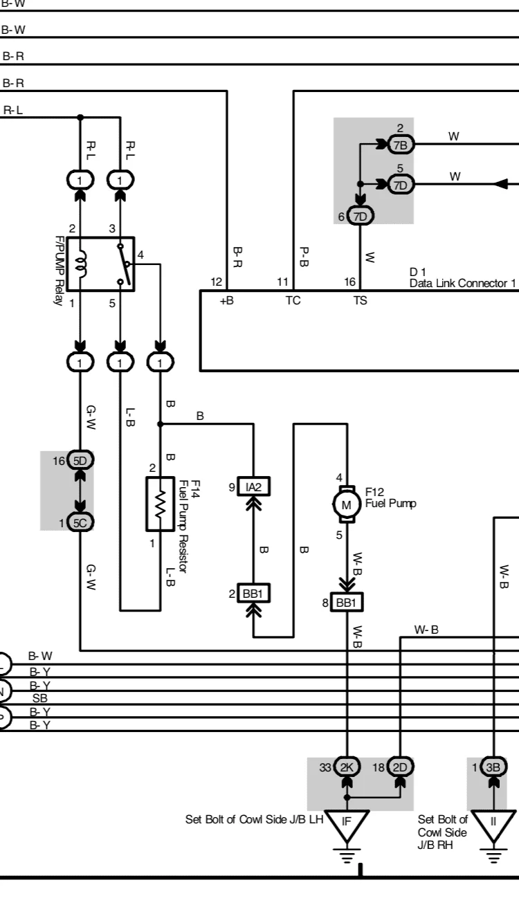

s***, lol. there's another discrepancy, book calls black wire pin 4. This is what happens with too much time to kill.
Go by colors and continuity. Trust, but verify.

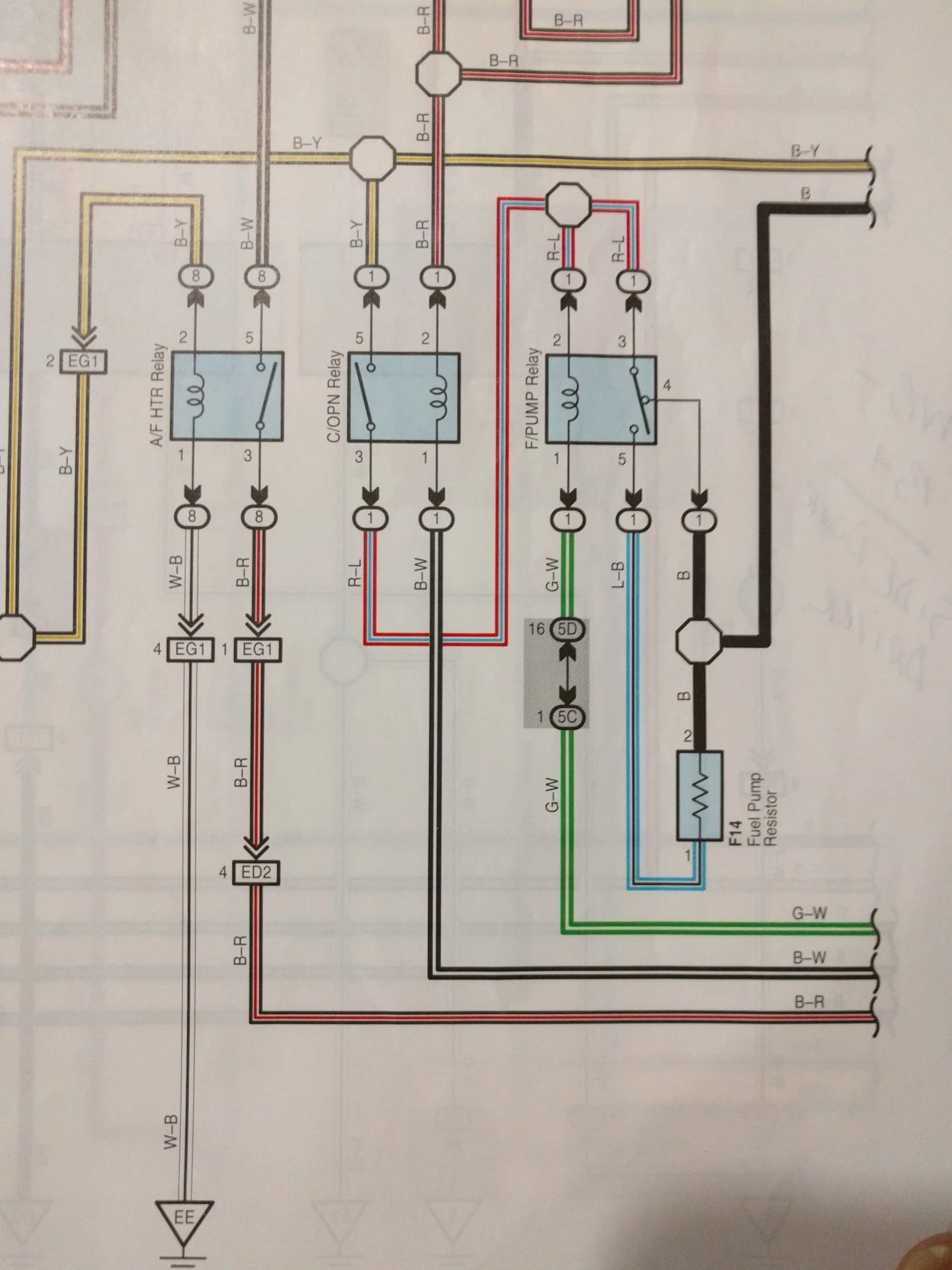

This is the correct wiring diagram, it is the same connections, 4 + and 5 -. It looks like toyota use this pump at two speeds, it either gets a feed through the resistor or direct depending on the relay position.
^ so is the pump running constantly while the engine is running or phasing/pulsing on/off to maintain a certain line pressure? Just wondering.
it runs constantly at two speeds, you can hear it with a non toyota pump.
It would run constantly, the line pressure is regulated at the fuel rail, I am not sure what the two speeds would be for, I guess it either slows it down at idle or speeds it up under full throttle. You can see from the wiring diagram that they certainly use the relay to alter the voltage.
you could also remove the C/OPN relay and add a positive feed to pin 3. It would do the same thing.

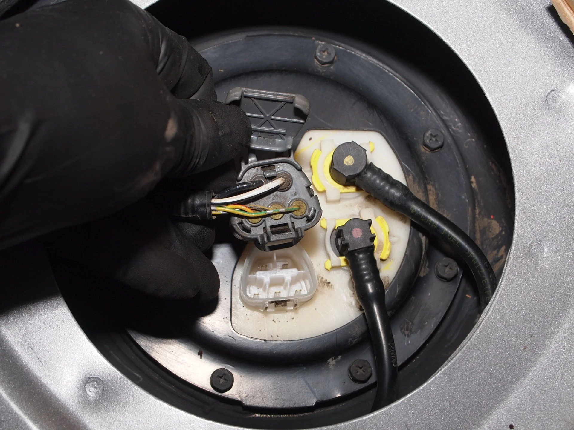

It's a test procedure for fuel pump at pump. I posted FSM page on this, along with pictures of wires at fuel pump and fuel pump disconnect. @jerryb pointed out FSM has us reverse polarity (- battery where black wire is on pump).
I ended up pulling fuel pump out of tank, to drain fuel tank completely. I did this rather than use fuel pump to drain for following reasons:
  • Parked on hill and want to get every drop I could out fuel tank.
  • Concerns with running pump for prolonged period at full speed on low tank (exposed fuel pump). In test FSM no longer than 10 seconds?? Do you know why??
  • Unsure of which pin to jump in fuse box.
  • Concern with shorting while jumping from battery in fuse box, damaging box, wiring or pump.
  • Concern with creating a spark inch away from where I'd tap fuel line at fuel filter. (gasoline fumes under hood from disconnecting)
I was think it may be safer to jump at fuel disconnect under passenger door, and tap at fuel filter quick disconnect. Although jumping at fuse box is easiest access.
If you could post picture here of how to jump pump the ways you've done or like, that would be very cool. Feel free to use any pictures I've posted or ask for ones you'd like for editing, and I'll post them for you use!.

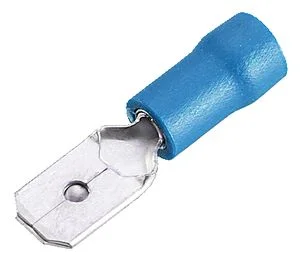

Match pin 4 or 5 from the relay to the slot on the fuse box, use a spade connector the correct size to push into the slot, again I have a tool, a probe tester that connects to the battery and with a flick of a switch I can give a positive or negative from the battery to the probe tip, I would then put the probe into the spade connector, flick the switch to positive and this sends the voltage from the fusebox down to the pump. You could make a lead with a inline switch and fuse to achieve the same thing, just clamp it on the positive side of the battery.
