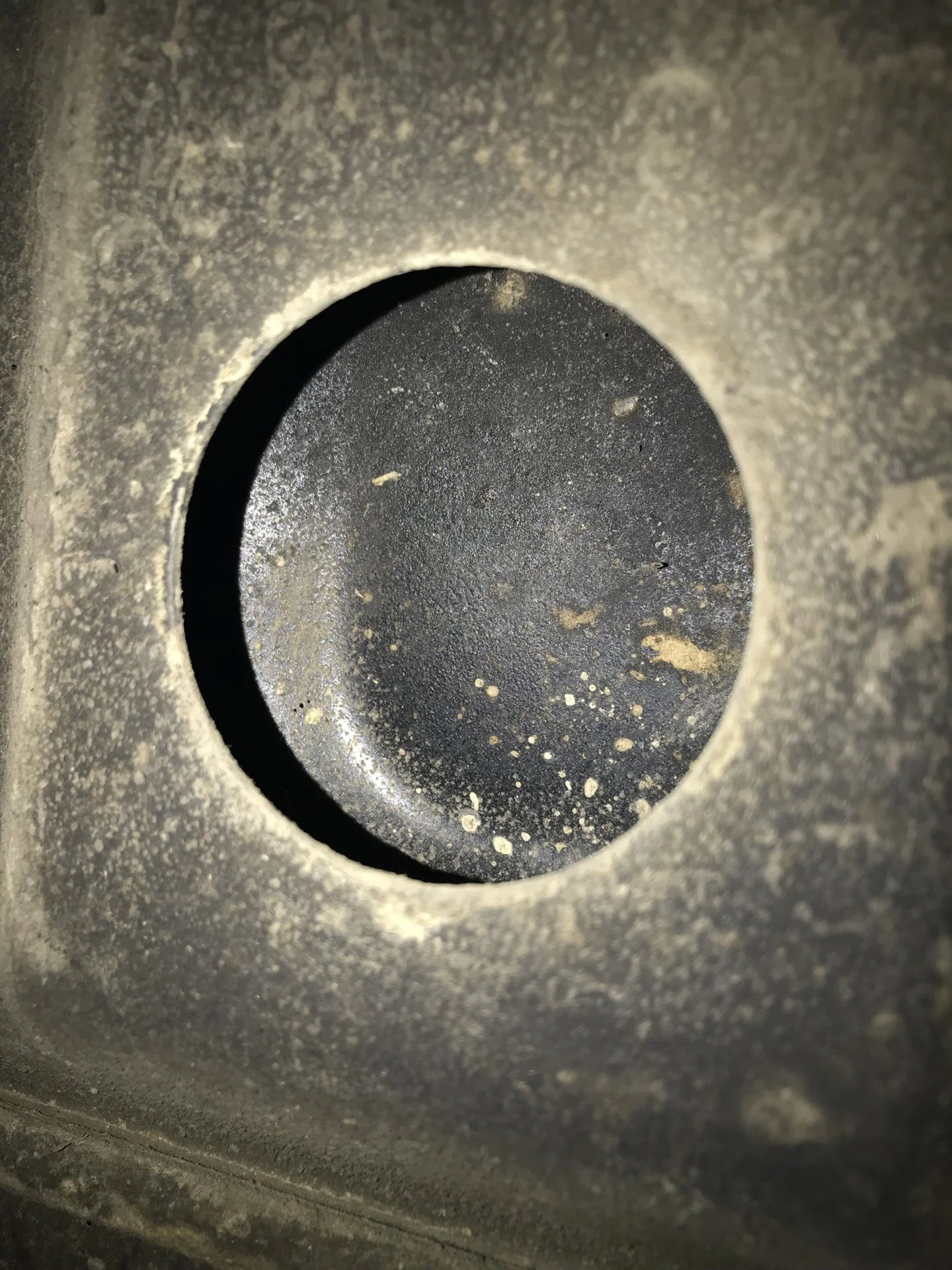

The 00 LX & 01 LC FSM shows a fuel tank drain plug.
My ‘98 does not have a drain plug.
This reply got my curiosity up... so I went and looked at my 99 LX470. NO drain plug there either.
So now this has me thinking, did the diesels all have drain plugs and they decided to delete it for the petrol versions, or at least the NAS market?
Do the diesels and petrol models use the same fuel tank?
My 99 LC has no drain plug either, looked at factory repair manual that shows a drain plug but couldn't find it had me scratching my head!!
I think Toyota knew how many tweakers we have in the USA and didn’t want to give them an easier way to steal gas. (They’d probably drill the tank anyway however)
On a serious note I talked to my Toyota mechanic friend, he said he has never seen a drain plug on a Toyota.
As I mentioned earlier that's what my parts' guy said "no Toyota's have fuel tank drains". But 80 series was before his time!
@Trunk Monkey stated his 80 series had a drain also. So my guess is authors of FSM use old digital word doc to write newer FSM. Sometimes they miss changes!
When I bought my 01 LC FSM from Dealer in 2004 they gave a bunch of correction pages, that have sticky edge to insert in FSM books. At some point Toyota turned over publishing to outside company. Then that company stop publishing hard copy. Today only online is available. https://techinfo.toyota.com/techInf...urce_url=https%3A%2F%2Ftechinfo.toyota.com%2F
Be interesting if someone with online access would see if this was corrected.
Online diagram shows the US 100's don't have the drain plug. Rest of the world DOES show the drain plug. However, both have the same part number. Does that answer your question? Not really, huh. o_O

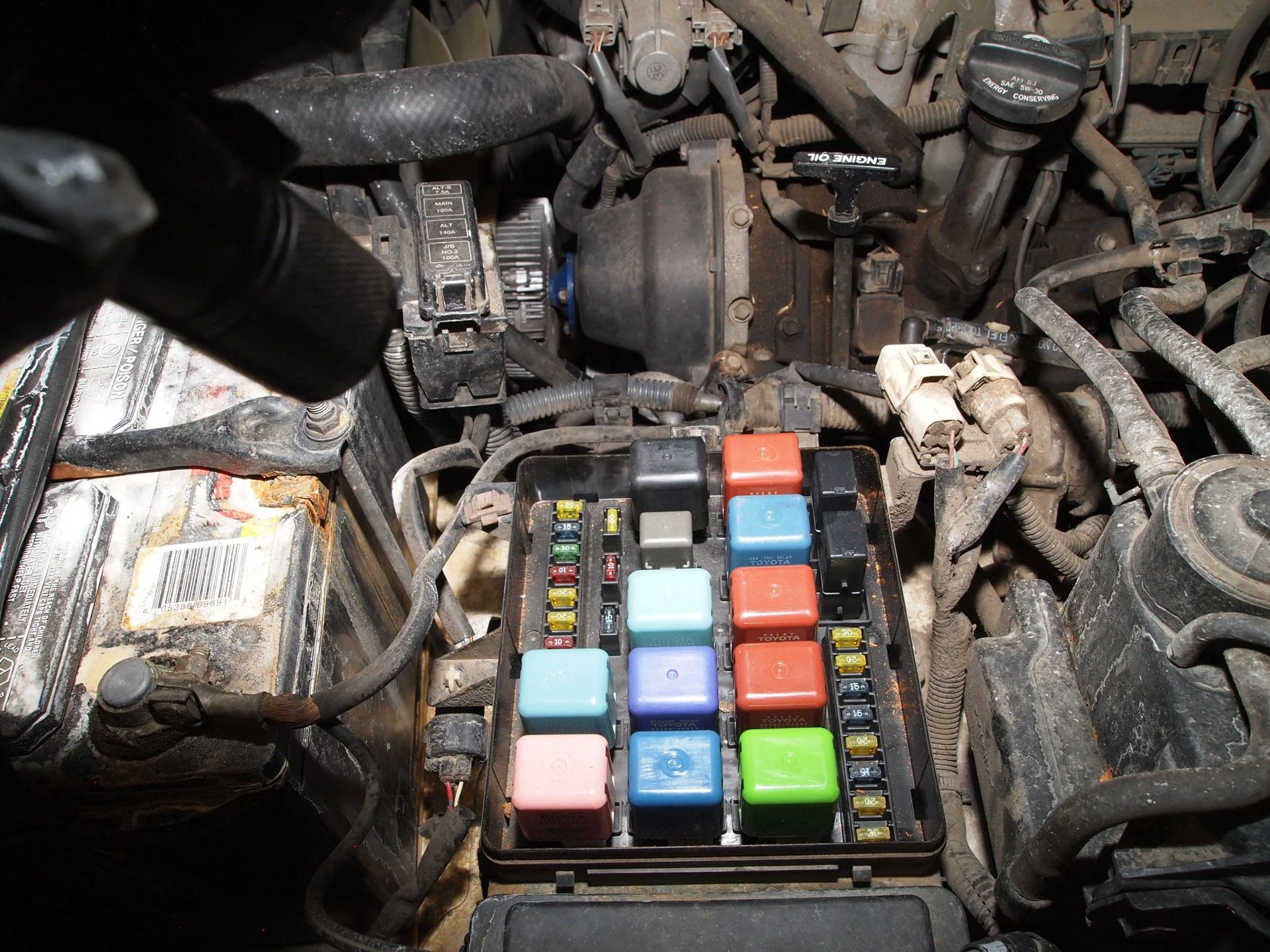

It has been a few months since I did this. The following instructions are based on my limited memory. Also, I did it on 2004.
To operate fuel pump with key ON (engine not cranking)
  1. Remove C/OPN relay from fuse box sits next to battery.
  2. Short pins 3 & 5 (fuse box side)

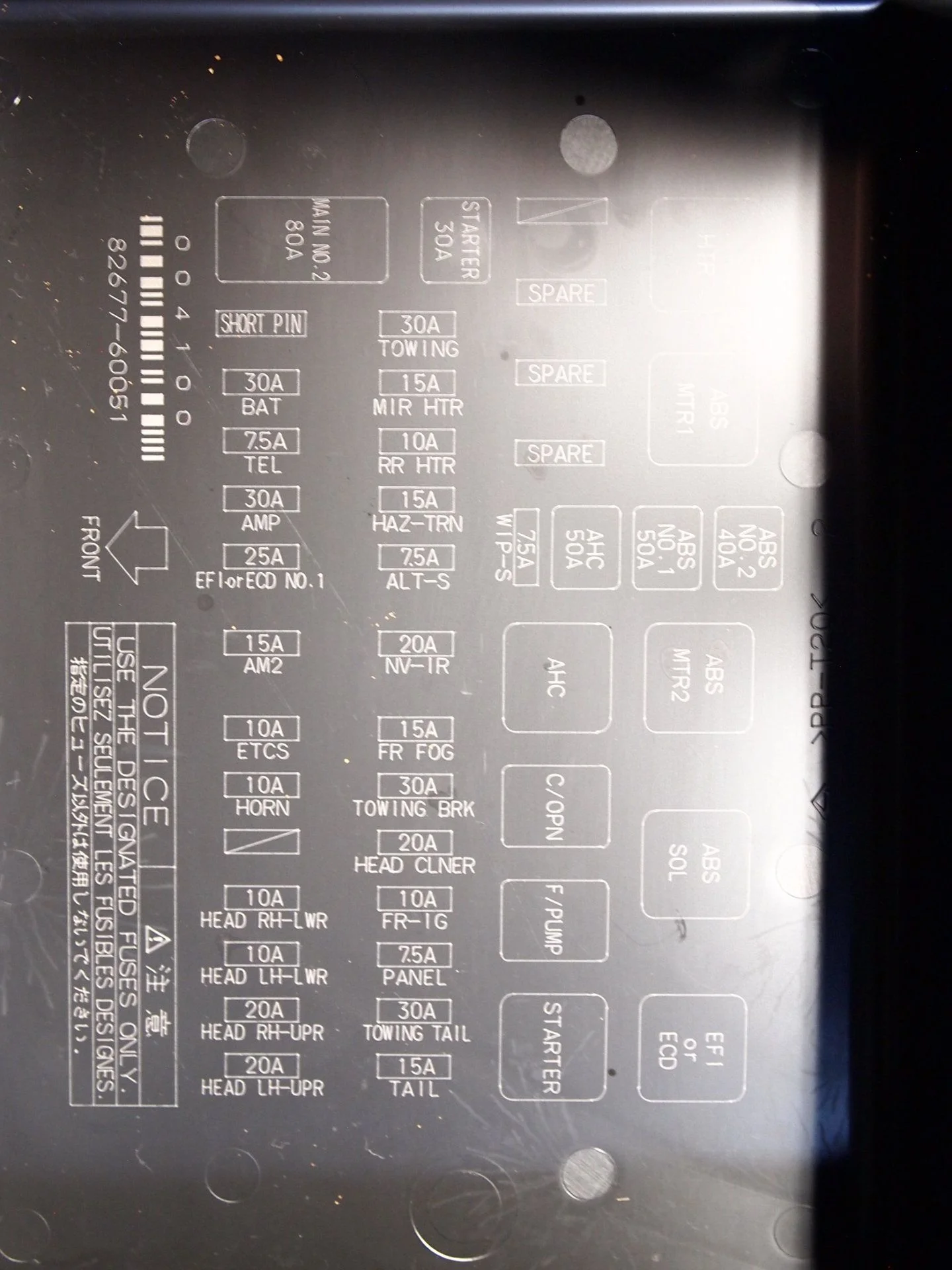

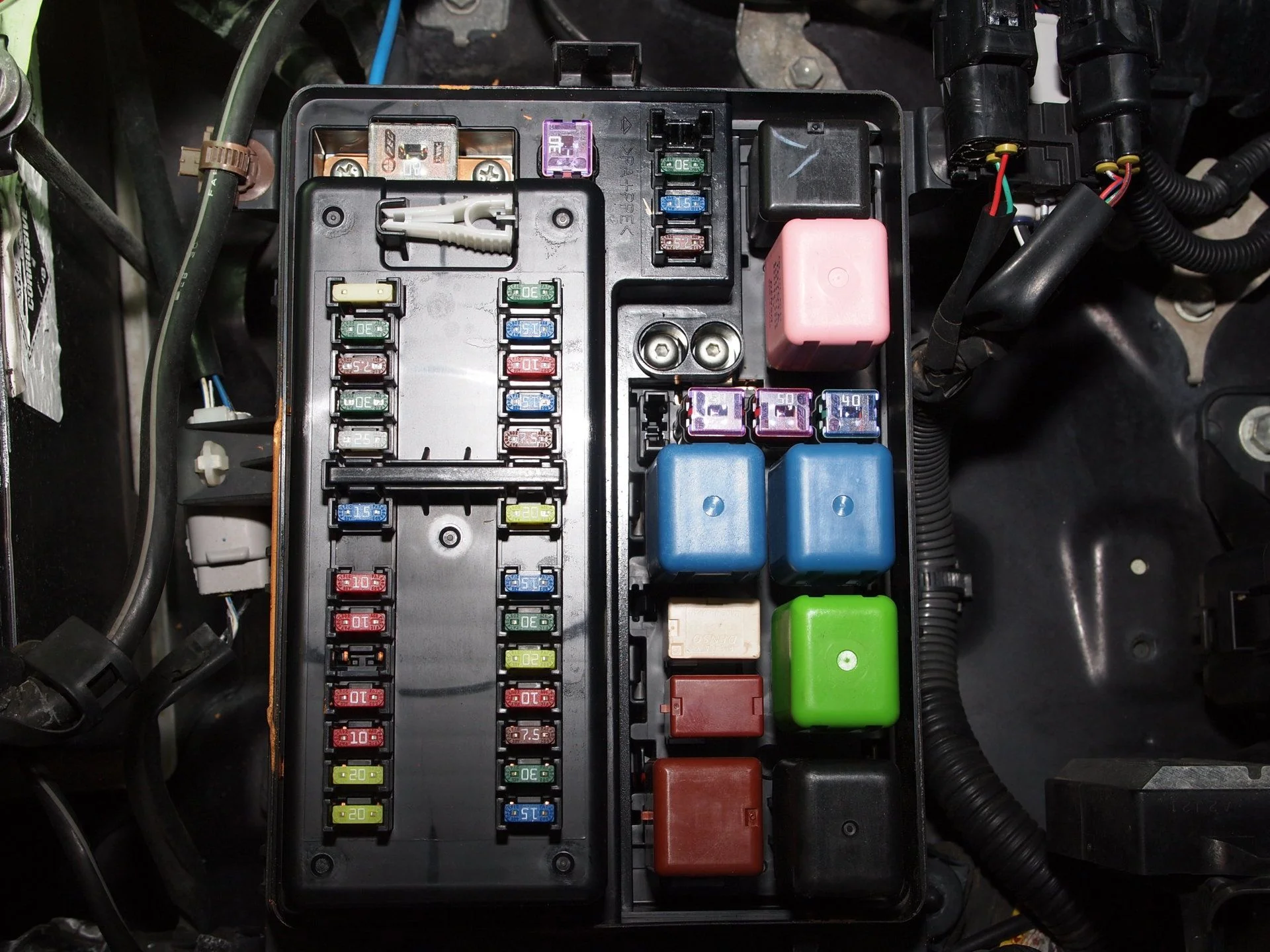

07LC I see the C/OPN on this main fuse box lid.
01LC I don't see the C/OPN on this main fuse box lid

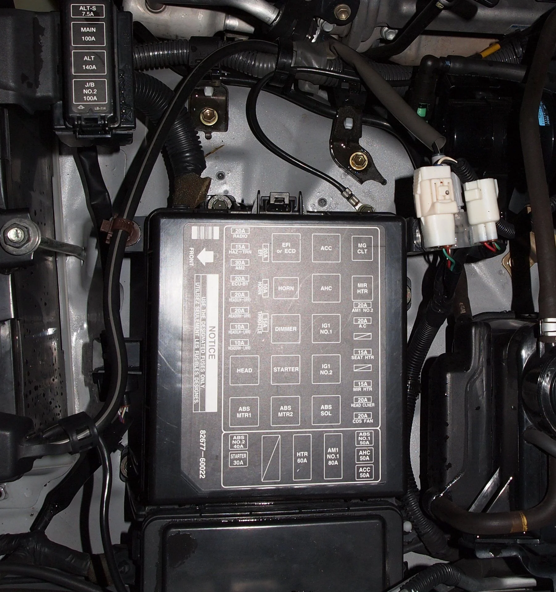

98LX looks to be same as up to 2002 LC or LX

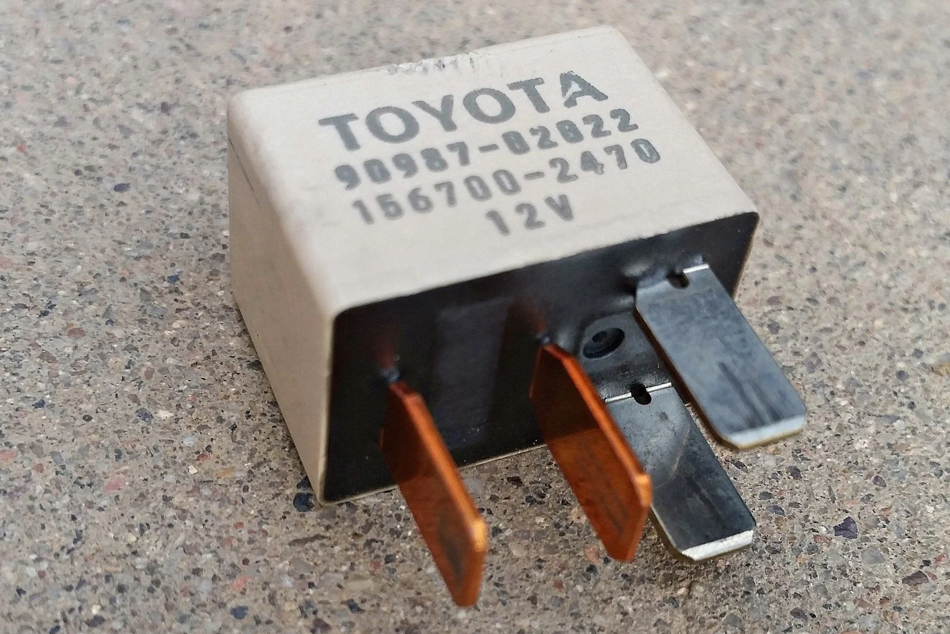

I tried this again recently. The above instructions work.
The 2 golden pins are pins 3 & 5.
