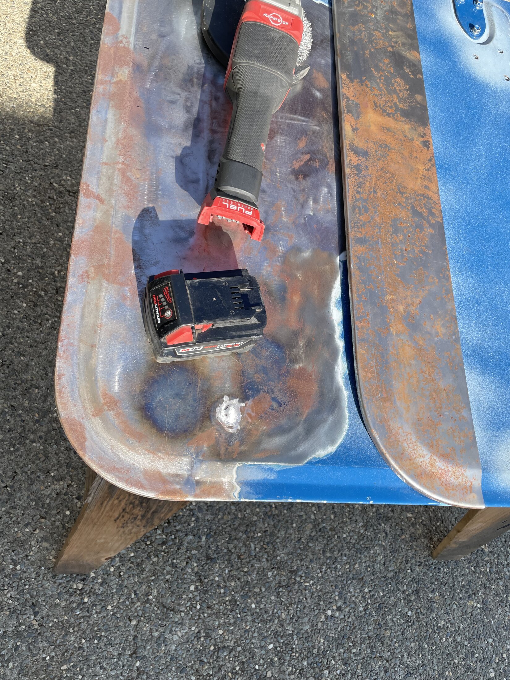

Quick recap. I hired a guy to patch my doors and that was a huge mistake, I was trying to speed up the project, but should have done this myself. Now I'm in the position of trying to fix his work. The door patch came back to me totally flat along the exterior and the original door metal above the patch had a harsh ridge where it attached, the original metal also bent into an oil can shape. I spent about an hour working on this over a month ago (hence the new surface rust); I dramatically improved the ridge along most of the door and lessened the oil can effect. What I really need to know is how much oil canning should the door have? Or should the entire lower half of the door be dead flat. Forgot to take photo horizontally but you will get the idea.

At 6" in, about 3mm deflection:
At 10" in, about 3mm deflection:
At 14", about 4.5mm deflection:
The deflection is also uneven. It is higher than center from the base of the door to the stamped ridge. More pics in a minute...

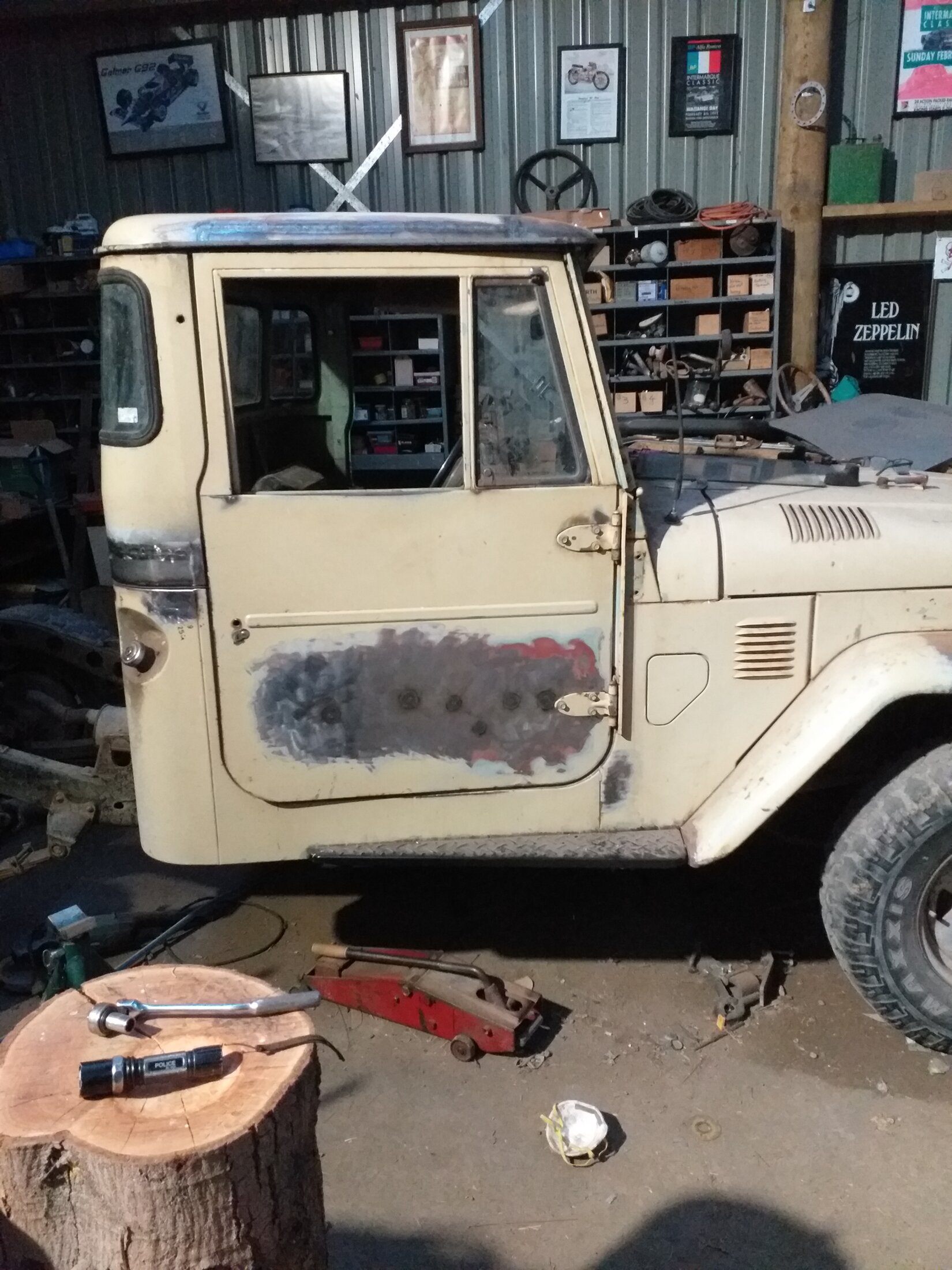

the non hinge side of the door, the patch panel seems off
first pic post 1 the seem doesn't match the door, like the hinge side does
wondering if the patch panel has a deeper raised section the further away from the hinge side to the latch side of the door, which would match the #'s getting higher across the door

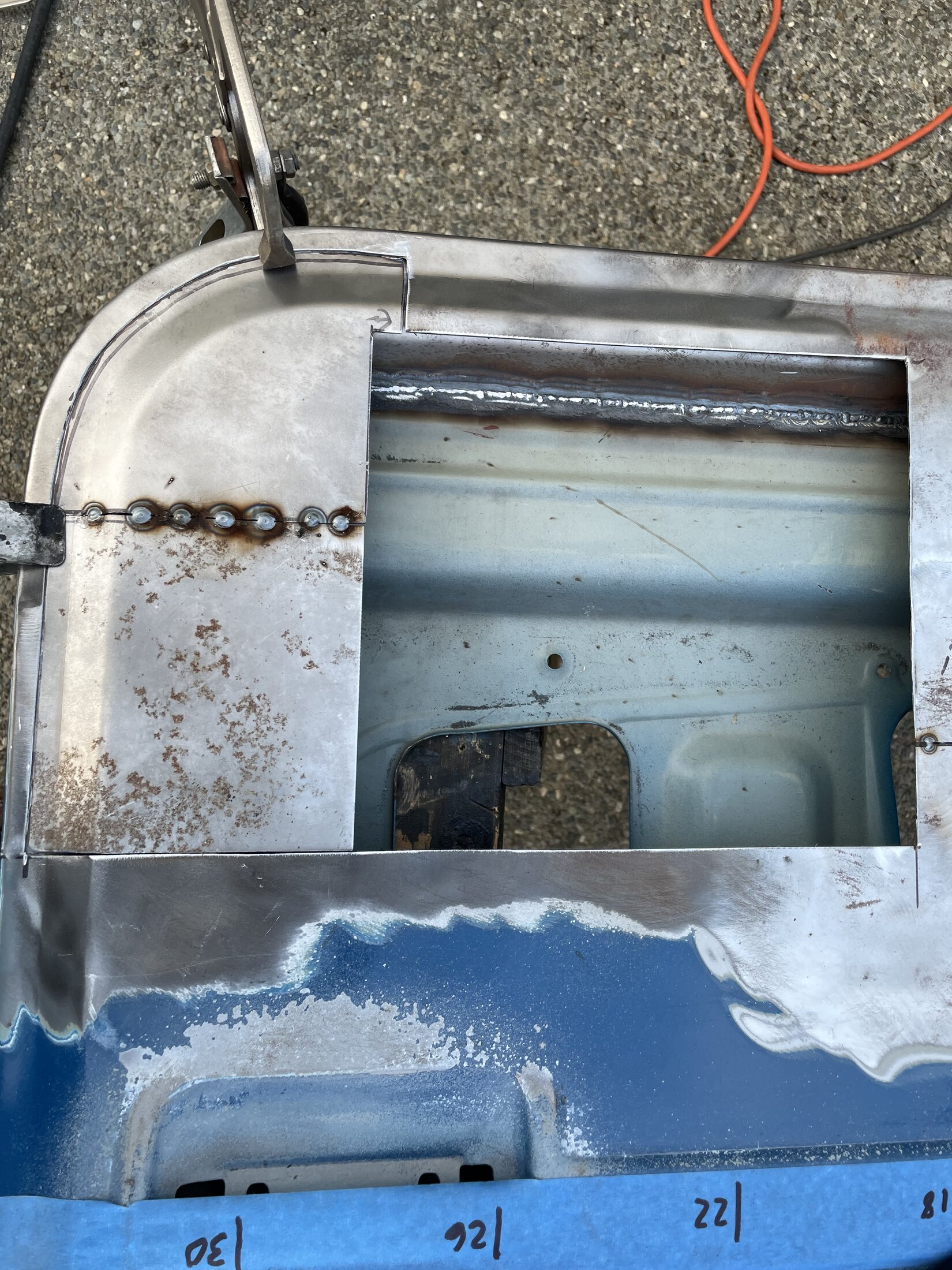

Circling back on this with an update. I set it aside and focused on other work. Good news is the body work and fitment is close to done. Been chatting with the painters. They’re booked out until fall but that’s cool because it gives me time to correct all the garbage stuff I paid someone else to do.
I just couldn’t live with the quality of this work so I’m redoing it. Only had an hour to work on it today but will post up some pics tomorrow when I get back to it. Using an old patch panel…hence the surface rust.
Will try to get the curvature to match the OG passenger side door. Already looks better cutting out that section and mocking this up.

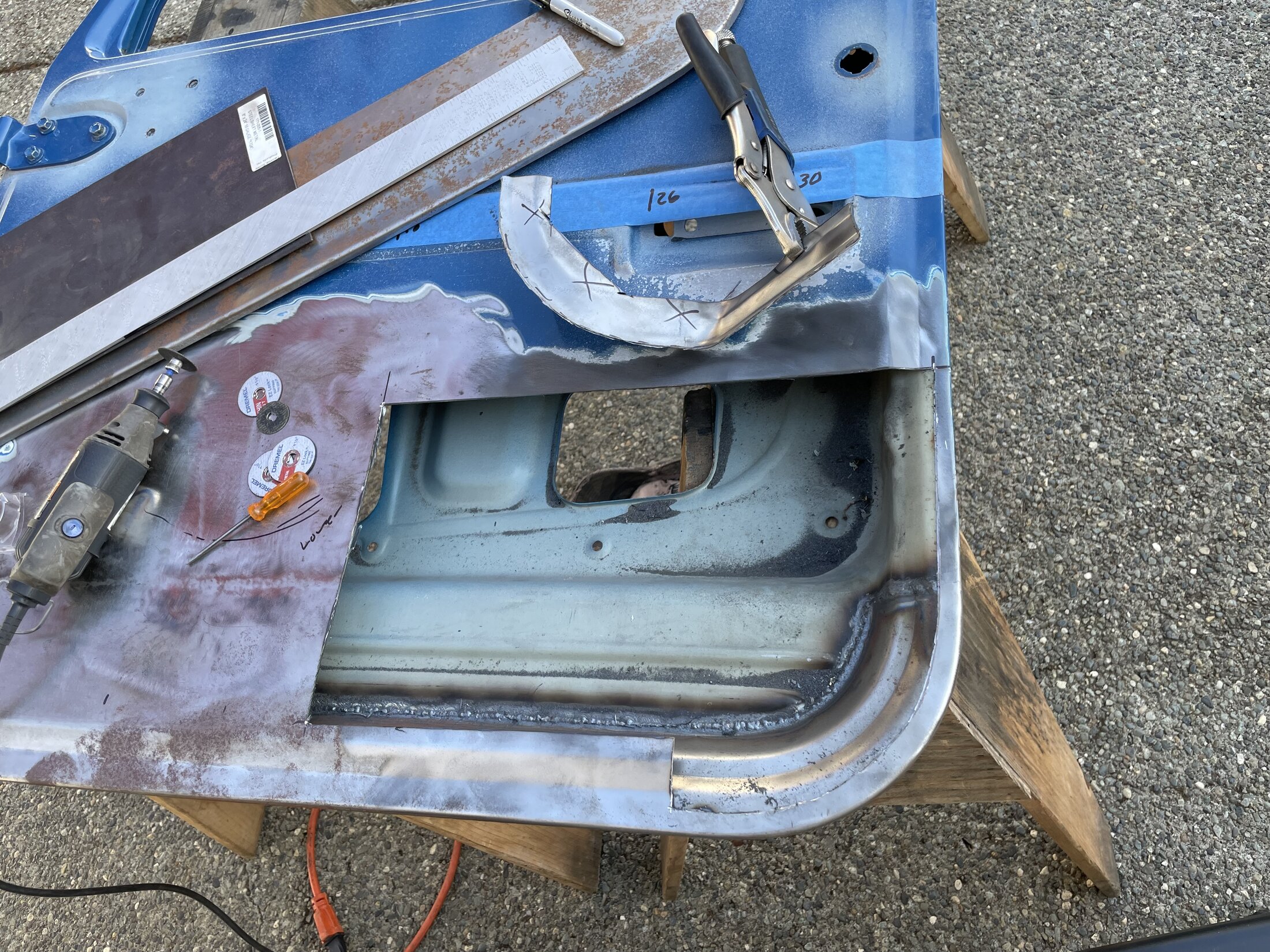

A bit more work today. The hinge side still wants to pop in and out and the recess is way too deep.
So I cut a relief in it then pulled it up and tacked it. This lessened the depth of the concave and now matches the untouched door in how much concave it has, also stopped it from moving.

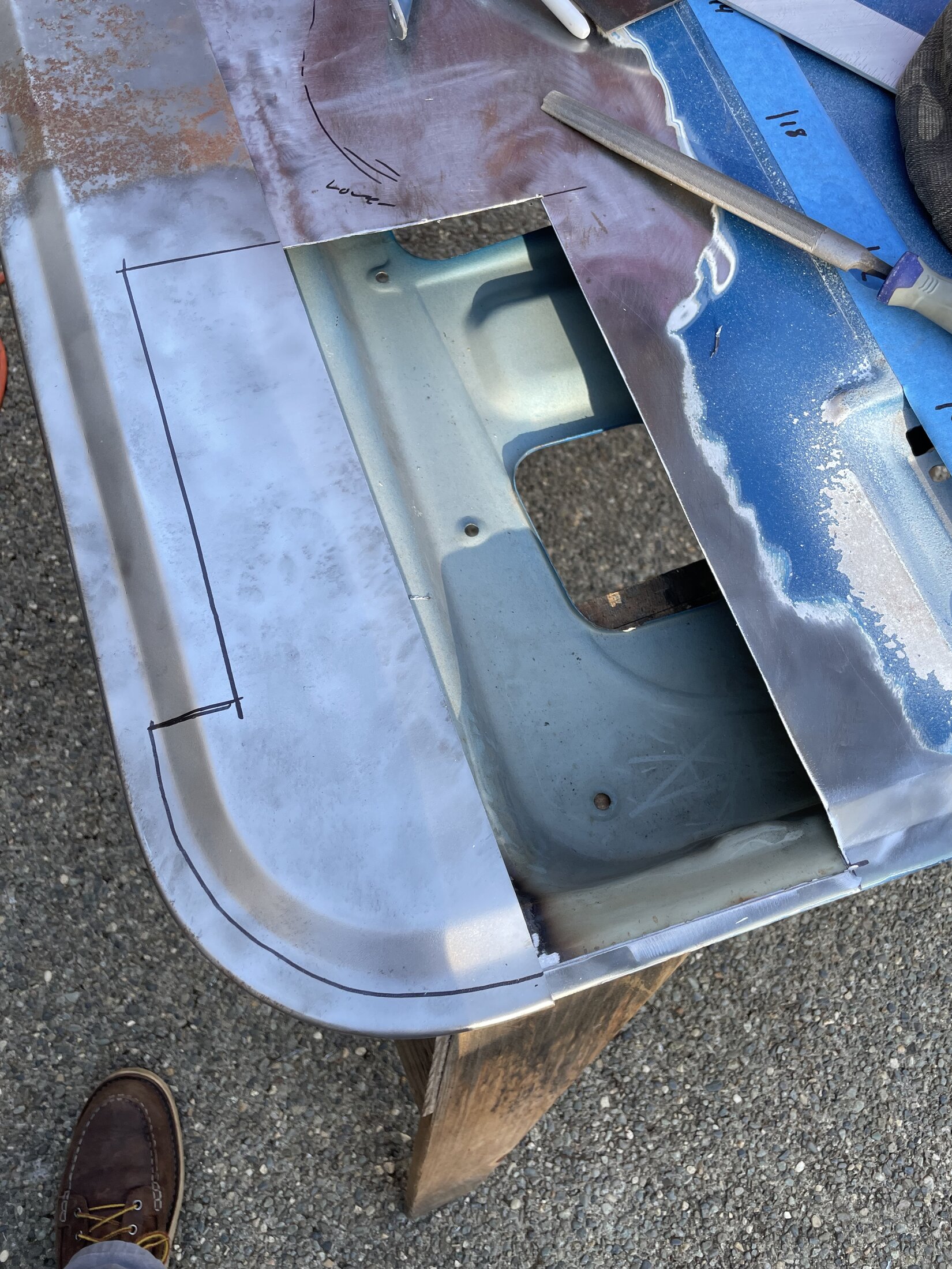

I’m mocking up a patch. Pre-bending it. This is what the Mc Tard didn’t do an why there was a step between the patch and the original door.

Love your truck! A 45 is on the short list for future vehicles. I’m using a torch to heat the area then hammering in a circular pattern just outside the heated area. Had decent success with that method on other panels but not so much on this because the metal is thinner and has much more surface area that’s unsupported. This method of cutting a relief channel, clamping an alignment and tacking it seems to be working. I’ll get back to this in a few days and circle back. Thanks to everyone for your advice!

Be very careful, looks like you're about to weld a dish back into your door skin. The door should be the same profile as that original patch panel - there are 2 issues with that door, the rusty bottom and the stretched skin. The rust repair was very nicely done, have a look at the weld under the 3rd small X in post 13, thats tig or even oxy. The only issue was the mismatched bit at the edge which is hard to avoid when the 2 panels are different lengths - top bit is stretched, but that panel crease could have been moved across with a bit of hammer and dolly work. Yes, the weld still needed dressing but you've done that.
Then there's the stretched skin - your cutting a slice then welding will work but get all those panels up flat before you weld them, once you mig a butt you'll make it very hard to work.
I wouldn't slice any more, tho - stretches are round which is why a shrink works better, I did touch on what worked for me in my long thread.
