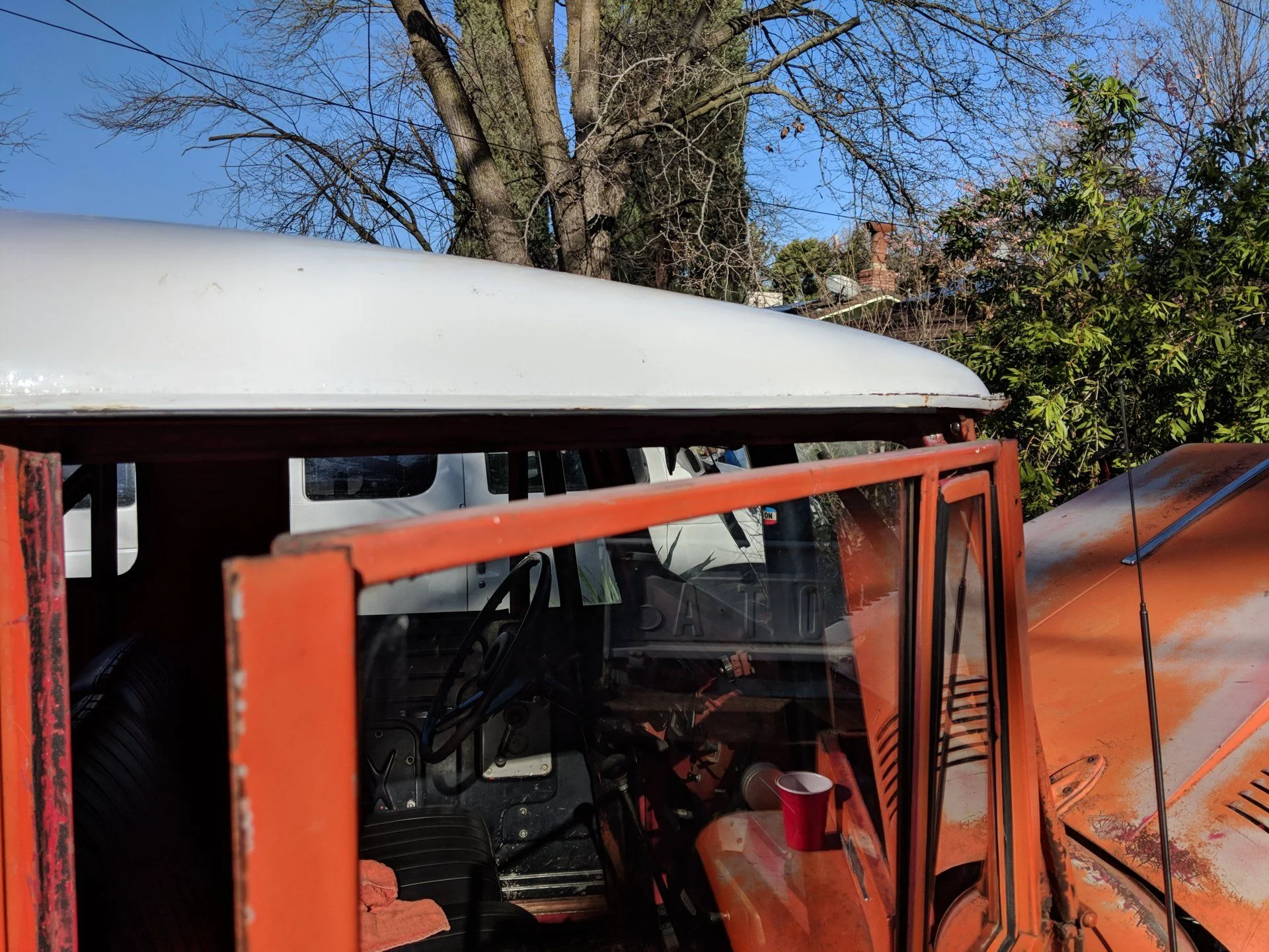

I was going to install some weather stripping when I noticed this door does not have a top like my other early fj doors. It looks original with clean factory edges/bends. What is this please?
that is normal on very early doors. where it meets the hardtop rail, you also wont have the swoop that the later tops had. i'm assuming this is a corrugated top
65 would have the corrugated top and bifold rear door. Those look like my '65 doors. I attached weather stripping for the top part of the door on the cab frame (top), not the door itself.
