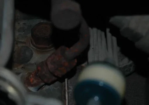

Oh, does anyone think THIS might be an issue?!?
I sprayed it with soap-water and saw a stream of bubbles! Elbert hooked me up with a used one that looks MUCH better. I just gotta sack-up and give it a shot. Newbie-nerves and all...
