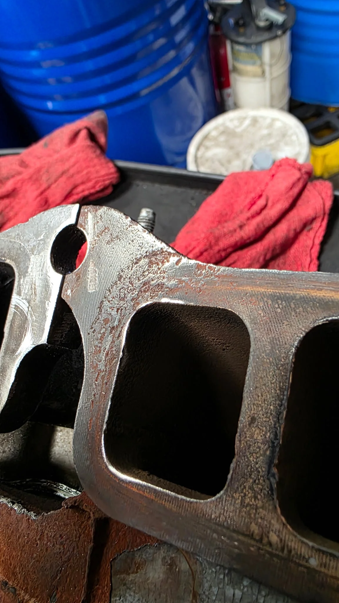

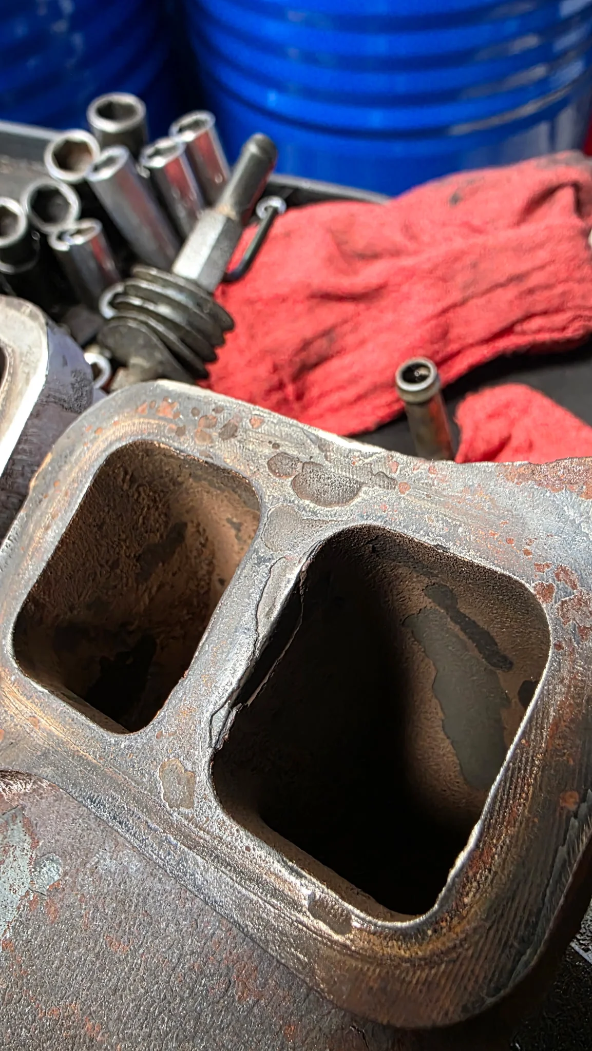

that slight unevenness on the mating flanges of the exhaust manifold isn't a problem The gasket will seal that. The big common problem with the manifold assembly is that the whole freaking thing warps and won't sit flat against the cylinder head.
If you place the assembly against a perfectly flat surface and everything fits tight - you are good, No machining required. But if there is gap - time to get it machined.
