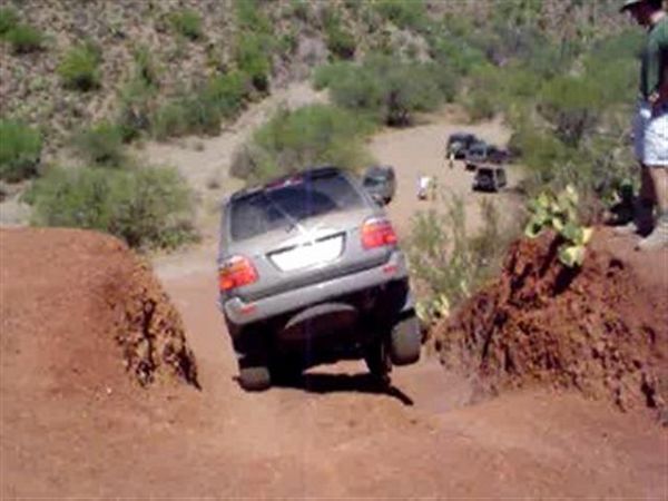

I'm fully flexed at that point. Another inch back and my driverside rear lifts in the air to the point I can remove my coil with ease...Also note that you are taking that photo above your rig where mine was below. Kind of hard to compare via photos.
Why don't you get yours to flex out and measure your shocks. Do your bumpstops hit at all?
I doubt that becuase you have the same setup as me. Depending on terrain you can lift wheels when your axle is almost straight.
And that is the exact reason I backed up the rock. Anyhoo someone who has an axle compressed to the bumpstop will chime in soon I hope.
