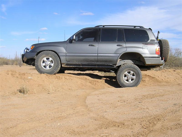

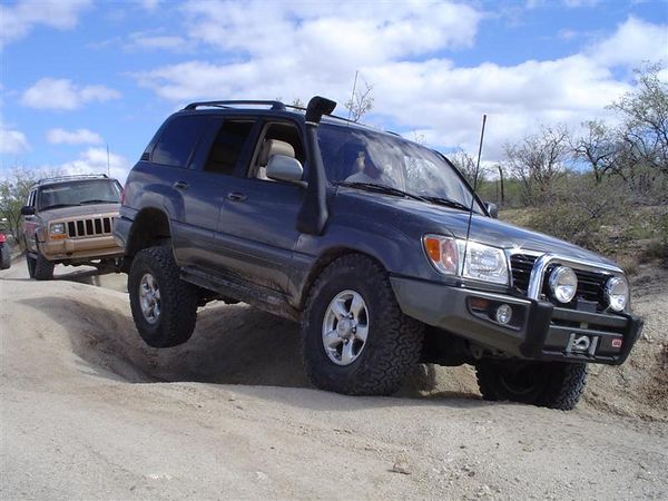

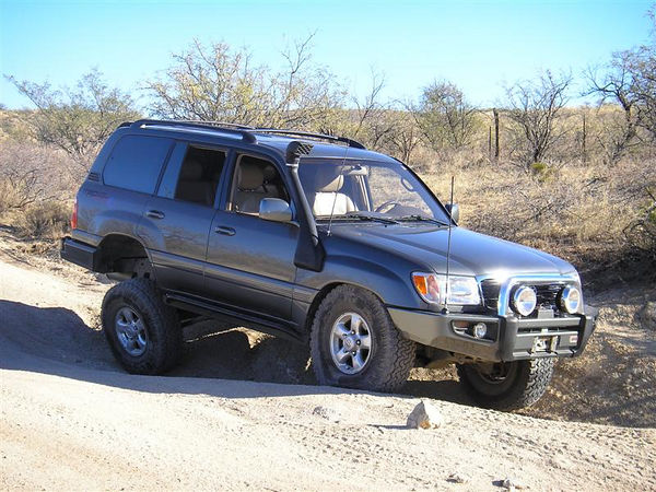

OK, here's the example pics I gave:
BEFORE the longer shocks were added, in both these spots at some point I would have had the driver's rear wheel drop to the ground, shifting the weight in the rear downward and therefore front-end upward. The passenger front wheel would have been off the ground, AND the driver's front tire would have been LESS stuffed because the weight is lessened on the front.
Then, as I passed the summit of the obstacle the front would have dropped down (gravity) and the driver's rear wheel in the air. Basically do a little teetering when the weight shifts to the front.
By having all wheels on the ground (due to gravity, spring, shock, force....I don't care) the teetering doesn't happen, the vehicle stays more parallel to the ground, and in these cases/pictures the front passenger side wheel remains on the ground and the stuffed wheel stuffs more because their's more weight on the front.
I've been through a lot on this truck. Speaking of weight distribution and articulation/feeling more stable....check this out:
This is what I used to live with BEFORE adding your rear bumper:
The front weight of the V8, the ARB and the winch always made this thing front-tippy, especially on downhills. A pic like this was common. I knew I needed to balance the weight more F&R. Adding your rear bumper helped my stability!
Now, here's a pic with your bumper on and N74L in the SAME SPOT (and that spot's worse now than before):
Huge improvement, huh? In fact...look at both of the front passenger wheels. Look how much more stuffed it is compared to the top picture. Why, I obviously don't know how to explain....but it is! This is what I mean by the truck being more stable and it flexing better.
So you see....while I may not always have the "techno" words, I think I make my comments and form my opinions based on on-trail testing.
I know I bugged you for months to investigate N74L's on the 100. Once you posted the ingredients to make the setup work I tested. Results "in newbie lingo"....are that they offer a notable improvement. Thanks for dragging those shocks out that day and posting up. My ride is better than ever thanks to you doing this...AND you sold a pair of shocks. :)
In conclusion.....the pics don't lie. If I'm dead wrong in the above writing as to why the big improvement exists off-road, that's OK....tell me. Disputing the results however is misleading to the newbies, my website, and the magazines. :D

Yes. I've got that. I wanted to give Mr. Slee one more idea of where I was coming from. Obviously....I can't write well. Thank god I can talk though or I'd have no friends! :D
What do you think of those 2 bottom photos?
You are in the same relative spot, but that picture does not mean anything to me.
The truck is in a shallower approach in the second picture.
Front tires stuffed better, yes, but that may be bacause the rut is more washed out or your truck weighs more with the extra stuff on it.
Longer shocks in the rear will not make 6" of difference as you are implying by comparing those tow pictures as the "SAME SPOT"

OK
Umm...nope...this popular spot is deeper in the second pic (due to age and use)
Yes, could be...and I think you're right...it's because the rear is down more too due to the rear bumper. This is for the techy's..not me.
Correct...though I didn't imply that. I pointed out above that the bumper made a big difference too. In between adding the bumper and then adding the L-shocks I've been there too. The truck drove flat with the rear bumper. The weight balance made the most improvement in this spot...though I'd teeter on 2 wheels until I added the L-shocks. Without that bumper, the thing would have still been a wheel-lifter...just a bit smaller a one.
