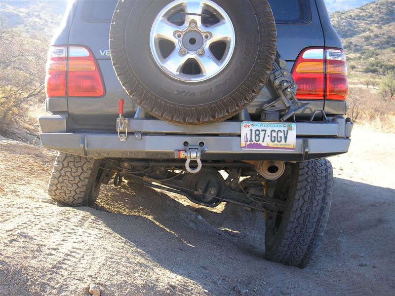

So I couldn't get it to rest on the bump stop at all not even close! So here are the numbers with how it sits in the pictures. Maybe Slee can get it to go further.
Distance from bump stop to axle 4 1/2 inches
Shock length from center of shock eye to base of top shock mount 20 inches
Distance from rear passenger tire to top of wheel well 4 3/4 inches.

I couldn't get them to bottom out at all. I lifted the driverside rear tire in the air with the passenger tire still on the rock and it wasn't close to bottoming out.
The shock was compressed to 19" or so..and taking out the rear shocks is a bitch :)

bull said:
N74L compressed are 15"
Bull. On that rock youre not completely flexed. Compare your axle angle with mine below. Try your truck in another spot...like a ditch and cross it at 45*.
I'm fully flexed at that point. Another inch back and my driverside rear lifts in the air to the point I can remove my coil with ease...Also note that you are taking that photo above your rig where mine was below. Kind of hard to compare via photos.
Why don't you get yours to flex out and measure your shocks. Do your lowered bumpstops hit at all?
