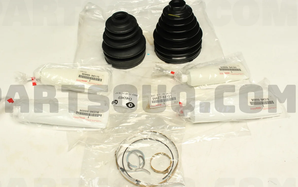

Just reboot the CV. I've had to do it a couple times. You can get an inner cv boot kit for under 40 bucks iirc. You need some tools to do it yourself. Most shops don't want to reboot. They want to replace, and aftermarket axles are worse than junk.
As a 100 owner, you probably need to know how to do front bearings, brakes anyway, and when you do that job, popping out the CV is just like 1 more step.
FWIW, the boot kits come with both inner and outer boots, clamps and grease; you'll need one for both sides.
Thought I’d update this thread and thanks for all the information. I ended up rebooting/greasing both axles with the OEM kit and all the play I was feeling has gone away. Just took each end apart, ran through the parts washer and reassembled with new boots and grease, pretty easy job.
