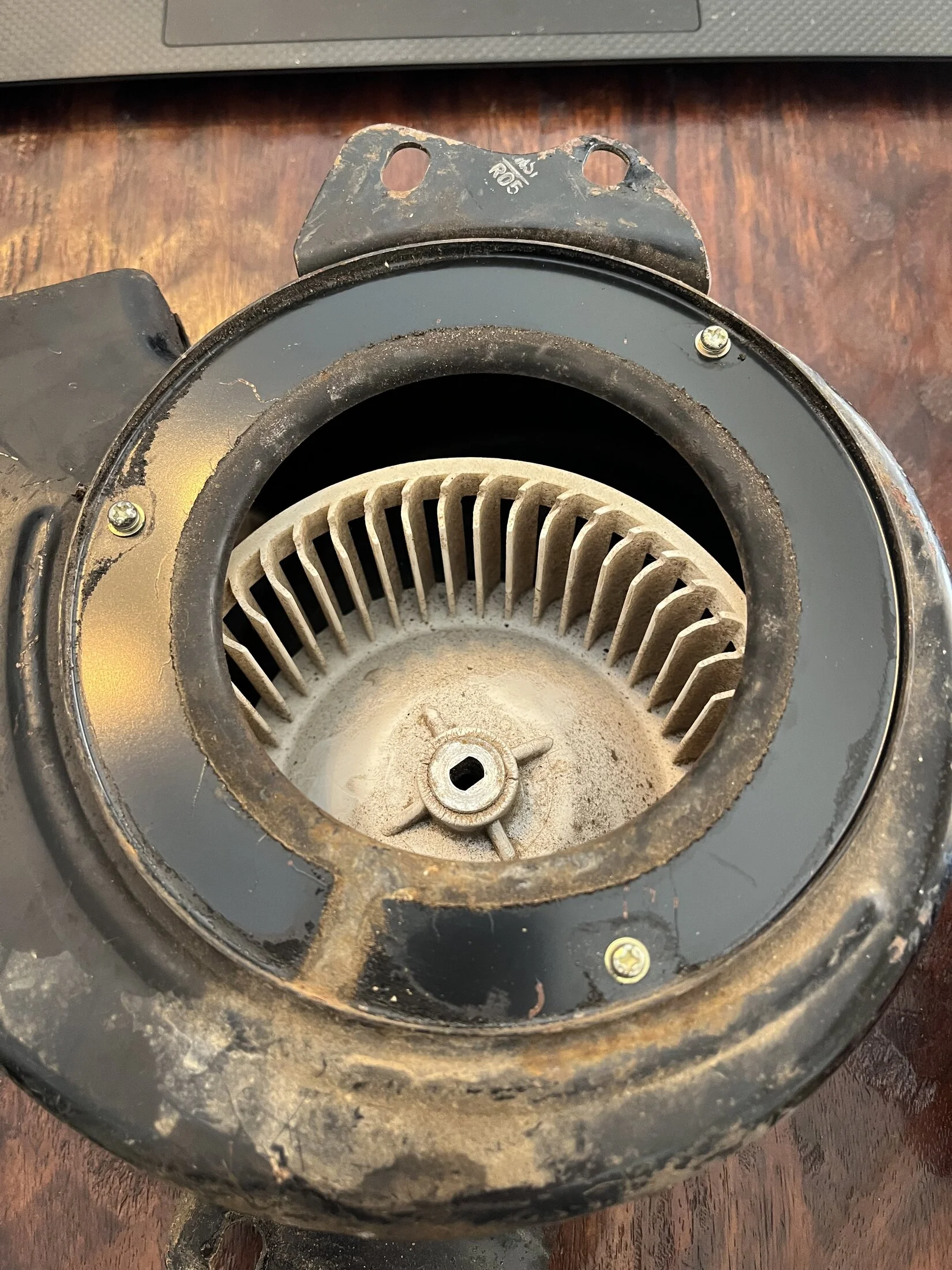

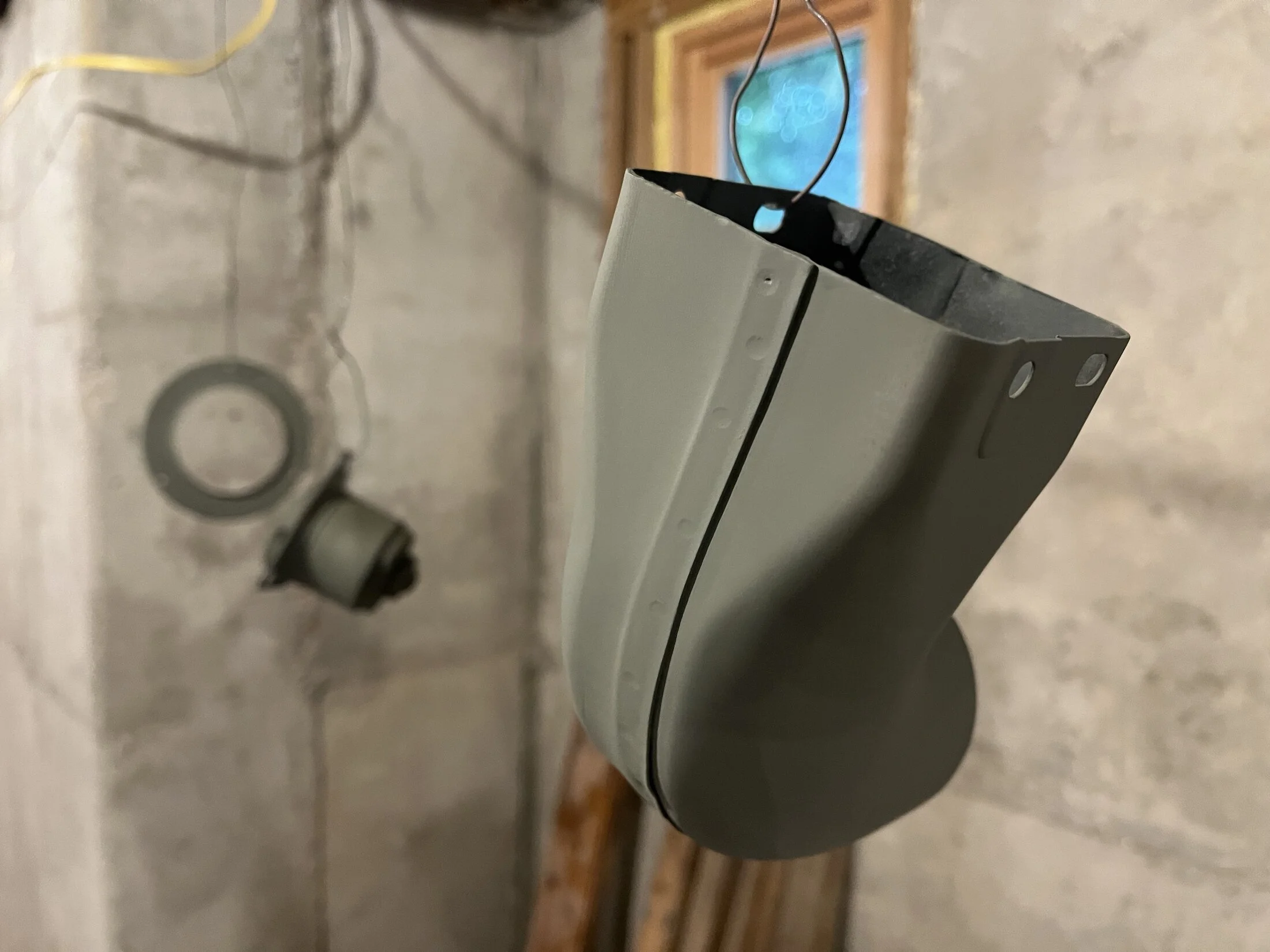

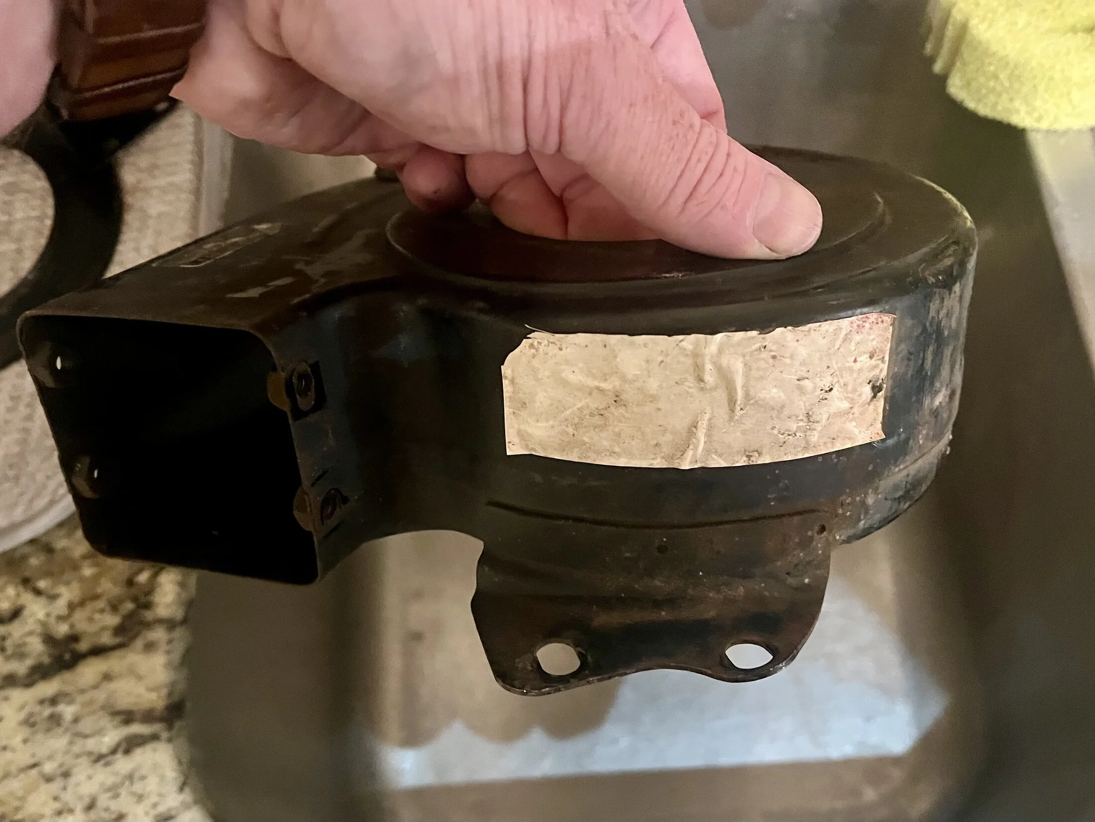

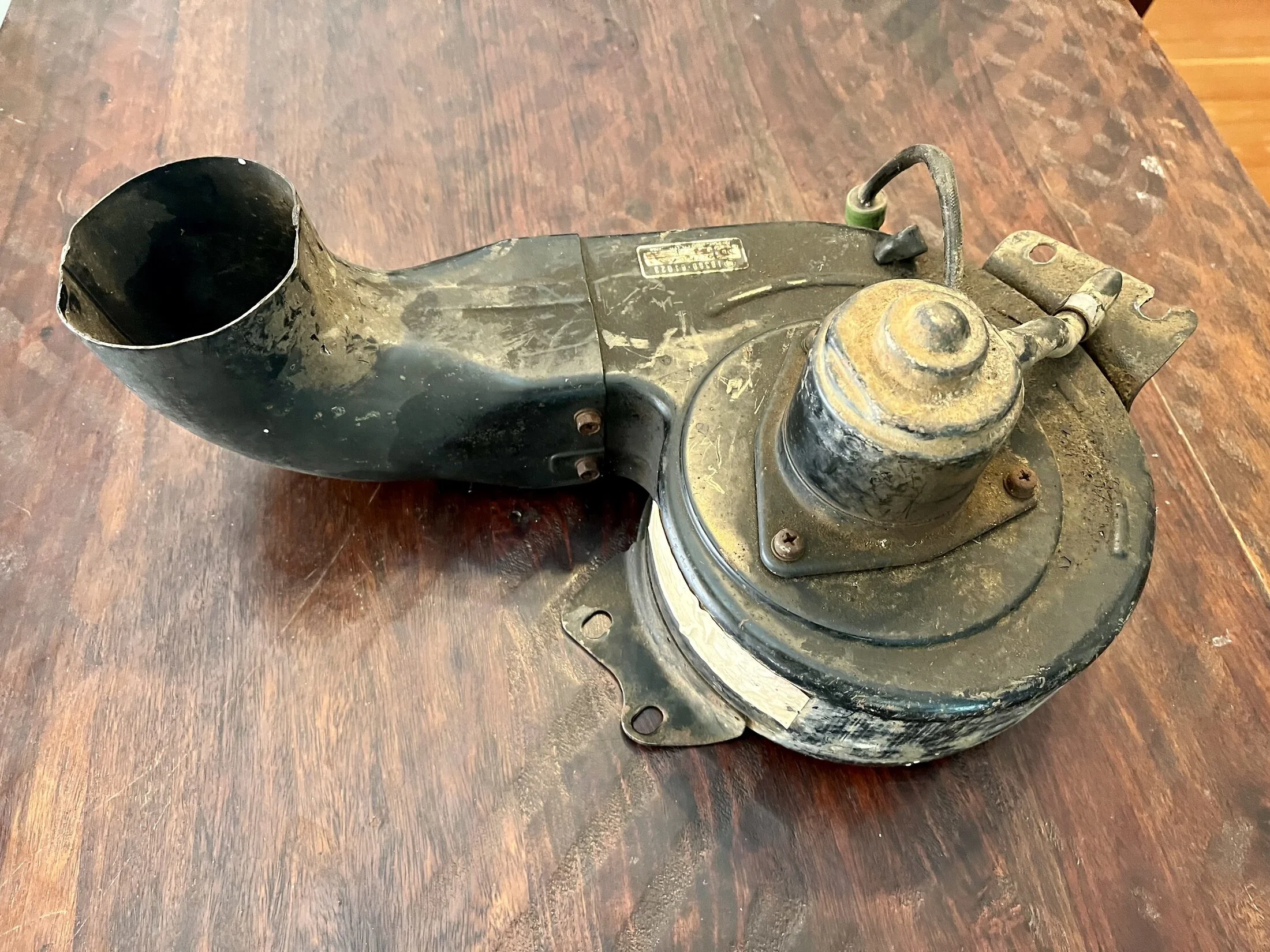

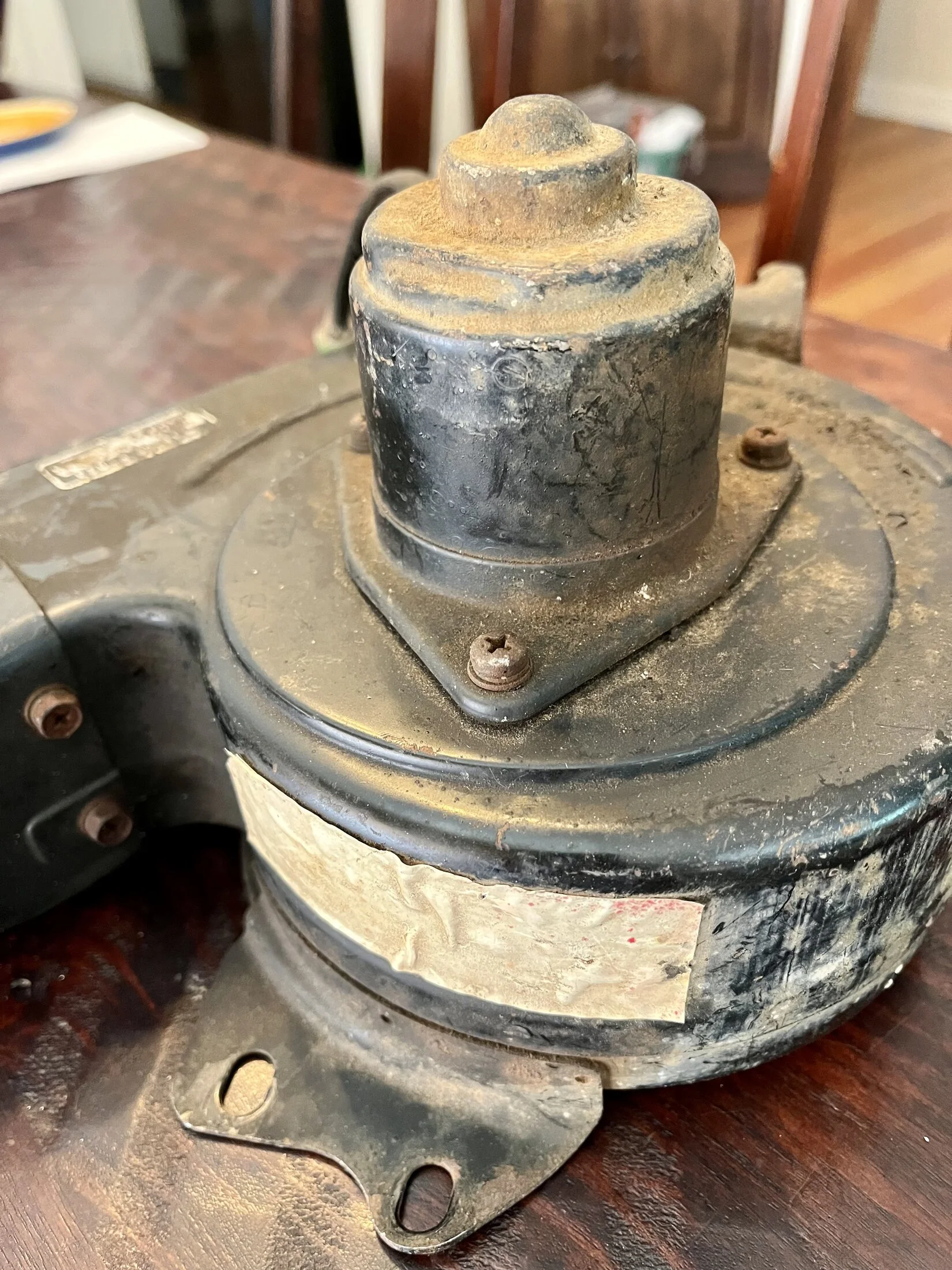

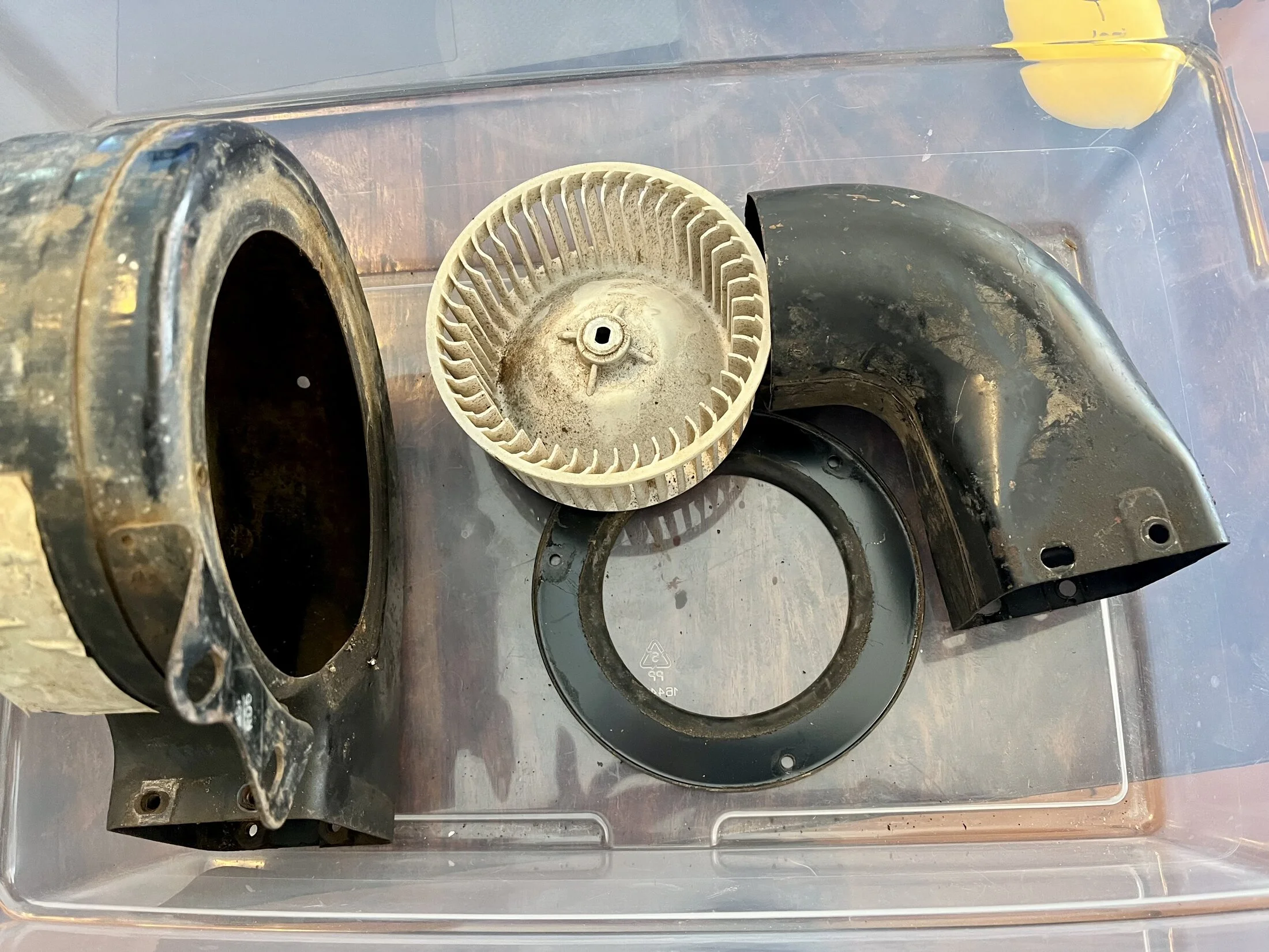

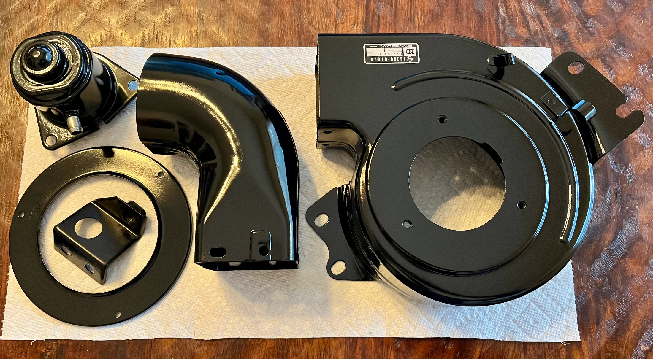

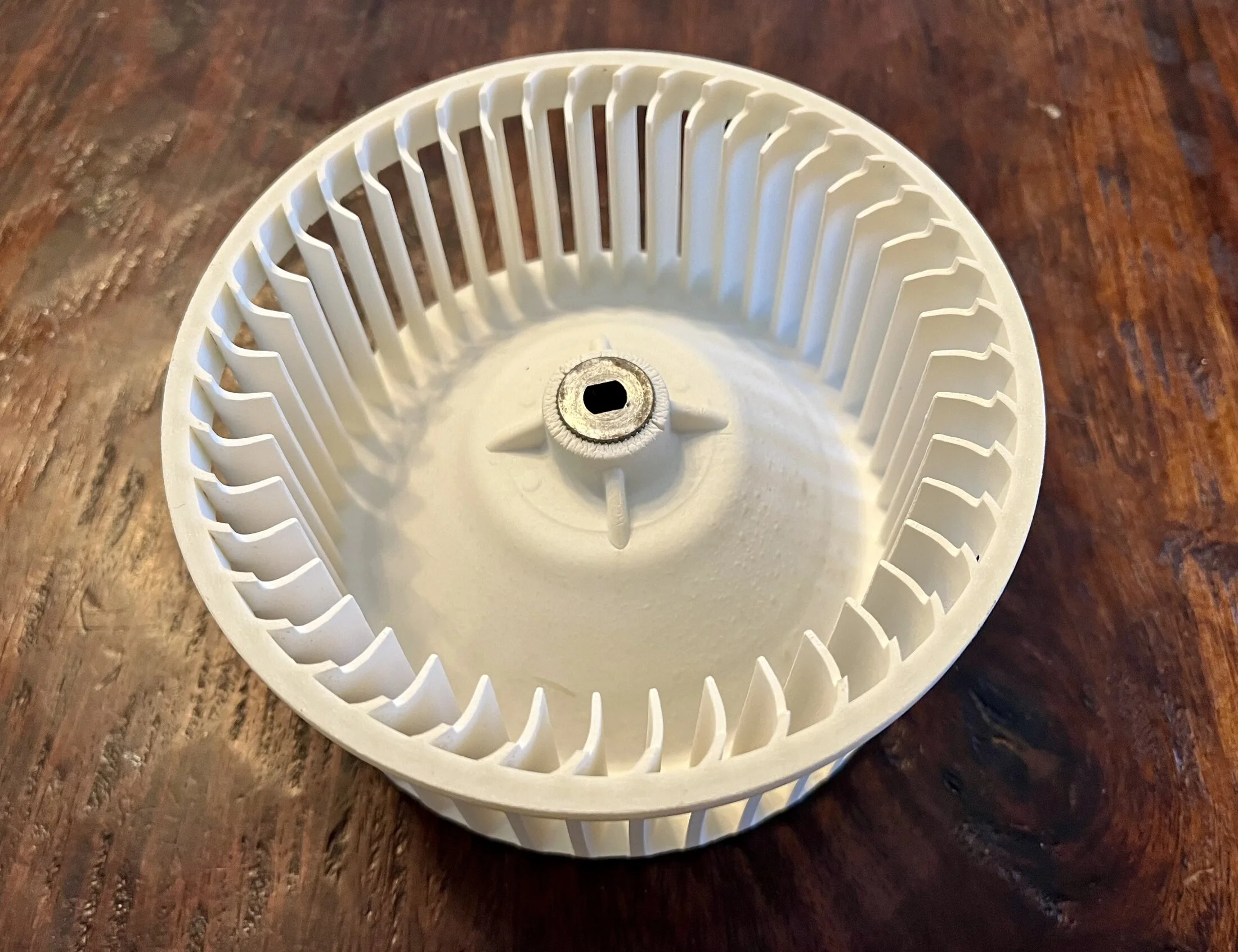

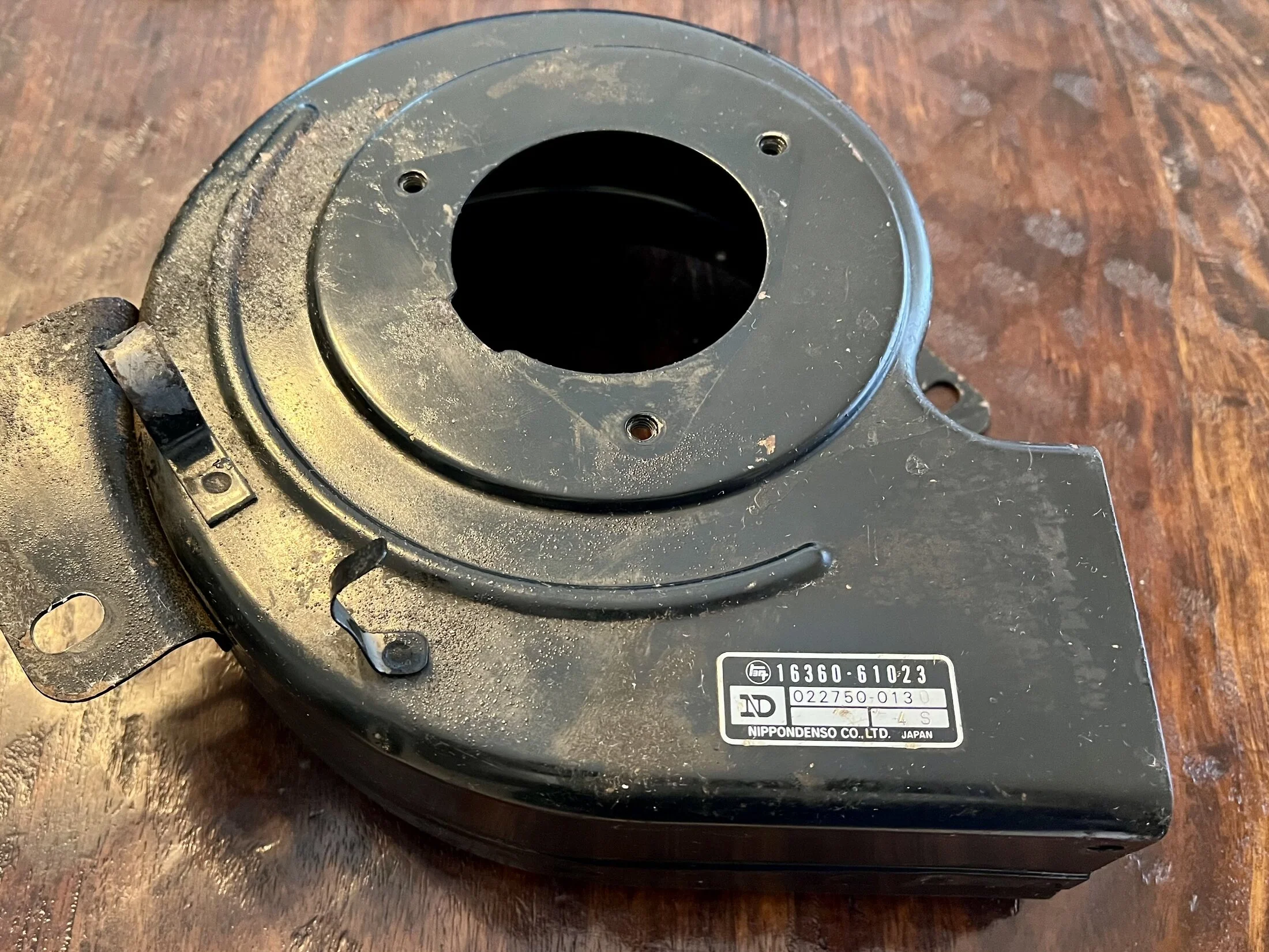

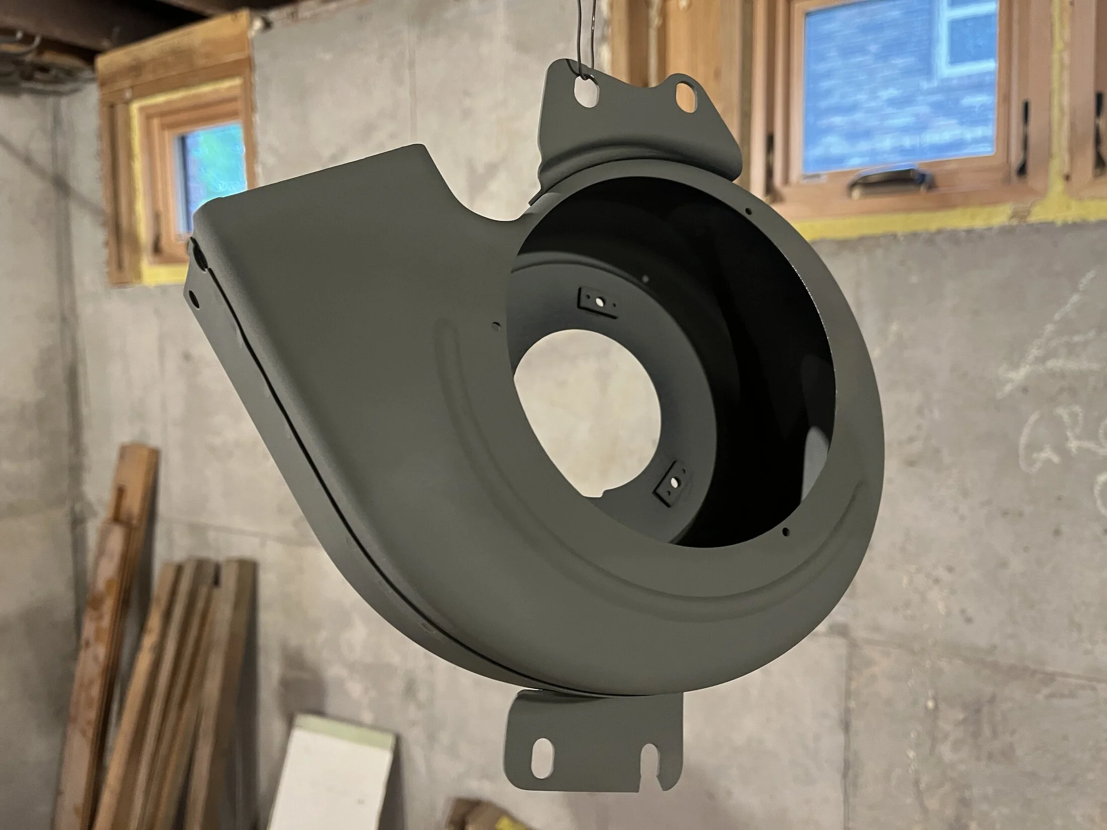

This weekend started the carb cooling fan restoration… It was in fairly decent condition, but there was enough rust on it that I decided to wire-wheel all the steel parts.

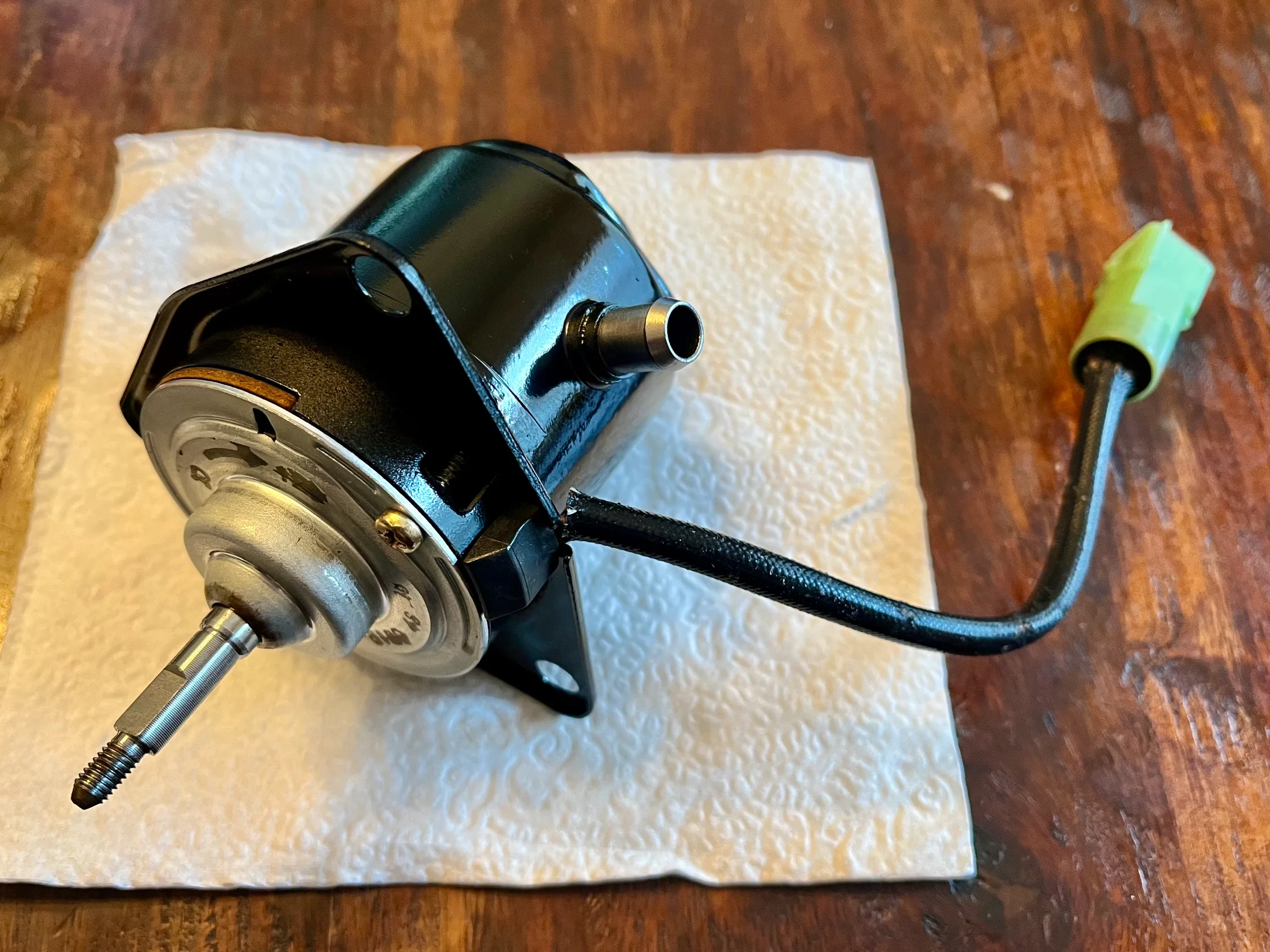

As of writing this, I have most of the hardware sitting in Evap-o-Rust, and the fan cowling / motor housing pieces are primed and painted. I’ll reassemble it after a day or so curing.

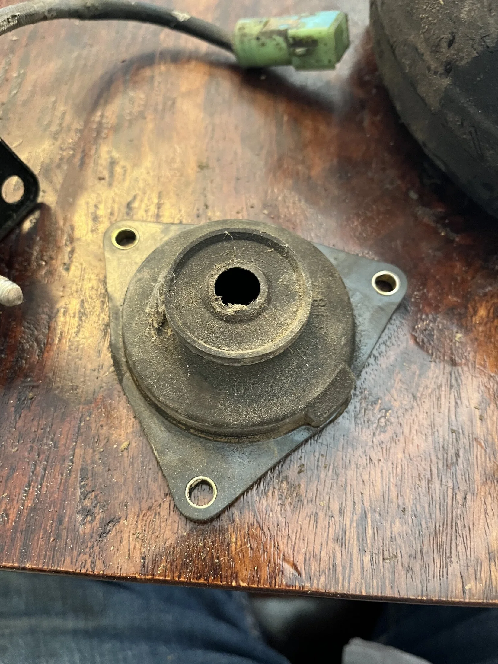

I did end up replacing the three M3 screws (and their washers) that hold the circular plate in with stainless steel equivalents. I got two of em out ok but butchered the third due to a struggle against rust. Im not sure if these fan assemblies naturally trap moisture or if my donor fan came from a wet climate… I assume the latter as Mr. Toyota thought to add drain holes. We’ll see 🤷‍♂️

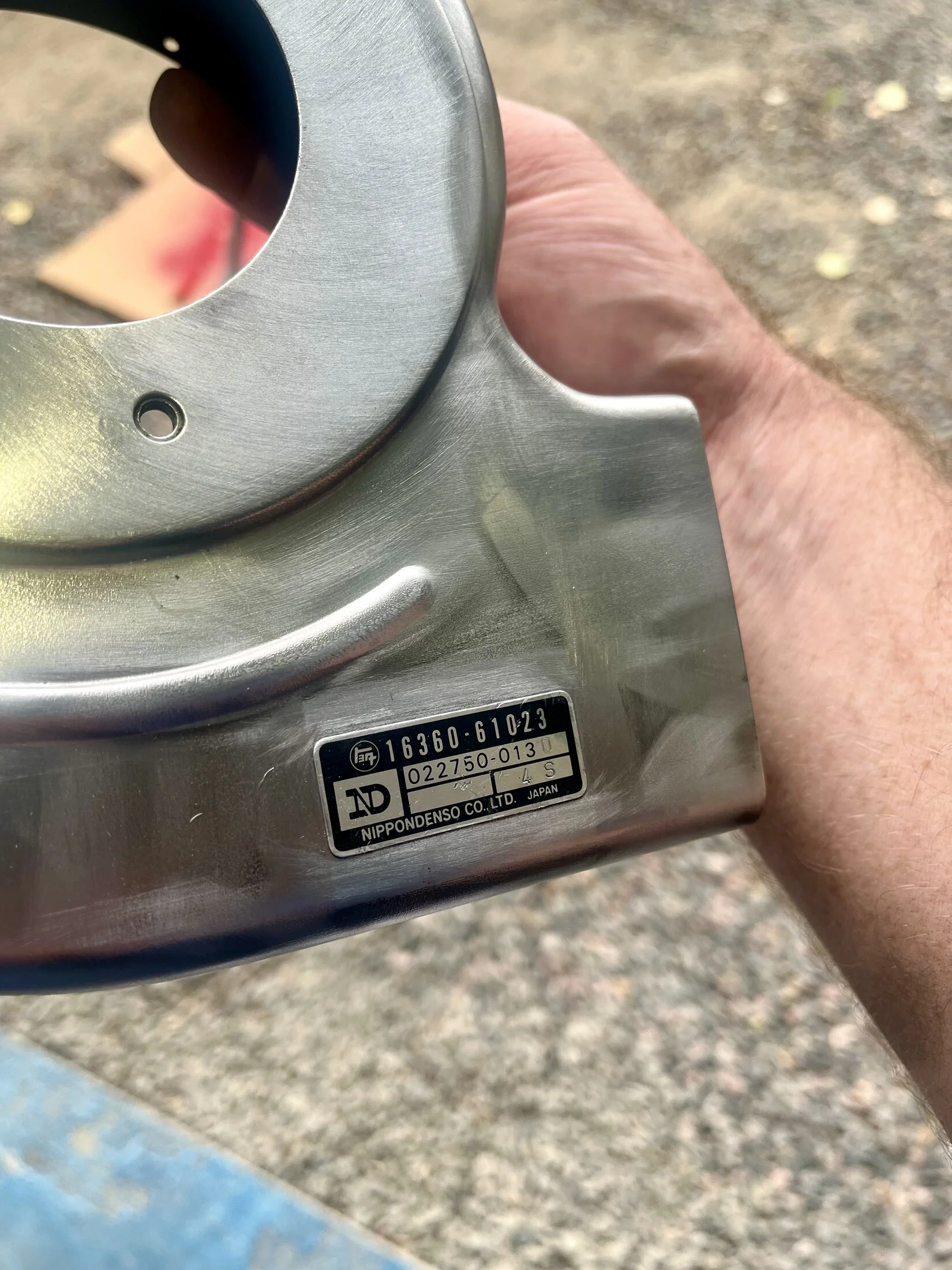

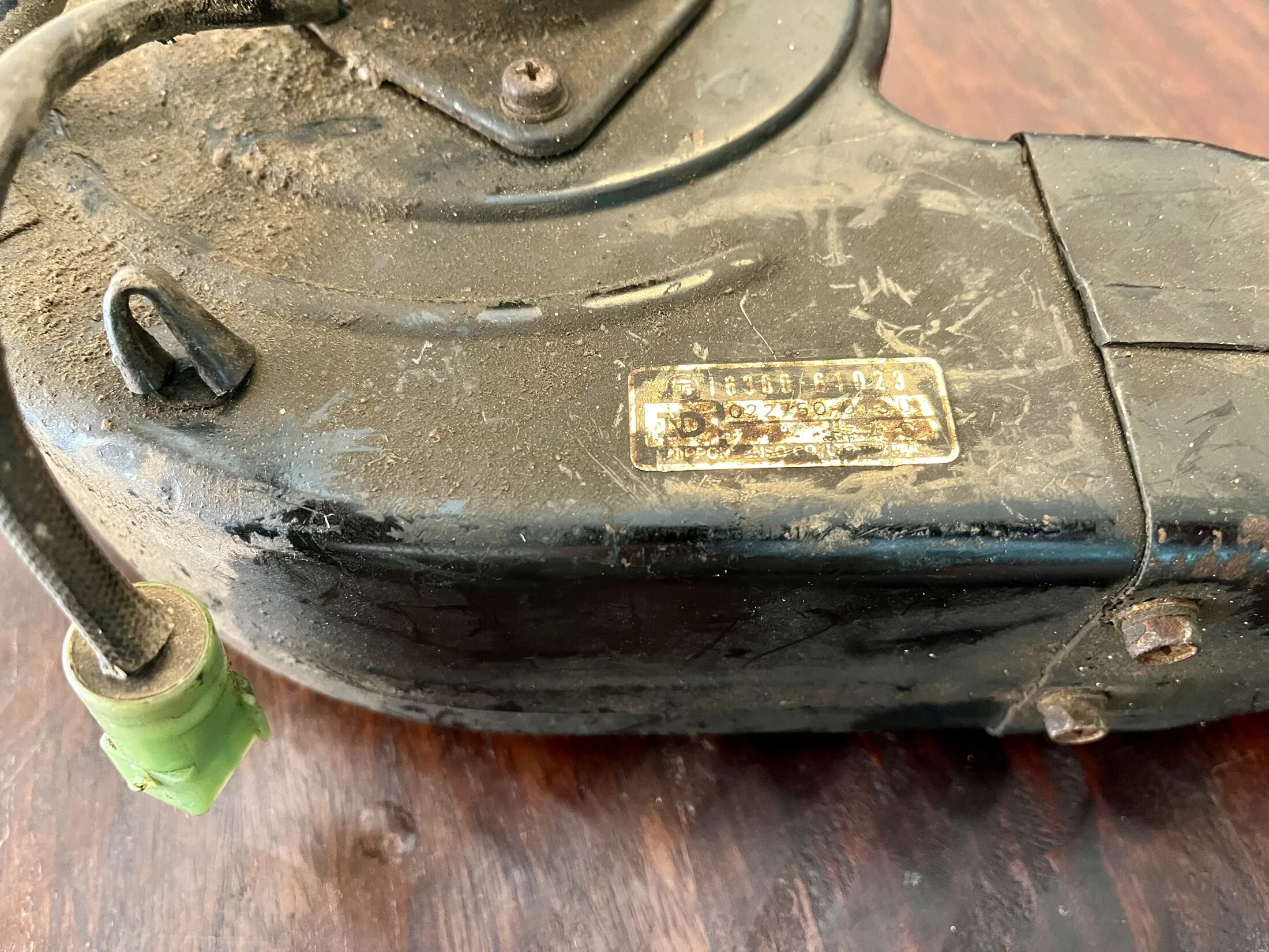

The Nippon Denso sticker was in good condition so I took my time and stopped short w/ the wire wheel, using hand-sanding / emery boards to get up close. Masked it off for painting and I’ll see if that all worked out in the AM.

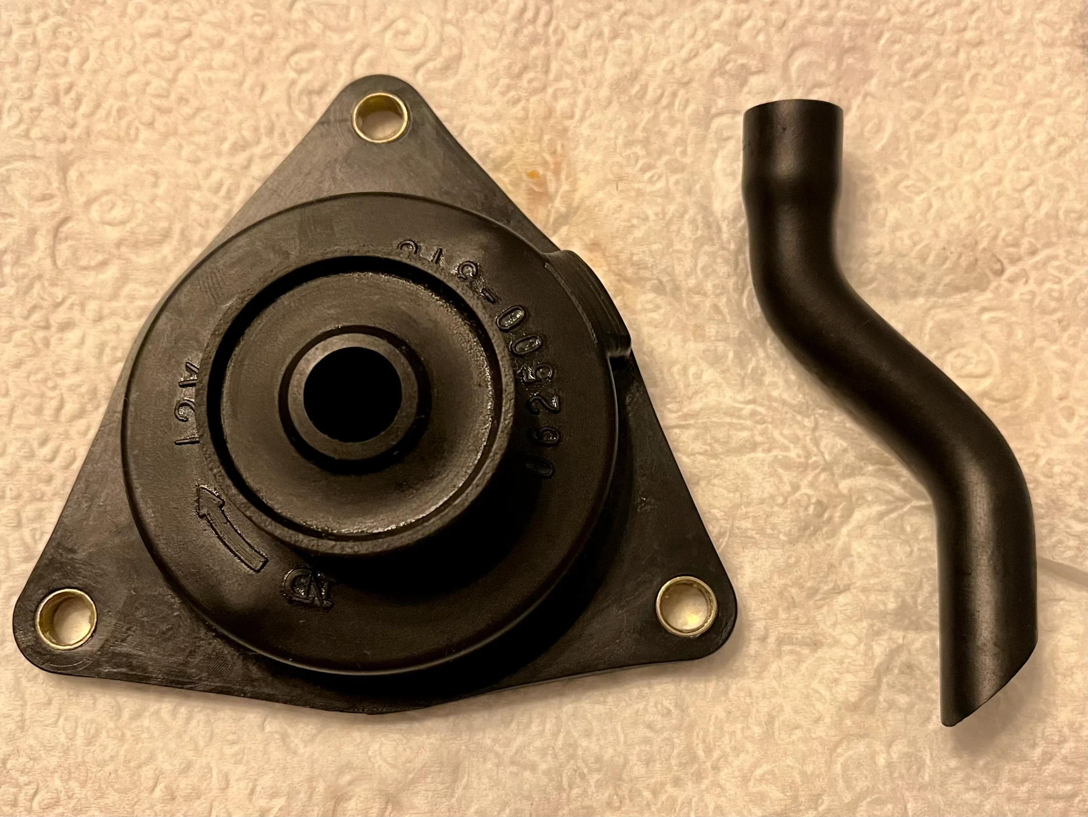

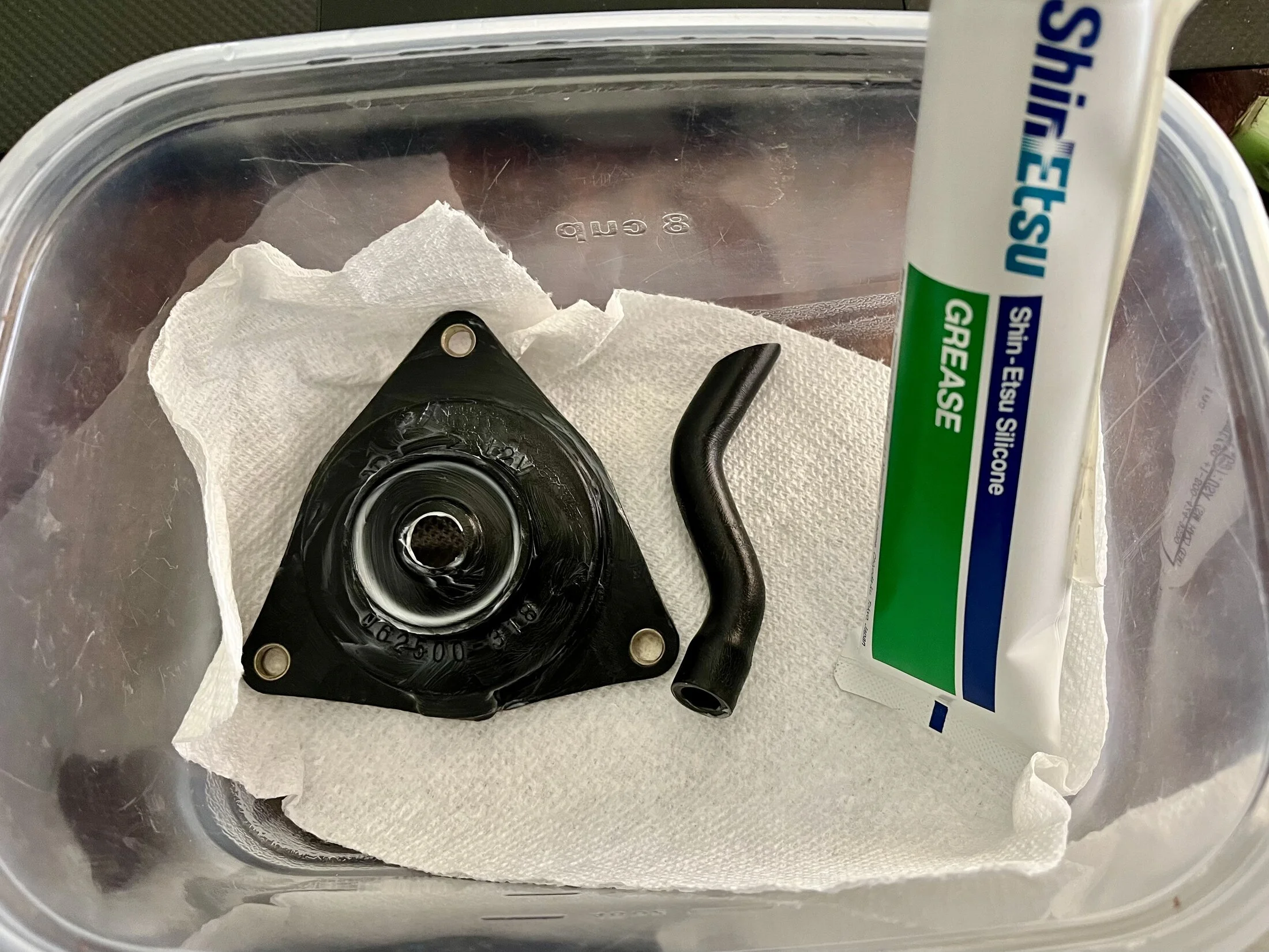

I lucked out and all the rubber parts were in good condition, still pliable. I am going to try and preserve/protect them using some Shin-Etsu silicon grease, which I hard heard good things about when I was researching rubber restoration during the heater blower restoration.
Done so far:
  • Disassembled, sorted and washed parts
  • Rusty hardware still in decent condition soaking in evapo-rust
  • Coated rubber parts in silicon grease for a day (will wipe off excess tomorrow)
  • Removed all paint from fan cowling and motor housing parts
  • Masked, primed and painted
  • Purchased SS screws to replace rusted-out ones
Still to do:
  • Clean inside of motor housing, oil bearings
  • Clean motor leads / high-temp wrap / connector

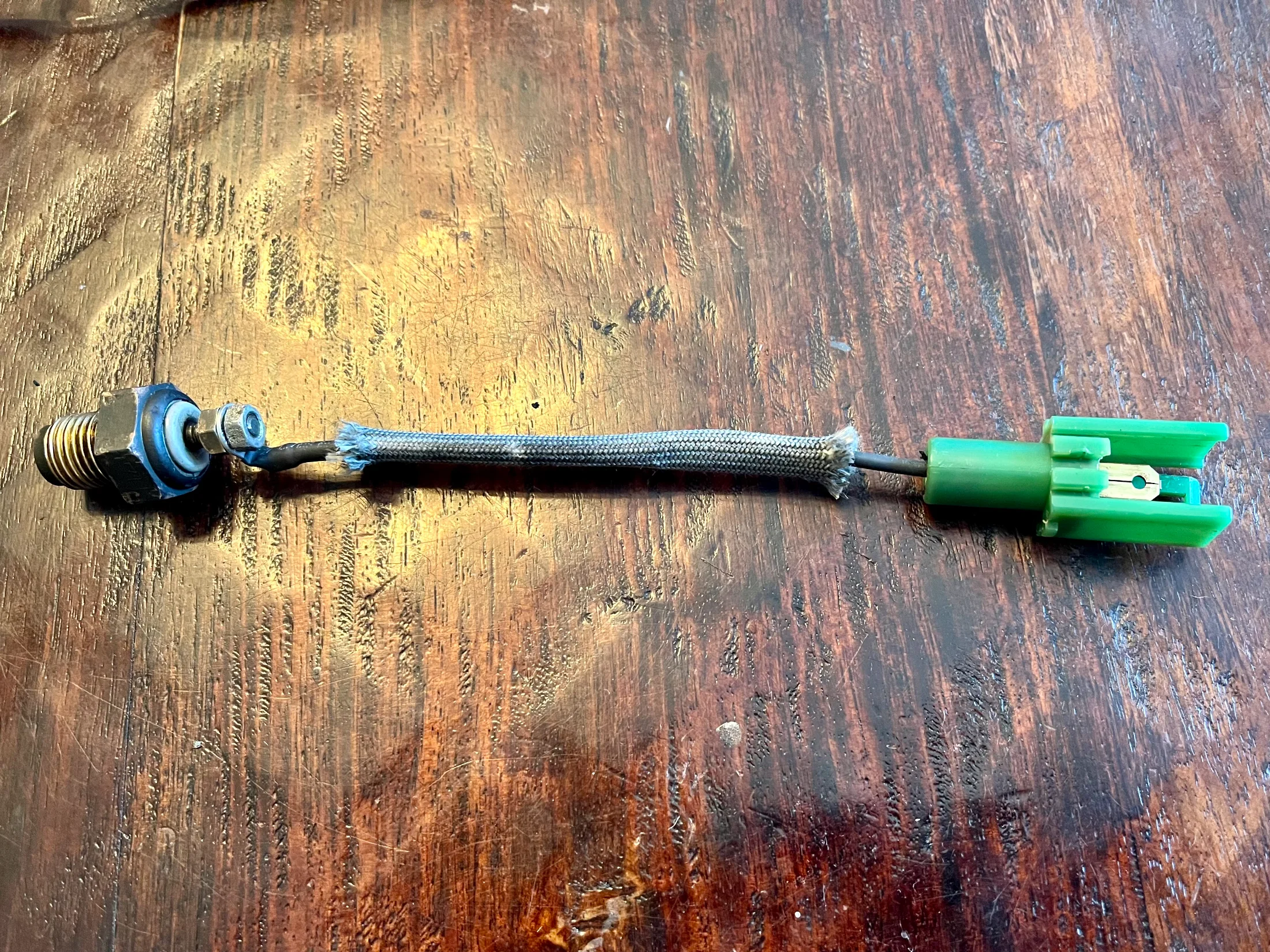

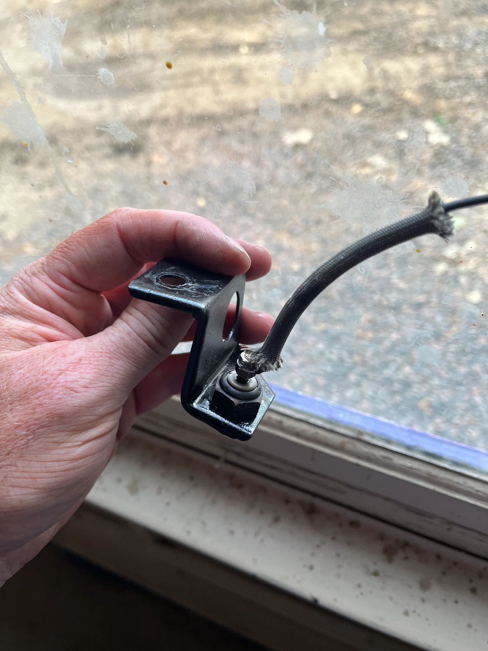

  • Clean up manifold temp sensor / bracket & install
  • Put together a connector / lead / hoop terminal for the manifold temp sensor
  • Reassemble the carb cooling fan assembly
  • Install and hope it works
Forgot to take pics of the wire-wheeled parts… D’oh!
Anyways, here’s the “before” pics:

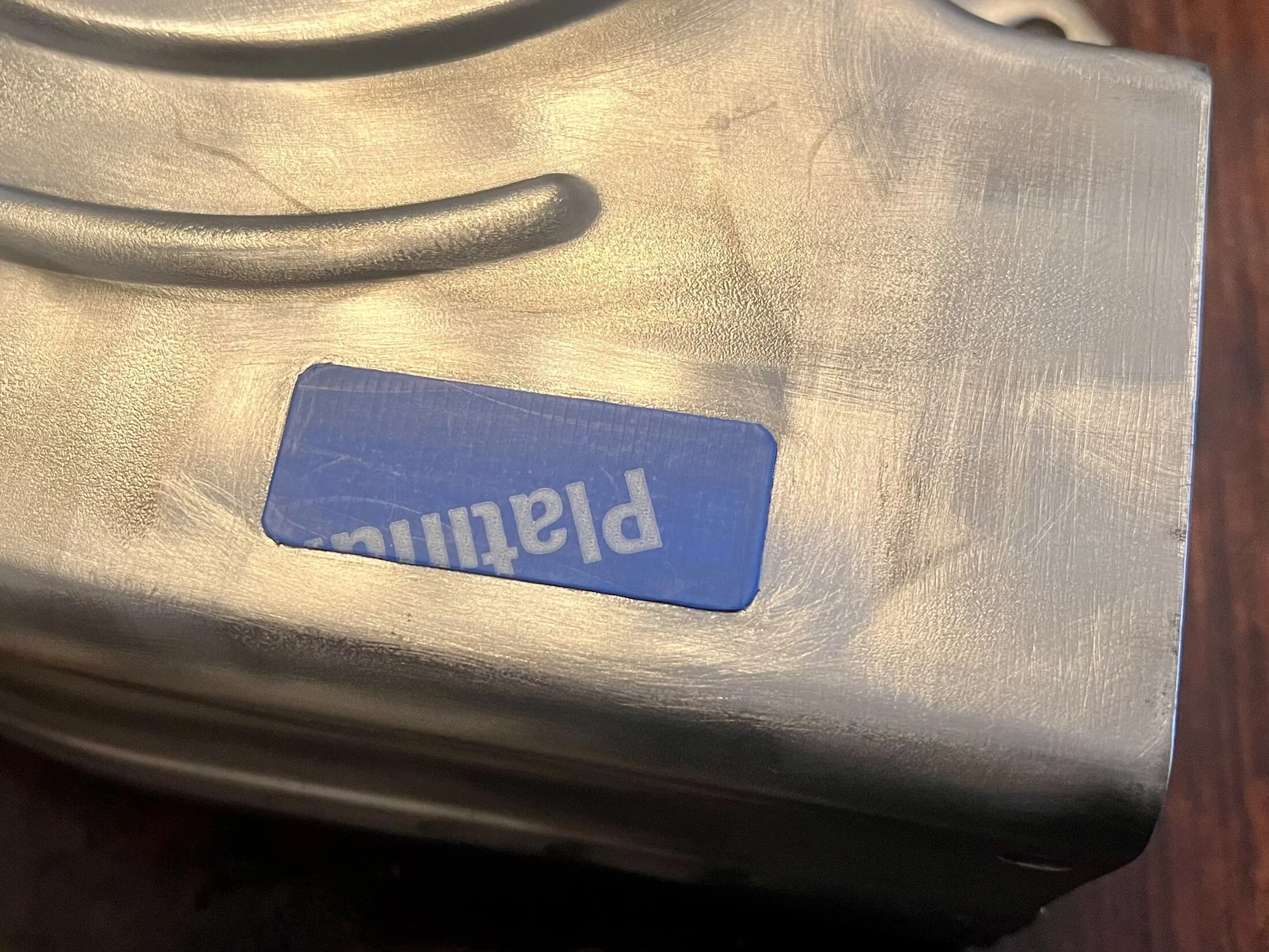

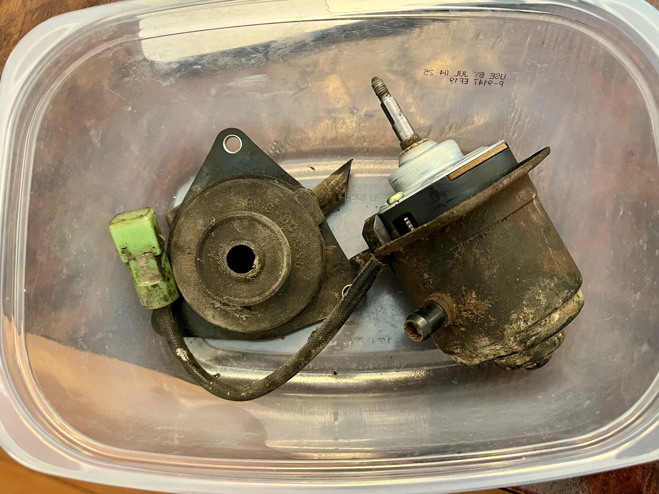

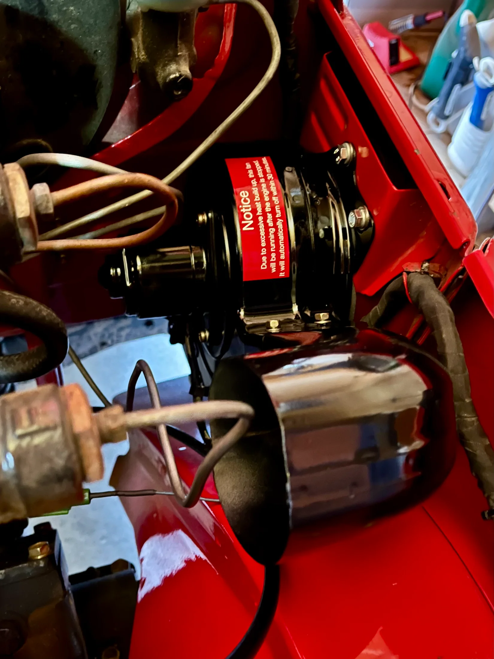

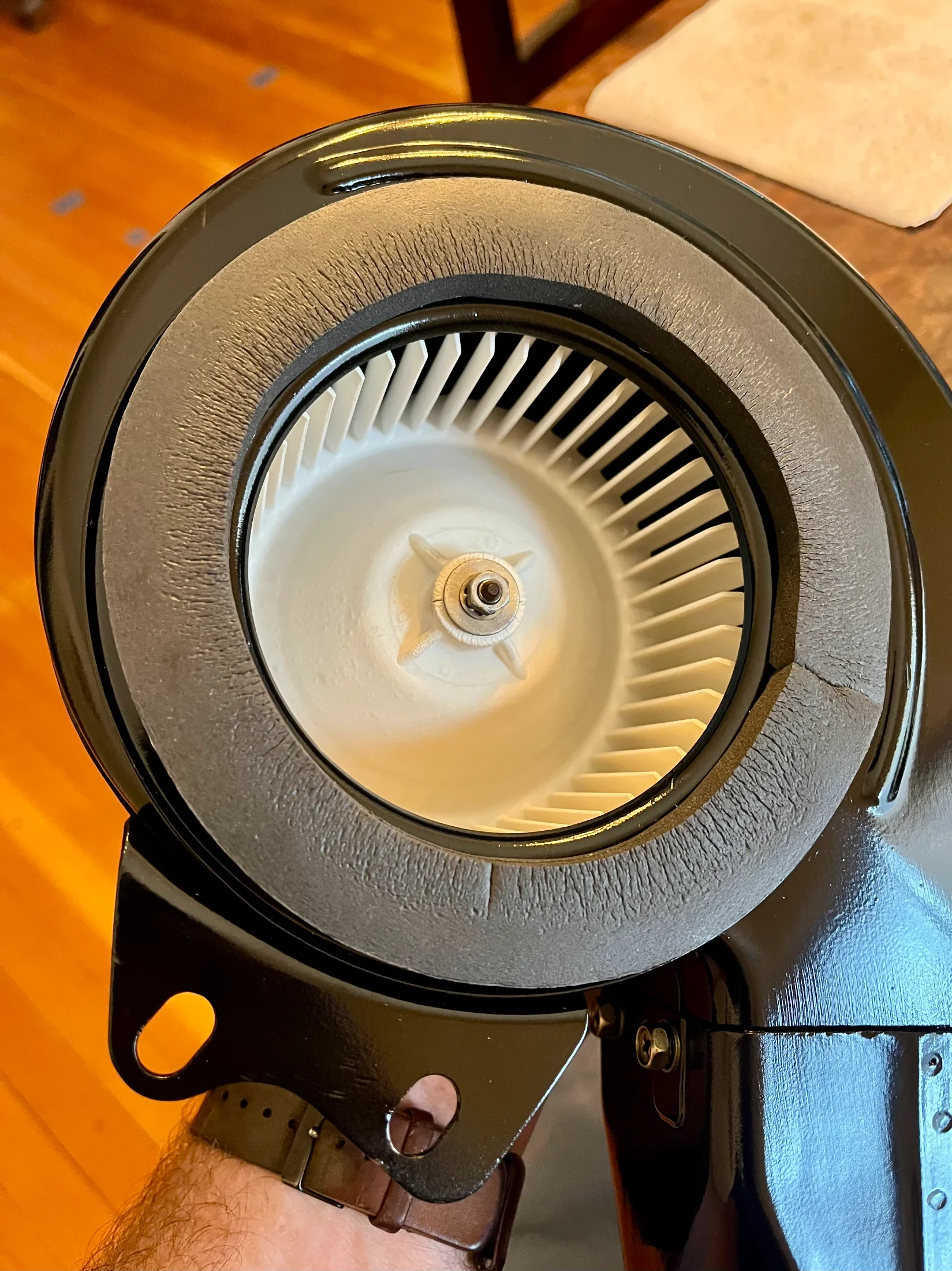

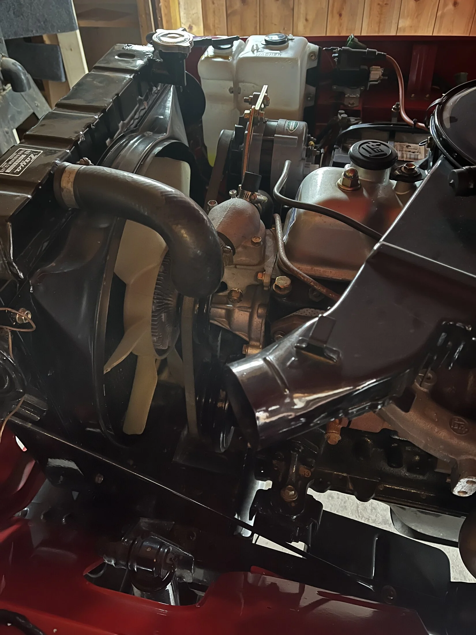

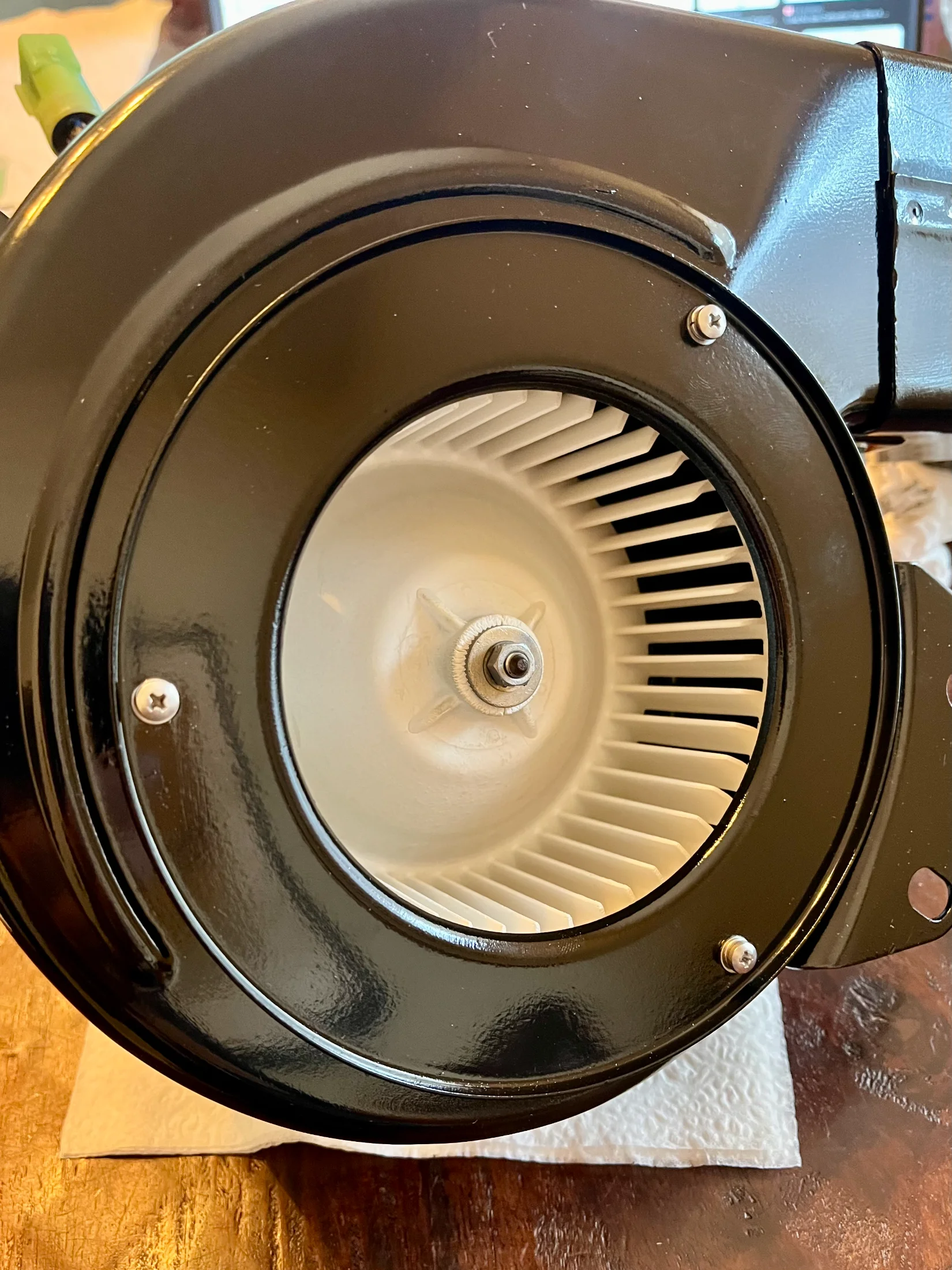

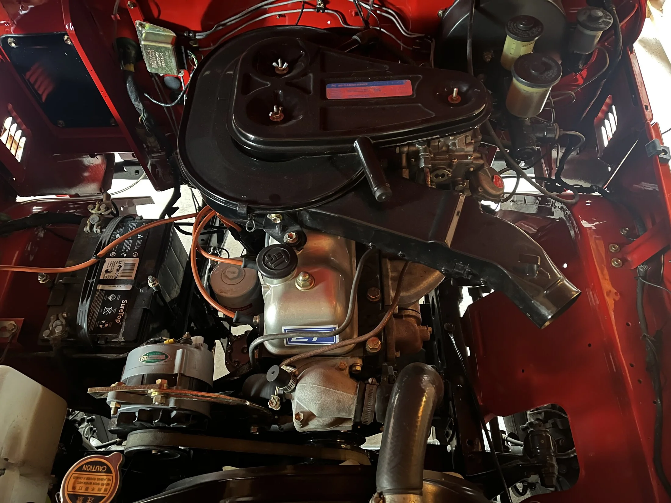

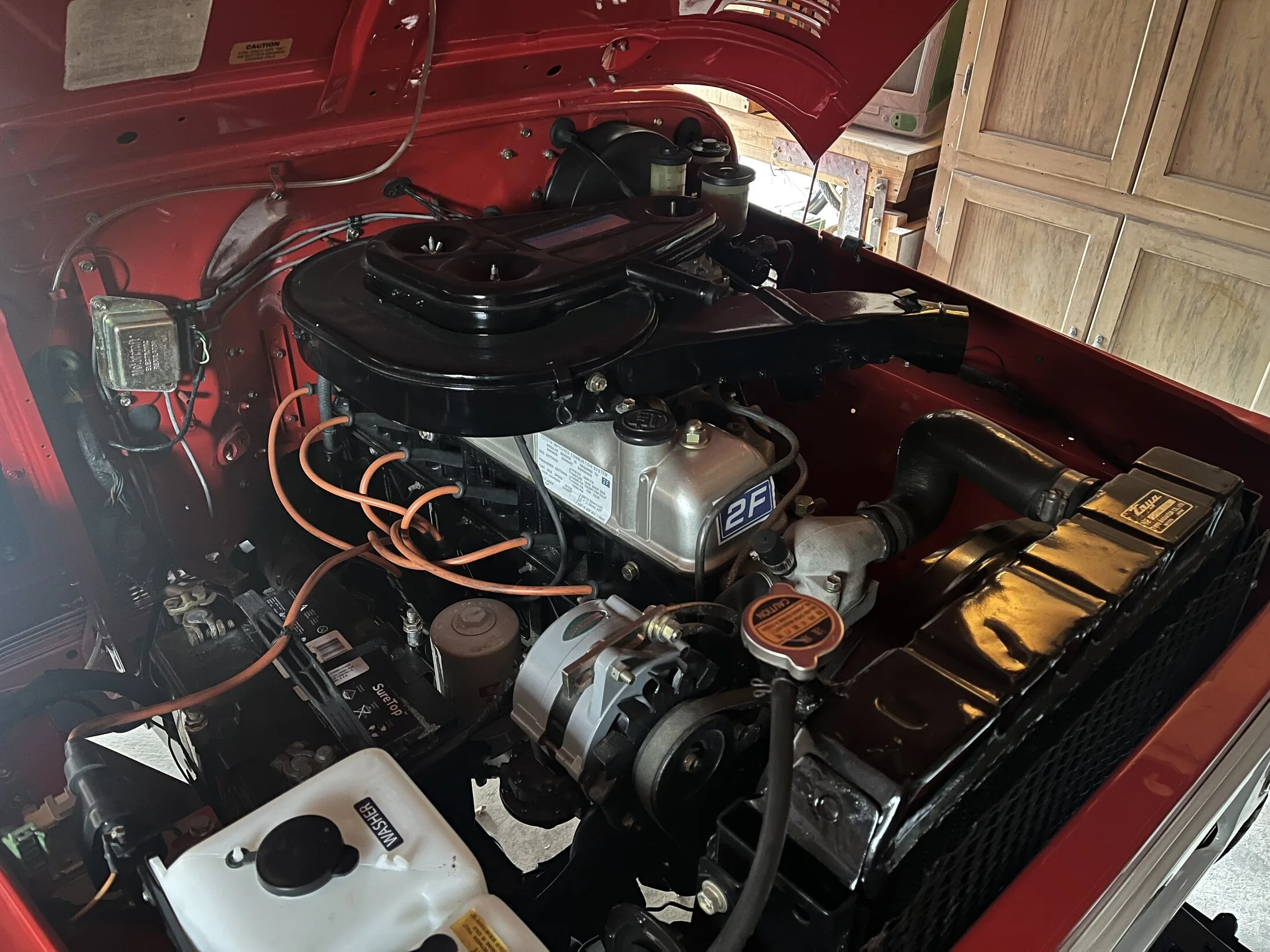

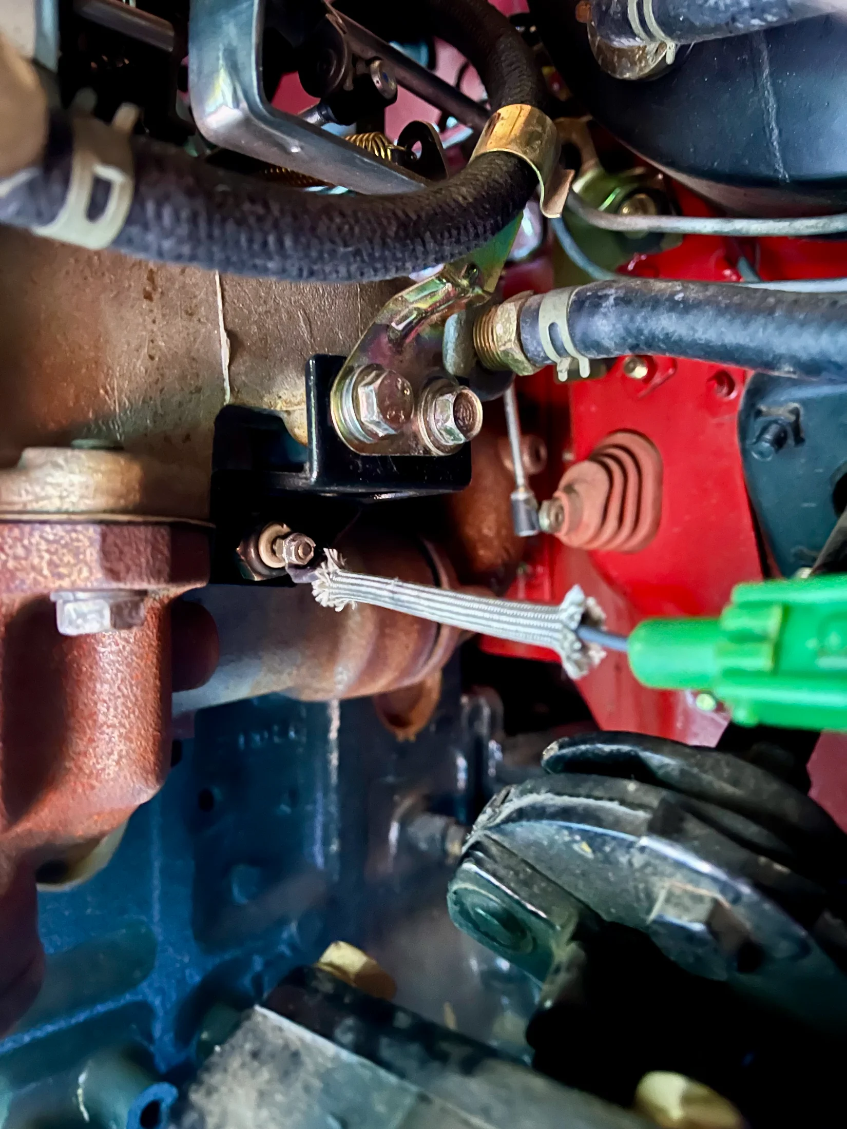

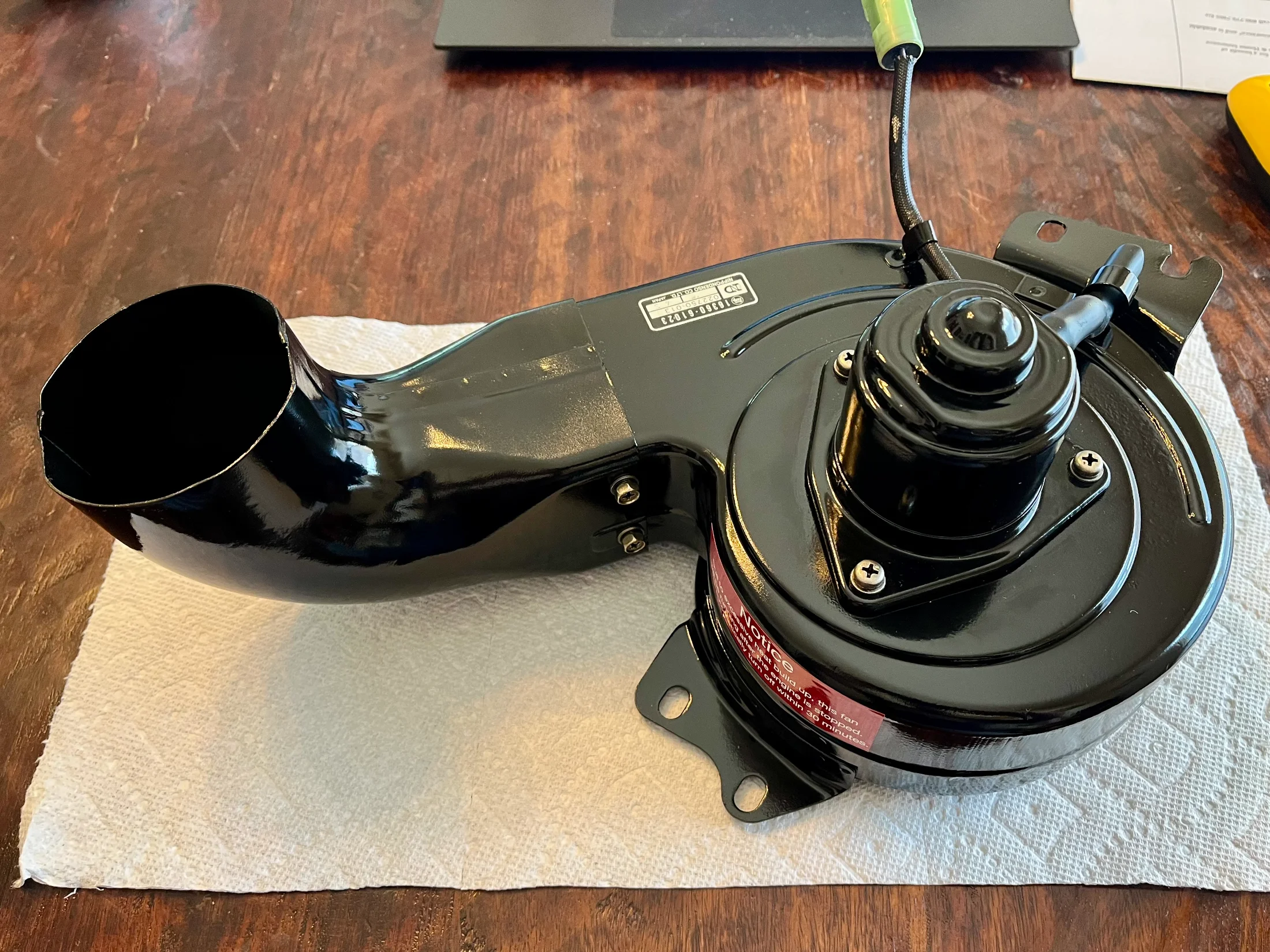

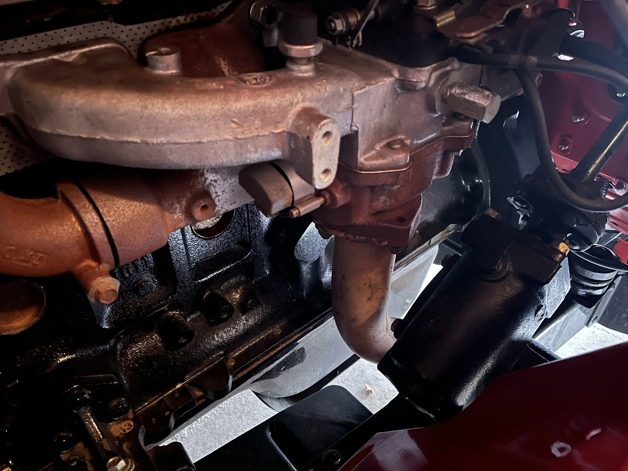

Carb fan restored! I re-assembled the fan shroud, motor (tested it as well), and applied new insulation (weather sealing from Ace). I also wired up the manifold temperature sender to a connector I had saved. I installed everything on the truck, pretty happy with how it all turned out! Except for one thing... The fan isn't coming on after the truck has been run awhile and is nice and hot. I'm not sure if its the controller, the temp sender, or something else, but I have a used fan controller on its way, so we'll see if that works (and if not, I'll dig em open and do some testing).
Here are the (nearly) finished pics:

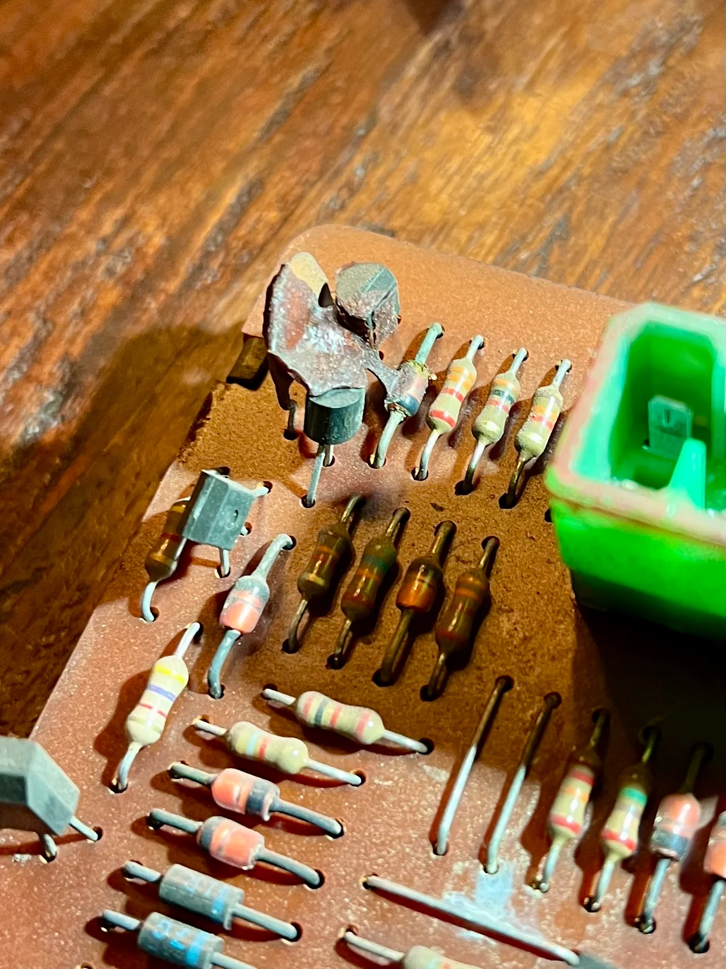

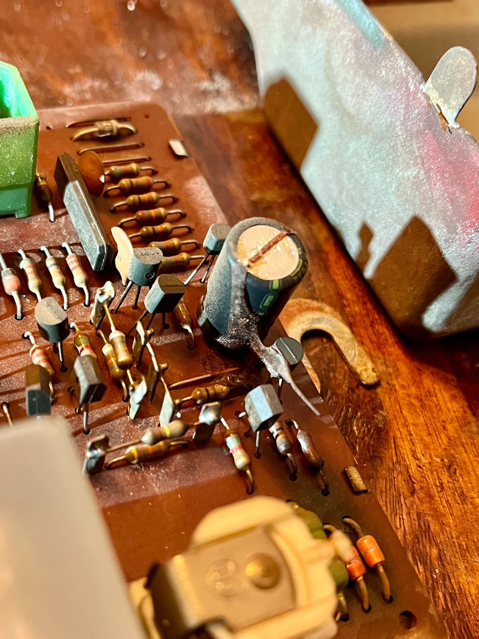

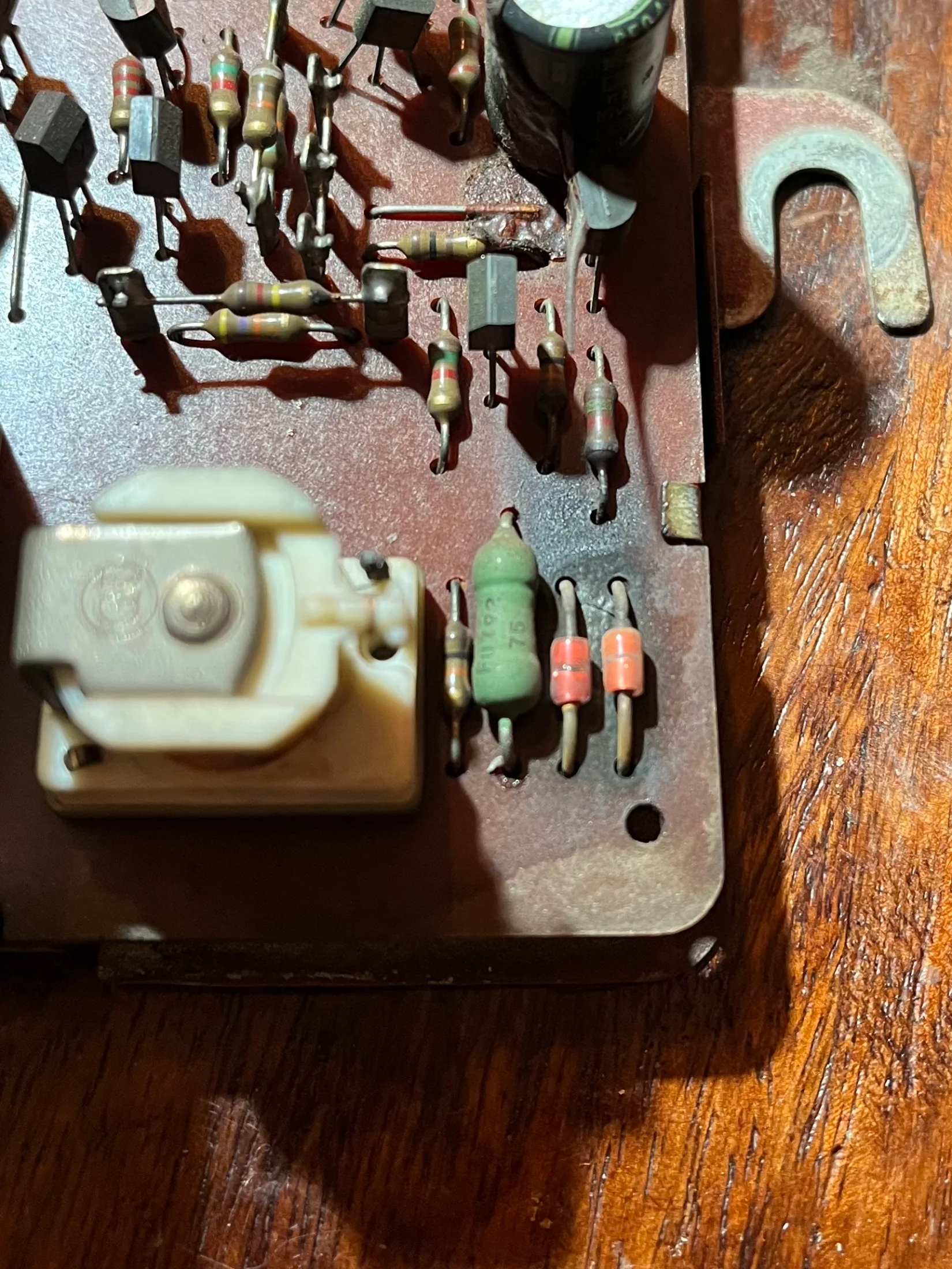

Whelp, found the problem, ha! I wasn't expecting so much gore on the inside of that fan controller. Looks like the cap done 'sploded and sprayed its guts around inside... I see some charring on the board as well. Lucky for me I have another controller en-route... Hope it's doin better than this one. If not, looks like I get to do some home electronics repair.
Looks like the truck is being consistent in terms of electronic gremlins, so in other words the sky is still blue :)
Update on the carb fan controller... I threw in the towel after screwing around with two non-working boards. Bought replacement caps, soldered 'em in, floated any loose connections... Nothin. I thought about mapping out the circuit, learning some basics of electrical engineering, but my list of projects isn't getting shorter, so I punted. @Engineer8000 to the rescue, he had one for sale, priced fair and he shipped it fast. And boom, I'm up and running! It's working as intended, and I have way easier starts on a hot day after the truck has been parked.
