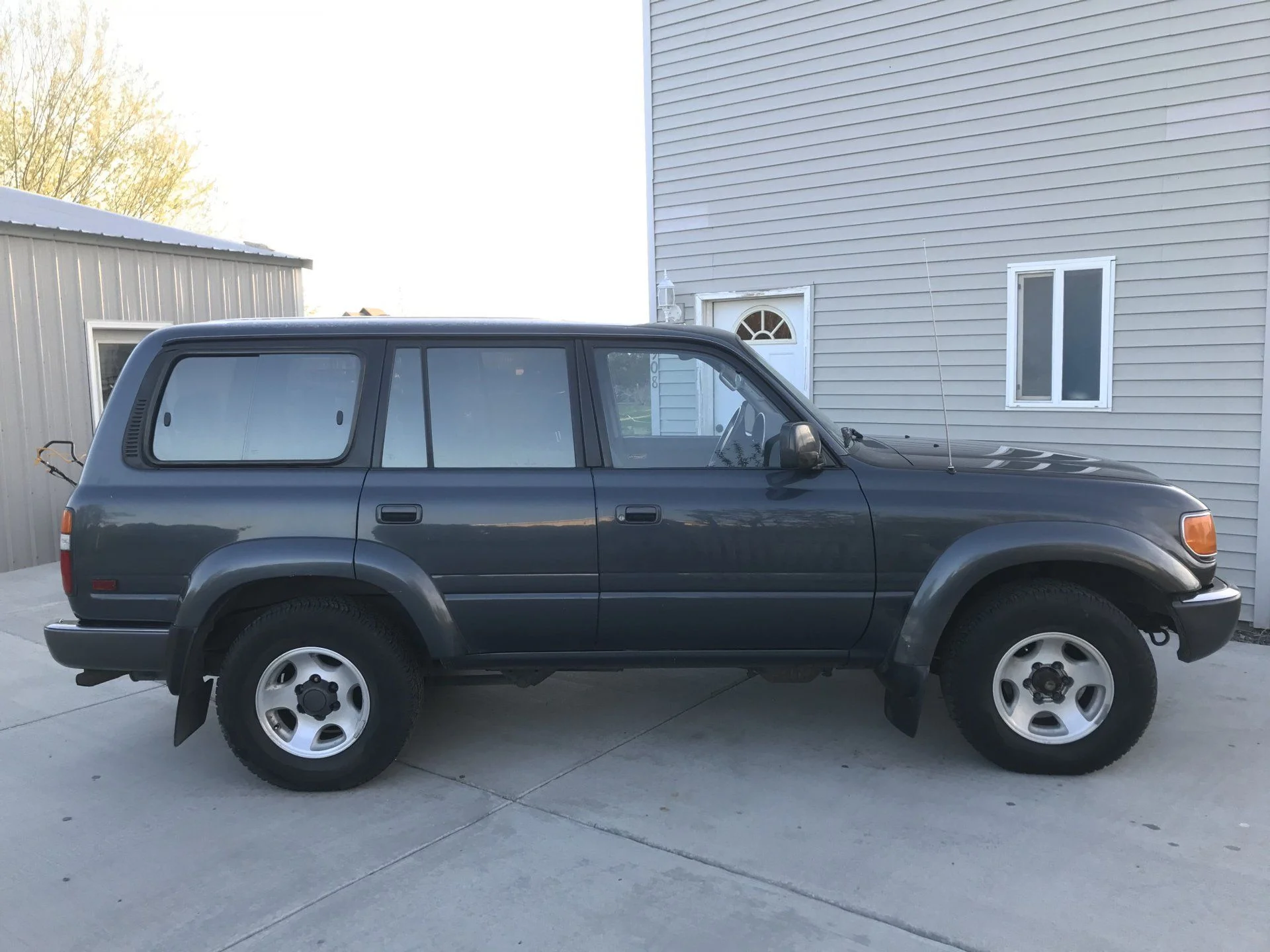

Here is a couple pictures of what I got... 94', center lock only and 165000 miles.

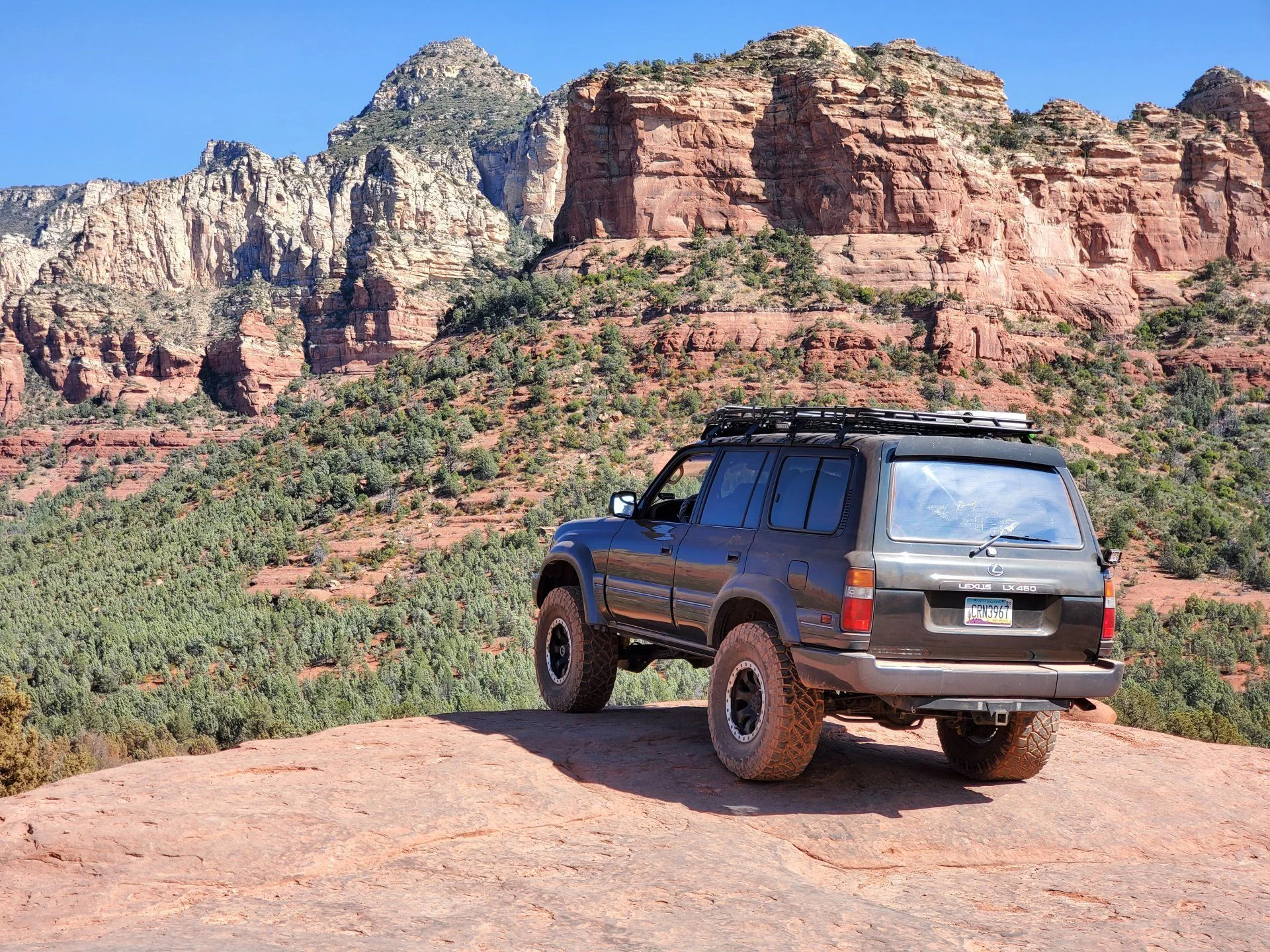

Dobinsons C97-144VT - front C59-615V Flexi rear. Ride better than worn out stock springs. Feels like it would take jumps well too. lol

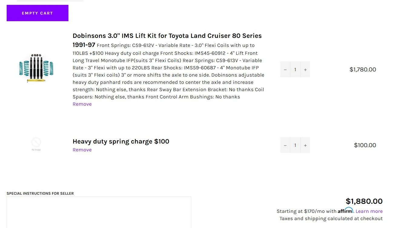

Thanks for the advice guys. Well, I think I'm going to cheep out a little bit and go with the 3" IMS kit, without the long travel portion. That saves me enough to get a front bumper kit and maybe a roof rack. This option raises new questions though...
With the 3" kit do I want the Variable Rate Flexi coils? Front & rear?
The options for shocks include the 4" lift shock with the Flexi coils, why would that be? I could go with the Linear Rate coils, but the Flexi Variable Rate coils are only $100 more, is there an advantage to getting them?
The 3" kit includes castor correction bushings, front sway bar extensions and rear LSPV extensions. Will I have any issues with the stock panhard rods or break lines?

I would send David Attero at Dobinsons a PM. I ordered parts and had to ship them back since they were not correct. They have tons of suspension offerings and he will be able to help you out.
Flexi coils offer more travel and you will need a longer shock to take advantage.
I dont think you will regret the IMS shocks. I can't comment on the dobinsons yellows but the IMS are amazing compared to the OME.
I think the biggest suspension tip is to plan it out with the final build in mind. Don't be a dork like me and waste money changing it out.
I am running the 2.5" VT up front and I'm getting almost 4" of lift with a winch up front. I am having front driveshaft issues. The 3" VT rear is slighlty higher.
I would recommend the 6" shocks with the VT springs to get the most out of the springs. I'm running the L version of the BP-51s 4" shocks and it is not using the full capability of the 2.5" VT spring.
With the 2.5 VT front and 3" rear, I had to do caster bushings, rear panhard lift, and slee weld in pan hard adjuster in the front. I am also running a Whiteline HD rear sway bar and I'm upgrading the front sway bar shortly.
Without the caster correction I had death wobble and the caster was at 3.5 degrees, and without the rear sway, it was really tippy in the corners and handled very poorly.

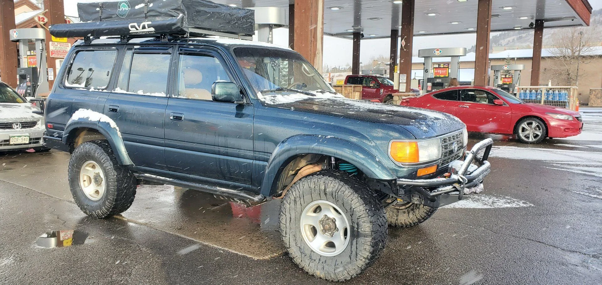

I just installed the 146vt and 147vt advertised to me as 2.5" springs for use with the 4" shock for maximum travel. I went with the IMS shocks over the regular yellow so perhaps travel is different from the general lift height number.
I just measured after 45 miles on the springs and I am seeing 23" front and rear hub to fender.
Tube bumper and winch up front. Double swingout and drawers in the rear.

Would you say the 2.5" resulted in about 2.5" of lift? Since I'm leaning toward not replacing the panhard rods, at least not at this point, I don't want to get so much lift that I end up needing them right away. How does your rig handle on the road? Can you post a picture of your rig?

That is how it is currently sitting with a fresh install. In its natural habitat at the gas pump.
I think the lift height numbers Dobinsons advertises are for a fully loaded expedition rig. The folks in OZ tend to throw a lot more weight into theirs.
For example in that photo the rear is sitting just under 3" of lift with a 4x4 labs rear, some gear in the back, the RTT, and a drawer system loaded with all of my tools. My rig is about 5700 lbs with two passengers and no camping gear.
