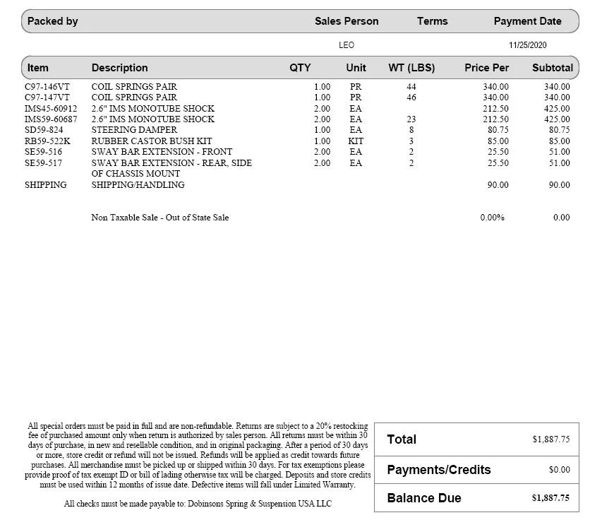

Well, its a done deal. Suppose to get the kit about the end of December. I appreciate the advice guys. I’ll journal the install and start a form to post the pictures on! Now…. what bumpers?
Nice job on getting some good springs! Money well spent.
I would pick up a cheap strut compressor. Makes installing a little easier.
The trail gear front bumper is cheap and just fine.
Castor bushing are the absolute last choice for castor correction. Considering your choice of springs and shocks, I assume you plan to do some wheeling. Why not do it right and buy new radius arms or at least use castor correction plates. If you flex the suspension hard those correction bushings won’t last even if they are “rubber”.
I can go through oem bushings every couple years and they have the bolt hole centered in the rubber bushing mass.
I will definitely be up grading more over time. I will prob see what I get for a Christmas bonus this year and maybe get the plates, Panhard rods and upgrade the sway bars. I suspect that once the lift is installed I’ll have a better idea of what I need to do next. 👍

I had to call and request this kit. I talked to Leo and he knew exactly what I was wanting. I got the impression that he’d had this request before. Basically it’s the basic 2.5” IMS lift kit with the tapered long travel coils and 4” IMS shocks. If you select the basic 2.5” IMS kit online, the tapered coils aren’t an option with the basic kit, and I’m not sure what length shock come with the basic kit. It’s 15% off until the end of November.
