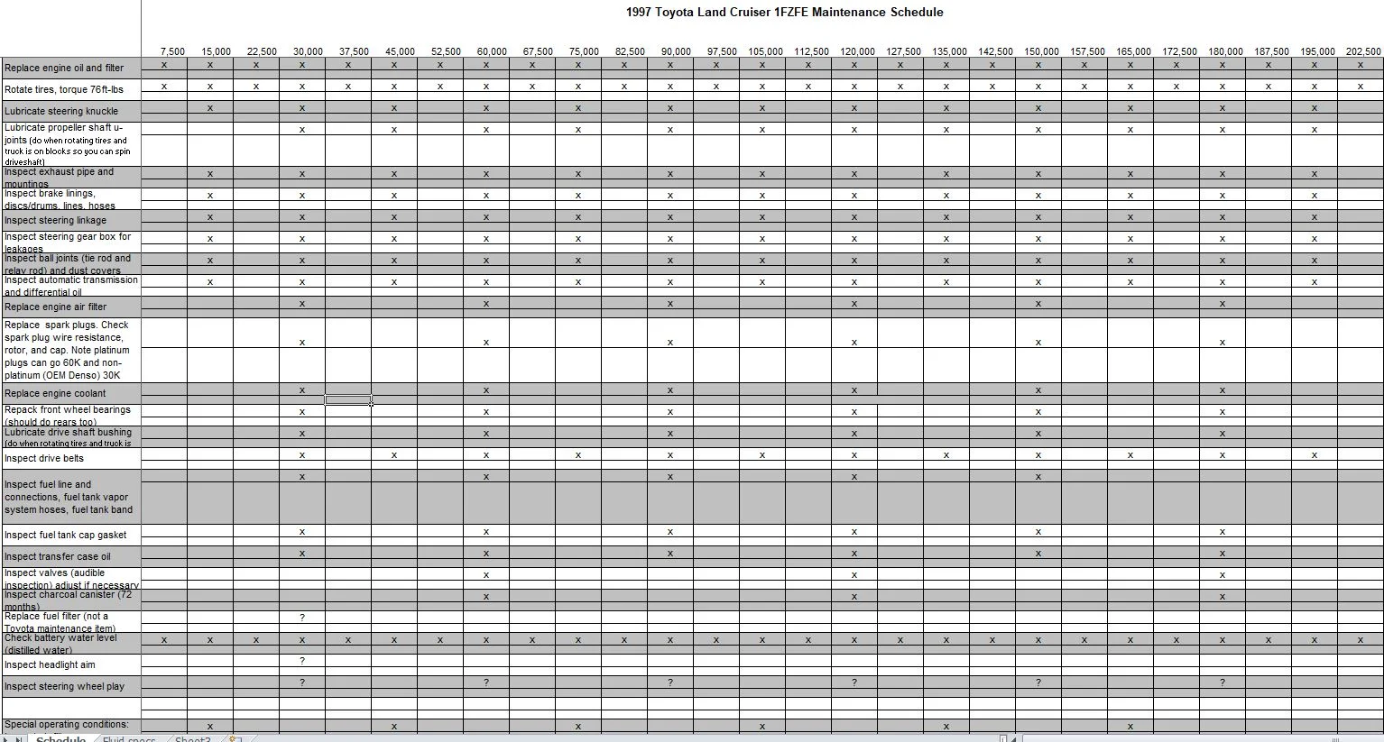

Here's a couple of schedules, one for the 80 Series (normal service) and one for the 70 Series just for comparison (click twice on the image below to magnify)
