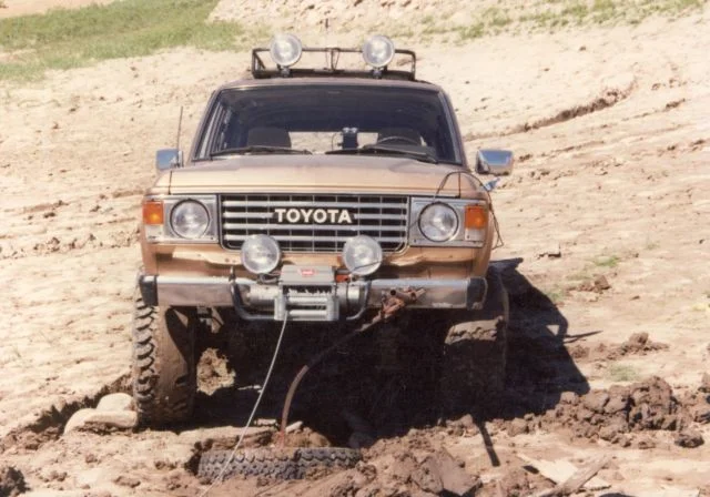

The only time where the hi-lift was essential when we had to lift the corner of a truck out of a hole, and have the vehicle drive off the jack :hillbilly:

Yes, but I suppose you can guess what the fender of that particular vehicle looked like after this endeavour...:hillbilly:

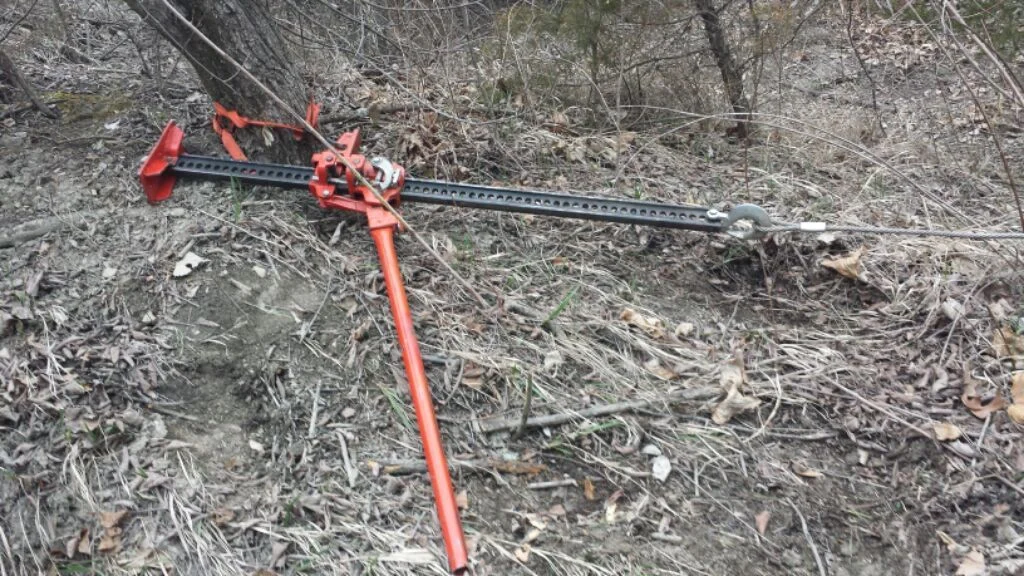

The last time I needed and used my Hi-Lift

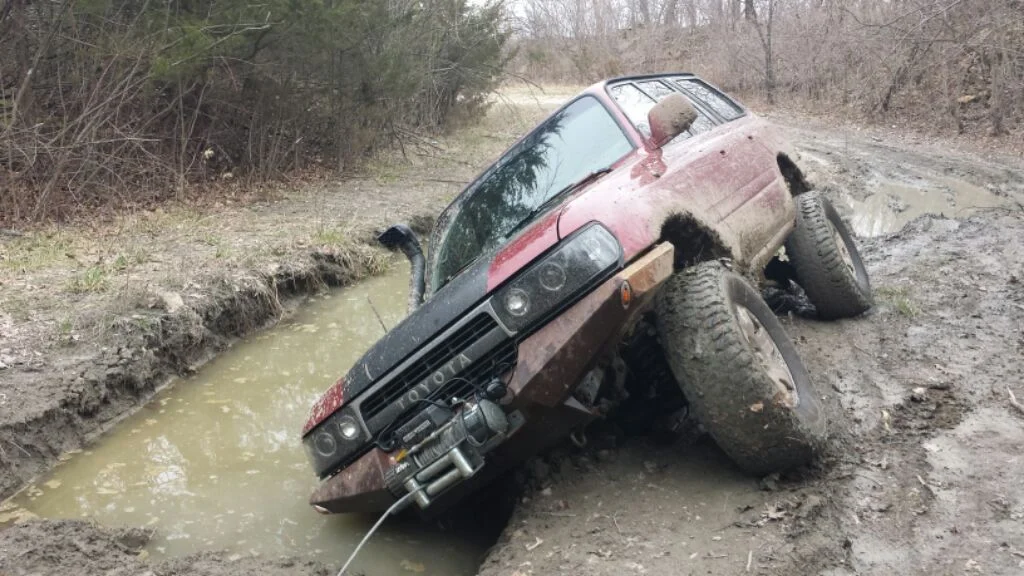

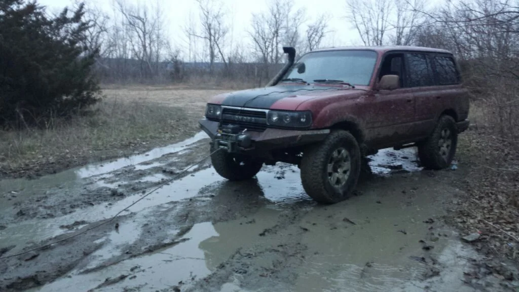

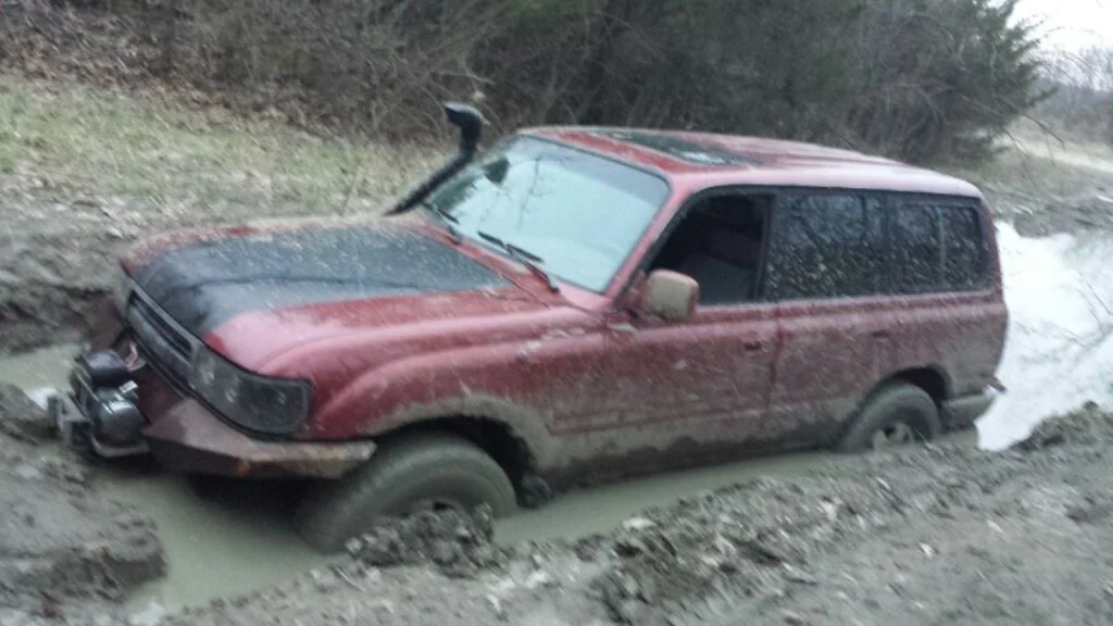

Was out wheeling alone today and got stationary (you're only stuck if you have someone else get you out right?). My first thought was, "it's a good thing I have a winch"! My second thought was, "it'd sure be nice to have a winch that works, rather than one that I tested yesterday, which doesn't work today". Then, I thought several other things before I thought, "I do have a high lift winch!,.... er Jack. :) That's when things started getting better.
Was out wheeling alone today and got stationary (you're only stuck if you have someone else get you out right?). My first thought was, "it's a good thing I have a winch"! My second thought was, "it'd sure be nice to have a winch that works, rather than one that I tested yesterday, which doesn't work today". Then, I thought several other things before I thought, "I do have a high lift winch!,.... er Jack. :) That's when things started getting better. View attachment 1052071View attachment 1052073
Damn! How do you slide into that from what looks to be flat land?
Well, the funny thing is I was trying to line up for a small Hill, and my spotter said I was past the threat of the pit, oh wait, I didn't have a spotter.
Why must everyone get worked up about details anyways? :-p

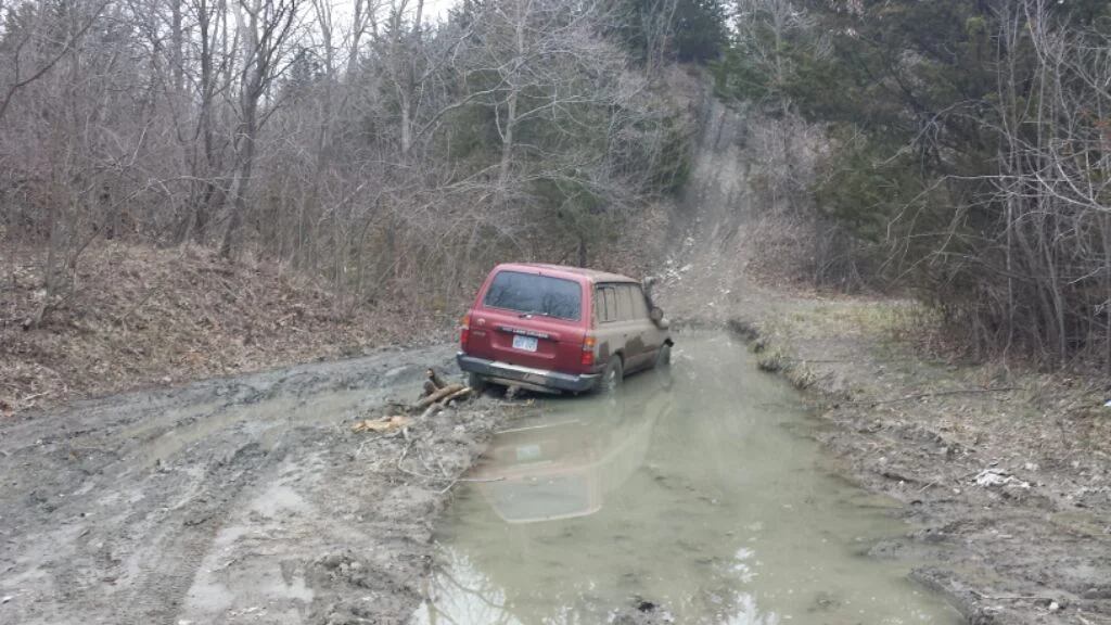

The LC had already been moved back under its own power at this point, but this pic shows the hill best.
I know how he did it, watched two guys in a row do this one day. You think you can just edge along the side of that puddle but the slick mud will slip out from under that side of the vehicle and away you go. Lucky you didn't roll that thing. @superstan26 whats up with your winch, is that a Badlands 12k ? I just bought one and I'm hoping it doesn't leave me stranded.
That's exactly what happened.
I was trying to go around the mud pit because "IH8MUD", (the fact that I was alone had more to do with it) and as I was lining up for the hill I was creeping along the edge of the pit when the wall collapsed under the weight of my tire causing me to slide in. I got the pucker effect, but all was well in the end.
My winch was a badlands 12k, and I honestly think that the problem was likely a bad connection somewhere, but I checked what I could and nothing changed. Time wasn't on my side so I decided I'd do what I could rather than spend what could potentially be a lot of wasted time trying to troubleshoot.
I exchanged the winch at HF, and upgraded to a wireless controller while I was at it.
