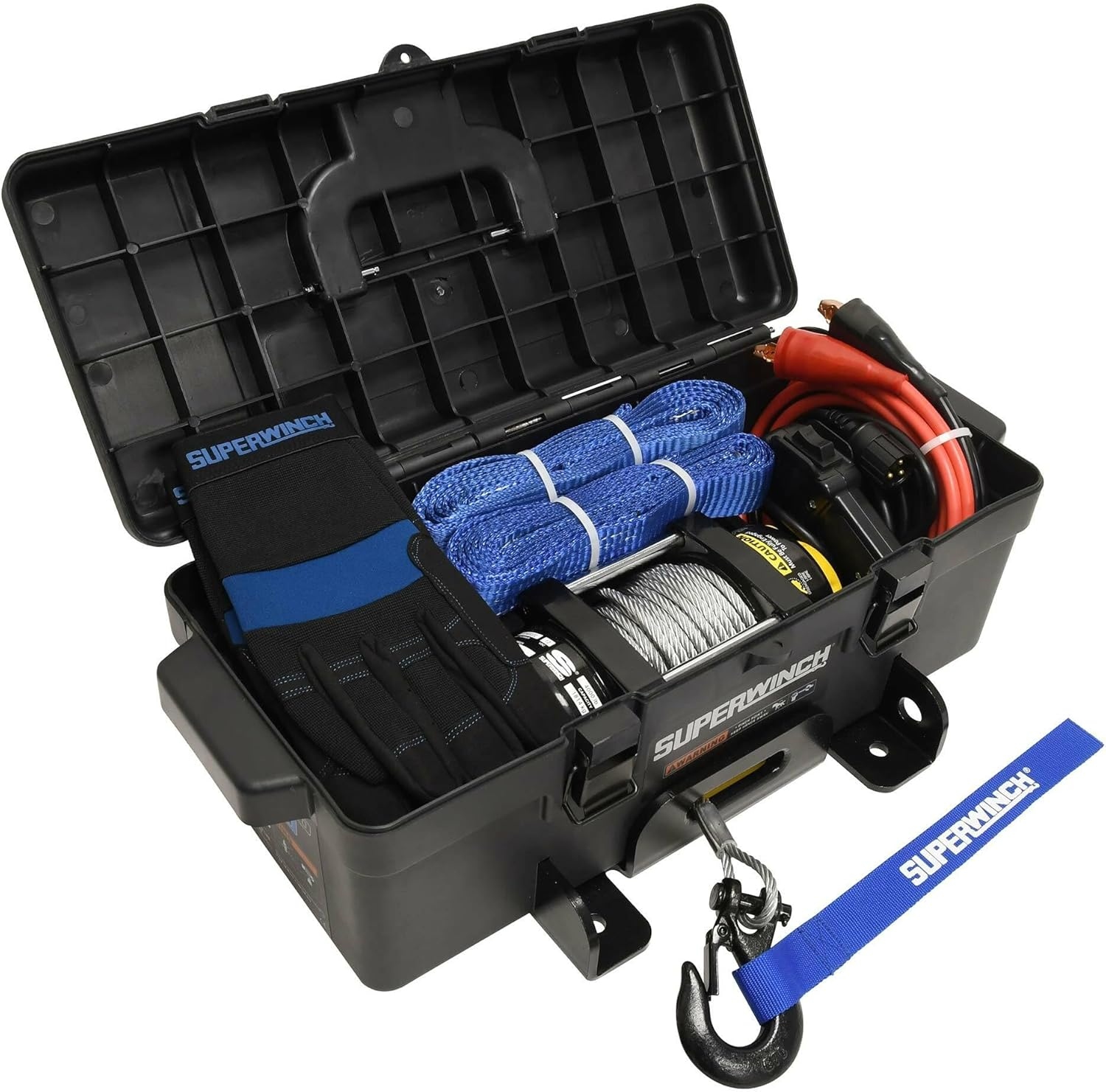

This exists. At least a few mfg make them. Winch in a box. Strap winch to front of van with included straps. Connect to battery. Pull. Pretty straight forward.
If you want to do it with your existing winch - buy a toolbox, a few lengths of steel angle and a mount plate and you could make one yourself that bolts together without an welding needed. But like everyone else has said - it'll be absurdly heavy and difficult to use. And probably cost about as much as a portable winch kit.

But take it small step further. @Plumber101010 Weld a 2" receiver end right at the frame end on either side. That's a $20 piece,
then take this winch in a box idea cause it's all enclosed and can sit on the floor without being a tripping hazard. but weld a receiver
piece to the frame of that winch in a box. Now you got portable removable winch. Doing exactly what you want.
Problem solved.
