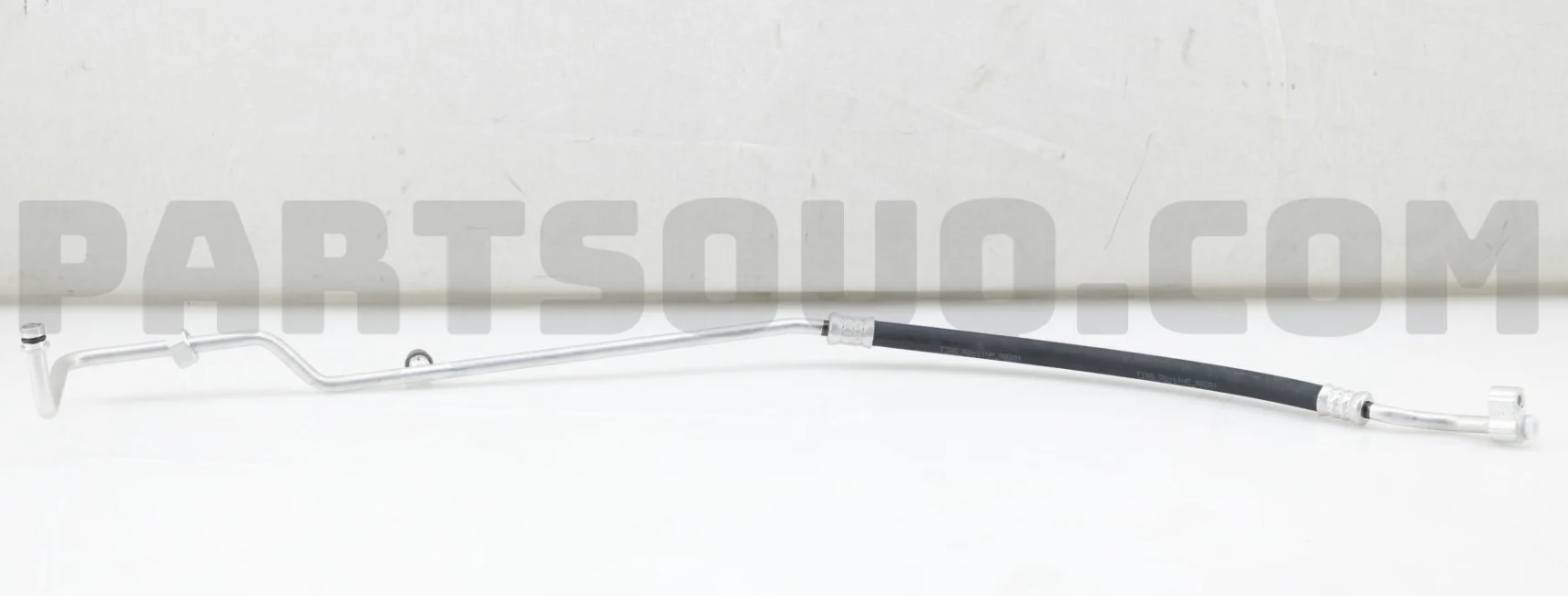

I really want to DIY the AC recharge, but AC work has always seemed like a dark art to me. The reason I want do DIY is because I replaced the HP line in 2020 and had it evacuated and re-filled. It stopped working 10 months later (due to a leak). I took it to a shop and they said they ran a vacuum on it and couldn't find a leak and asked me if I wanted to refill it, so I said yes... It stopped working like 6 months later. I took it to another shop and told them, look, it keeps losing refrigerant and I've filled it twice now and can't find the leak with the UV dye that keeps getting added. They said the same thing "Can't find a leak and it holds vacuum, want us to fill it up?" Leaked out like 2 months later.
Bottom line is, I've spent like $700 on recharging this system. That's why I am just replacing everything but the rear evaporator. I also picked up 9 cans of R134A at Wal-Mart when I was in Idaho because you can't buy it in Washington State anymore. But at this point I am also considering just replacing all the components and then taking it to the shop to charge it up and sell the R134A on the black market here for insane profits! MUAHAHAHAHA

have you changes out the low and high Schrader valves?
I second this. I had a leak recently from my low side valve. The one that came out was stuck in the open position once pressure was removed. It had no spring tension left. With a bad valve the system will hold a vacuum and keep pressure with the manifold gauges attached but it will not last in real life use.

I replaced the high-pressure line (very visible leak) when I first bought the rig. That's why it was evacuated and recharged the first time. I didn't replace the schrader valve on the low side though. I guess I would have thought if it was a big enough leak to run out that quickly it would have been obvious looking at the valve. I also did an AC sniffer test although the engine was off, so it wasn't under as much pressure as if it was running? Maybe I should also replace the low side soft-line while I am at it. I could replace the valve, but the crimped part of the line was what leaked on the high side.
That being said, there's some pretty obvious leaked oil/dye on the condenser, and the sniffer squawks on the evaporator, so I am pretty sure those were the big leaks. Thanks for pointing that out. I will do the low side too since it's all empty now anyway.
