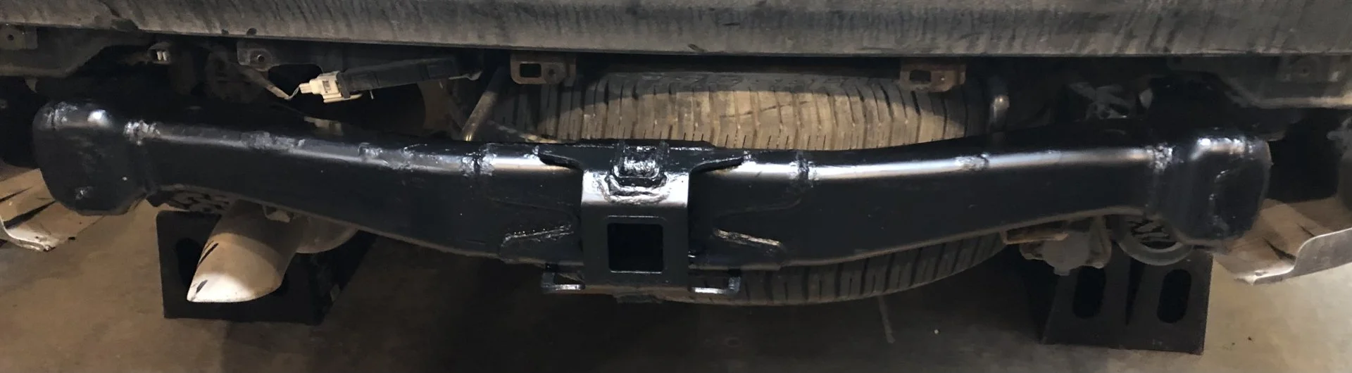

@tbisaacs, looks like you got the trailer plug to work w/o cutting that "bracket/brace"? My 2013 LC has the same brackets. Wonder what year they eliminated them?
My 2013 land cruiser didn't have that extra piece. Weird.
No bolted them straight on to the dissent bracket.
Really interesting difference. Not enough samples to figure if this is a model year difference or what.

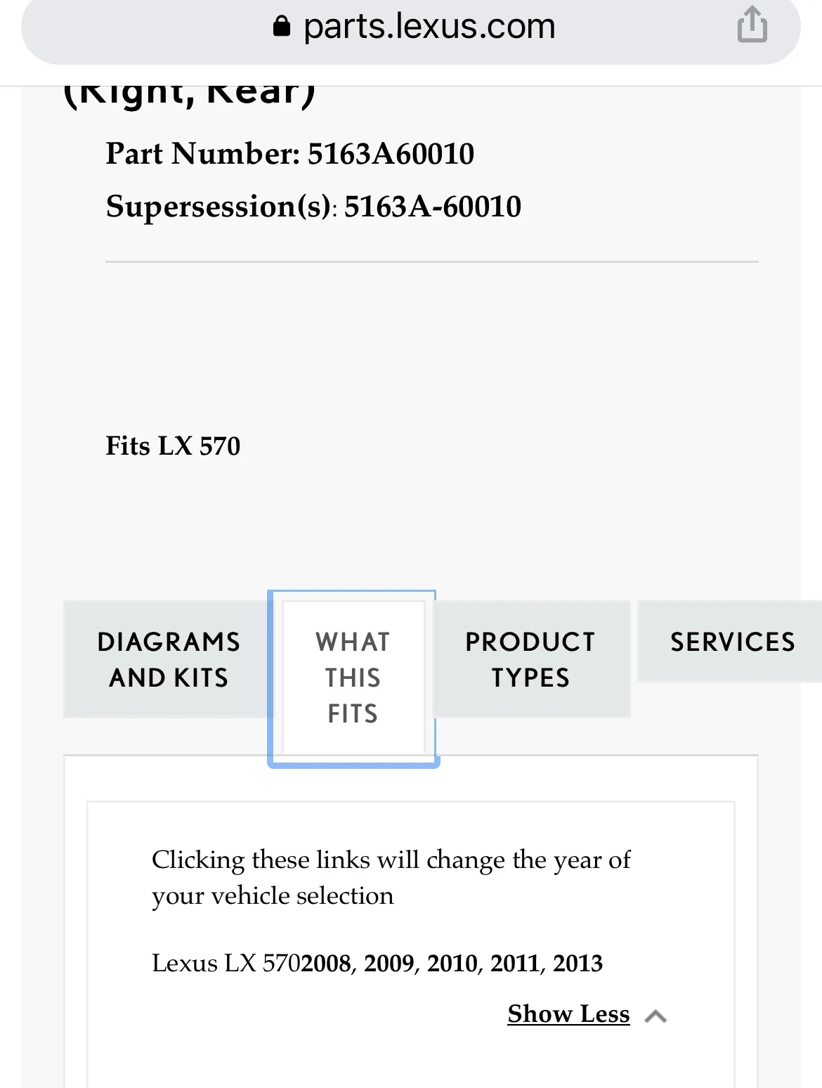

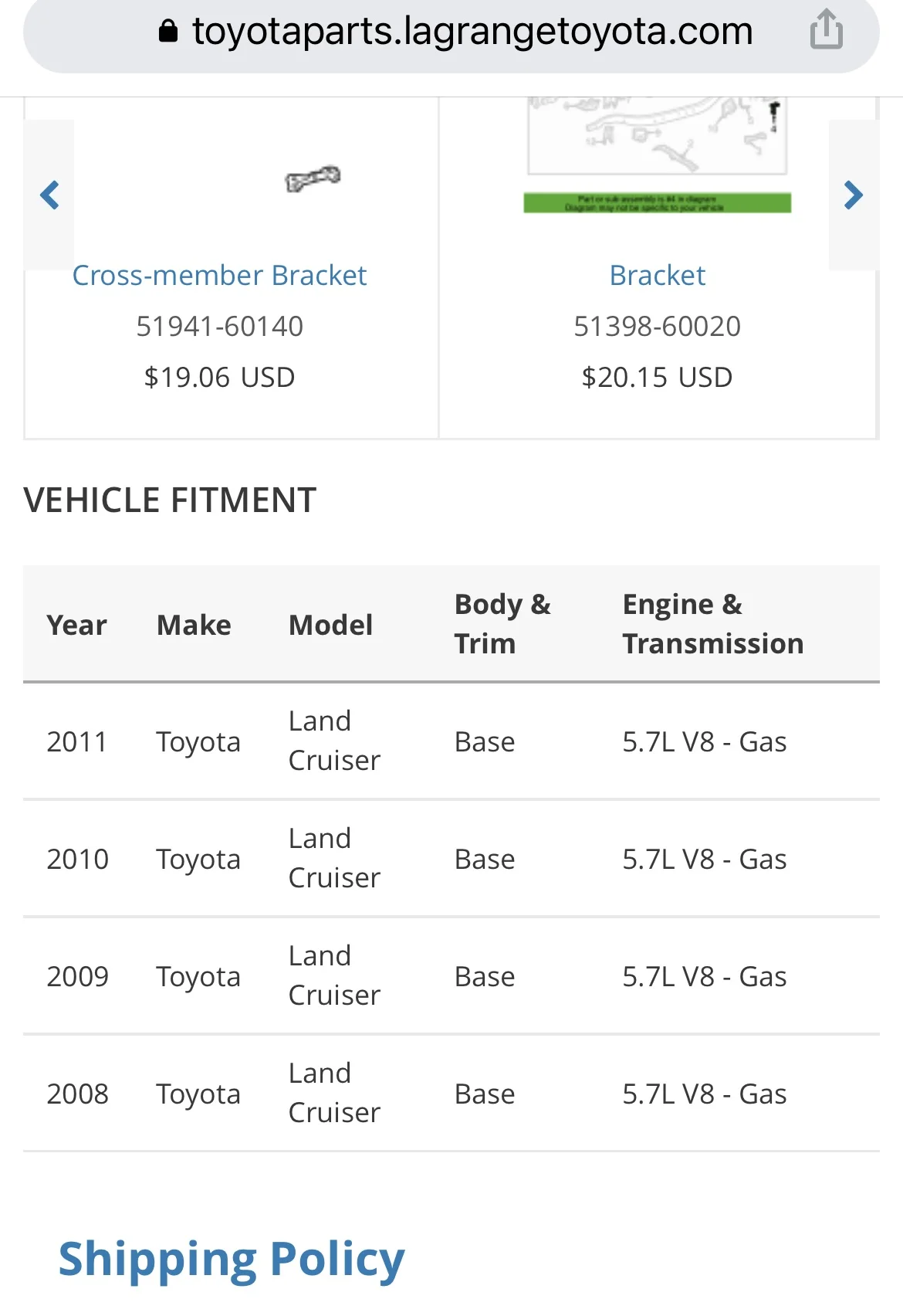

Part numbers show this applicable to both LC and LX - 5163A-60010. Part description shows it as a generic reinforcement...but for what? Towing? Crash? Will have to dig later when I get home.
Curiously the original LX brochures advertise a rear crumple zone. Perhaps this little thing is it? As the frame member alone certainly is not.

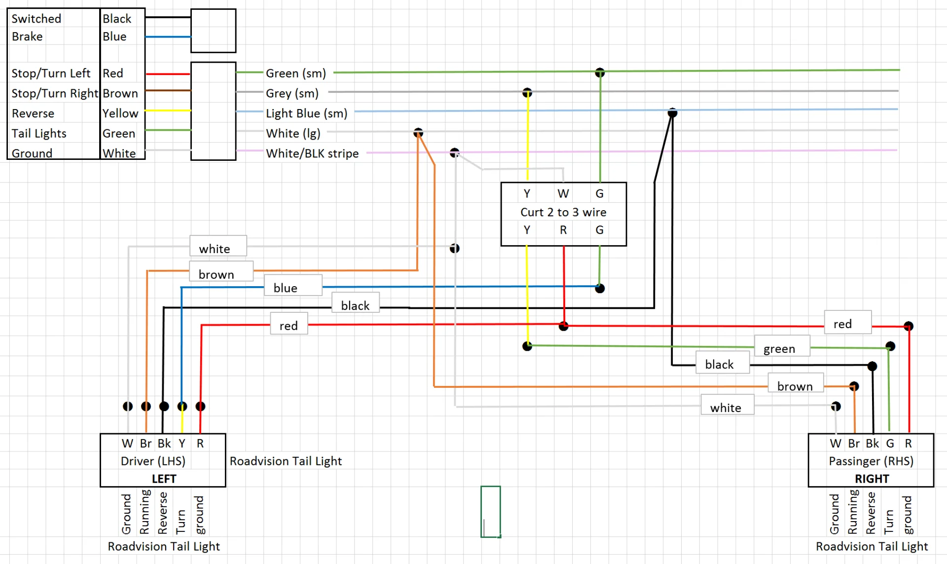

In case it helps future installers - here's a diagram of how to wire the road vision lights with a curt 2-wire to 3-wire converter. The blue wire (brake) and black wire (switched) at the plug are not used

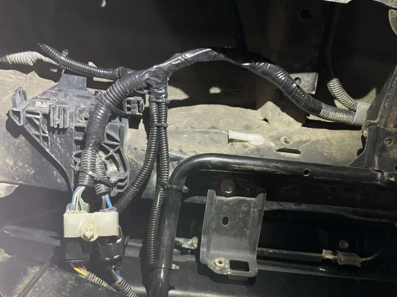

Wired my lights today and this was very helpful. I wired mine to the main harness going to the trailer plug harness simply because I didn't think ahead to tie into the plug harness itself. There is more room doing it this way but the other way allows you to make the whole harness on a bench which is easier than laying on your back wiring into the harness feed looms. I used this wire to run to the road vision lights:

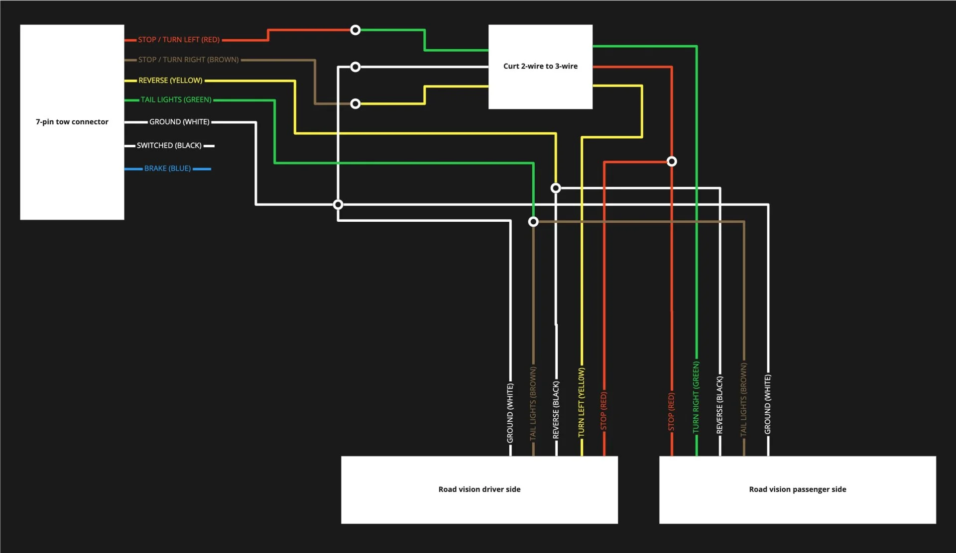

Here is my wiring diagram:
This is one of the projects I’m going to revisit this summer when it’s dry. I like the idea of tapping the harness like you did instead of the connector.
