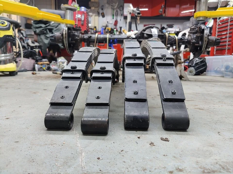

Here are the 4 of them, the rear ones have more arc into them.
I think this is only positive thing. The lower one is longer. Now you can get rid of the cruiser lean. Install the lowest spring to the right front and you’ll have perfectly leveled 40. Will not happen if the springs are the same height.

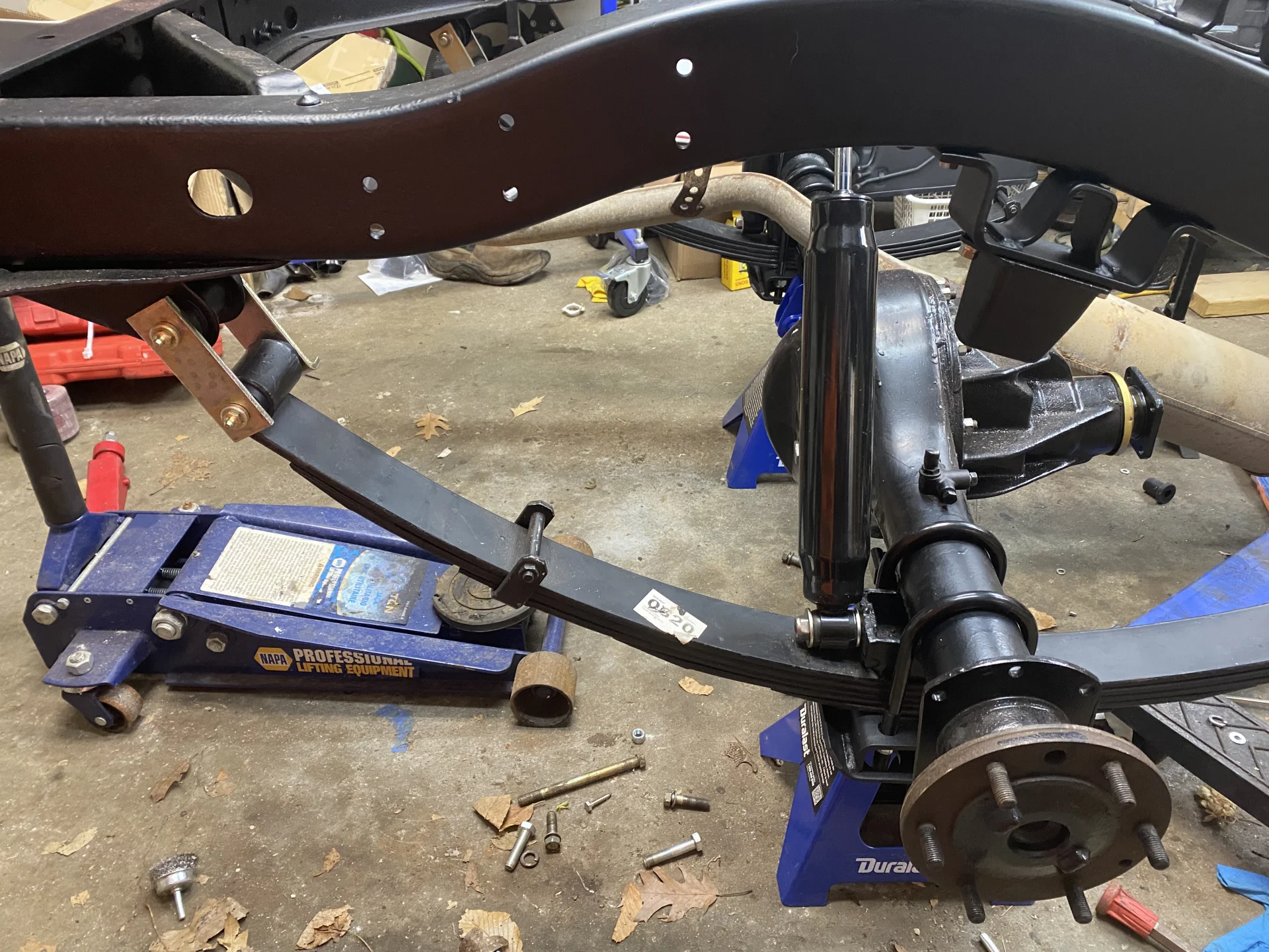

I too purchased a 4 inch lift kit from skyjacker, and this is what the rear looks like. Springs are the same length. WTF. Do I need longer shackles? I don't have any of the body on yet, but still, it seems like it won't settle into a decent shackle angle, and I didn't want big shackles because I was trying not to change the castor.
You need some weight on that thing man! The springs were designed for the weight of the body, and drivetrain, INCLUDING the top. Don't get all flustered until you have it all loaded up as she is going to be driving down the road.
Also, caster refers to the angle of the imaginary line drawn between the centers of the upper & lower knuckle bearing when looking at them from a profile view. What you meant to say is you don't want your pinion angle to change. Pinion angle is easily adjusted with steel shims if necessary. Way less work using shims than cutting off and rewelding to adjust the spring mounting pads.
thanks, you are right, I meant pinion angle. Thanks for reassuring me. I thought it would improve with weight. When the frame was jacked up and I was attaching the axle to the springs, there was no weight on it at all, but the shackle angle didn't change that much once I added jack stands under the axle and lowered the frame. These springs are stiff!! Should the pinion point towards the e-brake drum, such that lines drawn perpendicular to the pinion and drum are parallel?
:facepalm:
