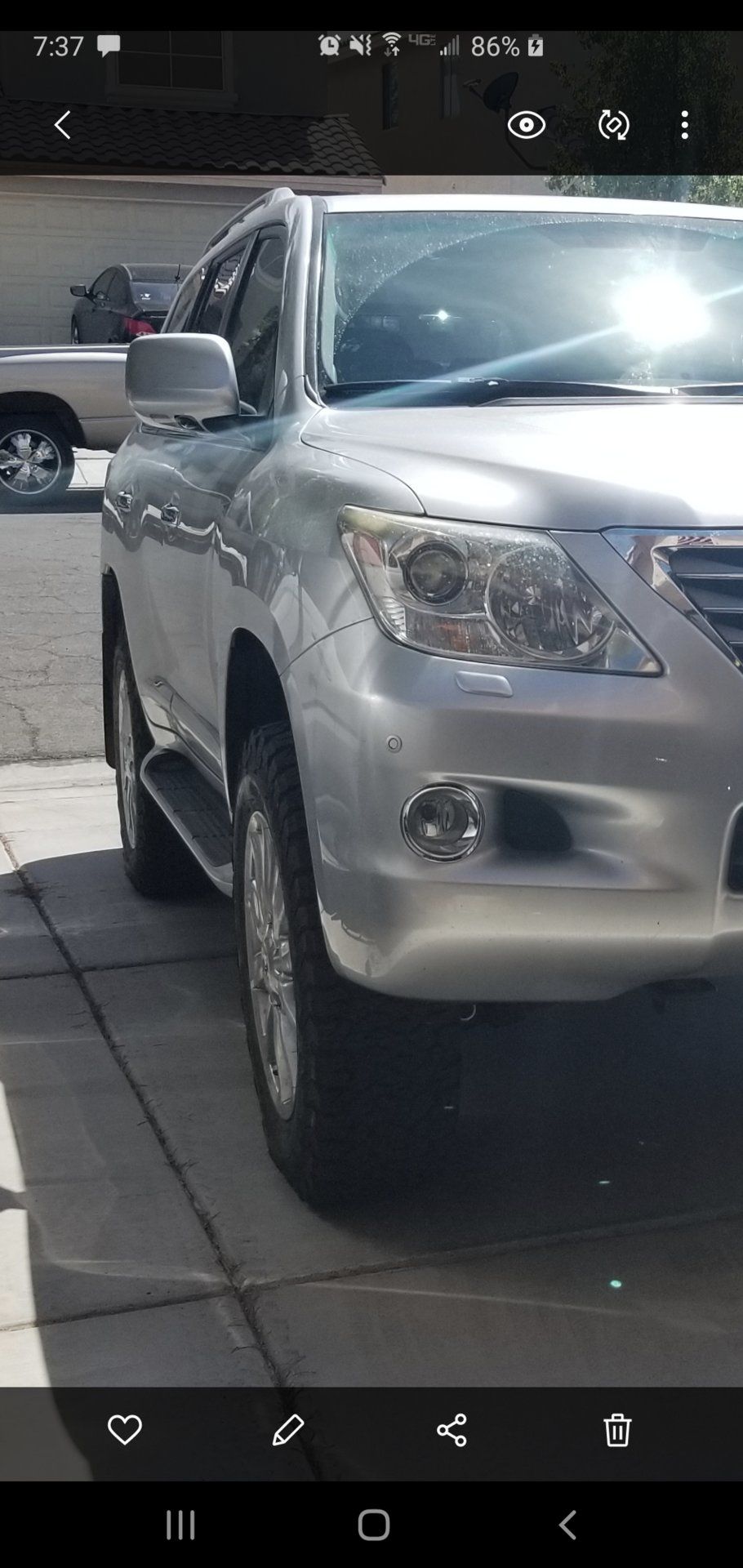

Can you post a picture from the front and rear along the side? Looking for perspective on how these fill the fender wells vs stock.
That helps a lot, but I meant more directly in-line with the edge of the tire. I'm curious where the tundra arms put the edge of the wheel in relation to the fender.
Thanks
Thanks
