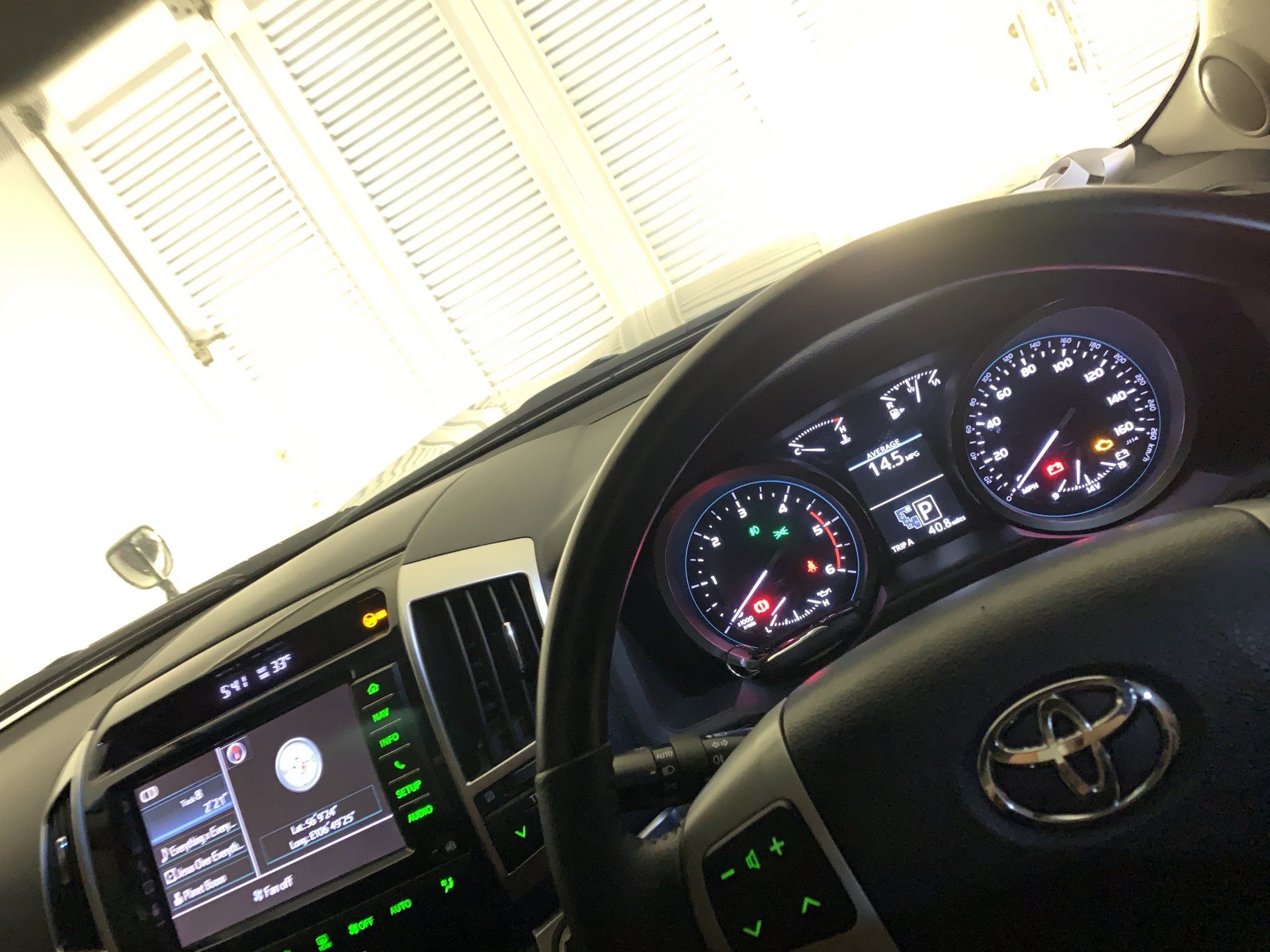

Hi all,
I just want to update information. I have deleted the whole AHC systems and been driving around since August 2020 and 5,000 KM without problems.
I am very happy with @turbo8's work. His work was really awesome and easy. Actually, I have been waiting for information about that since 6 years HAHAHA :rofl:.
Then, I have tested drive about 5,000KM. The result was successful and no warning or error display.
This is my car Land Cruiser 200 (VDJ200 UK version) below ;)
What I have done:
- Old man Emu Nitrocharger 2"
- Rear coil spacer OME2722
- Superpro UCA
When I turned off and removed the AHC system and converted to OME lift.
Here I have changed the OME lift with superpro UCA below..
BEFORE:
AFTER:
Both the engine check light and height sensor errors will not come out on speedometer display.
Thank you very much to @turbo8 for helping. His information was really helpful :).
