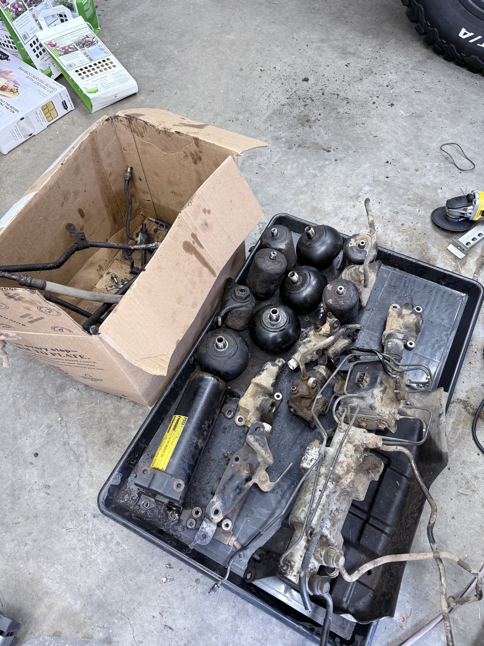

Disabling the AHC and AVS systems, no warning lights.
So, installing the shocks and springs is the easy part…
I’m down to the passenger rear valve block and then will pull my dissent bumper and slip the pump out.
There are two really long lines that are above the gas tank / exhaust that I’m not mad enough about to extract.
This stuff is seriously heavy (in a robust way). Factoring in the hardware and guards For the accumulators, I suspect it’s 150+ pounds. Will throw it all in a bucket and weigh it once I’m done.
It is so nice having all that free space and not worrying about it getting damaged.

After seeing how crusty all of the lines and components are as in removing them, I feel good about my decision.
