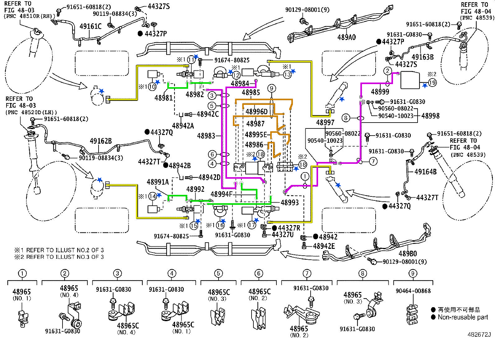

I'm in the process of removing the AHC components on my LX at the moment. I added some color over the AHC lines in the diagram to make it easier to read. Blue stars indicate components that I intend to pull. Hopefully this will help to make the job easier for others in the future.
I still have not pulled the reservoir in the rear, I believe everything else has been removed on my lx.
