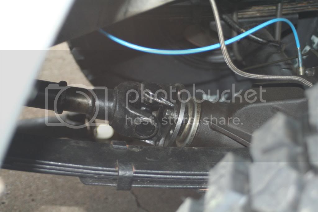

Front pinion angle- a little steep but just fine:

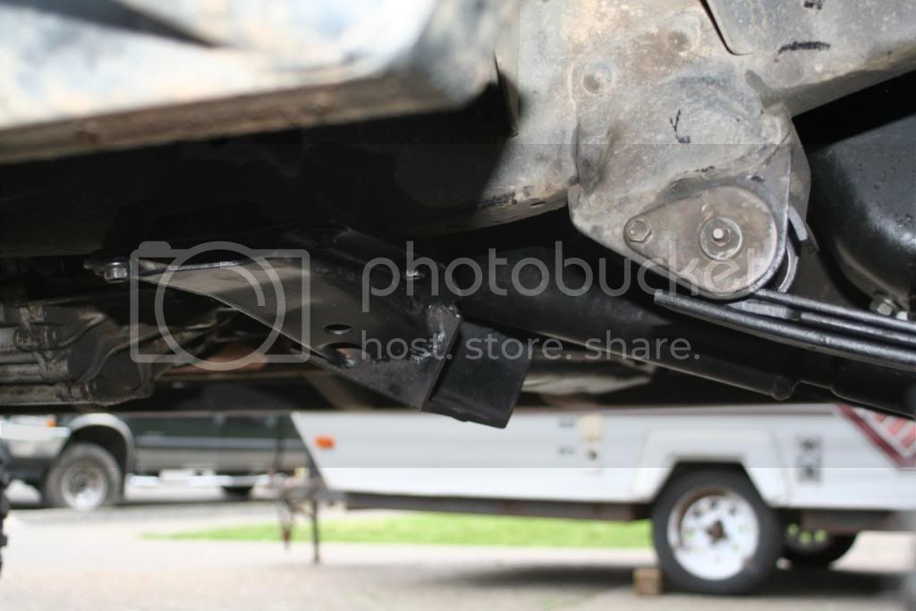

Cross member cut and welded for front driveline clearance:
Rear driveline and another angle for cross member. Also another view of front pinion angle. Looks worse than it is in this pic:

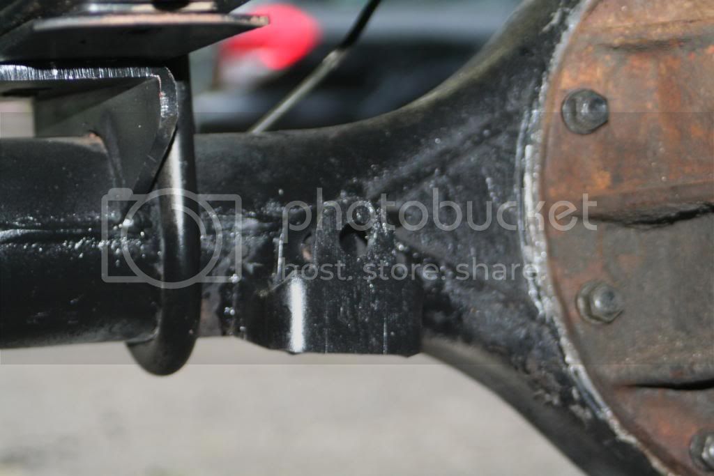

Rear lower Ruff-Stuff shock bracket pic for Drew:
The front pinion angle irks me a bit but not much to do about it now. It will wheel just fine. The rear lower shock brackets are nice quality however I am going to have to grind down a nut to get it to fit the axle tube side of the mount. Ruff-Stuff needs to make these about 1" deeper. No big deal as I figure I will just put a tack weld on the bolt head to help keep things tight.
