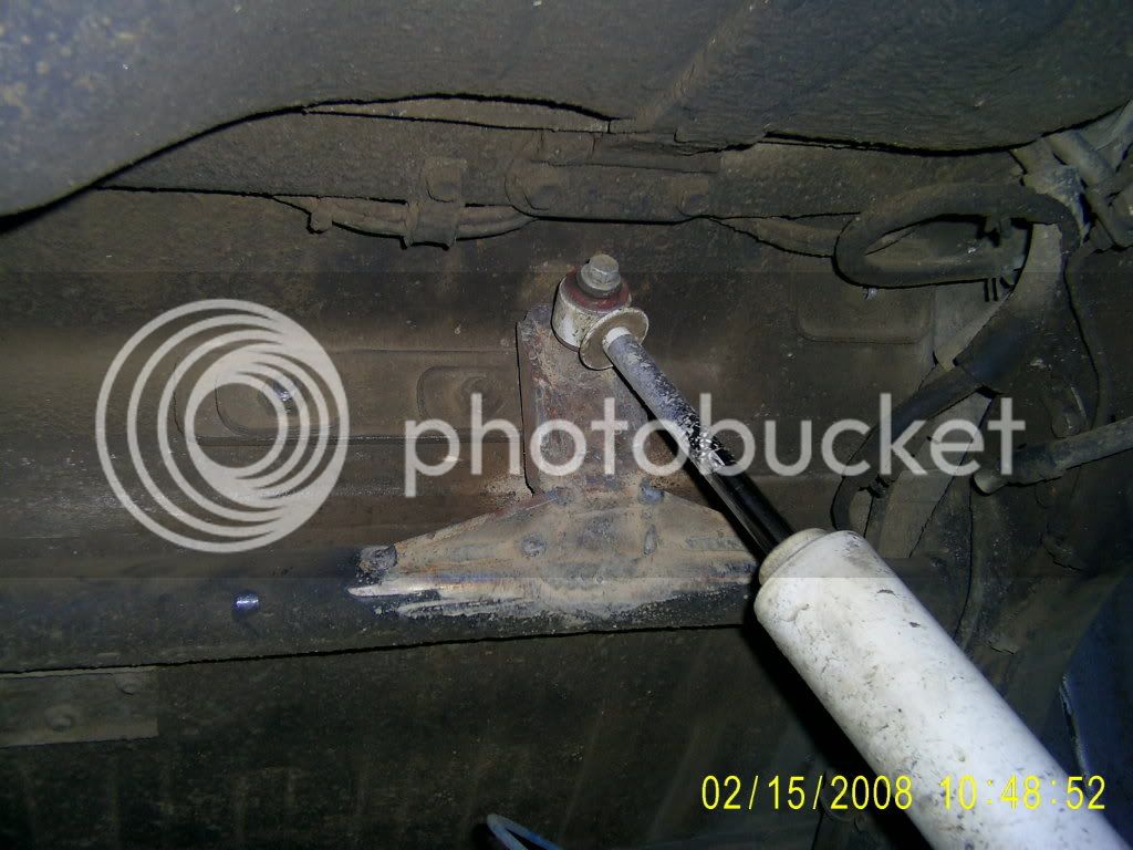

One area I will continue to address for at least one more step is the shock set up. I was running 10" shocks in the rear (and still am in the pics) through Rubicon but was afraid of bottoming. I ended up puting long bump stops in there to limit travel. I am pretty sure I would have wheeled a bit better through the Con' if I had some more flex. After discussing some things with Mike we jumped on it a few weeks back. I wanted 12" shocks in the back and so we welded up some extensions.
They are 3/16 and 1/4 plate with the stock shock studs cut and re-welded on the top. I will later drop the lower brackets and make some skids to be able to max out the 12" shocks.
Left rear:
Right rear:
They are heavily gusseted and thanks to Mikes killer upside down welds they are solid!

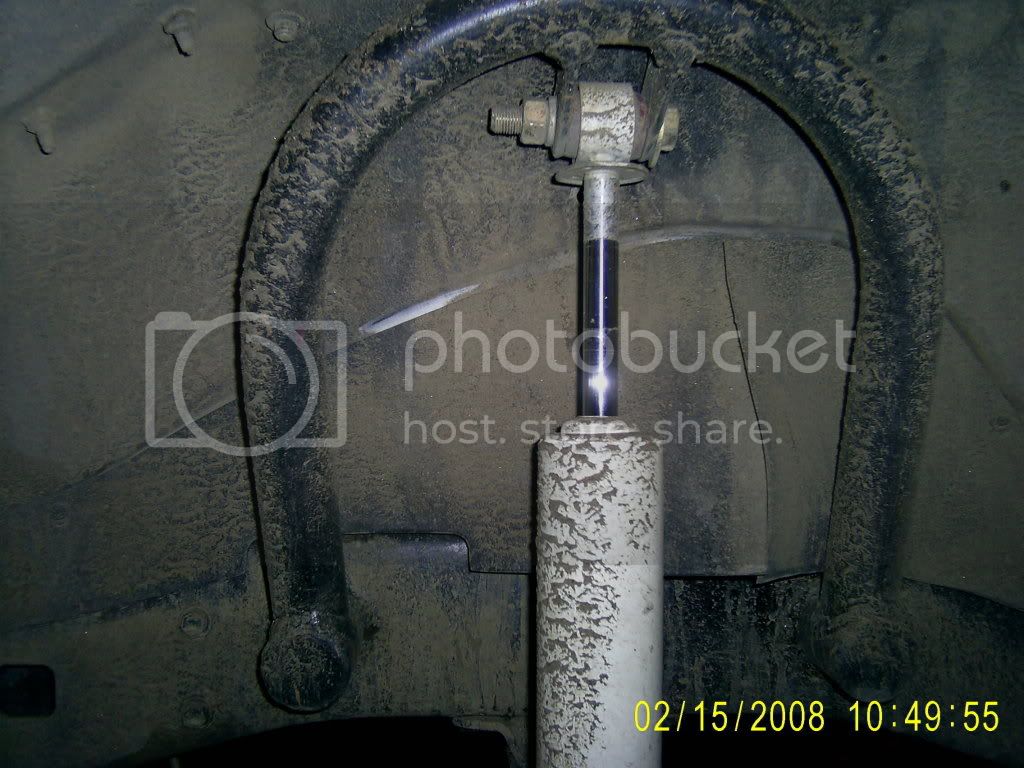

The other area I wanted to address was the front shock towers. Although Ford towers are a great and inexpensive way to get your shocks mounted up I never really like the set up and looks. After a rally session through baby doll heads at 45 mph I managed to rip off the drivers side tower. Found that I had some poor welds and never went back to clean them up. I dug and dug for some different options and found that 4xinnovations here on the board had some universal cut and weld your own shock hoops. I took some measurements and they were a perfect fit!
I had to offset the hoop on the drivers side to clear the steering box but I fits really well:
On the passenger side I was able to center it:

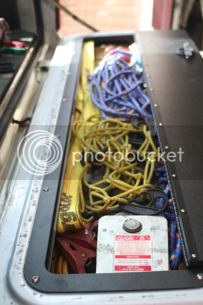

I was able to empty out my 10 Gallon tote of recovery gear and put it in the tailgate! I still need to line the tailgate with something and am thinking that I will hit it with bedliner when I get to my rocker panels.
