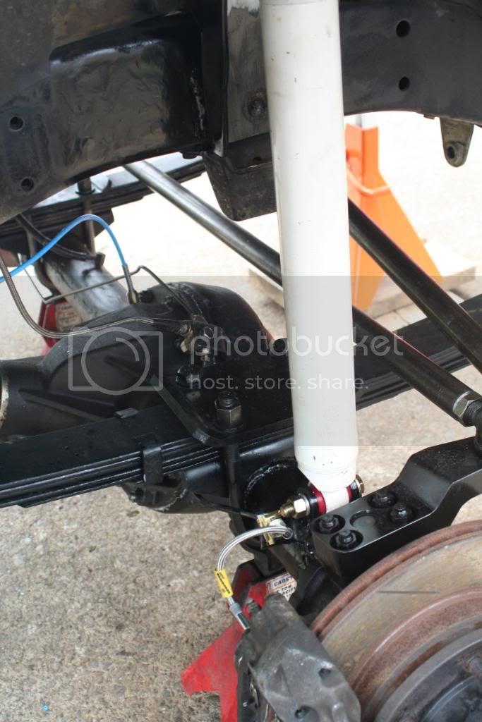

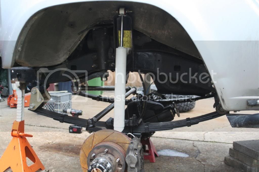

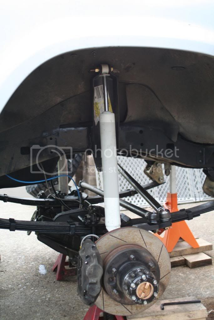

Passenger side:
Drivers side:
Front brakelines/ lower shock mounts:

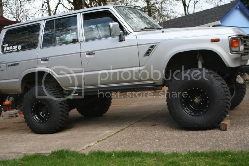

Check it out suckers:

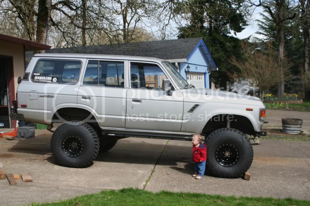

Pic from a 4 year old, nice angle if I do say so myself:
