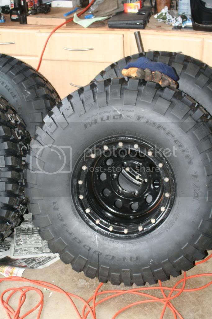

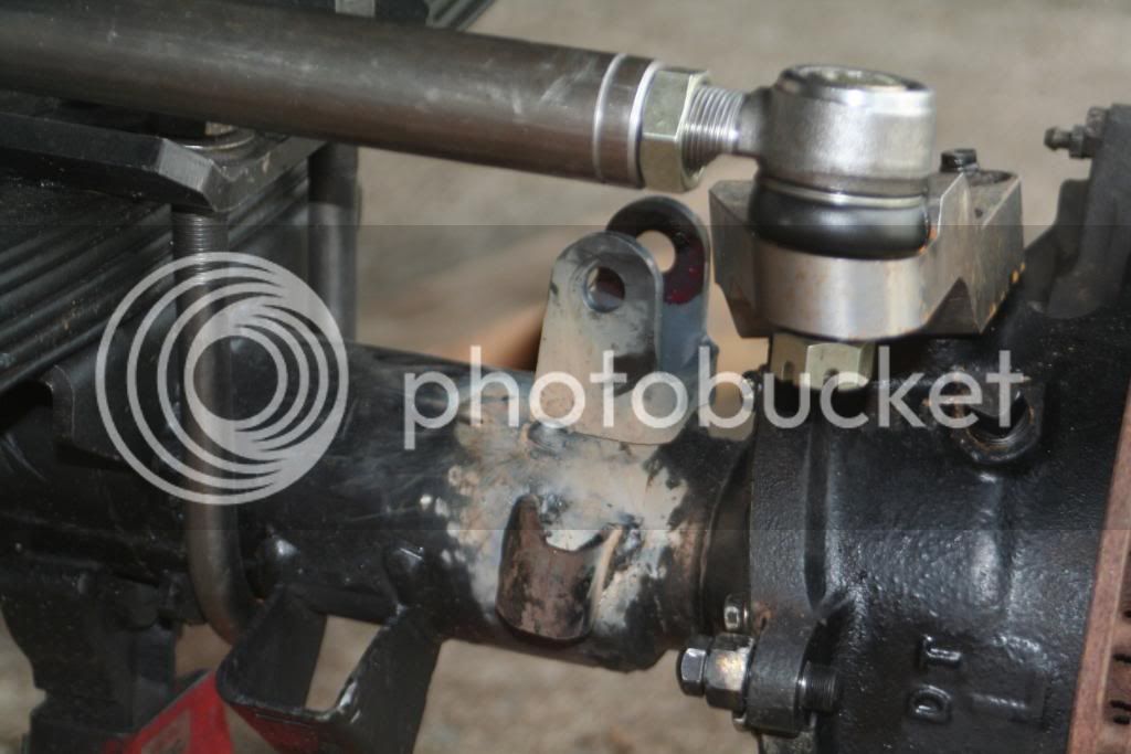

Got a few hours on the truck today. I am fighting the weather, being tired from lack of sleep and issues with the wire feed on the welder. I did manage to mock up and tack up the shocks and brakes.
Tomorrow will be a good day with some help from my brother-in-law with finishing all the loose ends. Plus I was able to sort out the wire feed issues so the welds will actually look decent.

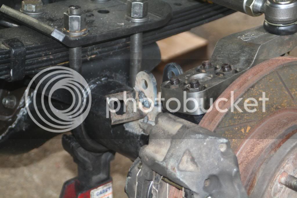

Front lower shock mounts:
Front brakeline tabs:

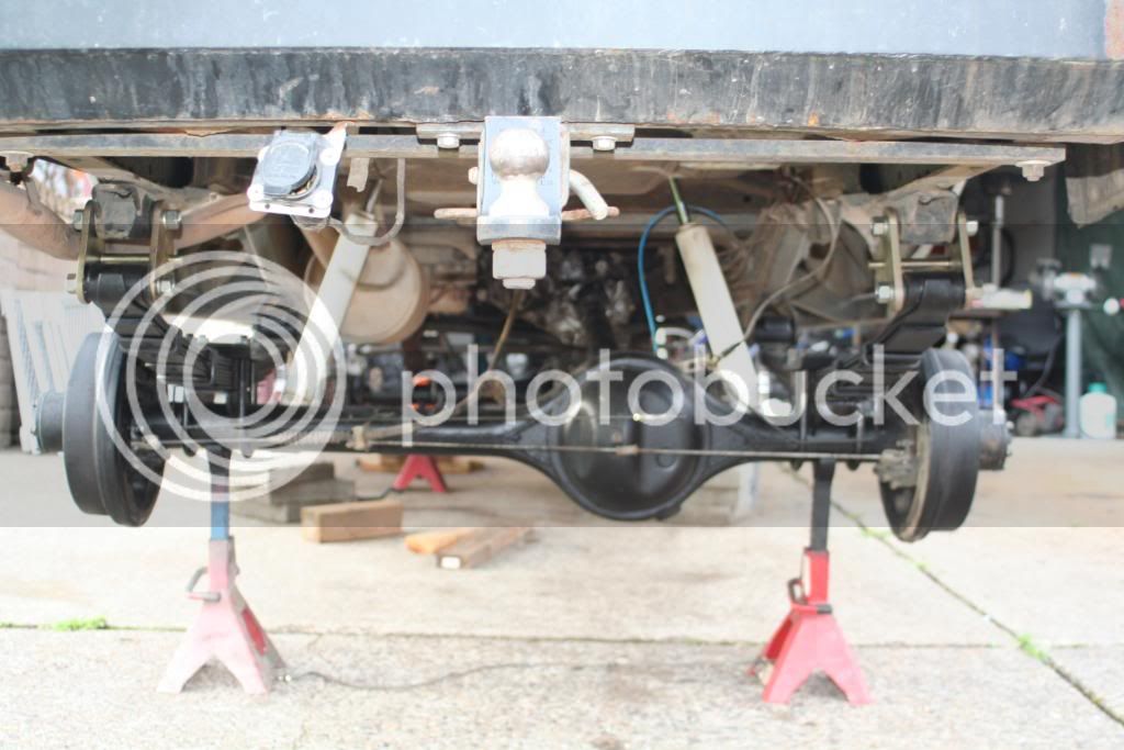

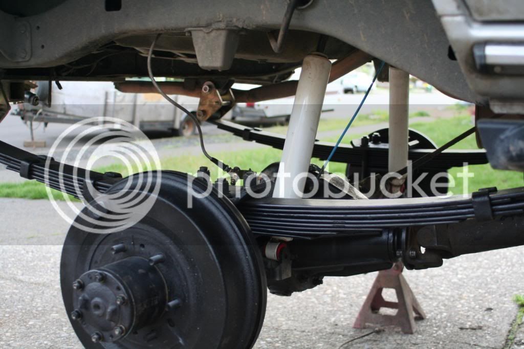

Rear shocks and parking brake cable in:
Another shot of rear shocks and brakelines:

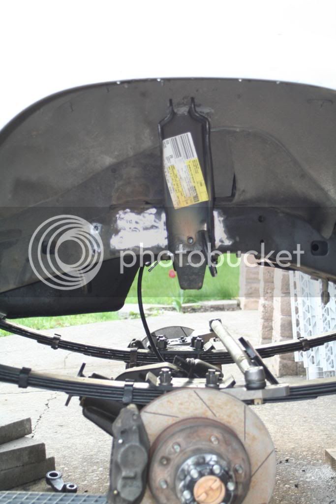

Front Ford shock towers:
Last of the beadlocks seated:
I ended up with 2* tilt in and 4* tilt back on the shock angles. I would have to pursuade the inner fender a bit more and cut/ weld the tower to get a bit more angle. I am going with this for now and if it needs to be re-done jump into it as I have an extra set of towers and lower mounts.
I ended up with 10" travel rear shocks in a swap from Brokenparts. I just could not get the 12" to work without a ridonculous angle.
I also am not totally impressed with my brakeline skills but it is what it is.

Id love to find out how that rear brake line does when at full droop. It looks like it COULD be a little short, but it will probably be okay.
Mine is STUPID long, so I wouldnt mind shortening it up a bit if I could find a better alternative.
Nice call removing the gear box to weld the DS tower in. I did NOT do that, and it was a BEOTCH welding that front side in right next to that.
