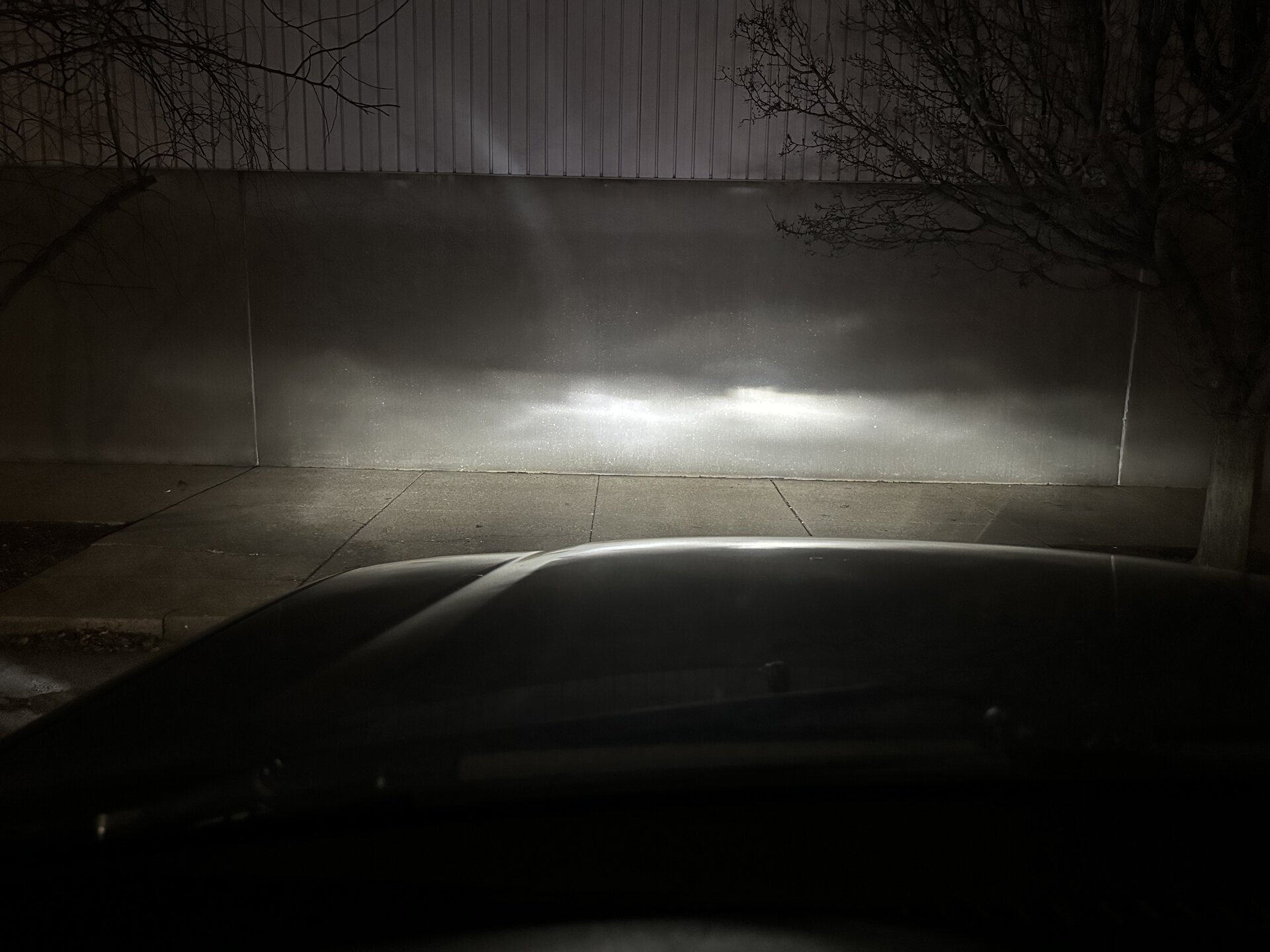

Been very happy with my Bi-Zenon retro fit. Nice sharp cutoff and much much brighter and safer than stock.
