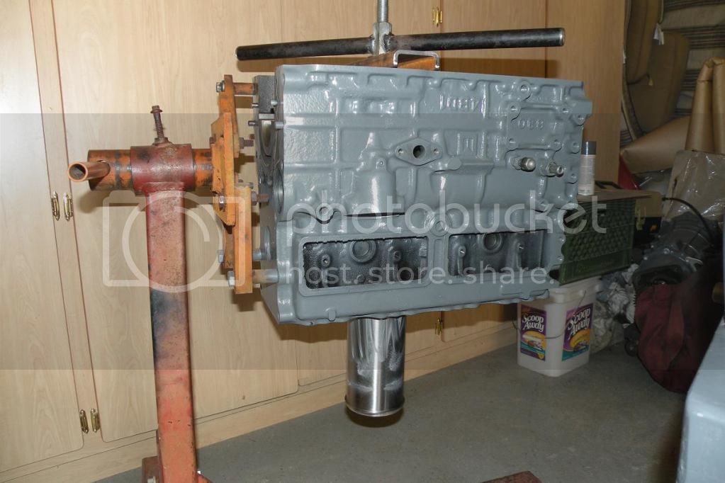

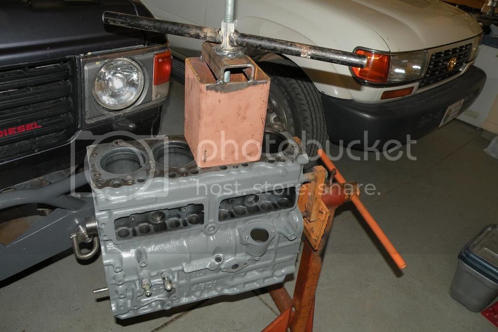

Here are some photos of my latest puller. The first one was just a horseshoe type setup that you see earlier in the thread and it worked but not very well. It would cant over and bend the threaded rod when I got a tight liner and it was just a real pain to use.
This one I upgraded to 3/4" all thread an used a piece of 1/4" wall box beam for the base and it worked great. No more flex and pulled the liners out much quicker with the big handle as opposed to the crescent wrench I was using on the old one.:hillbilly: For the installation of the new liners I just used a piece of 1/4" wall c-channel to span the bottom of the block and then froze the liners and they went right in quick with this new set up.

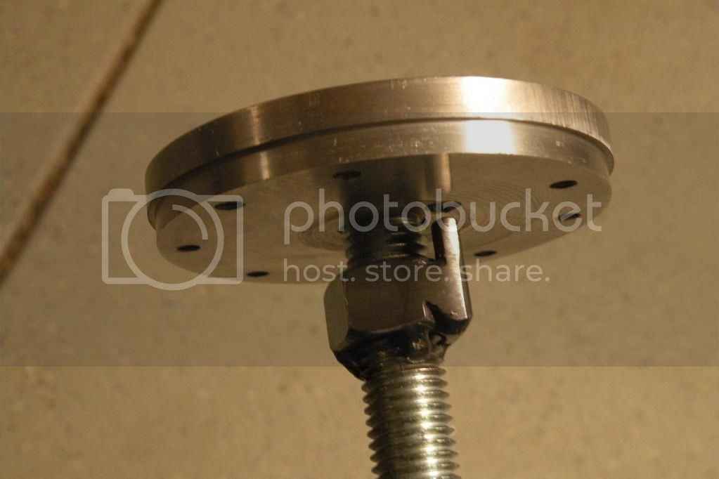

On this one I welded a nut to the all thread and then a locator pin to keep the puller disc from spinning. This was a major improvement over the old one because it used to take 4 hands to keep everything tight when the puller started.

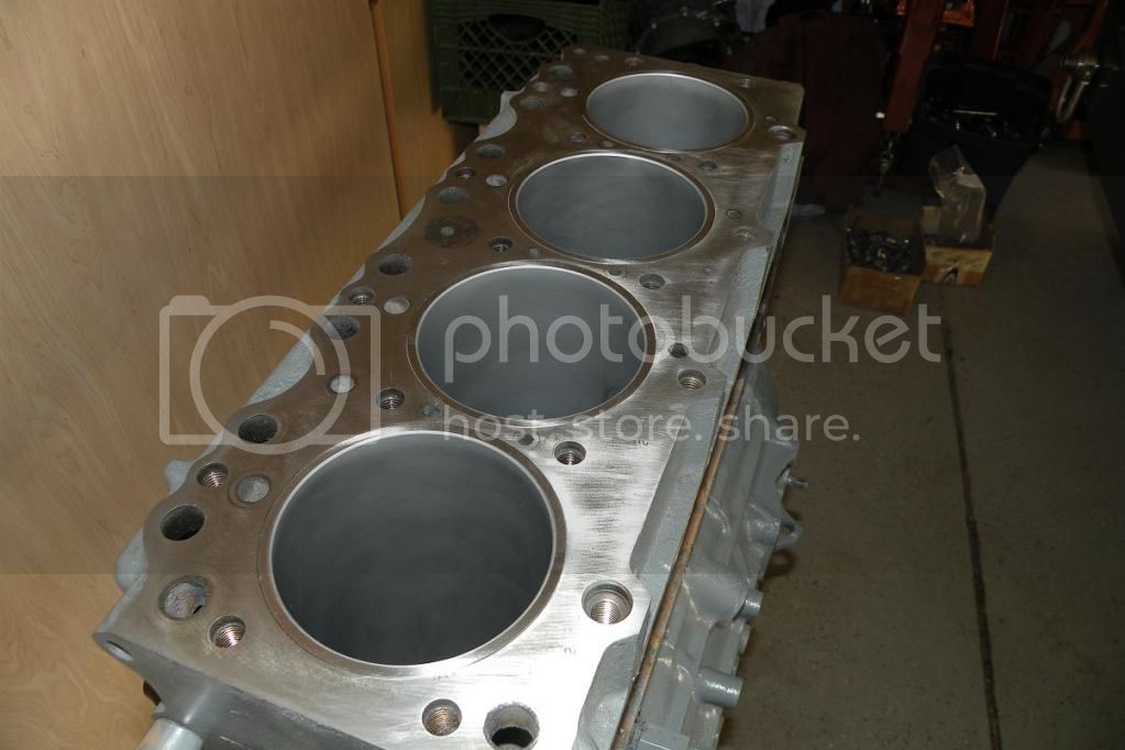

And here are my nice new chrome liners all installed and ready for pistons.
I turned the disc out of a piece of 5/8" 6061 T6 alluminum.

Thanks for the photos Don. Your liner puller looks like a very sturdy and easy to use tool. I'll start scrounging materials to make one for me. One can never have too many tools :)
