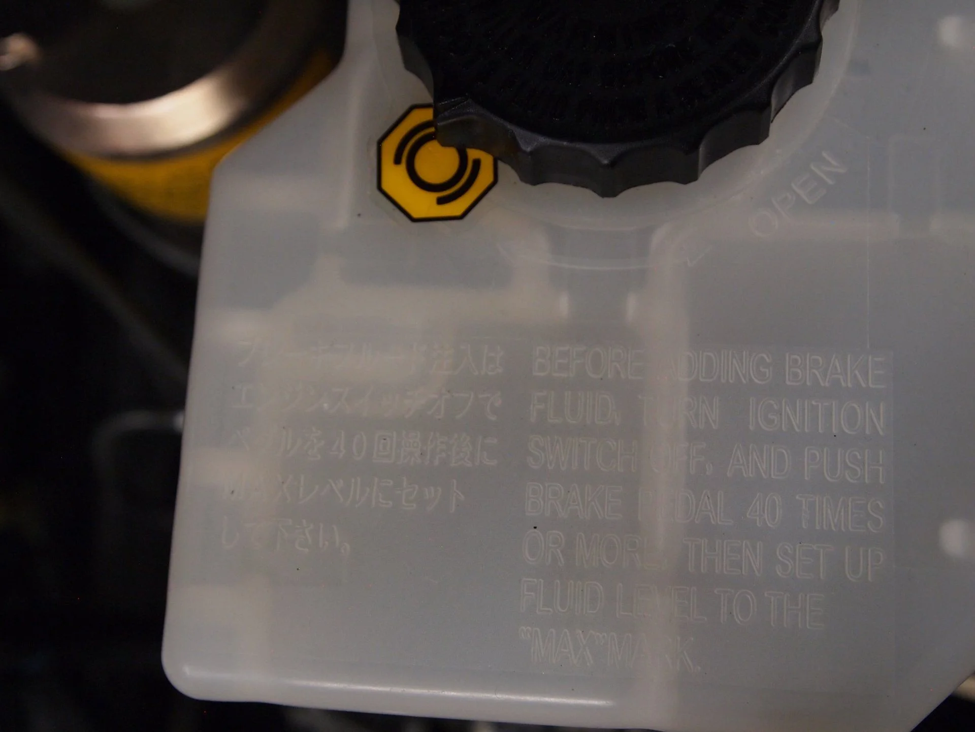

1) First when shop was done with job, they must not have tested the booster motor run time. Or it would not have run more than <40 seconds at that time or just after when you picked up. FSM Spec is 30 to 40 seconds run time after evacuation of fluid from accumulator. FSM states; if not withing range of 30 to 40 sec., re-bleed. Actually what I find very often, in our ageing fleet. Is a leak(s) after bleeding at bleeder(s) themselves. Your pump running 5 minutes after flushing, indicates system is taking way to long to reach full pressurization. Leak and or air in the system will cause this. Air in system will yield spongy pedal. Low level would indicate it had a leak, if it was actually low. So will a bad motor, pump, accumulator or even failing pressure switch. Running that long is hard on the motor and pump. In the 200 series FSM, Toyota now has a warning, to not run brake booster motor for extended periods when servicing (1 minute IIRC of run time).
2) Finding fluid around and under brake master reservoir, indicates they over filled. But could be spillage also! FSM states do not over fill. Toyota is so concerned with this, they added the procedure for topping, embossing it on the reservoir. Why shop don't read this IDK. I mean it right in there face, when adding fluid. I find reservoir overfilled in ~30 100 & 200 series I inspect.
Your taking back in shop, and they top while key on tells me they (SM or whomever did that) doesn't know correct procedure. As I said Toyota went to, extra expenses, to make sure we top correctly.

Not topping correctly does do damage. But my theory on this suggest damage takes a long time to accrue. Other than brake fluid damages paint. I believe brake fluid it gets into boots of motor resistance wire, due to overfilling, increase resistance over time (years). That this leads to early motor failure.
Your booster motor "run maybe two or three 1-second intervals to pressurize" (pre-flush) is not normal. Normal is to run for up to <40 seconds, with one or two millisecond pauses as it builds pressure. I usually hear booster motor run for about 15 second, rig after sitting parked over night, if I wait to crank engine which muffles the sound. This may have indicated you had a issue pre-flush, or maybe your just heard it wrong. Motor may have be hitting dead spot on commutator, run the stop then run, is one possible answer for 1 second run times.
