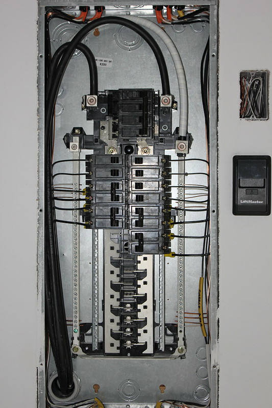

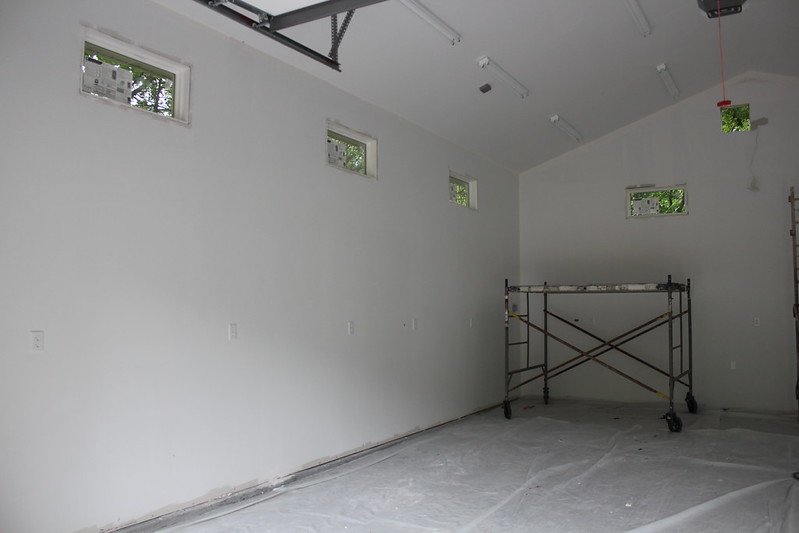

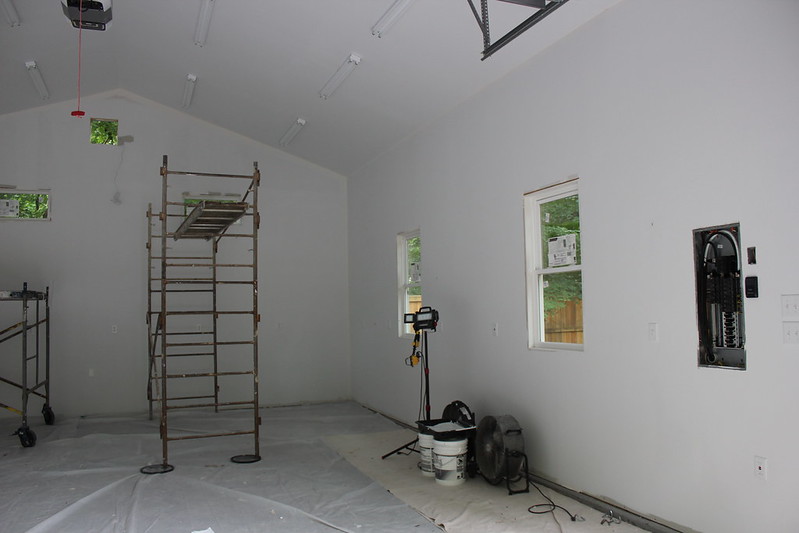

The pics don't show much for yesterday's progress but electrical work continued and we should be ready for final inspection Friday. I also found time last night to get paint on the walls (painted the ceiling Monday night) and plan to finish the corners with a brush tonight.
I also plan to run window/door trim and baseboards this weekend. Lift is scheduled to be installed on the 23rd. Coming together very nicely!

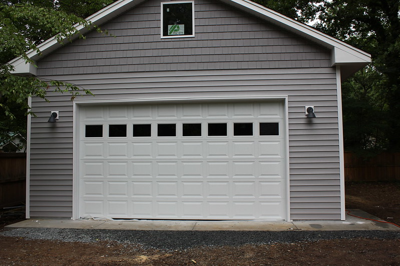

Exterior lights...my massive RAB flood light should be installed today.

Electrical is done and final inspection tomorrow.

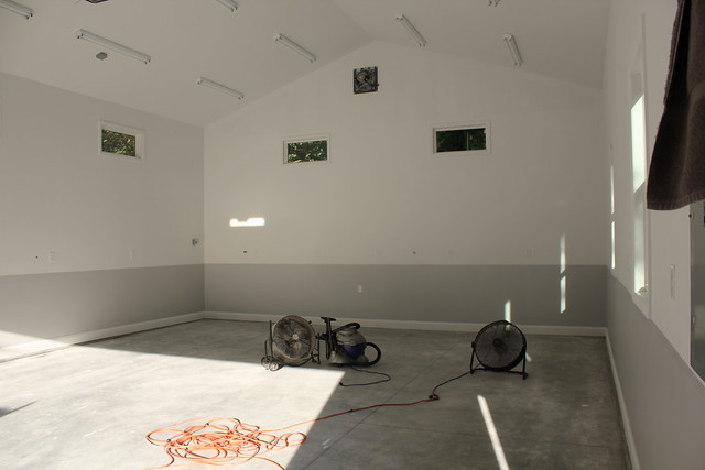

I finished painting tonight...but now am contemplating painting the bottom section of the walls a gray color. What's the consensus? Leave all white or go two-tone?

All one color. If you stick with the modular theme, ie can just pull everything away from the walls when it is time for new paint, your life will be easier. Two tone just makes the repaint a bigger hassle.

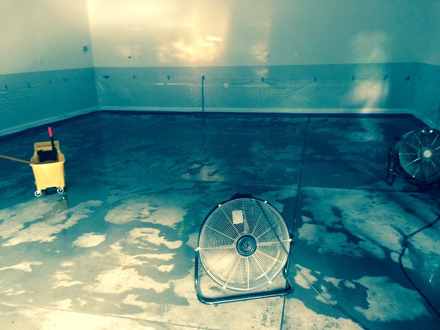

Actually neither. I'm applying a densifier that will be burnished in with a floor buffer. It's kinda like a sealer but acts more as a stain guard and will leave a semi wet look. It leaves my options open long term as I was torn b/w acid stained or epoxy flake.

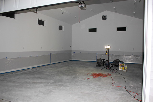

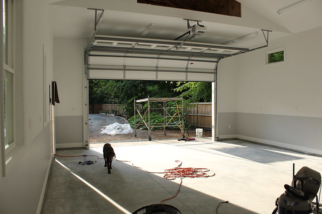

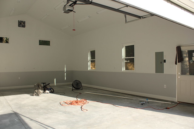

Busy couple of days! I got the windows, door and walls trimmed out Friday evening, caulked, filled nail holes and painted Saturday, then wrapped things up and started cleaning today. I ended up going two-tone on the walls. It took a good amount of extra prep time...but I'm very happy with how well the lines turn out!
Got the walls taped off this evening and plan to clean the floors real good tomorrow night. The garage door guys are actually out there now (late Sunday night) swapping out the chain opener to a jack shaft style motor.
I had to order special floor buffer 'burnishing' pads as HD doesn't carry them. Hopefully they'll be in mid week so I can finish the floor and start moving stuff in!

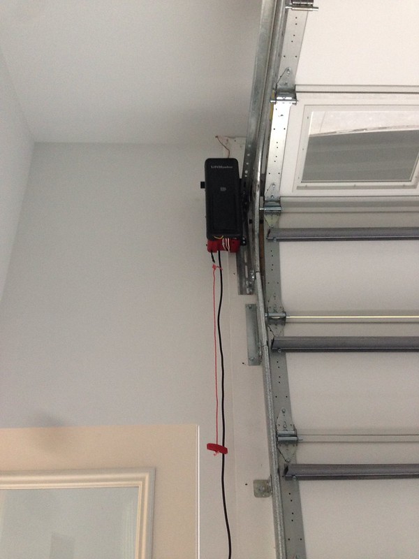

You've got to give us more info on that opener setup. That's slick as s***.

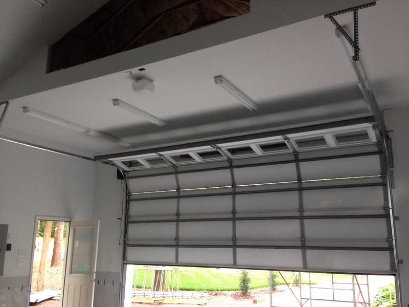

Yeah it's pretty neat and I'm not sure why they aren't used more in residential applications. I'm not really sure how long they've been readily available but at least 5 years or so. I don't think the setup would work with a 'spring' tensioned door as you would need a torsion bar setup.
Here is a post of garage journal that talks a little about them, but in simple terms it has an internal mechanism that attaches to either end of the door's torsion bar (which is attached to the corner end of each door with a cable) and turns the torsion bar to raise/lower the door.
http://www.garagejournal.com/forum/showthread.php?t=36006&highlight=jackshaft
It's much quieter than the typical chain drive overhead openers and the only downside I can think of is it seems just a tad slower. I'm very pleased with how clean it looks now not having the overhead motor hanging off the attic truss area.

Got the floors cleaned and prepped last night. I'm ready to coat the floors once my burnishing pads come in (hopefully tomorrow).

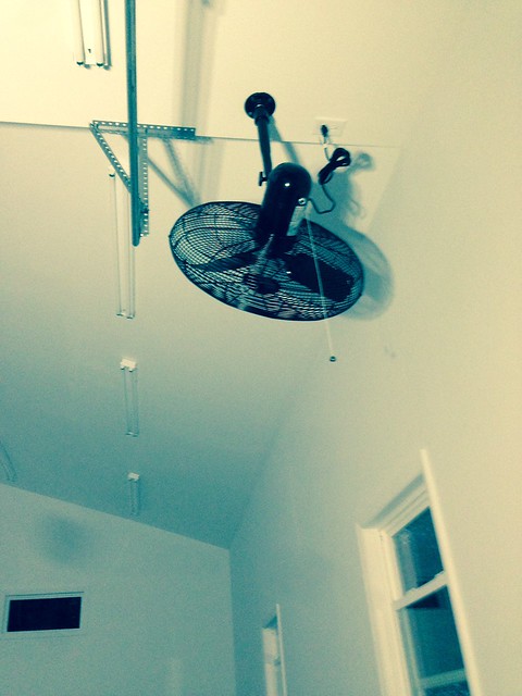

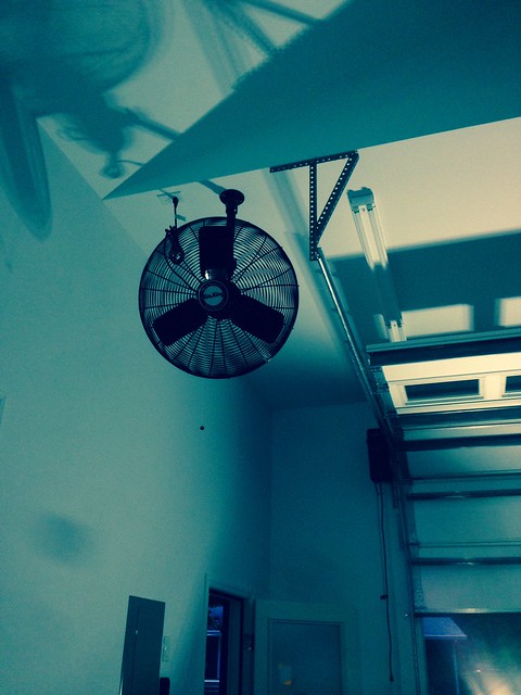

This evening I installed my ceiling mount fan. It's ~30" diameter so should move tons of air!
