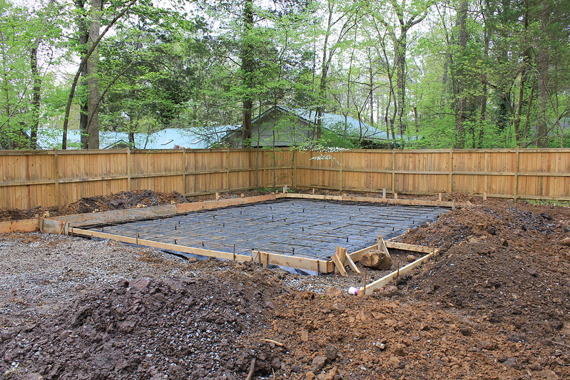

12' walls for a two post lift. I had originally wanted to go with Mohawk's System 1 lift but $8k is a bit much :doh:. Ended up choosing Bendpak's XPR-10-LP and very excited (included in price of garage)! Slab was poured 8" thick (i measured to be sure), rebar 2' on center and massive footings. It is actually over engineered for the space but figured "what the hell", right?

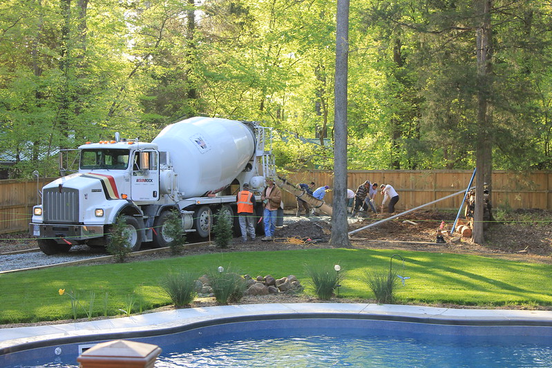

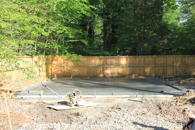

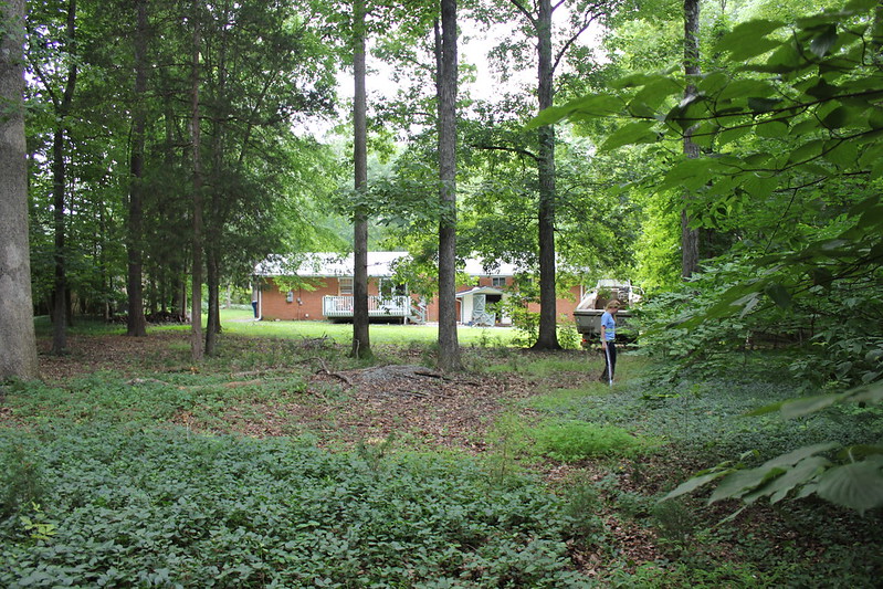

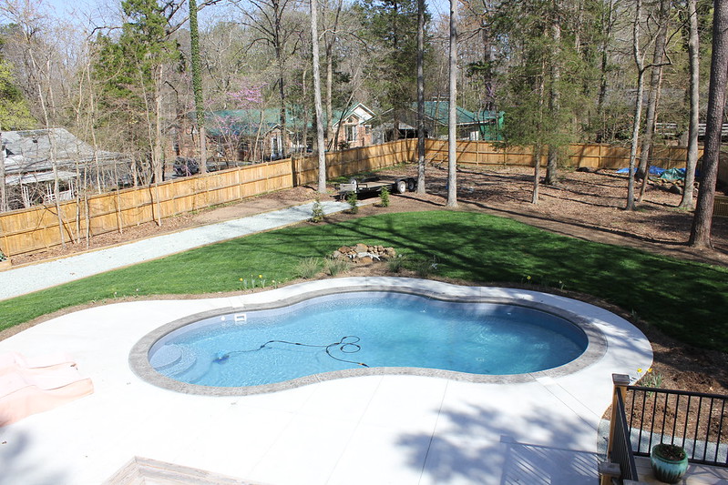

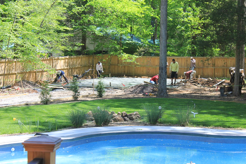

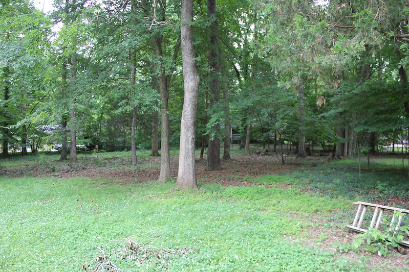

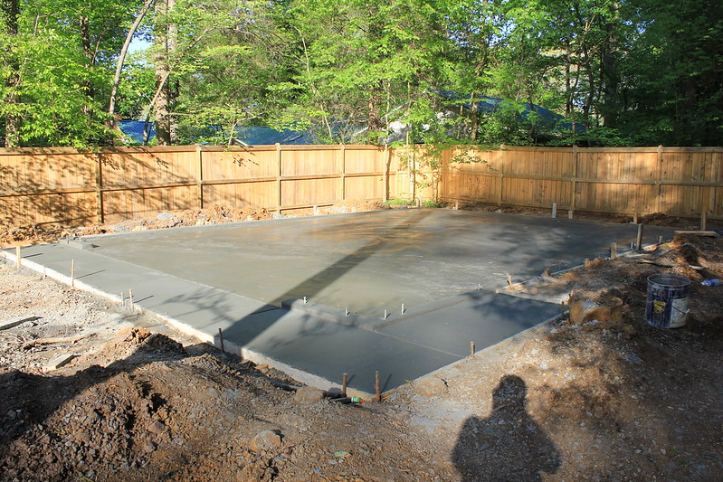

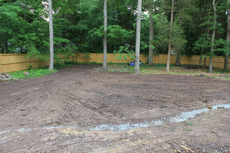

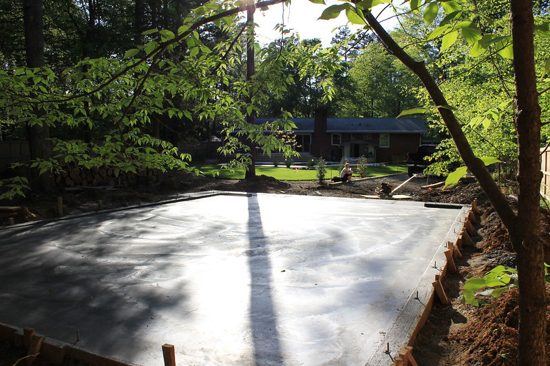

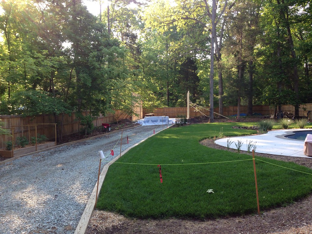

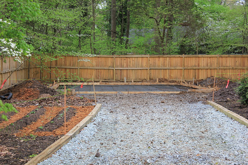

Couple pics of the space before we moved in and throughout the past 18 months. Also couple pics of the new slab that was done yesterday...4 concrete trucks and they DESTROYED my driveway!!

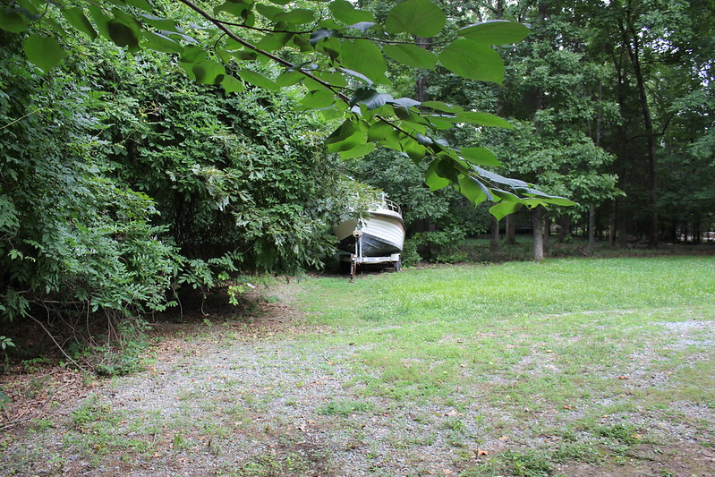

Not our boat...wasa neighbor's that was 'storing it' on the lot...

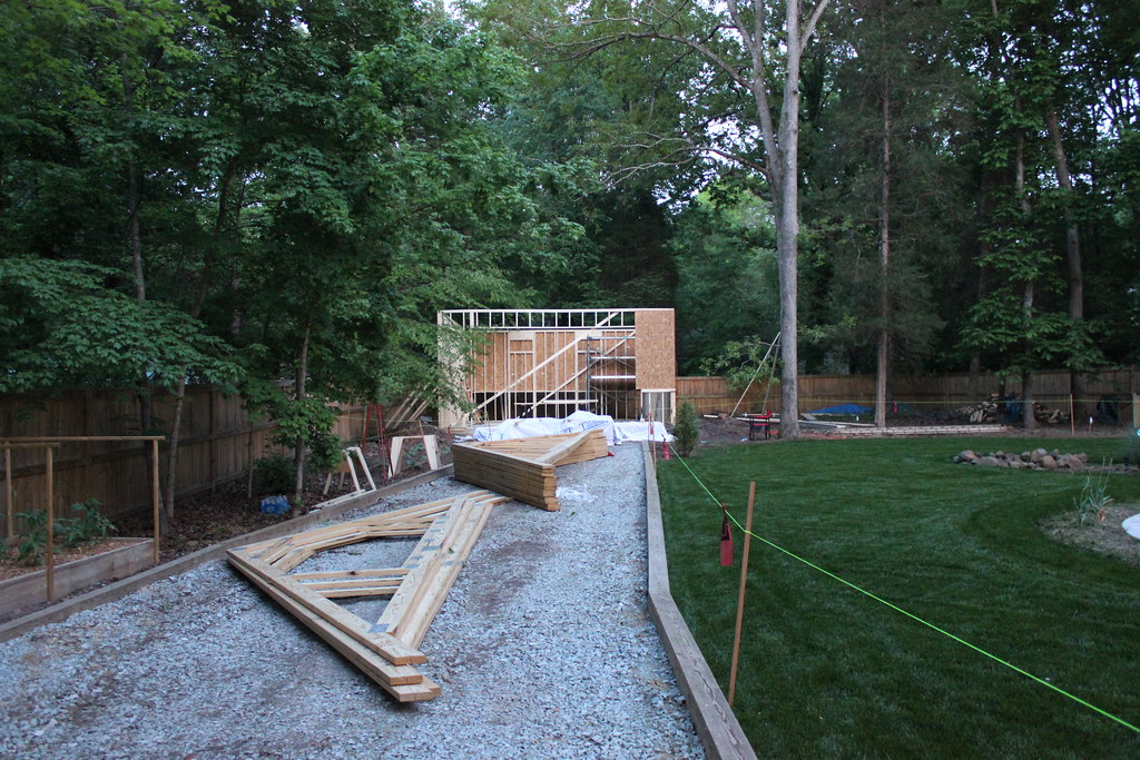

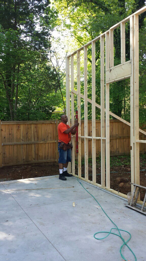

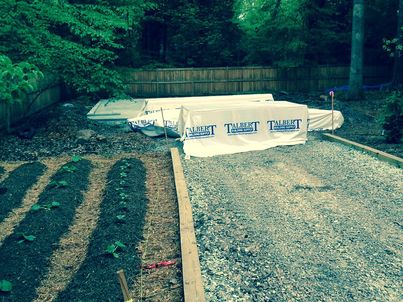

Not much has happened since the slab was poured...but materials did get dropped of today. Framing starts tomorrow and trusses will be delivered Friday.

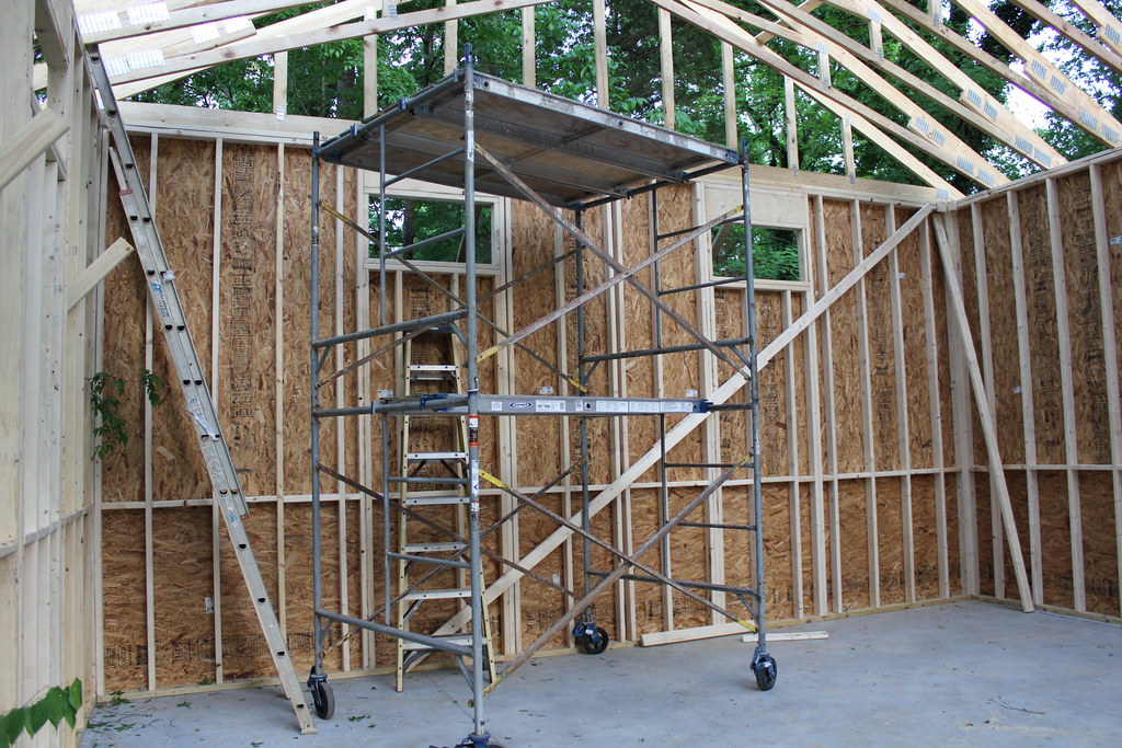

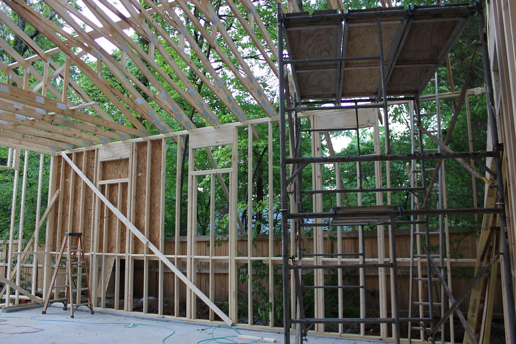

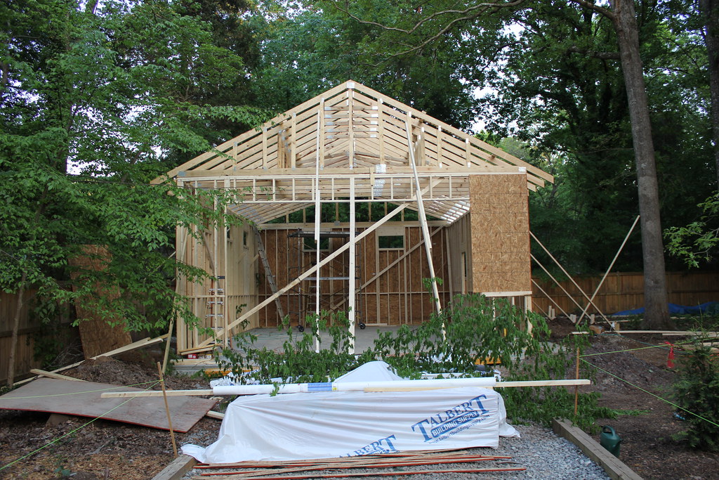

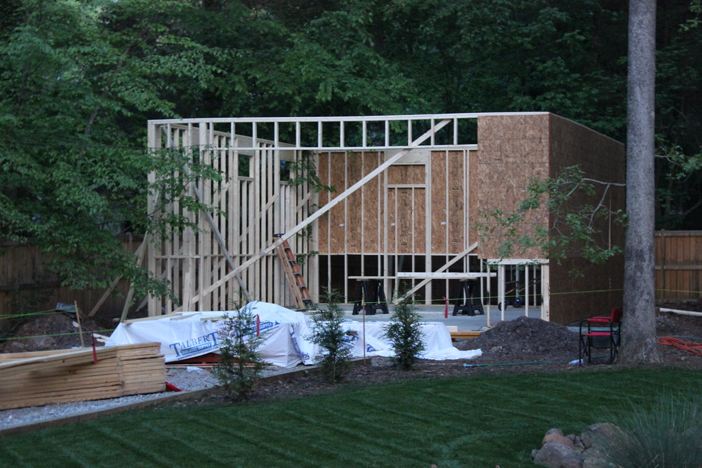

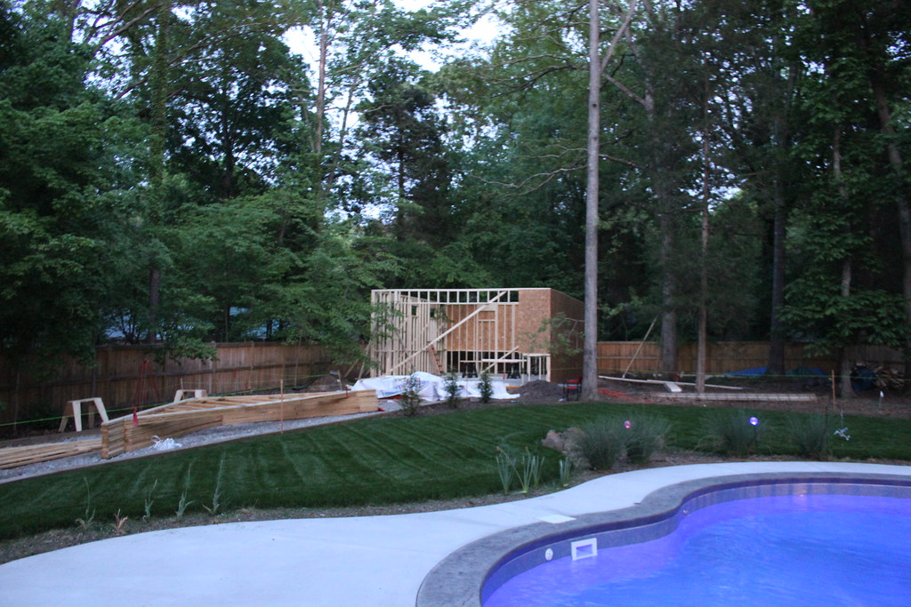

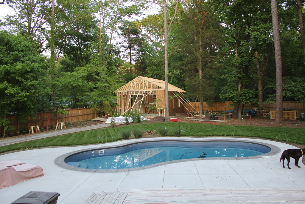

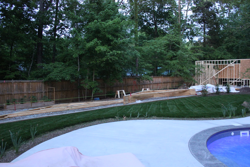

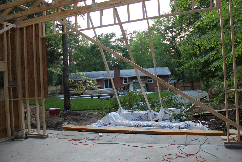

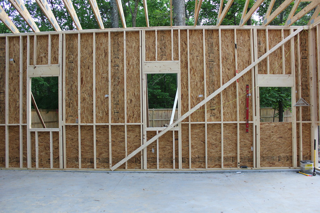

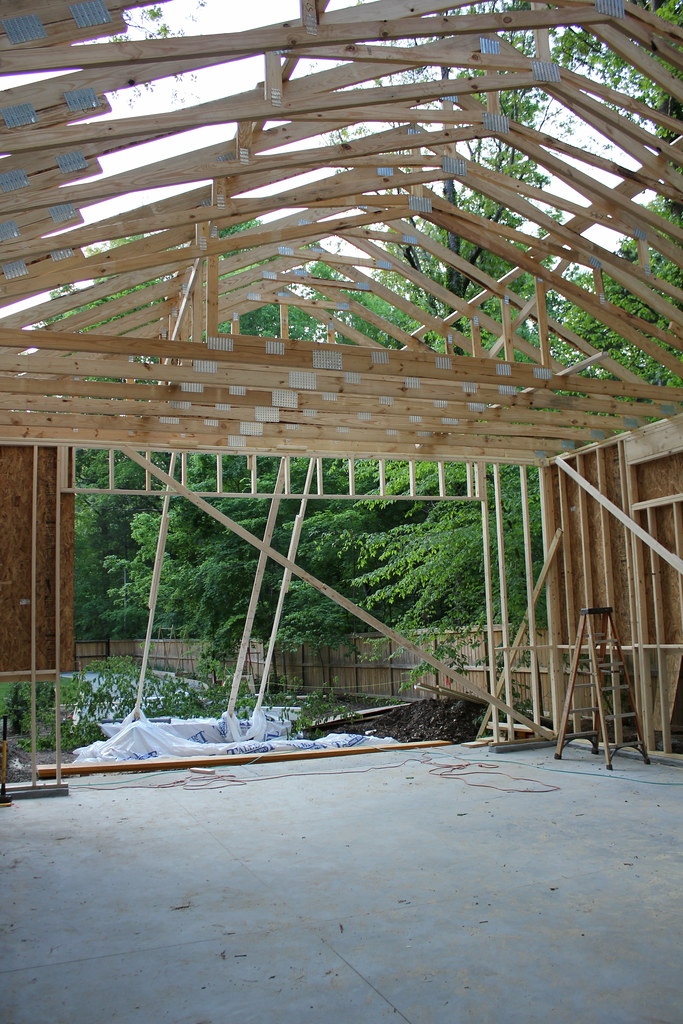

We were greeted with some progress after being in DC for a Mercedes / German carshow over the weekend. I was hoping for more but I think the weather was not the best here on Thursday afternoon and Friday.
The walls are going to make this sucker very TALL...
