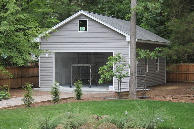

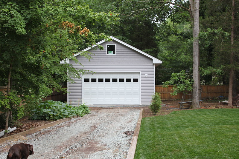

Looks awesome Jon! Very jealous!
That looks amazing man. Is that matched to your house?

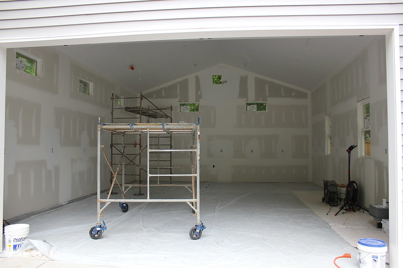

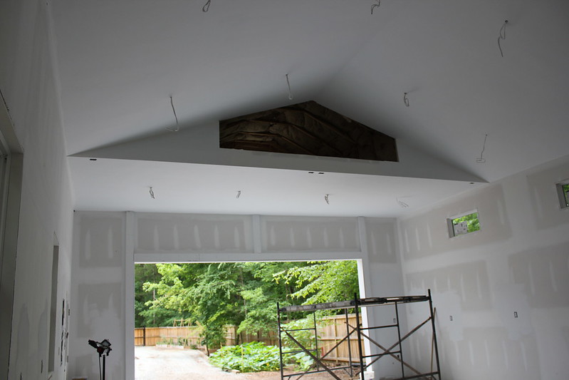

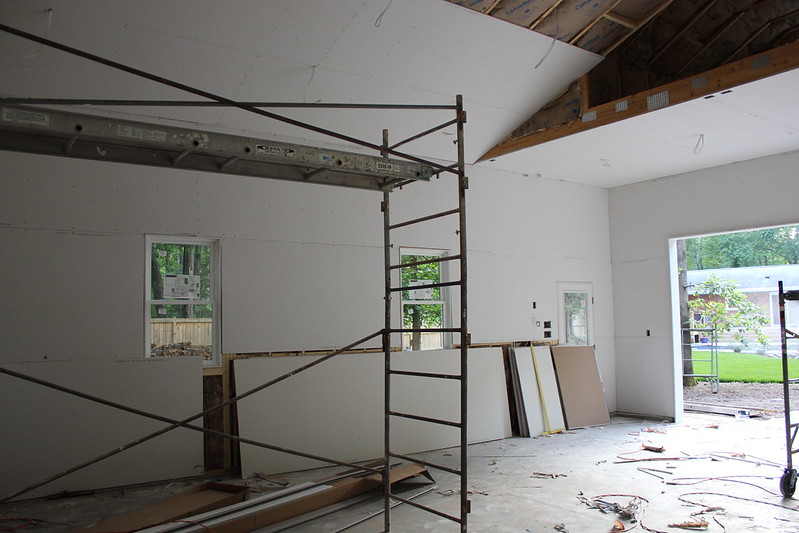

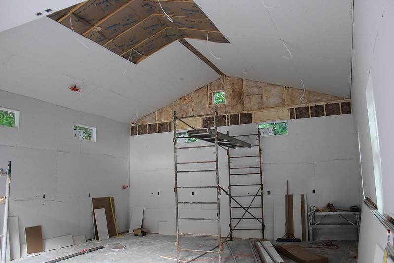

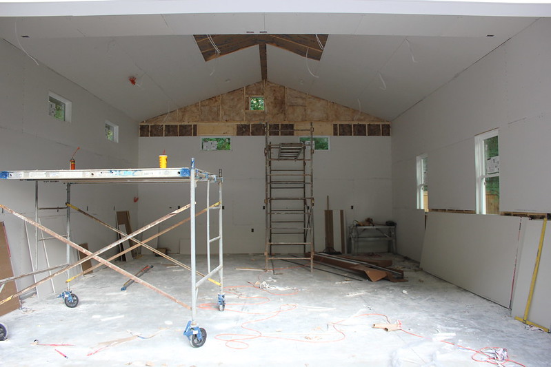

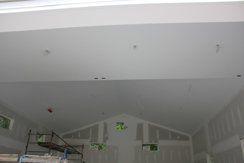

Almost all the sheetrock was hung today...I imagine they will be back tomorrow to finish hanging and start mud/taping. I don't envy those who finish sheetrock for a living. My finishing skills are way to amateur for how particular I am.
Btw, anyone want any squash/zucchini? I'm about to have too much to eat real soon!
Getting closer!!!

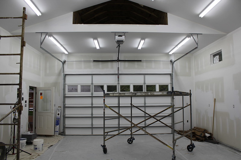

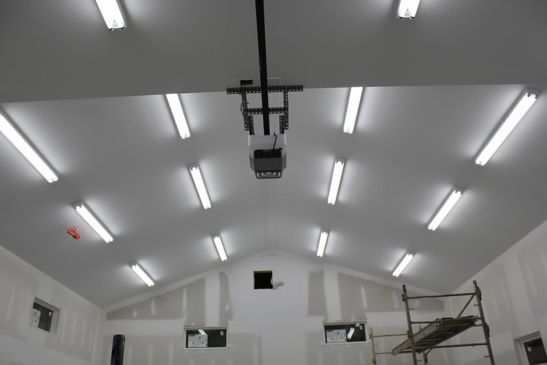

Sheetrock is done and finished/sanded. I painted the ceiling and around outlets last night...neck is sore and legs too (from climbing up and down scaffolding). I'm sure it was much easier than waiting till after the lights are installed.

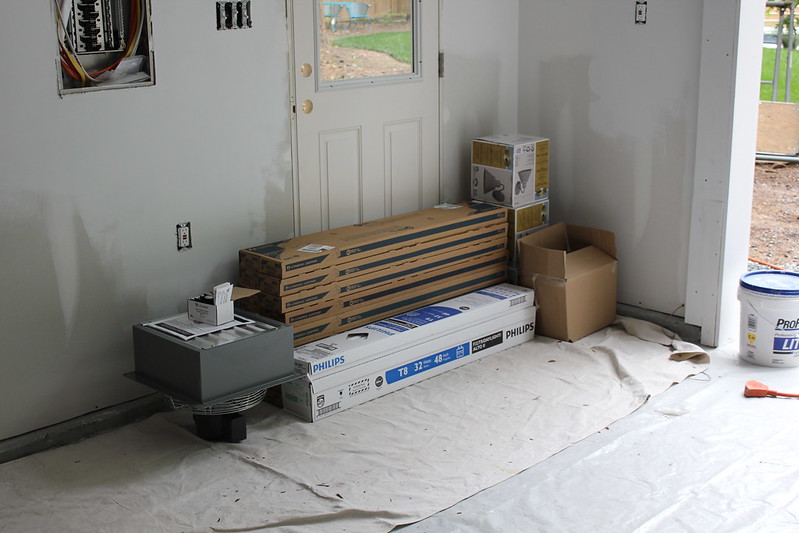

Electrical should be trimmed out today and final inspection tomorrow/Thursday...then Duke has 10 days to trench/install the new service line. Garage door should also get installed today.

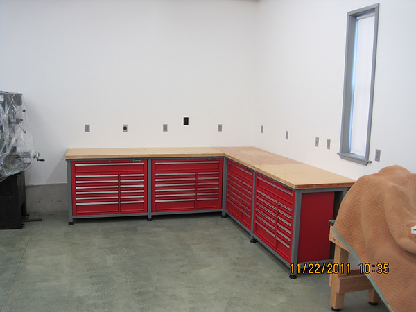

Have you decided on the layout of the workbenches / cabinets?
Just highlevel. I'm thinking the back right hand corner will have a 'L' shaped bench with the long 'L' on the side wall under one of the windows. I'm leaning toward the harbor freight toolchest metal framed style bench. Not sure on the benchtop material though...
I'm a big fan of variety in benchtop material. I've got one hardwood workbench, one birch ply workbench and one steel welding table. My wooden benches are coated in spar urethane. Urethane stands up to most anything, but is more gentile on painted or fragile stuff. When you really need to let loose on a part, or are fabbing something up, having the steel welding table is amazing.
Having variety in design is good too. One workbench is built like a traditional table, four legs and a shelf. Another is narrower, but cantilevered on one wall. The welding table is right now just 4 legs and an open section in the bottom, but will eventually have expanded steel shelf and wheels. The cantilevered design really shines when I have large items like lots of wheels, or axle housings, or driveshafts, that need storage.
Not really an easy answer :D
Also, I'm sorry if my thoughts/suggestions are overbearing or over-enthusiastic. I'm dreaming about what my shop would look like and its starting to look pretty flipping similar to yours, so I'm excited :bounce:
No worries -keep them coming!
Good point and since I already have a 4x6' welding table, I'll go wood. Maybe even butcher block.
Best I can recommend is to not attach anything to the wall if you can get away with it. This leaves you with a modular set up that can be reconfigured as you add new tools or storage units to the mix. You can never have enough storage. Don't worry, you'll be adding a storage shed in a couple years :)
