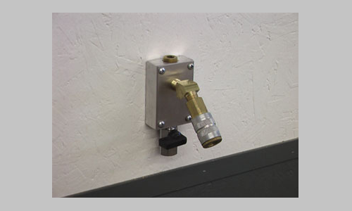

Run shop air to the outside of the door so you can work outside with the door closed and still have air and electricity. Nice when it's hot or cold and you want to keep the main door shut.

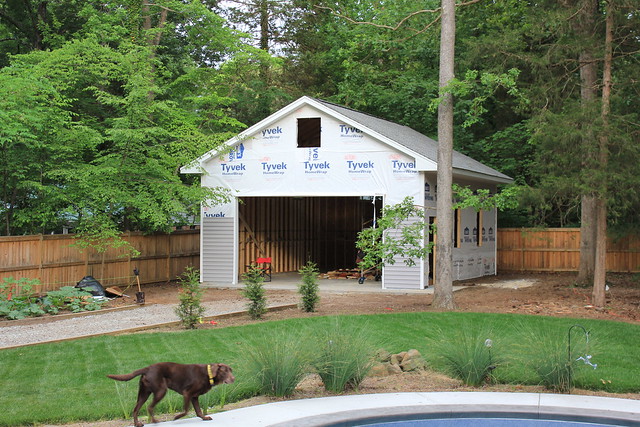

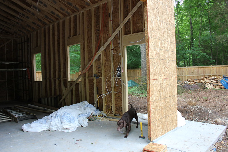

Shop is all done. Jon was wrenching just the other day.![]()
Looking great!!! I can imagine that you are chomping at the bit.

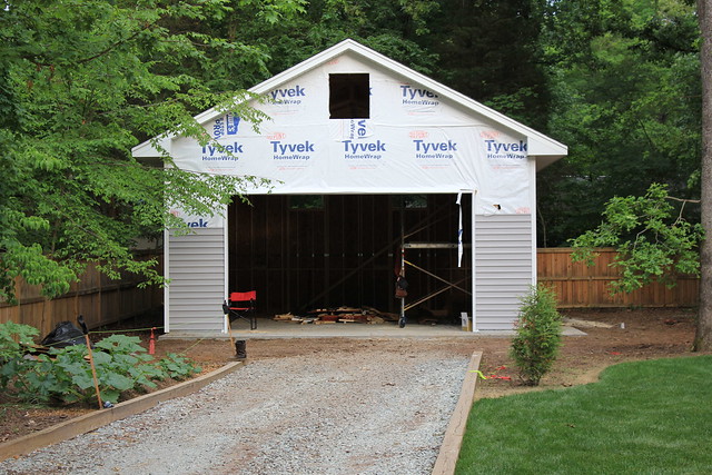

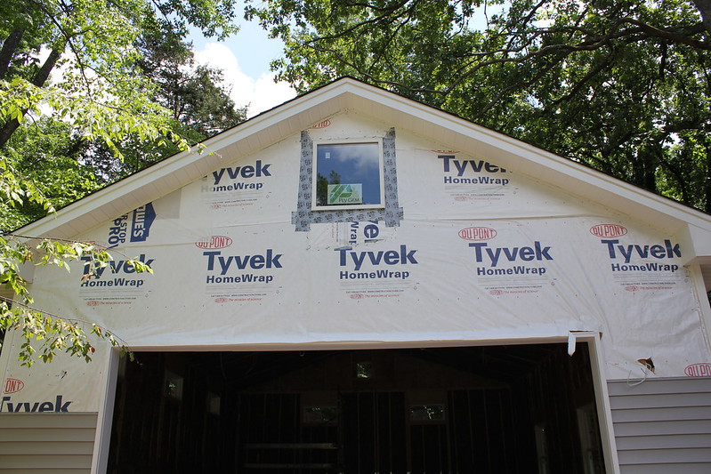

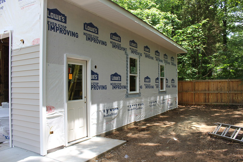

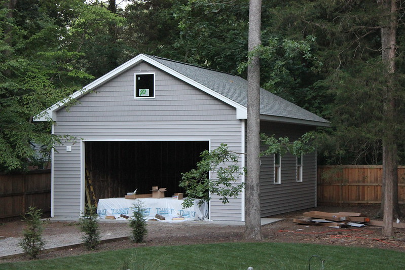

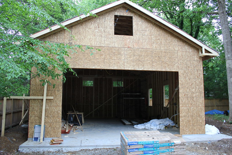

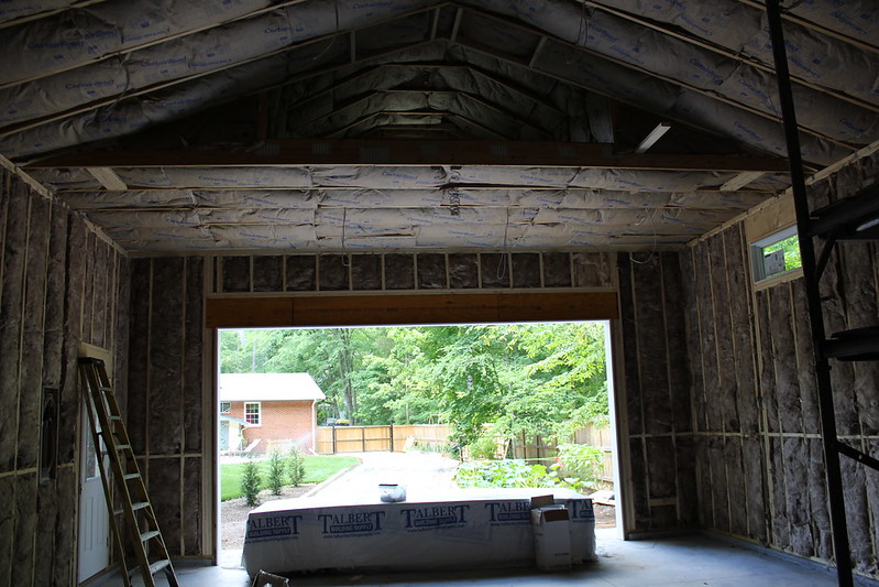

A suggestion from a former builder who learned this one the hard way. I can not tell from the photos, the vertical legs on the garage door opening. If they are wrapped in aluminum, ask your uncle if he can bend you up a pair of replacement covers that will fit over the existing ones. Put them up in the attic and forget about them.
Years of use will dent, scratch and finally one will get torn. I got to the point that I had the finish carpenter trim the rough 2x6 or 2x8 prior to siding going up and sand it trim smooth. I then had the painter paint primer and 3 finish coats. This way it could be repaired and touched up by the average home owner.

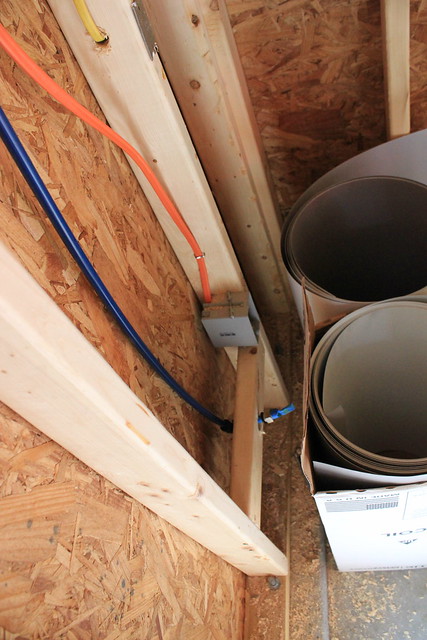

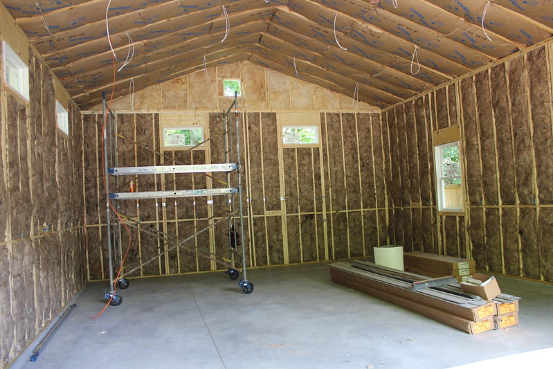

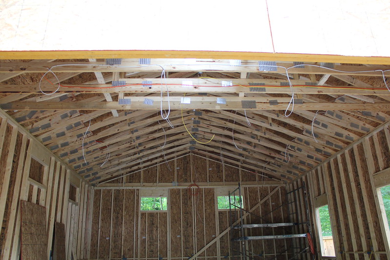

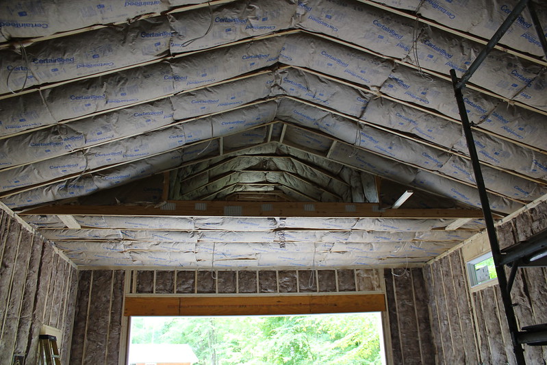

Why is the floor of the truss storage area insulated?
