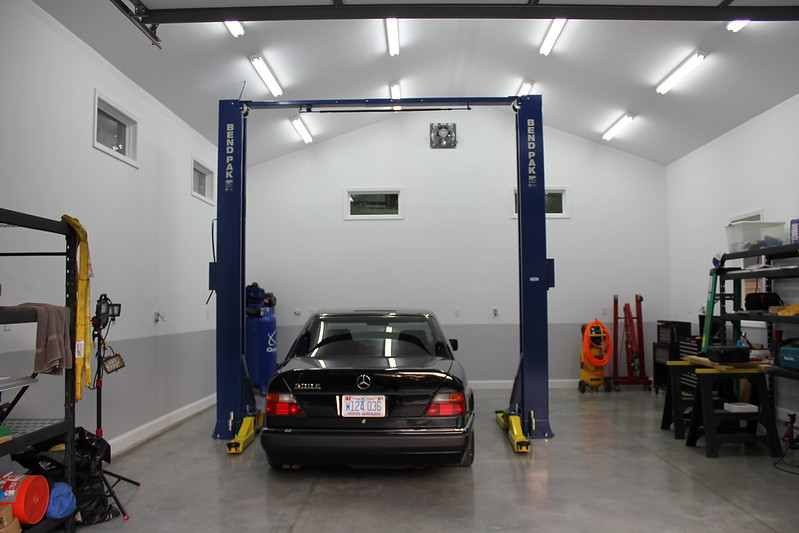

Lift got installed today...how freaking cool!! I'm like a kid in a candy store just slack jawed that I have a lift in my own garage. It's something I've always dreamed of having but never thought I'd see the day.
The installer was a one man show and he worked is @ss off for 6 hours to get it all done. Rose Equipment out of Rocky Mount, Dennis Rose is the owner. I'd recommend him at this point.

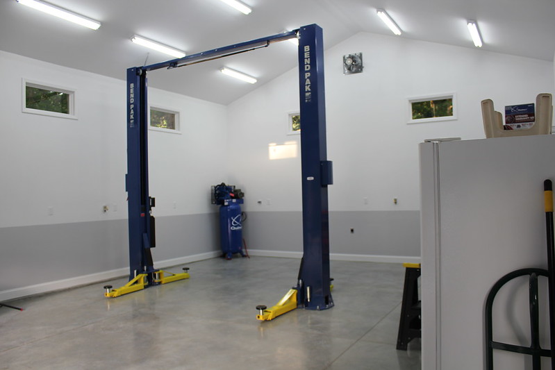

Did you have hooks put in the floor for the lift as anchors or did he drill the concrete and put in fasteners?
A+. Like Stan said, the build has been great to watch. HAMOM at Jon's house.
No, nothing in the floor pre installation. I beleive the process is: drill hole, epoxy in sleeves, then install bolt stud, then torgue down nut. Torque specs are 100 - 125ftlbs ber stud. Unfortunately I wasn't out there to oversee the entire installation...was hot and didn't want to hold the guy up with conversation.
One last question then. Was the floor poured thicker where the lift, or is it reinforced, etc.?
Good questions...
The lift calls for a minimum floor thickness of 4" with 3k psi concrete. Instead of pouring piers under the lifts, I went with a 6" minumum slab, with 3500psi mix, fiber and rebar 2' on center throughout the slab. The slab actually ended up being more like 7 1/2" - 8" as they over excavated when digging the forms. No extra charge of course!
I also told them where to cut the control joints based on where the lift bases would be...don't think you should have the base closer than 2' from a saw cut.

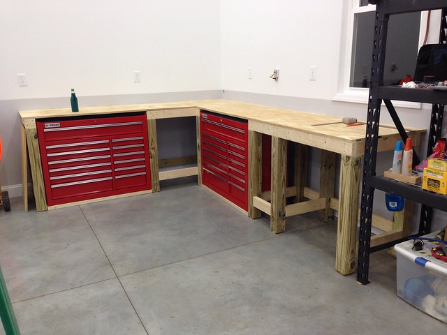

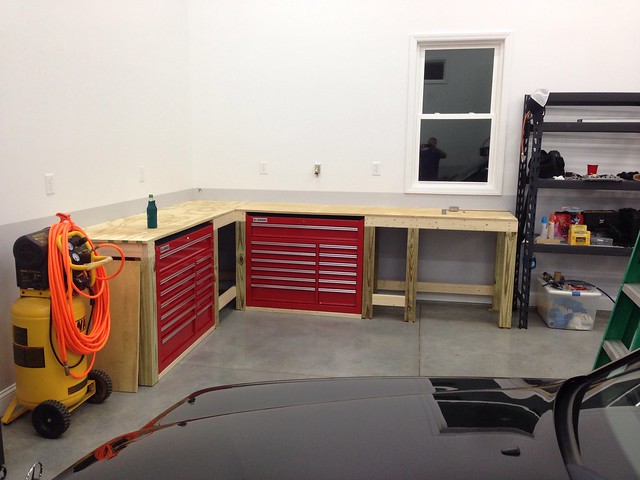

Slapped together a quick workbench today. Still some finishing touches to add, shelf plywood and trim, but should suite me just fine until I have time to fab one from metal. I wanted one quick so I can get stuff moved in for our storage unit.
