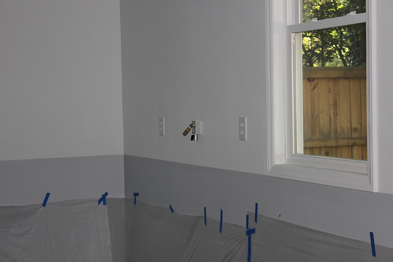

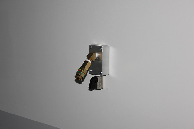

Got the air line 'outlets' installed last night...very clean looking!

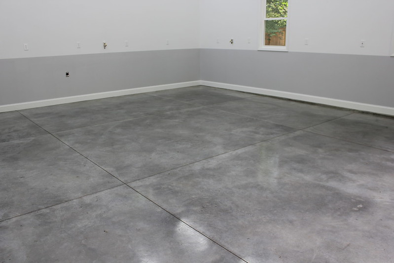

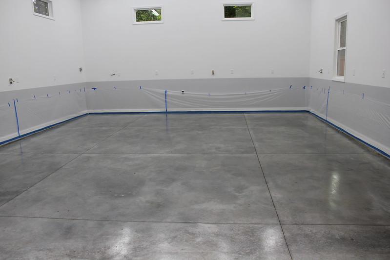

My burnish pads showed up yesterday so I'll likely get the floor coated this evening...pics once it's done. Then I can start moving s*** in!

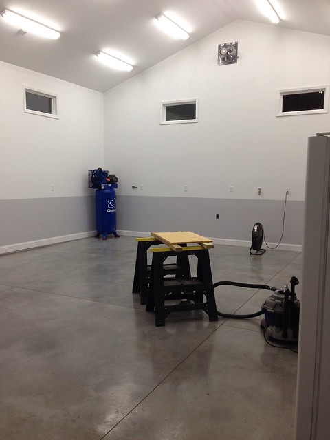

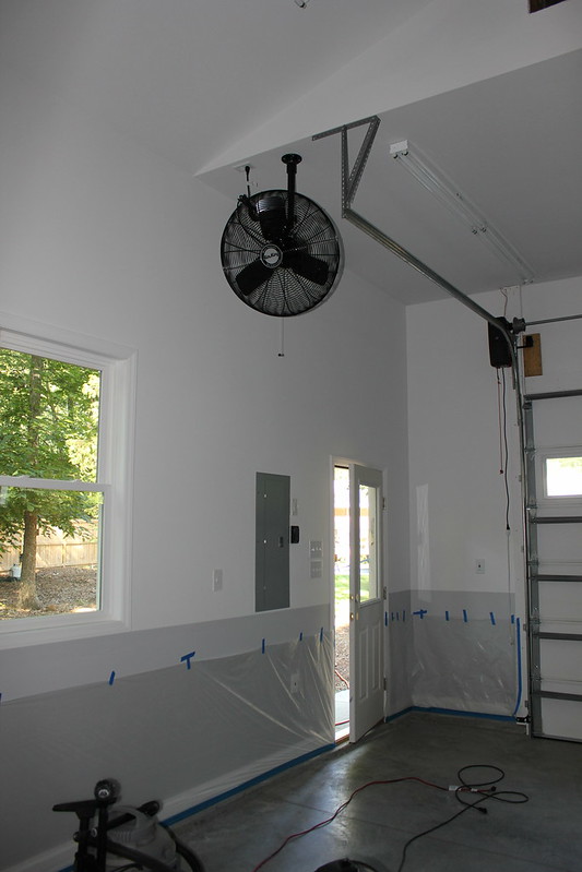

Better fan pic...sucker is big :hillbilly:.

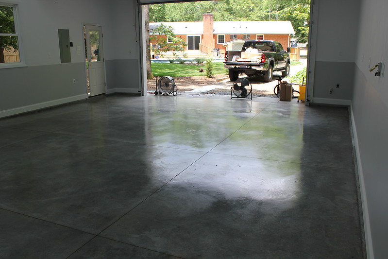

Wahoo!! Floor is done and once I get my dirt work done, I'm gonna be moving stuff in!!

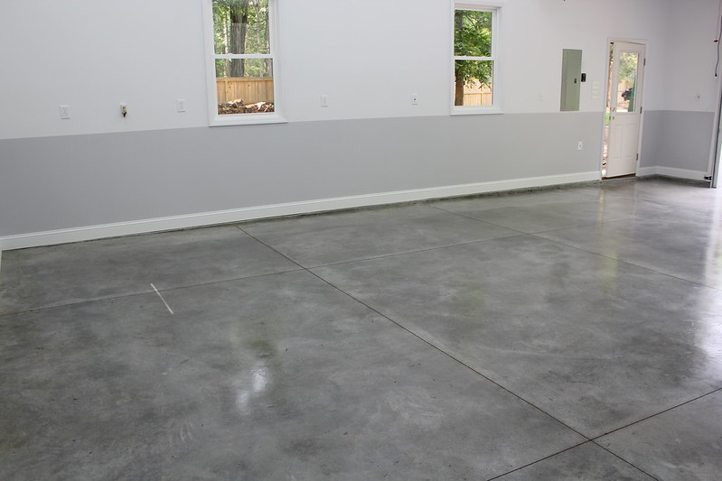

I started working on the floor last night. I laid down 3 coats of Legacy Industries HD40 Stainguard, waiting about an hour b/w coats. Once dry, (first thing this morning) I spent ~3 hours wrangling a highspeed floor buffer burnishing the stainguard into the floors (damn thing owned me at first, but I got the hang of it). 2 hours with a gloss pad and 1 hour with a high gloss pad. I'm sure my core is going to be sore tomorrow morning!
I'm super pleased with how it turned out! It's very glossy and seems to have significantly improved the surface durability (i.e. doesn't scratch or mark). The other slick part is this is not a sealer, but is absorbed by the concrete and binds with the lime creating an even denser surface. No VOCs either, so no lingering fumes like an acrylic sealer.
Floor prep was super easy, just scrub with a Simple Green solution, mop off dirt, rinse and let dry!
Didn't change the color of the concrete (which I liked) but burnishing left a real nice smooth glossy finish. Total cost was ~400 bucs which included the stainguard, applicato pads, cheap garden sprayer, 10 burnish pads (only used 2) and 4 hour floor buffer rental.

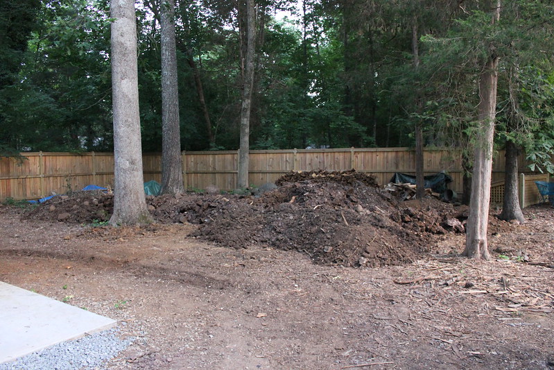

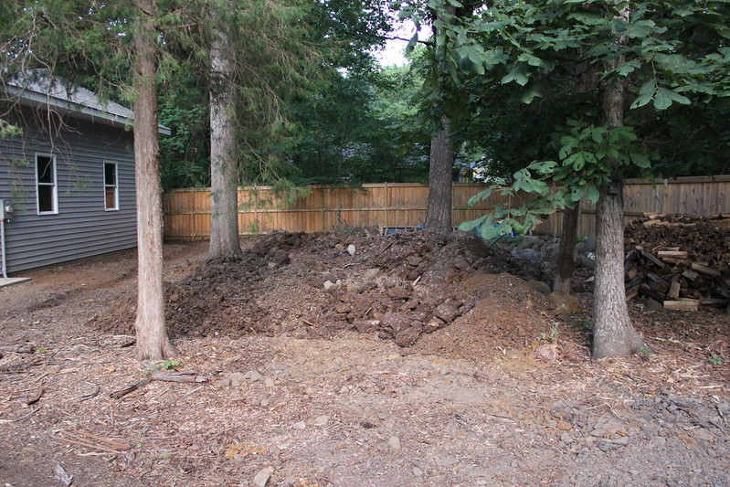

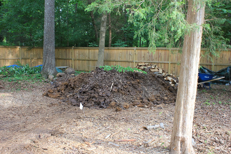

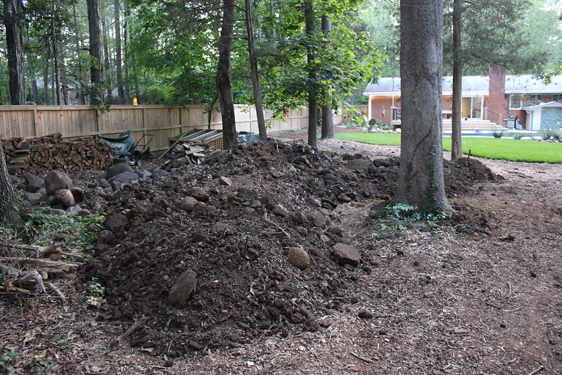

I literally moved dirt by hand tools and wheel barrow half day Friday, all day yesterday and all day today...freaking spent man! I think that I've now moved all the dirt that was excavated for the slab, plus some...Hopefully it's good enough to pass inspection tomorrow!
Since I was moving dirt for the past three days, nothing got moved into the garage yet...maybe during the evenings this week. Lift gets installed a week from tomorrow.
Initial dirt pile I created with a Toro Dingo:
New pile:
Your post is giving me flashbacks. I borrowed a dump truck and skid steer and took several dozen loads out to a friend who needed clean fill. I rolled the bob cat onto it's side after lifting the bucked while on soft soil. 8275 on the FJ40 pulled it right back up onto it's wheels. LOL
Just as I was at the point where you were, my neighbor Dave showed up with a Kubota setup with a landscape rake and saved the day.
Scared the s*** out of me. Just a few years ago I was driving a Kubota and one of the tires fell into a hole and I almost rolled it over. That was far, far scarier. Kinda hard to get hurt in a Bobcat....

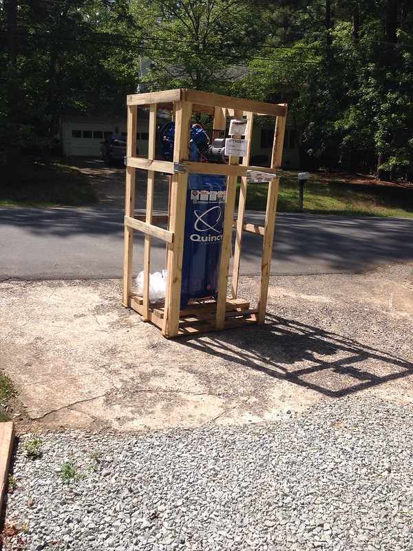

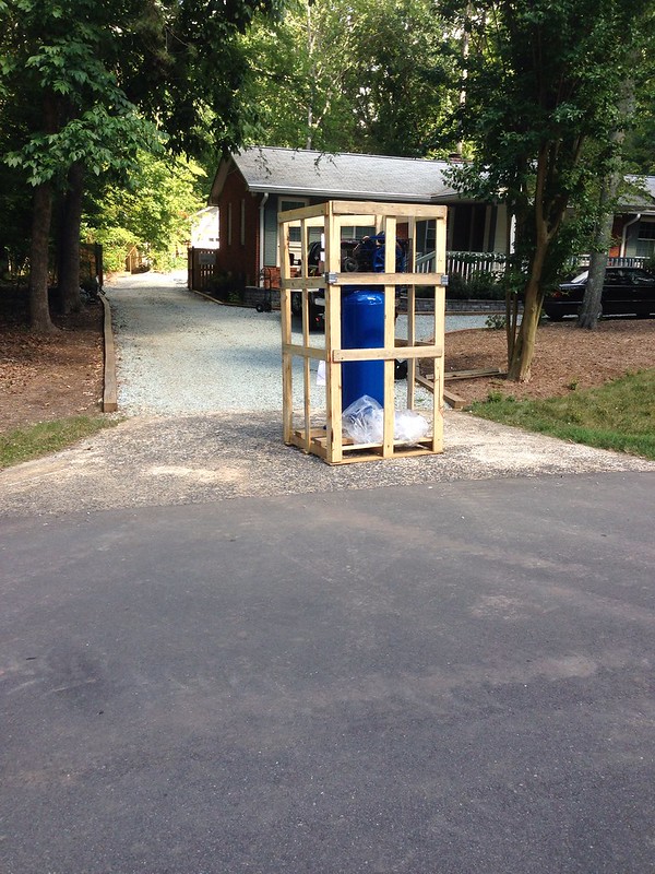

Compressor is confirmed for delivery tomorrow!!

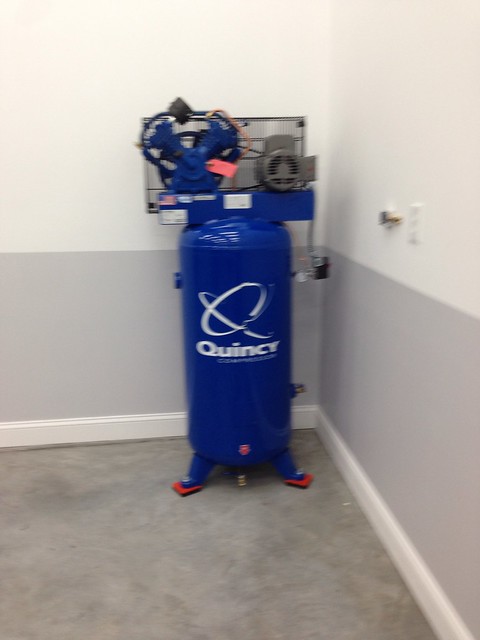

Quincy QT54 compressor was delivered today. I had to lay it down in the back of my Duramax pickup to get it back to the garage. Was only laying down for 15 minutes or so but leaked a couple ounces of oil.
How long should I wait before startup? Also, I'll most definitely be sure to check the oil level too!
I'd wait maybe an hour or two (in this heat), but I'd make sure to replace the oil that leaked out.
Very cool, congrats! Agree with Johnny, maybe pull the output tube and cycle it a couple times by hand to make sure no oil got above the piston.
