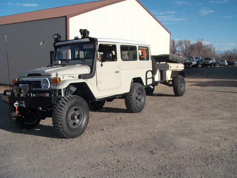

Or just have Proffit's build you one of these...
Started as a shorty...
Current specs include:
-1965 FJ45 SWB pickup turned into custom Troop Carrier
-Turbo'd 1HZ with H55F
-FJ62 axles (rear full float with cable locker; ARB's f/r coming soon)
-WARN 8274
-in cab remote controlled FLIR camera
-in cab remote controlled GO light
-auxiliary WVO tank 25 gallons capacity
-custom rear bumpers
-etc
