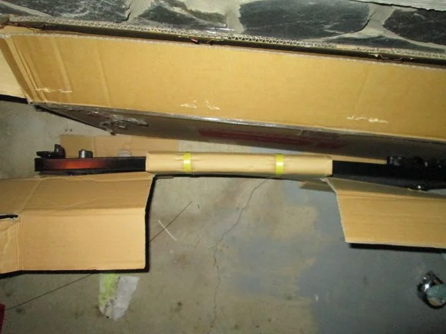

Just received a Denso AC condenser from RockAuto; great price (~$76) but a few problems. The most obvious is that it is bowed forward looking at it left to right ie: bowed out facing toward the front of the vehicle; the original is not bowed. Haven't tried to mount it but I think it might bang into the hood latch bracket just in front of the condenser. The curve is symetrical as if it were made that way however it also has a slight but obvious acute bend on the left side looking at it from top to bottom right where the pressure union is located.

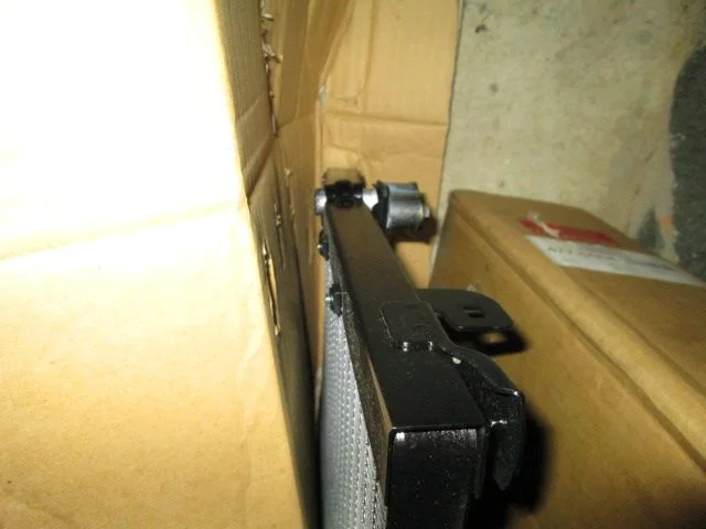

The distance between the mounting posts also does not match with the OEM condenser. I measured ~25 inches between the posts for the original condenser, but the Denso replacement I'm looking at measures ~25 1/4", so it probably wouldn't fit into the mounting holes.
Also noticed one less line of cooling fins across the bottom and some missing foam pieces that are attached to the Toyota condenser, and it did not come with the mounting cushions for the bottom posts. You have to reuse the mounting brackets and cushions from the old part. FWIW. Will post up photos later.

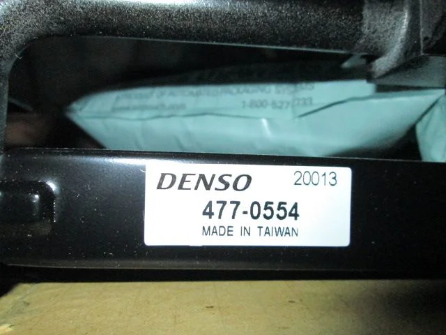

Landtank: did you notice if the condensers you've installed were flat (straight) left to right, top to bottom? This one has been tweaked at some point, and made in Taiwan.
Thanks for the tip on removing the plugs however I'll probably return this one due to the bends side to side and top to bottom, maybe why the mounting post distance doesn't match up with the OEM part??

Kernal, I'm a little late to the thread. So FWIW, I just yesterday received the Denso 477-0554 condenser from Coolstream and mine does not have that bend.
