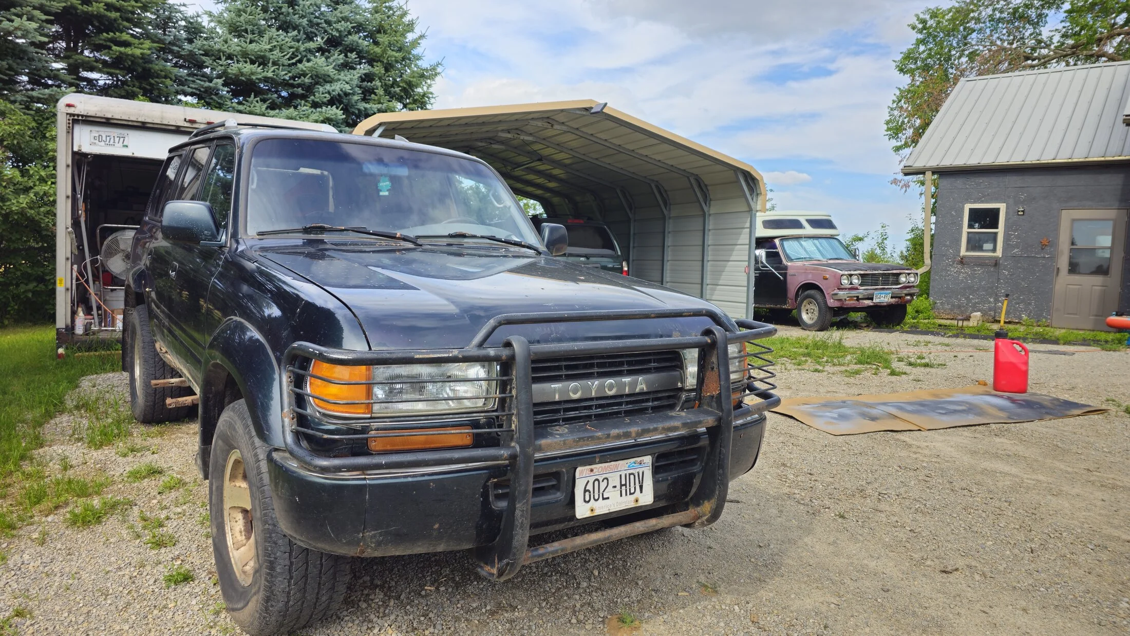

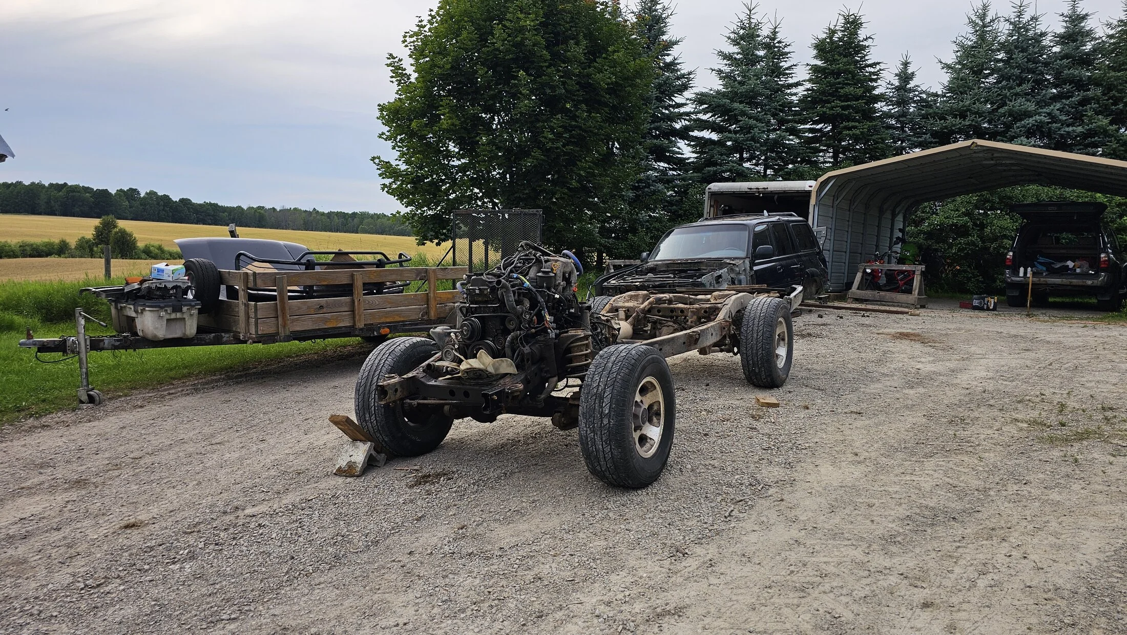

Little background, I've been piecing together all of the parts to build a 4x4 Chinook for a bit now, soon I'm going to be stripping the body etc off of this 1994 FZJ80 non-triple locked, rebuilding the rolling chassis, dropping a 1977 Chinook body on it, tossing a 5VZ-FE from a '98 4Runner, and going out and adventuring with my ideal rig. Combination of modern niceties of EFI, disk brakes, and the reliability of the mechanical 5spd and transfercase, I'm sure I'll find some roadblocks along the way, but I sold all of my other adventure rigs to fund this project so I'm all in.

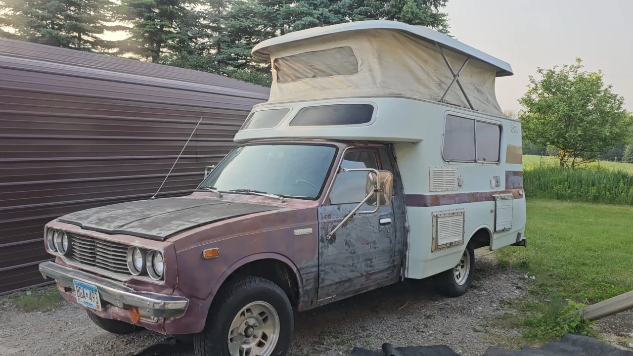

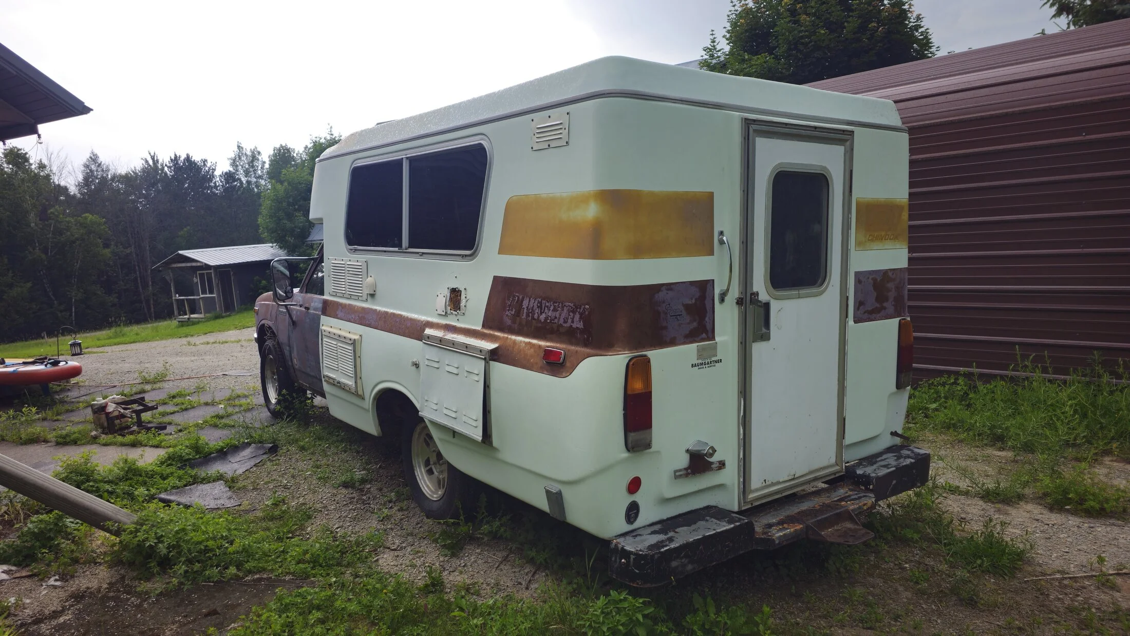

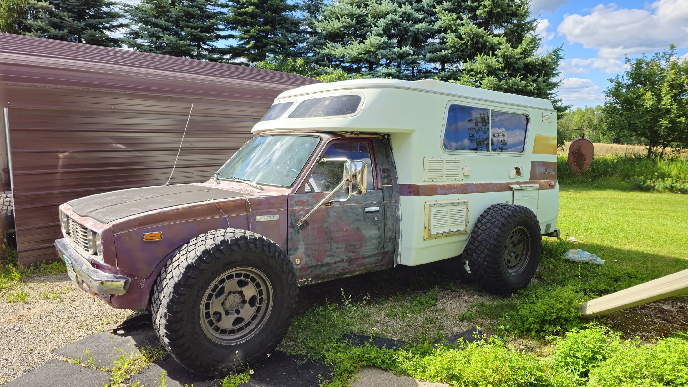

1977 Chinook donor body
She's as rough on the inside as she looks like on the outside, but I'm going to gut it and do some fiberglassing to close up the compartments I'm not going to use. Repair the slouching roof, and new canvas.

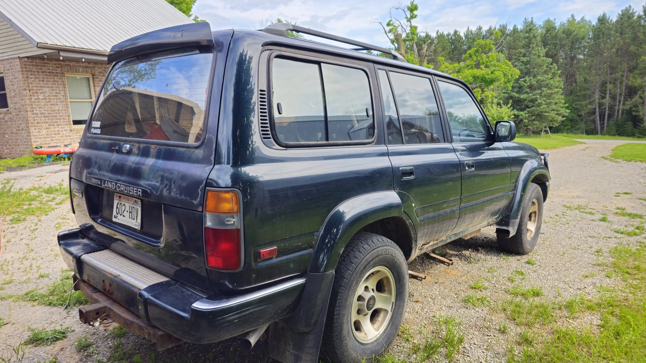

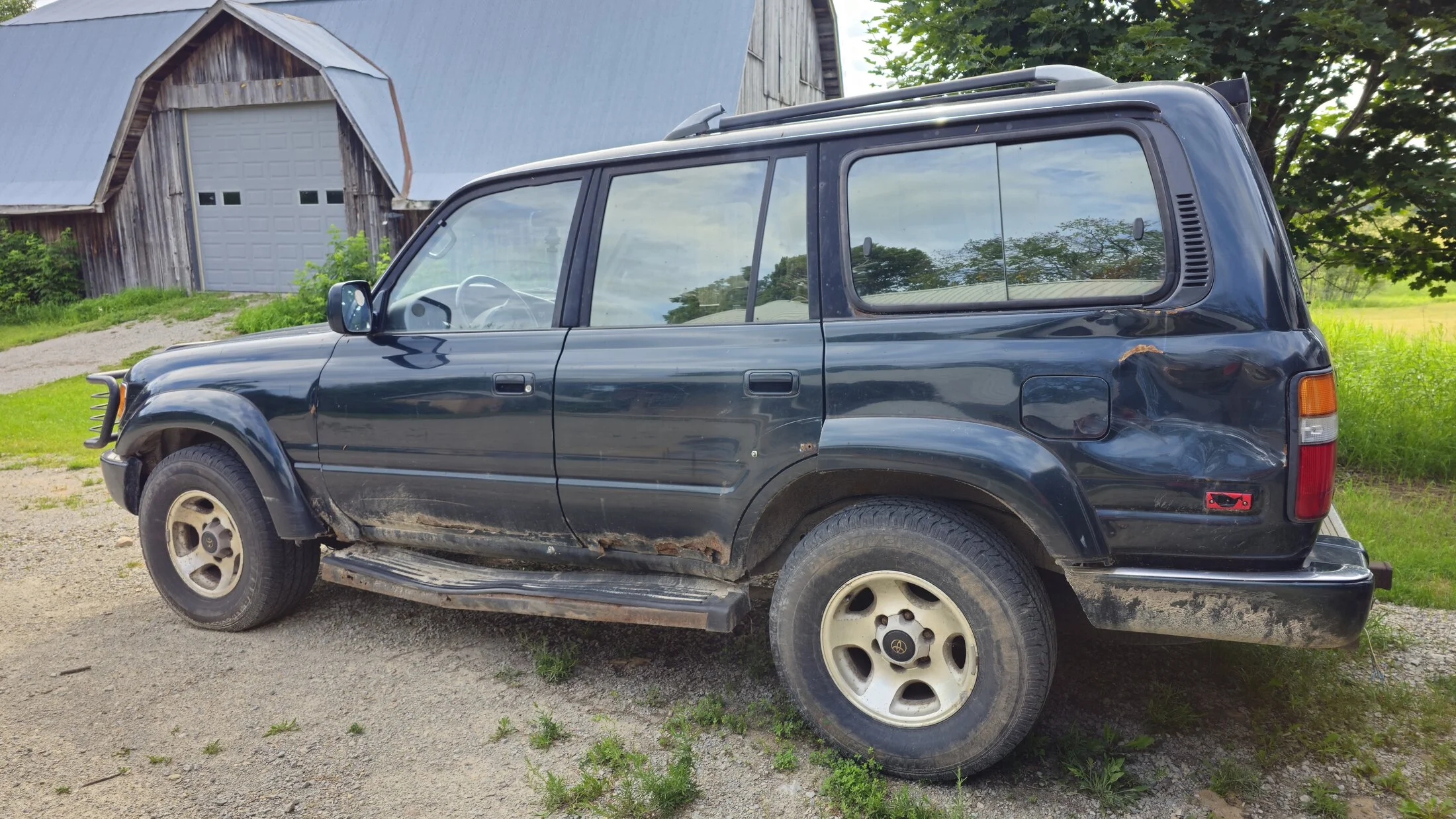

$1600 -1994 Land Cruiser
It got a little sketchy, but got it done. Going to borrow a steam cleaner and get the 1FZ cleaned up and pulled off the frame. Then its on to fully cleaning the frame and probably prep and Por15 to get the thing protected.

I personally like the looks of the 70s Hilux body over the 80, I think it looks more put together than the chinook slapped on the 80.
The 80 body also was a critter nest so it stunk of animal feces and urine etc. and it was generally rotted out.

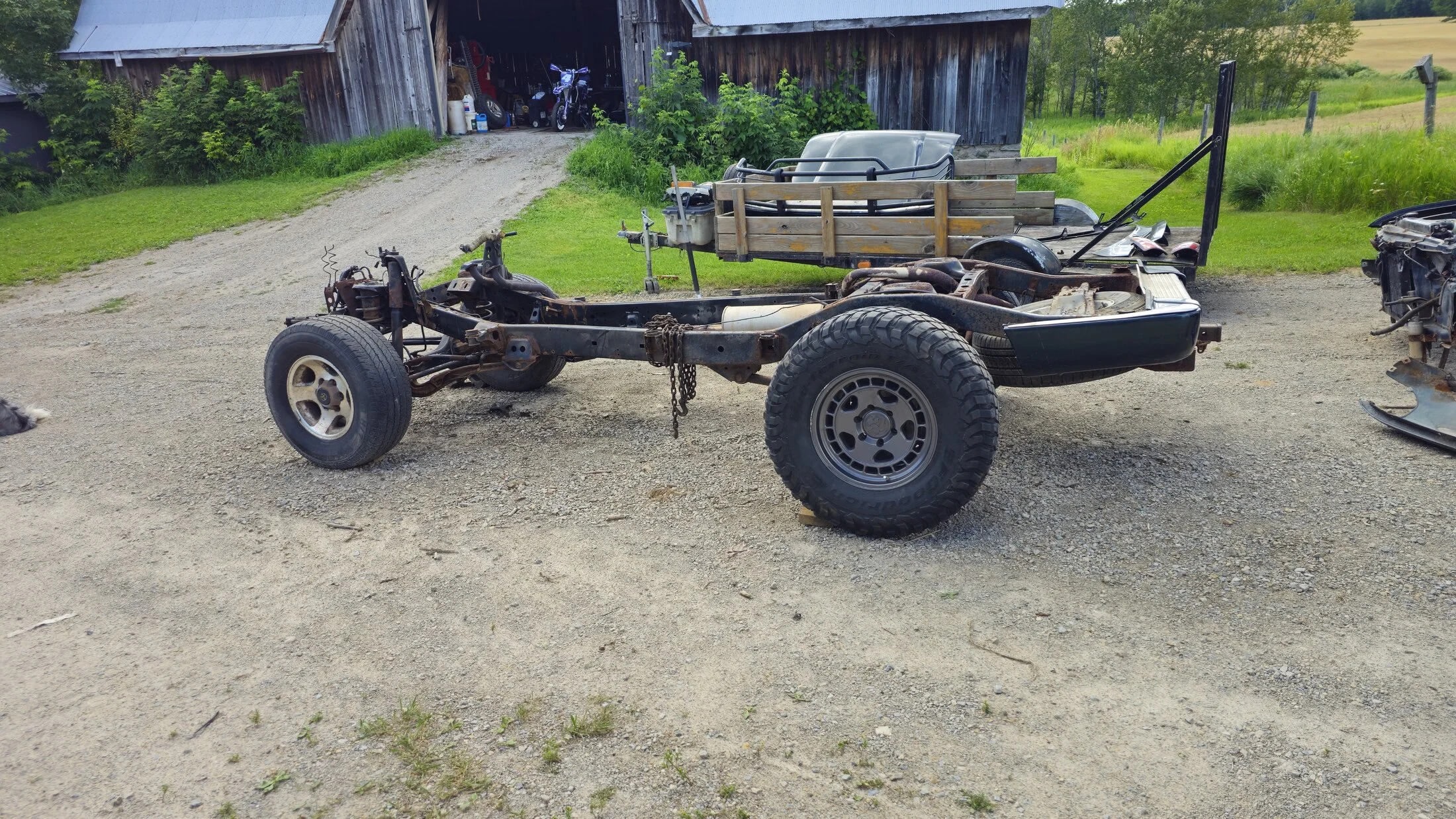

Everything is off the frame now, I'm going to get the needle scaler and wire wheel out to knock off as much of the rust as I can, then I settled on going with a fluid film for protection. I think something like NHOU or Fluid Film for it's creep ability and I don't mind spraying it on occasionally.

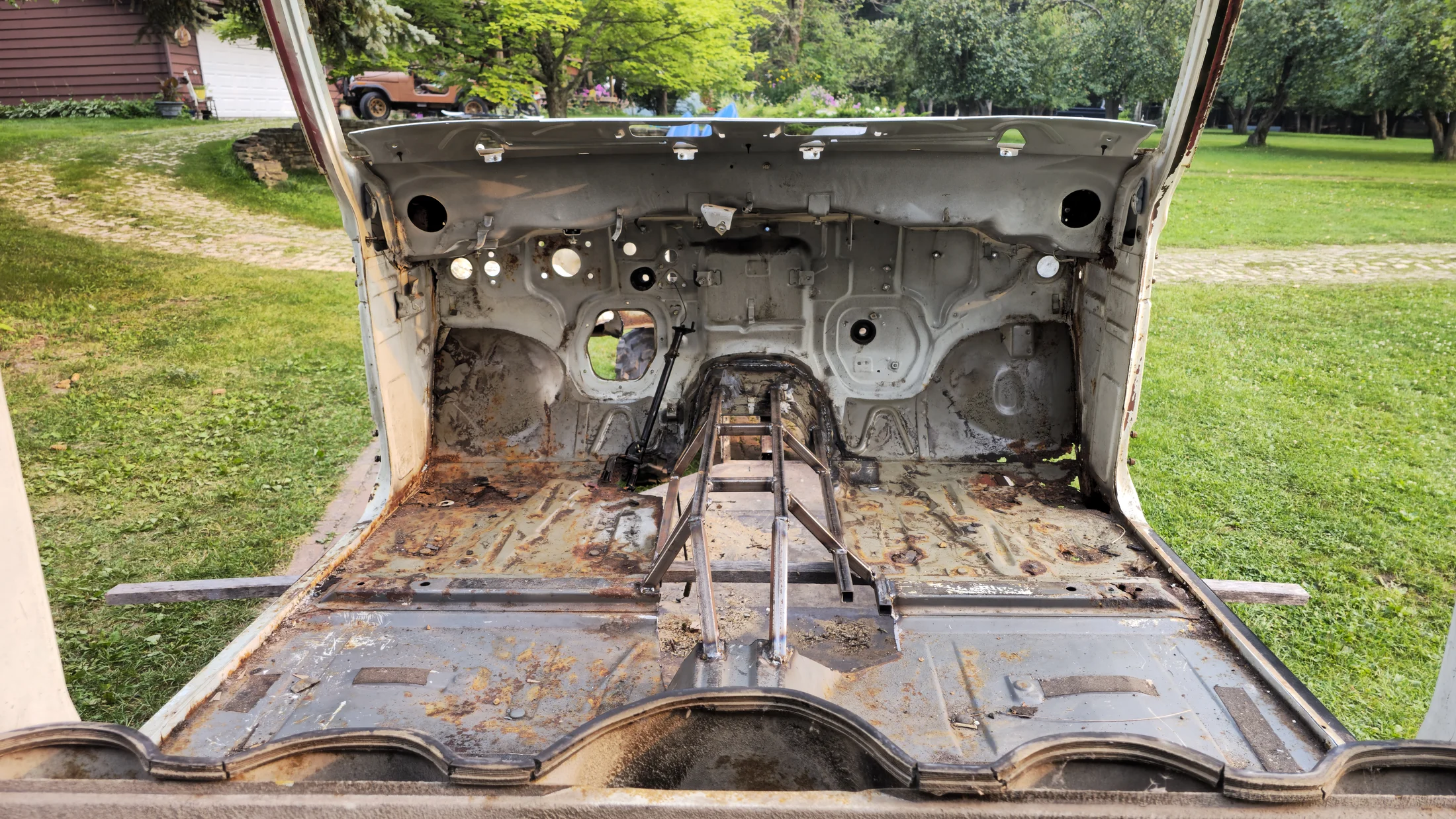

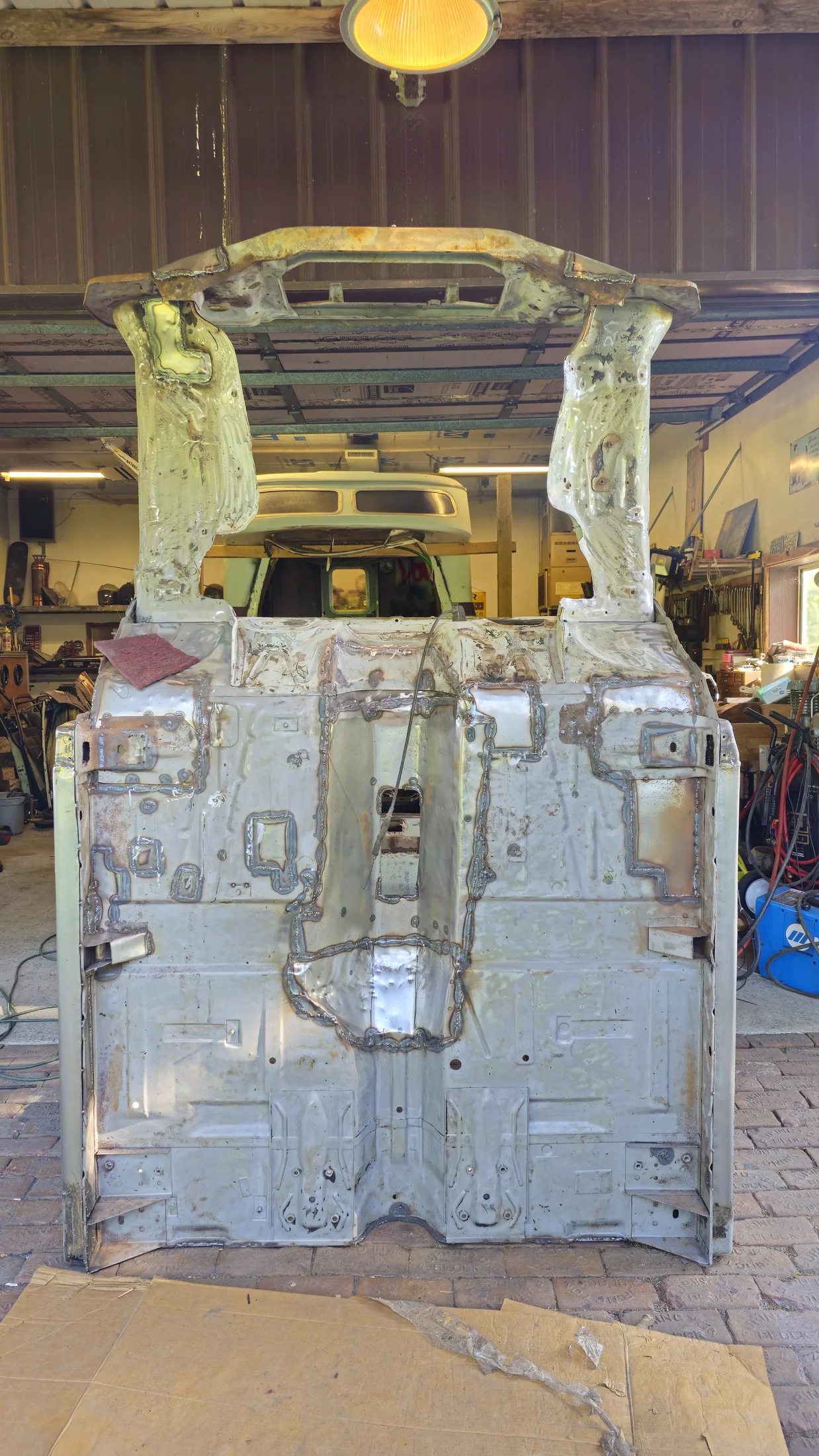

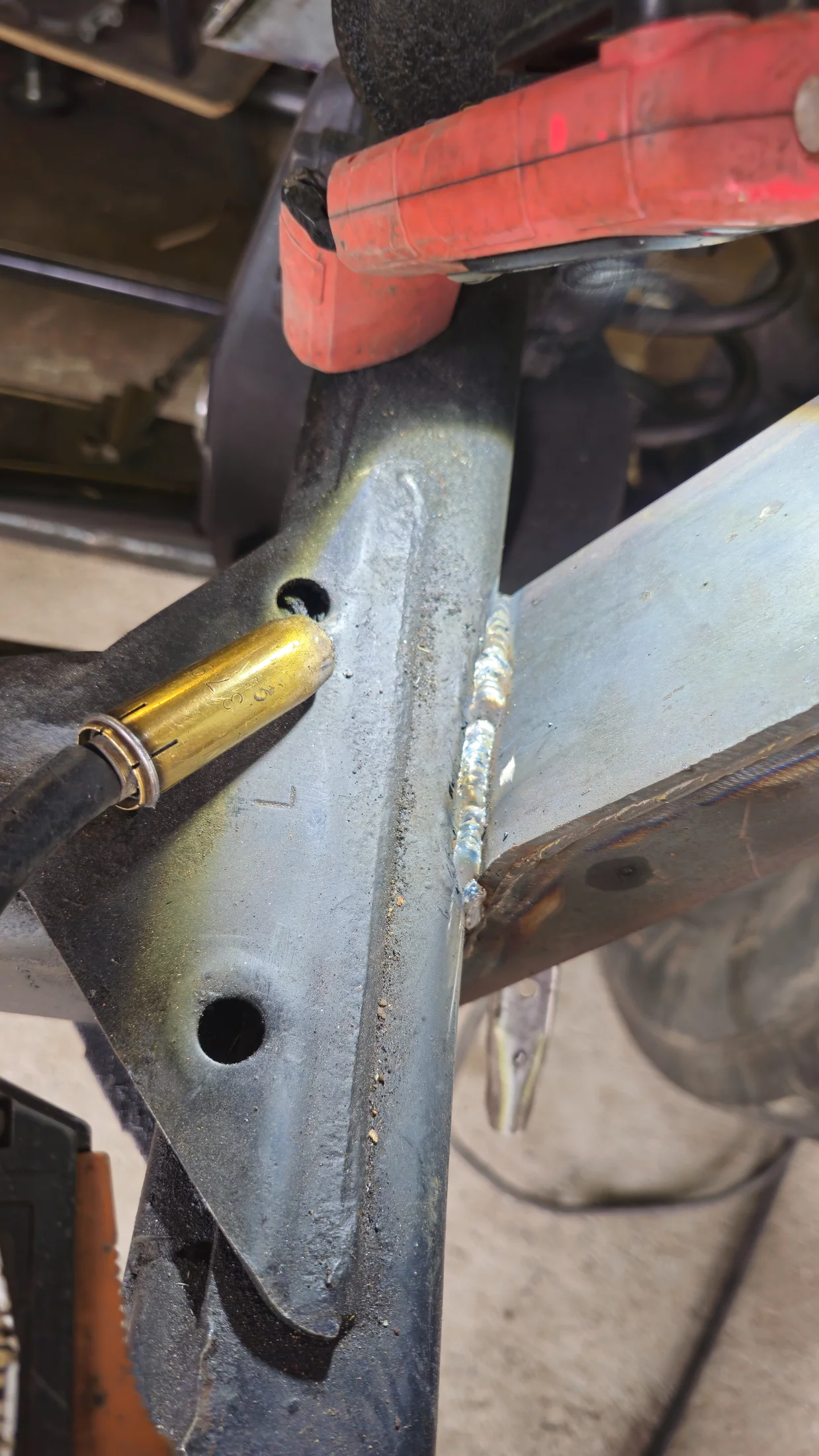

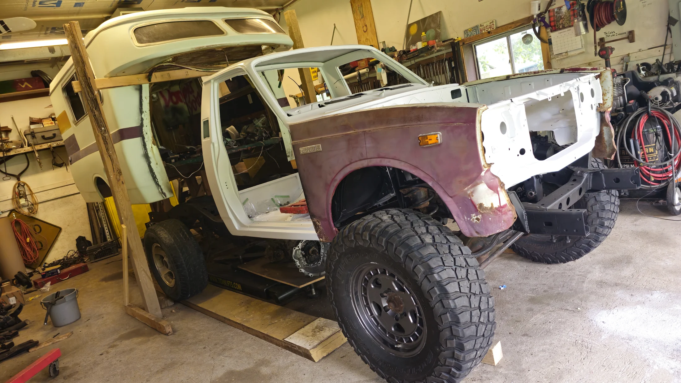

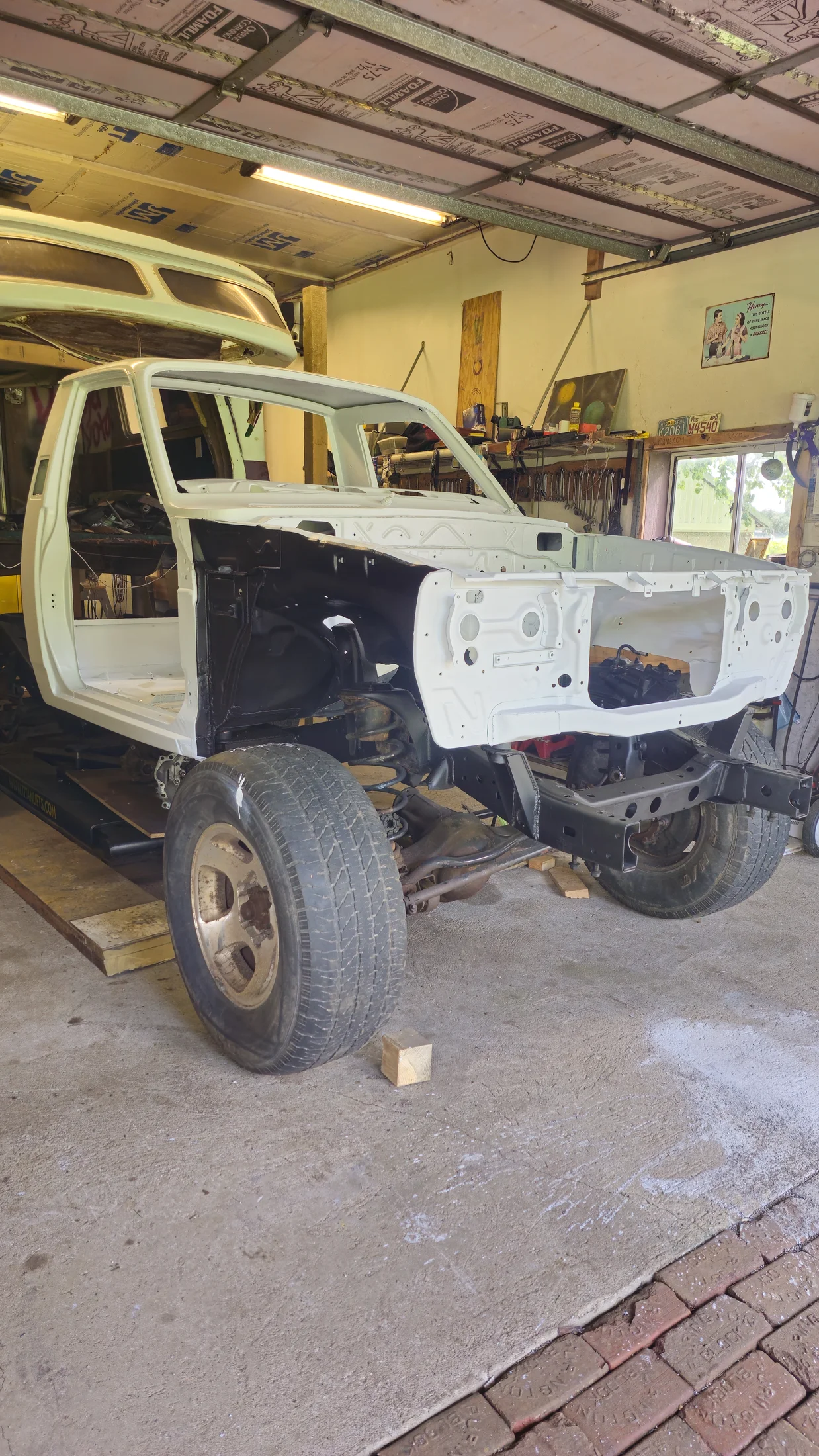

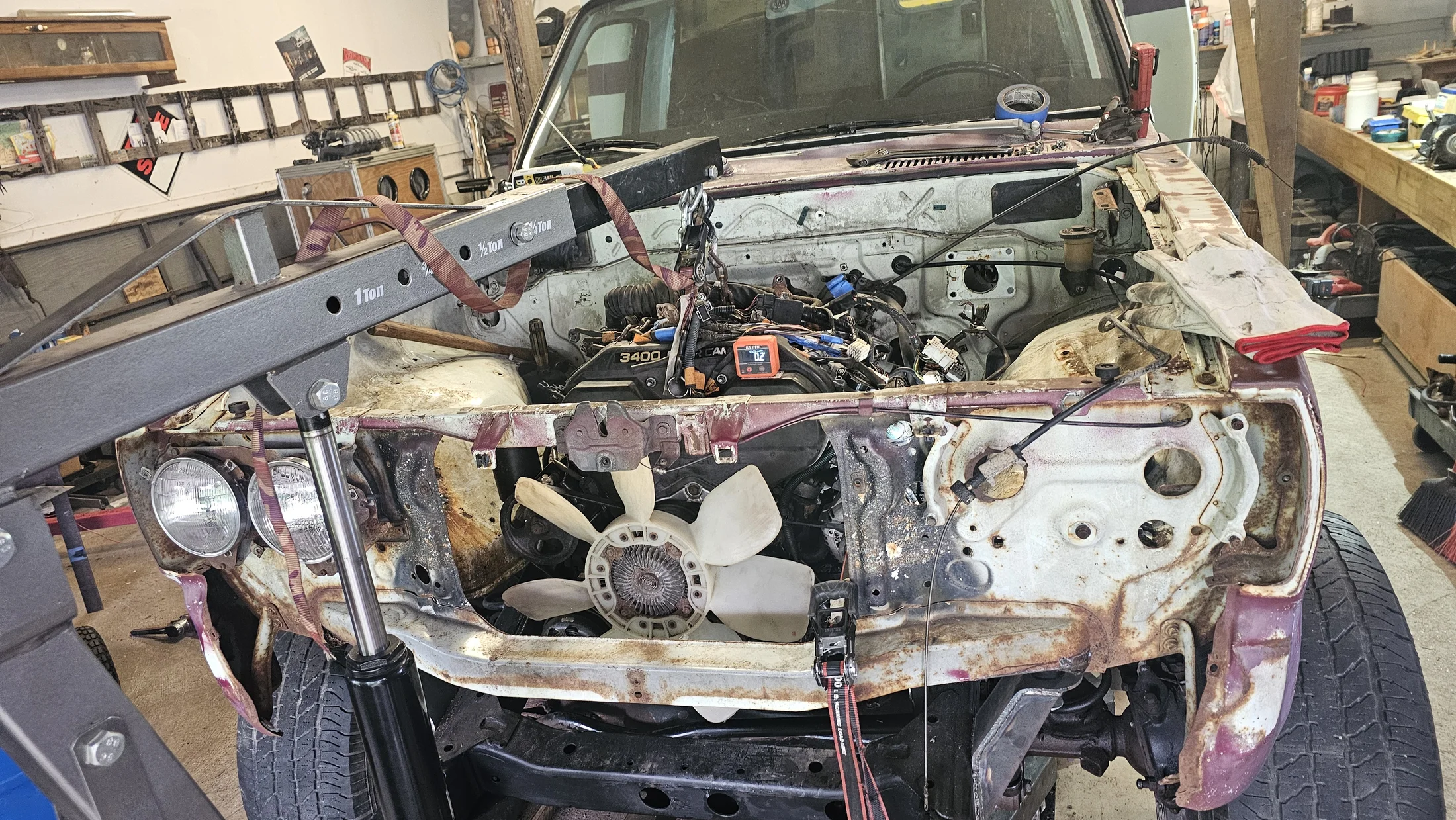

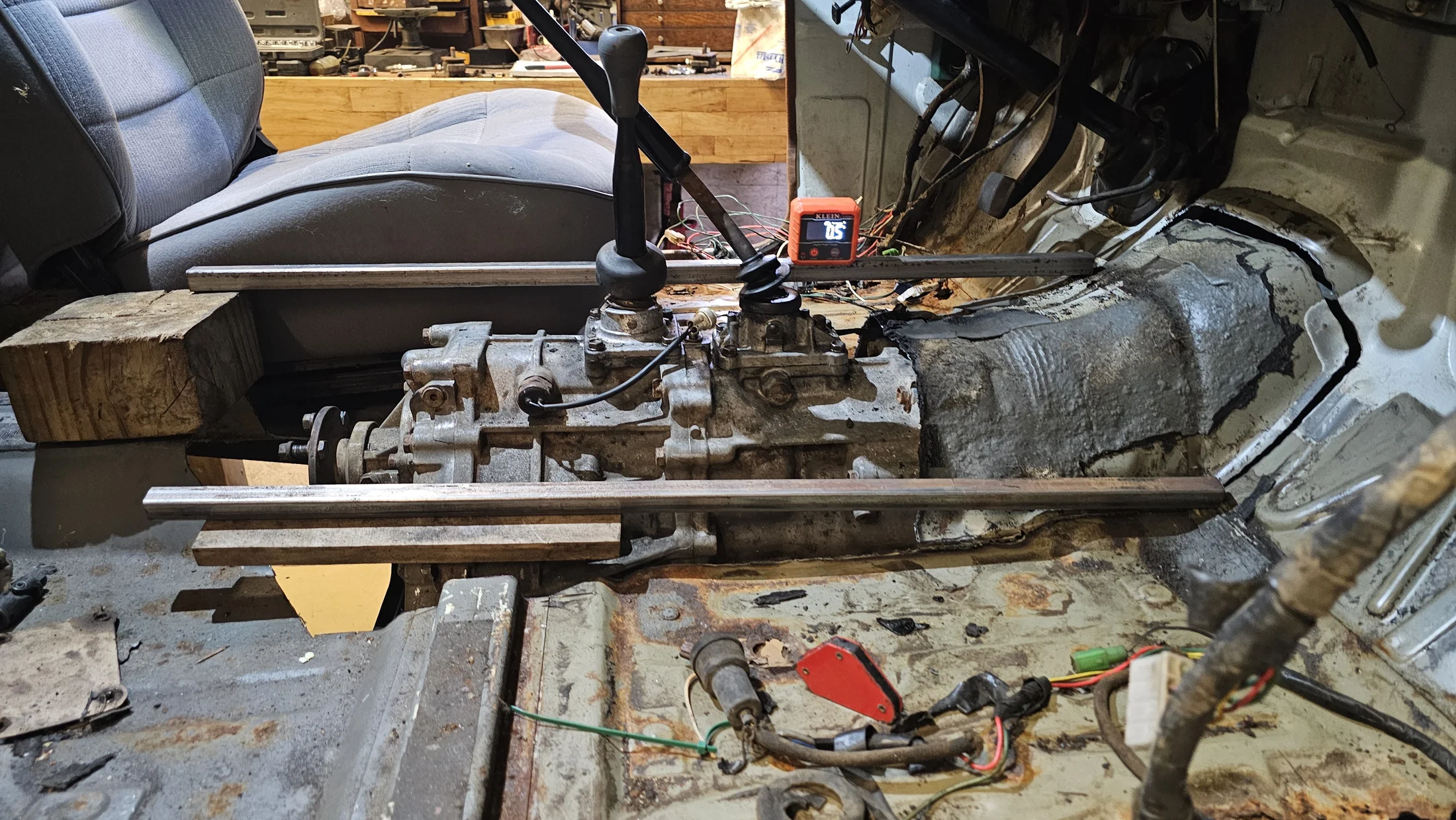

Well I made a boatload of process on the build, swapped frames, fully mocked up engine and trans, body mounts etc.
There was admittedly more rust on this thing than I expected, but I committed to it and cut and welded fresh in, full rockers and all.
I laid down epoxy primer/sealer, filler, and seam sealer, then epoxy again (3 total coats of Epoxy sealer. On the underbody, wheel wells I sprayed raptor liner.

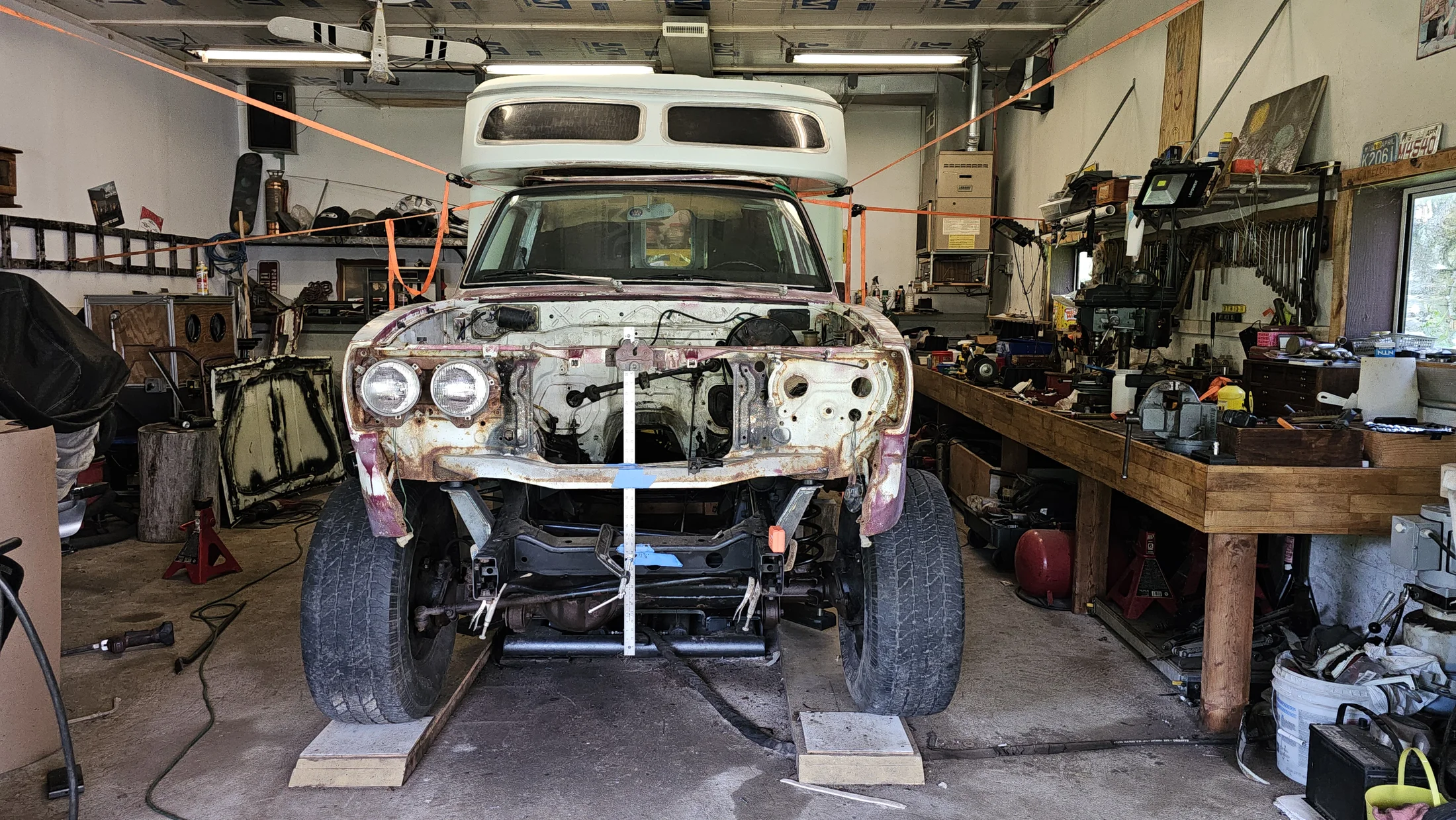

Tires will fully clear the firewall and inner fenderwells, radius arms, etc, happy with that. But there will definitely be some serious chopping to do on the front of the fenders and valance.
Going to assemble the cab, and wait for the last bits of my engine/trans parts to come in before I can toss that in for hopefully the last time.

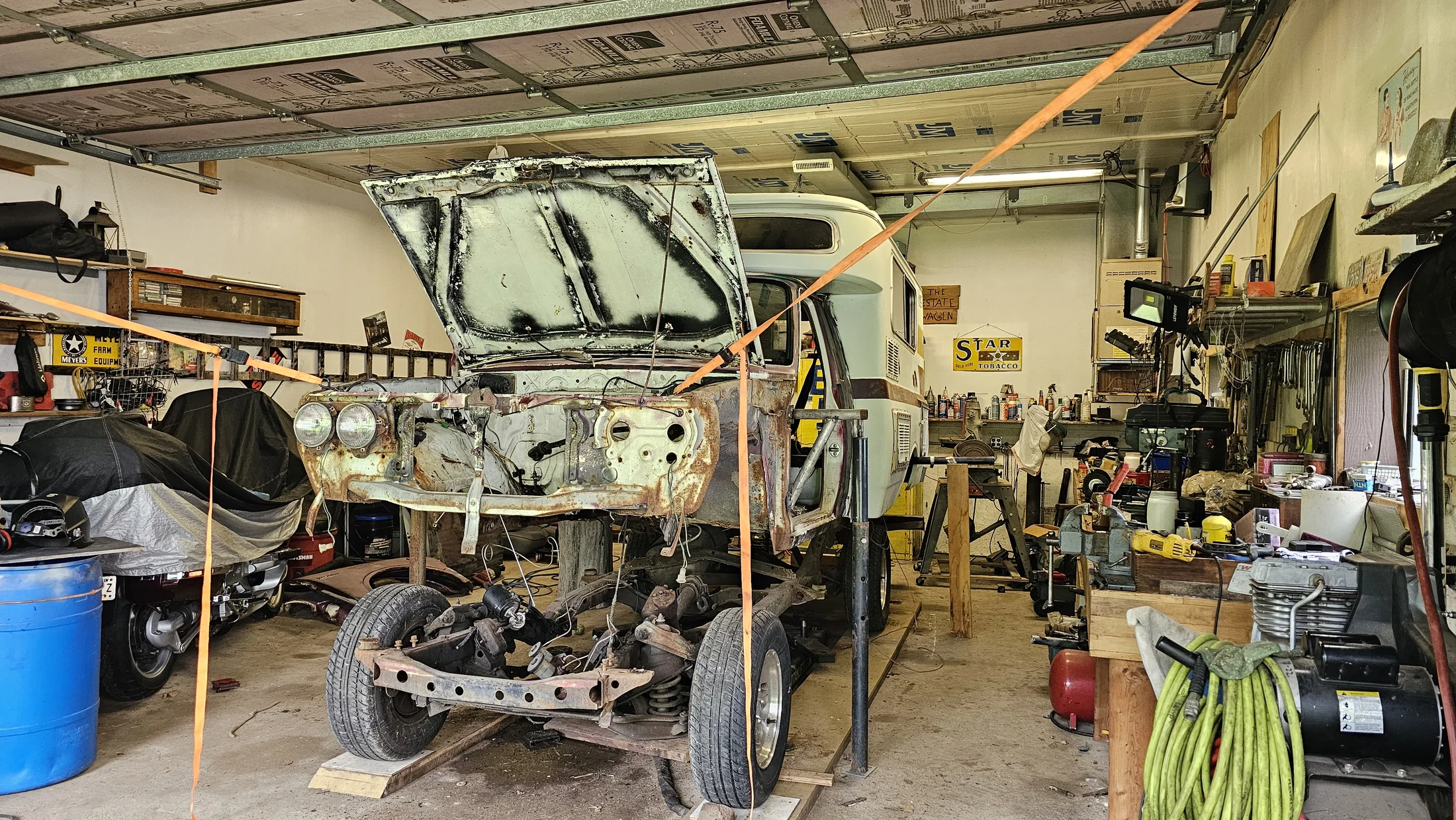

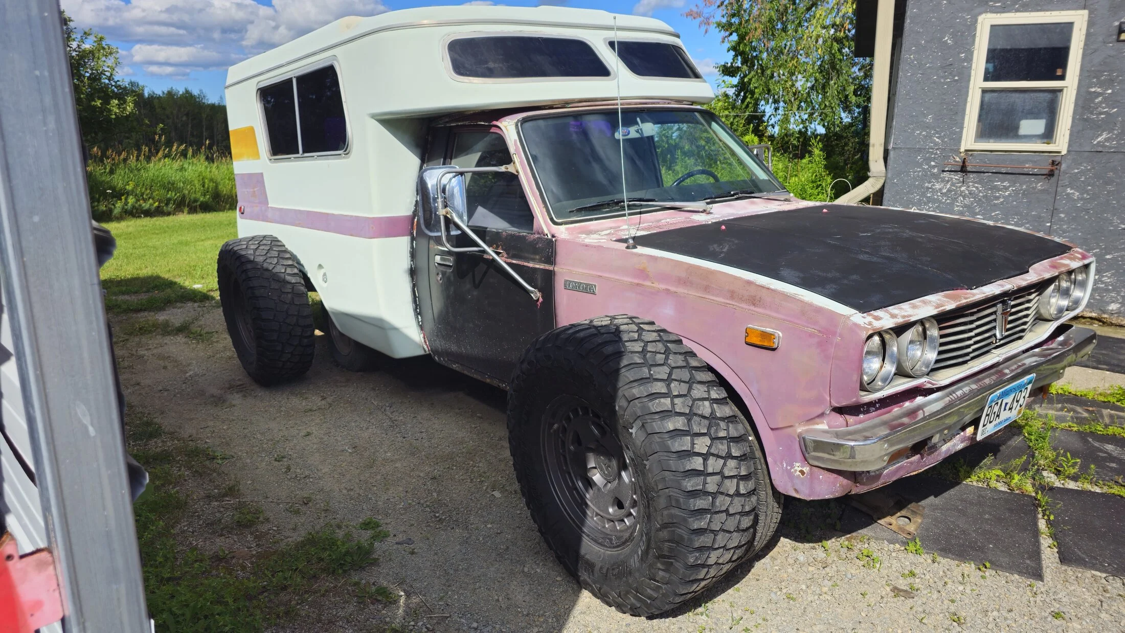

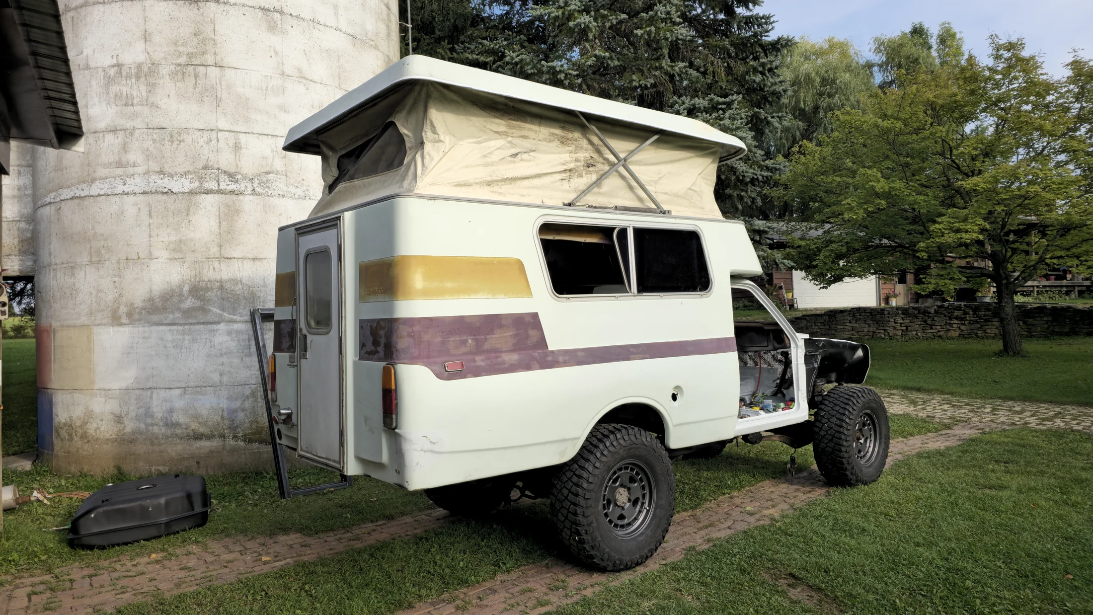

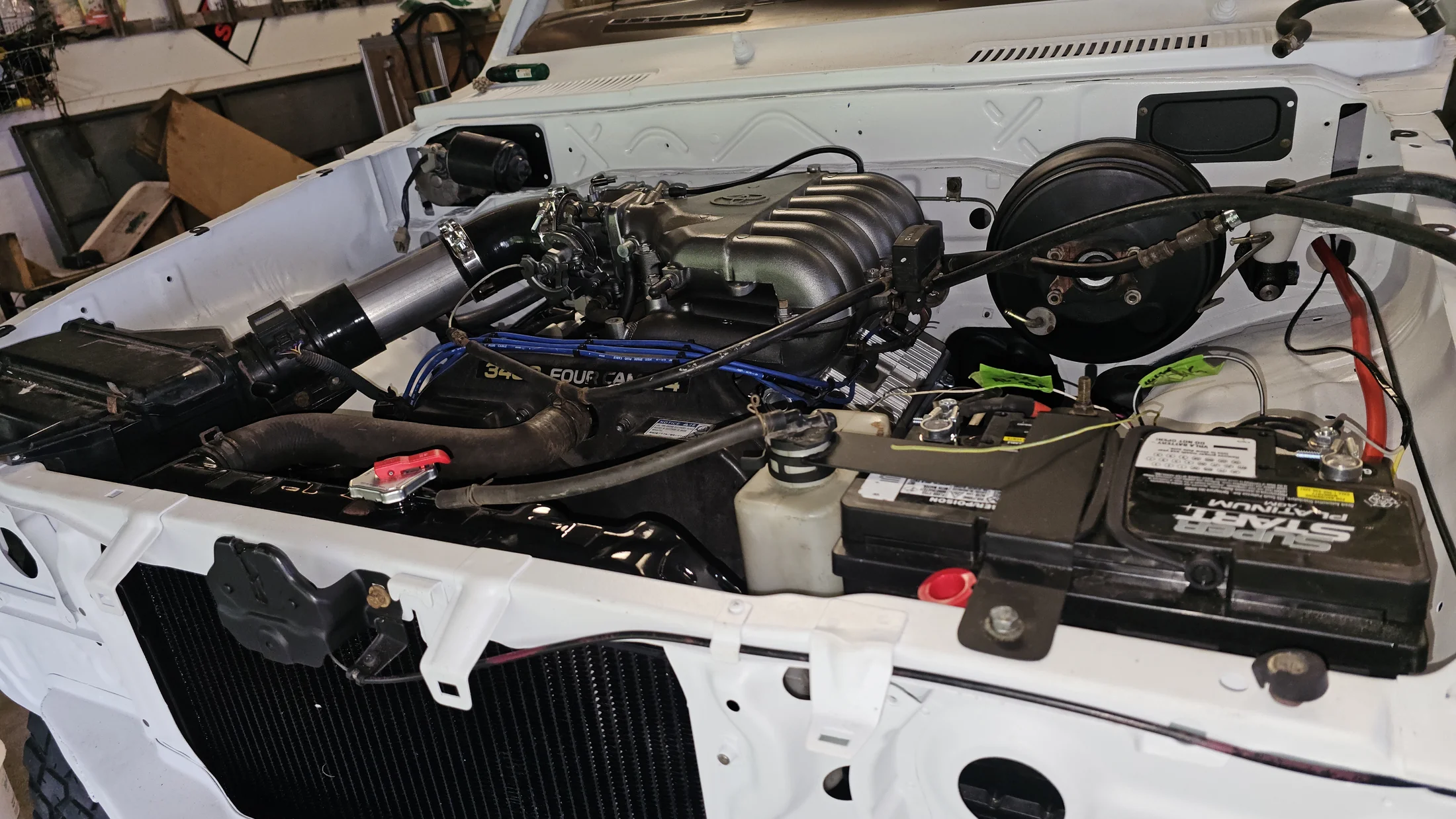

Got the engine in and temporarily wired up, she runs, but currently it's straight off the manifolds so she's louuuuud. Waiting on stuff to come in for the exhaust, and I'll get that all fabbed up and installed.
Brought her out to see the sun for the first time in a few months, I think I'm going to need to cut a little bit off the front of the rear wheel well to clear the 35s. Here you can also see my massive 42gal (~160L) fuel tank.
