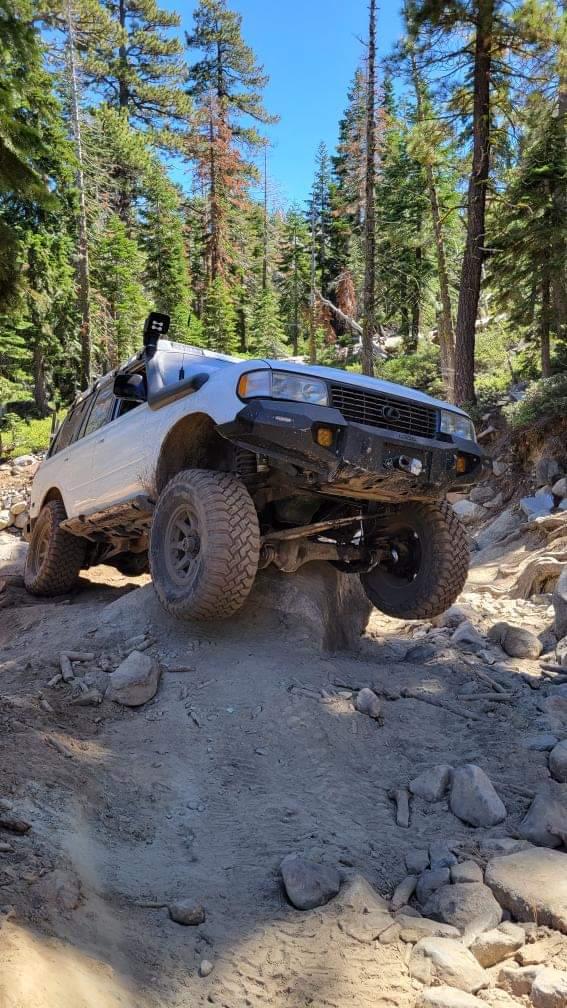

First picture, it appears that theirs a loss of ground clearance at the bottom of the arm over stock arms ?
As shown multiple times in this thread, our arms are similar profile to oem
OK, there's 32 pages do you have a reference. what does similar mean that there's only a small loss ?

My arms are slightly thinner than stock and I have noticed a slight difference when contact is made, I tried to articulate this below.
Billygoats 2¢
Compared to stock it seems to me that the front end slides/glides a little better than stock arms, I think if it sort of like a boat or a kayak tracking in the water compared to stock when contact is made there doesn't seem to be as much shifting around they seem to track across the rocks better. More predictable, hard to explain.
The Rubicon for example is a constant obstinate/ contact kind of trail, nothing but rocks, boulders and obstacles for 3 days.
Similar to a really good set of frame sliders which are sort of tubbed out allowing the truck to glide across an obstacle there's plenty of examples where both my frame sliders were in full contact as well as my radius arms sliding between, up, and over, an obstacle.

On the lifted ones yes. This is due to the increase rotation of front axle backwards to account for caster. It’s like flexing your elbow more when doing a curl. If bend wasn’t there it would not clear tierod
the reference is this thread, in multiple places unfortunately I don't have time to go over it over and over again. similar means our arms have more clearance for the tie rod.

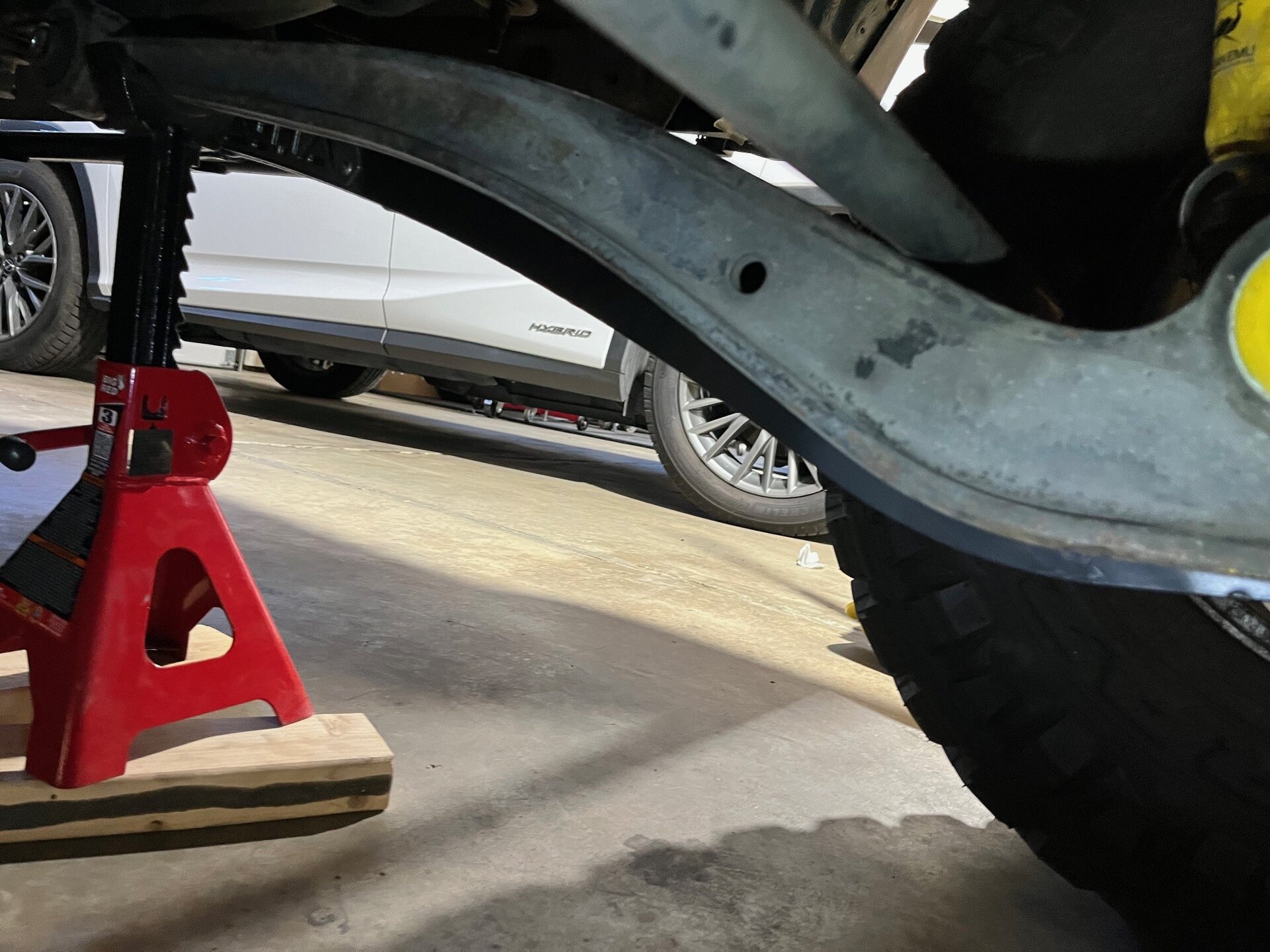

I’ve spent a lot of time under my 80 it looks like those arms hang lower just below the tie rod

So I threw the old arm up next to the new and while not the most scientific it offers some comparison. I didn't measure because for me it's moot given the other benefits and in a quick side by side look, they were practically the same.
So I took a measurement which shows about a 1/2" difference but the the arms are not apples to apples as I have the L arms which push the axle forward another inch so they dont exactly line up perfectly to truly compare, you can see the old arm jammed up against the tierod. Unfortunately in order to get them to fit next to eachother, the old arm is slight pulled forward. If you were to move the axle back and inch the arms would likely be the same.
