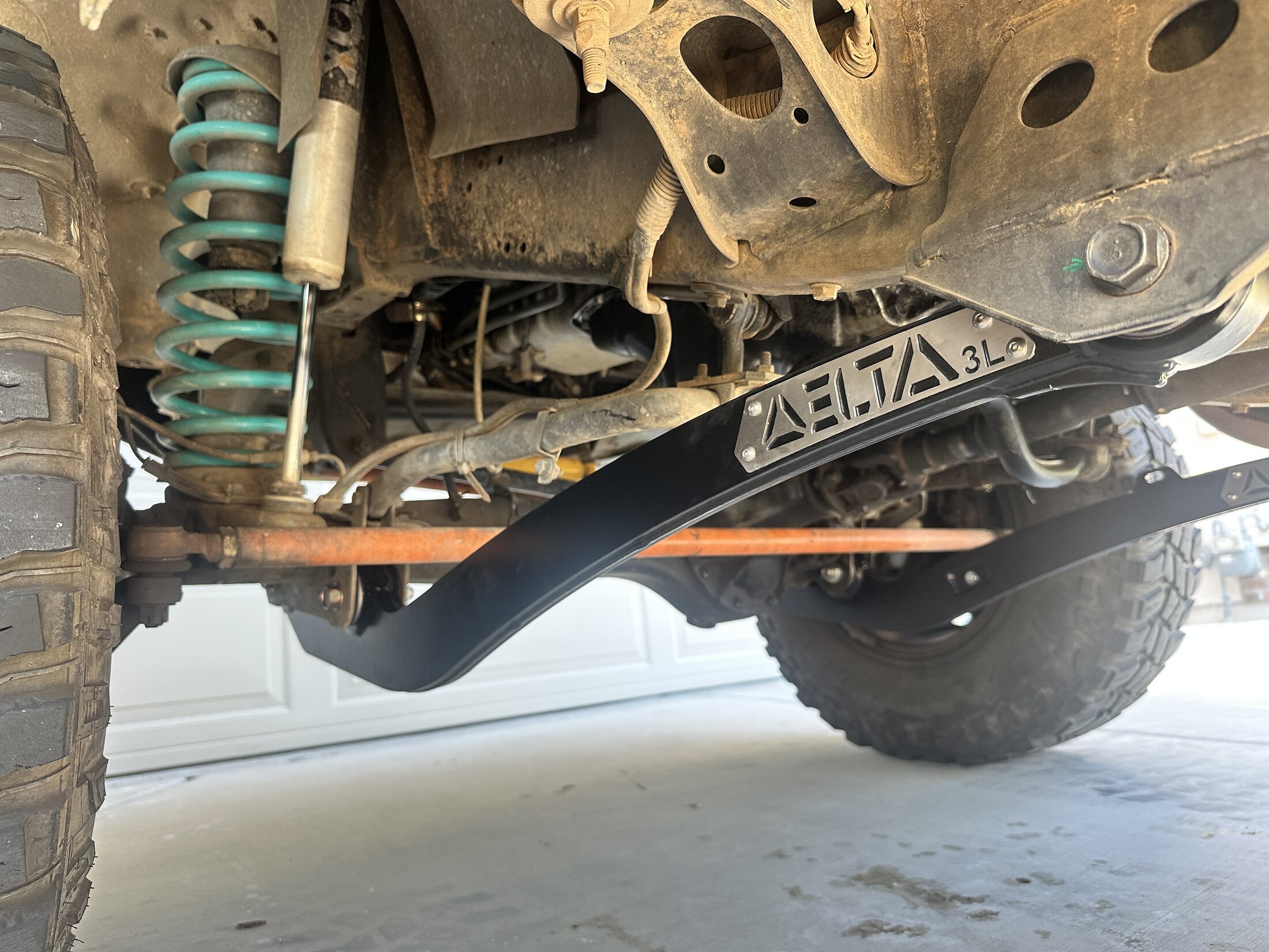

Absolutely no reason to shy away from L arms with 35s. We’ve been running a set of L’s on one of the shop rigs with 35s since before we started selling them, with no ill effects.

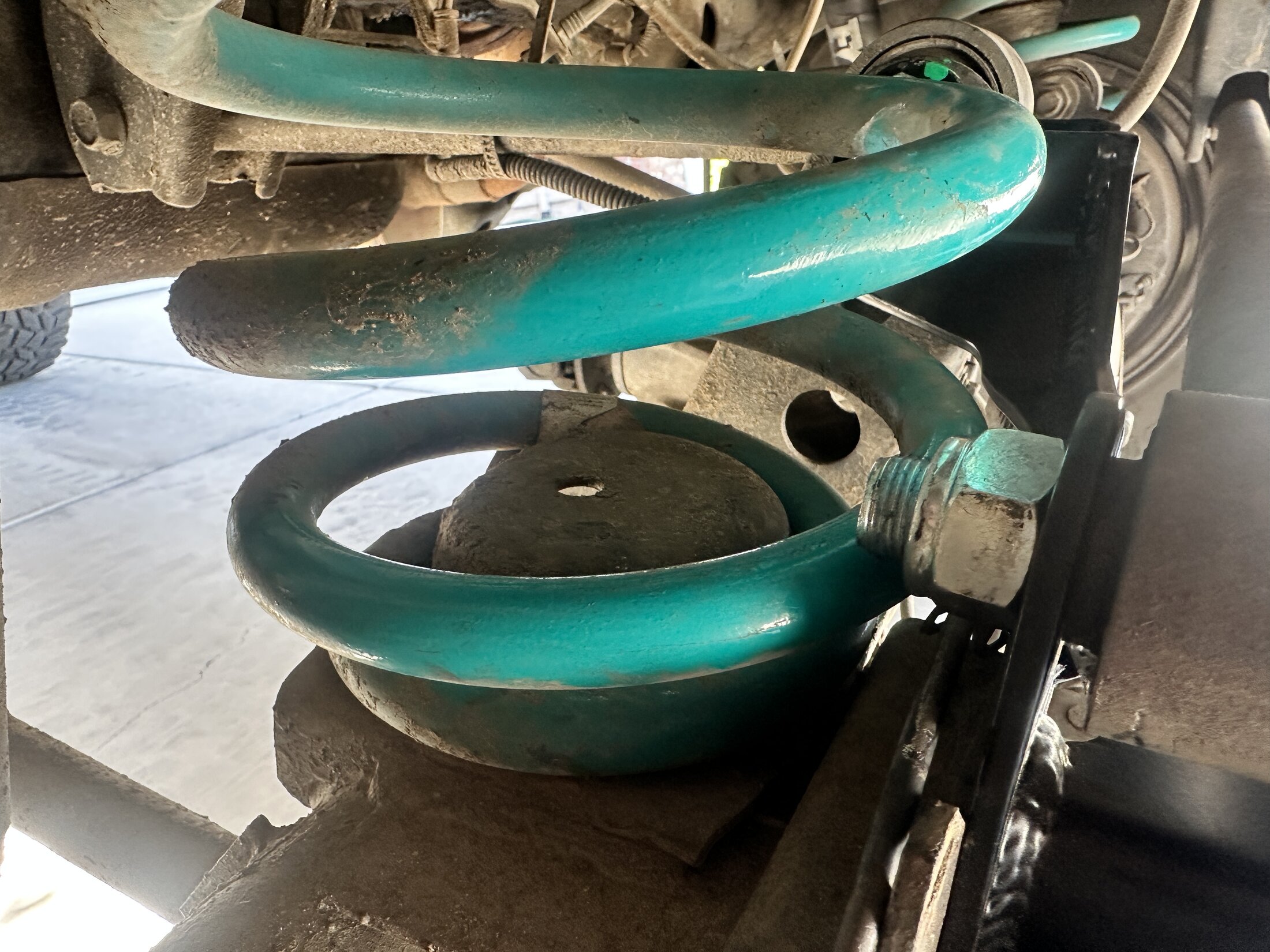

Put on the Longs and the panhard bracket. In retrospect, just pay the extra money for them to press the bushings in. I’ve spent as much money trying to press the bushings in with shty harbor freight press as I’ve spent installing the arms.
Rear bolt was a pain, but I was able to jack up one side and stretch the spring out for the bolt to come out.
However, it does seem like the bolt is 5mil too long, and I’m concerned it would wear down a notch in the spring. Is this common?
I experienced a similar clearance issue and ended up inverting the bolt.

I reversed the bolt.
The instructions does say the following:
If you find there is contact between the bolt and your spring, it is ok to install with bolt head facing toward the front of the vehicle.
It’s a common issue 😜
However you achieve the Clarence make sure the bolt is not rubbing on the spring.
I though that was referring to the control arm bolt.
