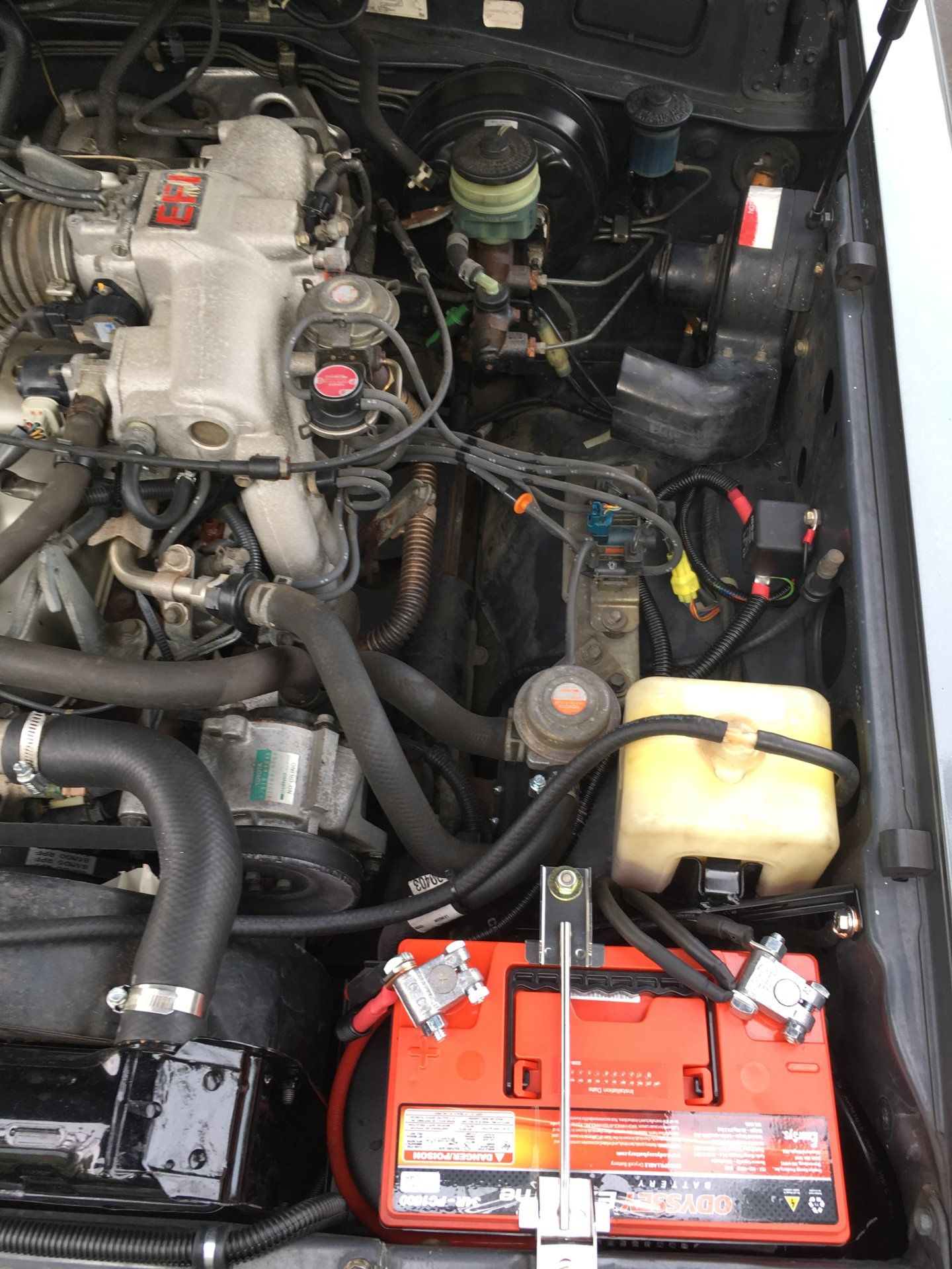

I moved mine over to the pass side inner fender, between the original battery and the windshield washer reservoir. find threaded holes in the side above the wheel well that fit the same screws. Hose reaches too. Just have to loop it around.

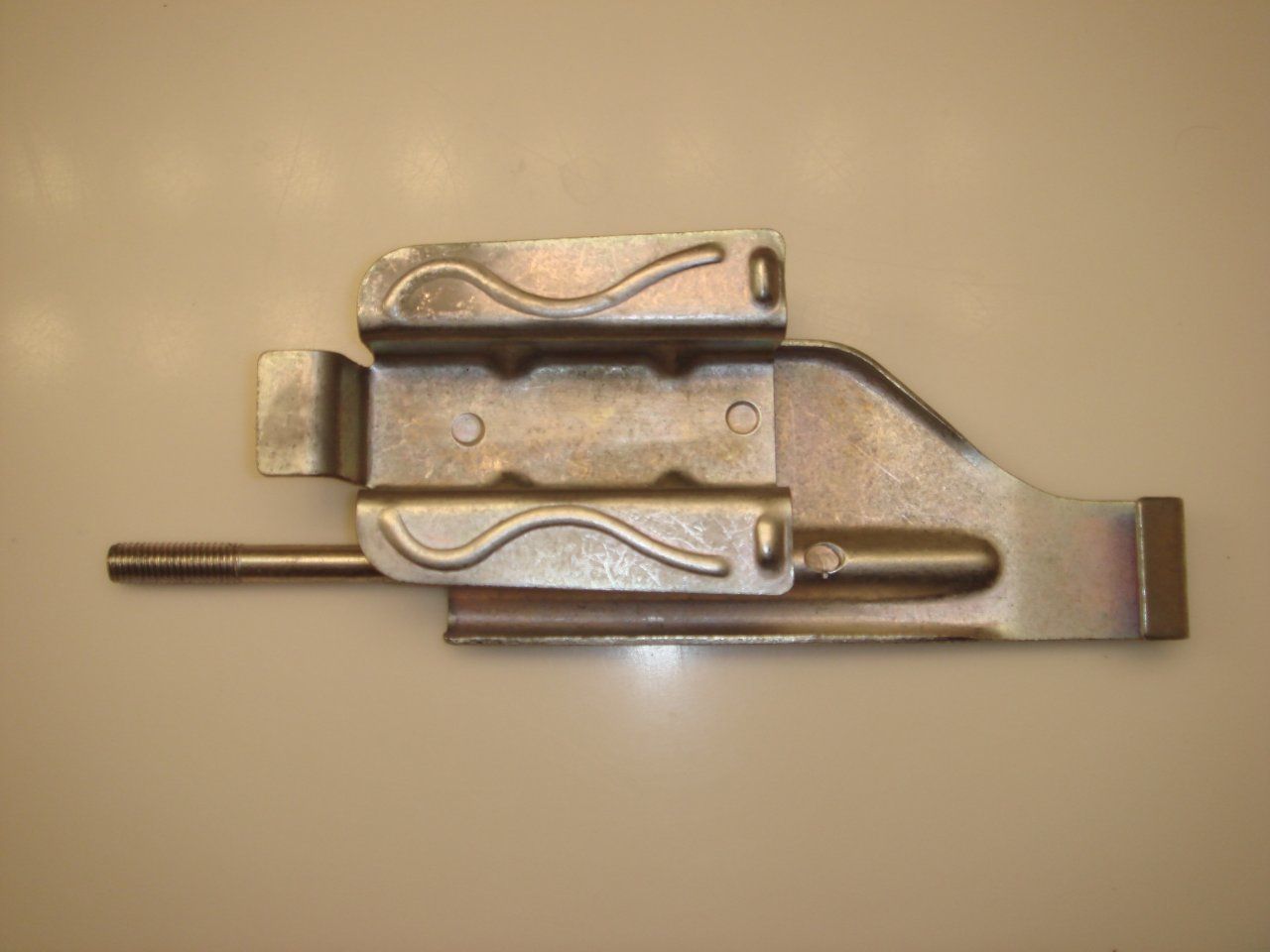

Toyota made a bracket exactly for this purpose. I had one & sold it. They are still available NOS on the web. Here's a used one:
Battery Clamp Bolt for Diesel H and B Engines from 8/80-8/87 [74407-90A00 - USED] - $40.00 : CruiserParts.net, Toyota Landcruiser Parts
It looks like this:
But you can make the original one that came with your truck do the same thing (relocate to passenger battery hold down hook) by just zip tying a bunch of small zip ties through your original bracket to a small (16 penny nail) to the hook rod. That's how I had mine for 'decades' when I had 2 batteries in the truck (don't anymore).

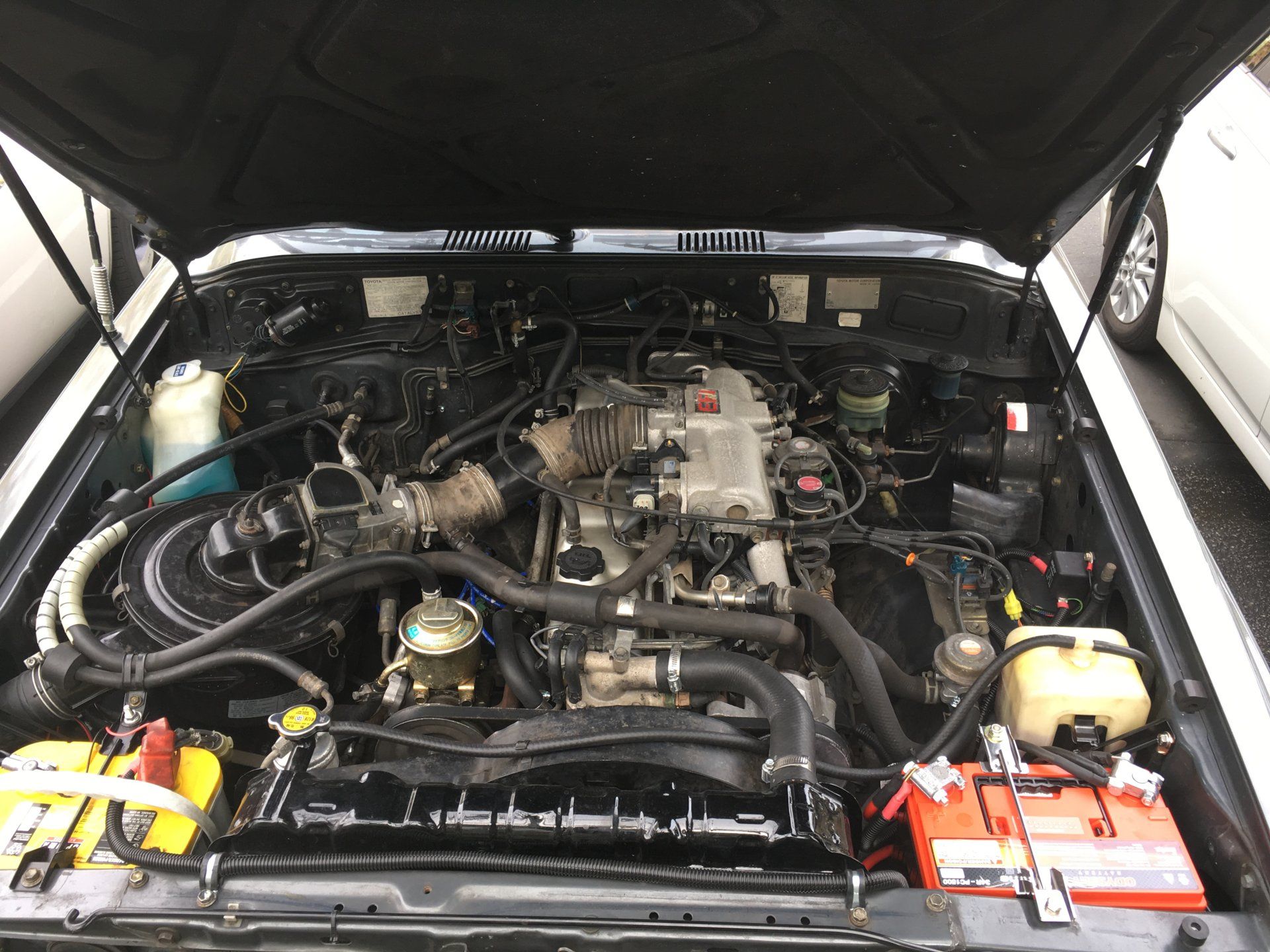

You can sort of see it here. That's using the original bracket.

I kept the factory bracket and just used a few bolts and a piece of scrap to mount it to the brace on the Stainless Steel Battery Tray that I got for the second battery. Plenty of room even with a Group 31. I think he also makes one that puts in on the brace as well.
