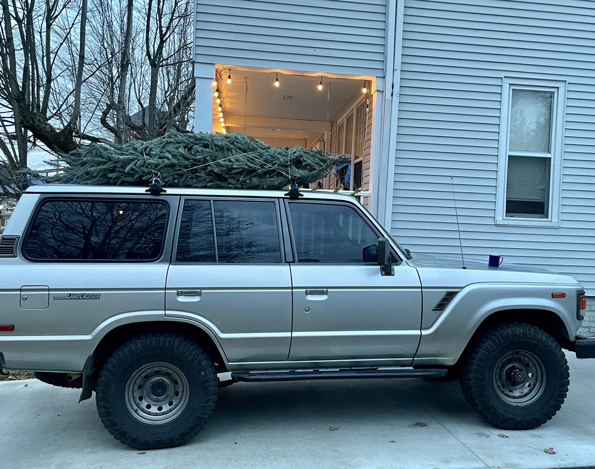

Not that exciting mechanically, so here’s a poser 60 with a Christmas tree shot…..
